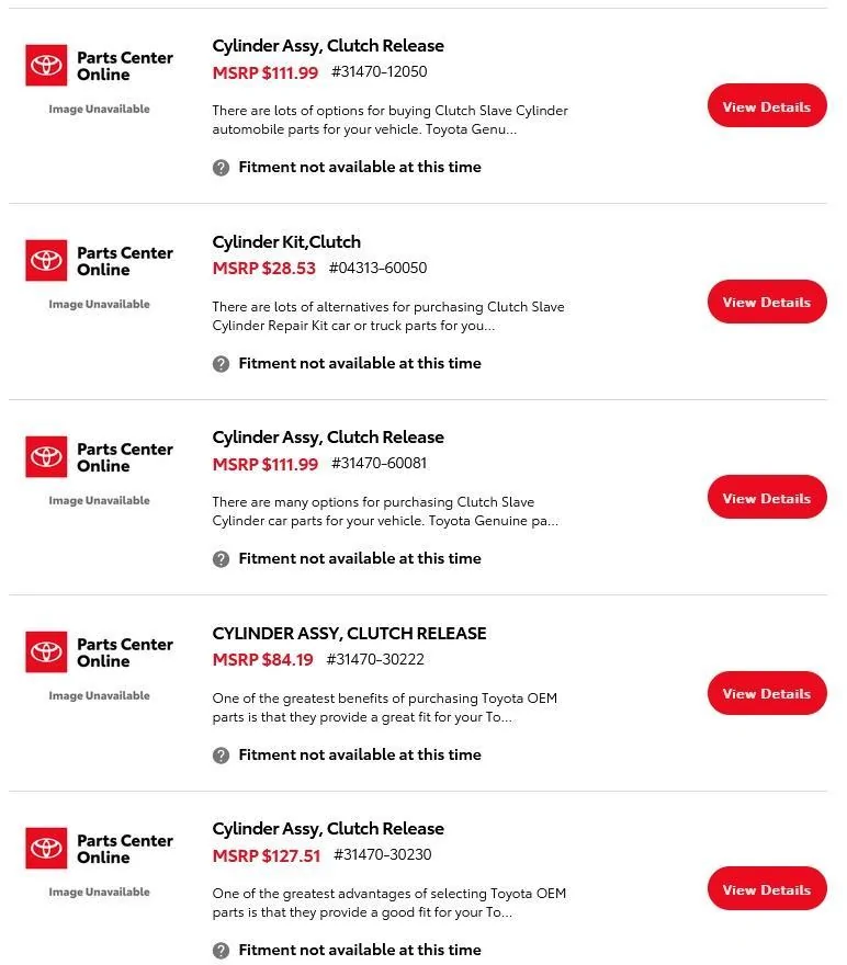

Has anyone swapped the actual slave cylinder with the BMW one (Part# 21526785964)? If so, does that slave cylinder attach to the trans the same way as the OEM one?

This kind of got me thinking. Might be easier to just do the mod, and in the unlikely event one were to have a serious transmission/clutch issue that needed warranty work, that would be the time to swap out the slave for an OEM one with the CDV valve still in tact. As such does anyone have the P/N for the OEM Slave Cylinder?
I did.
yup.

Does anyone happen to know the correct P/N for the OEM 2023+ GR Supra MT Slave Cylinder?
