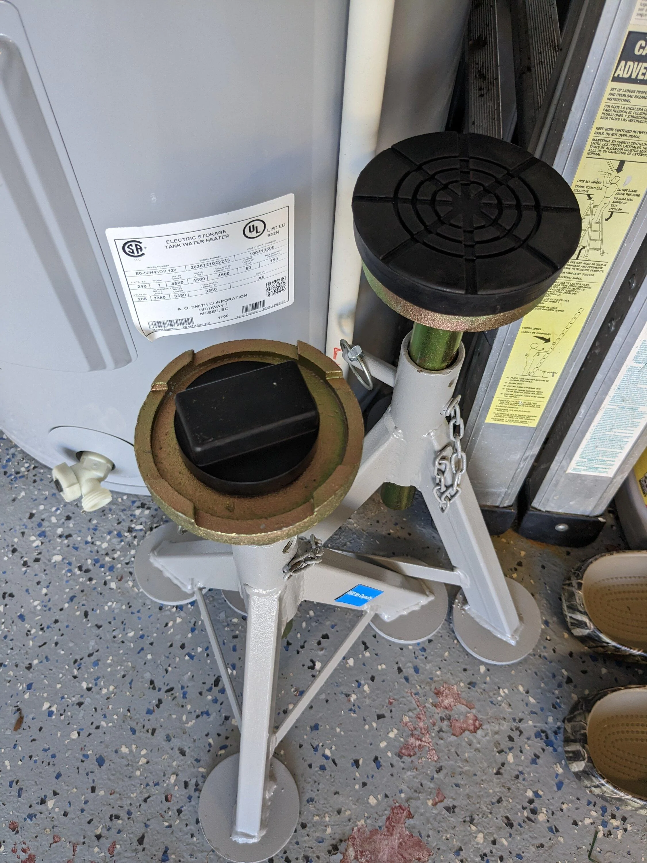

So I currently only have a regular jack and bought those rubber pucks that go on the jack/jack stands that fit up into the jack points. This has been the most pita car I've owned to jack up because of the way the jack points are on this thing. Do you have to align the pucks on the quick jack so they get inside the jack points too or is there some other method to lift this thing and I'm mistaken? Cause it seems like it would still be a slow process to make sure you have those pucks aligned perfectly as you are raising it up so the slot into the jack points?

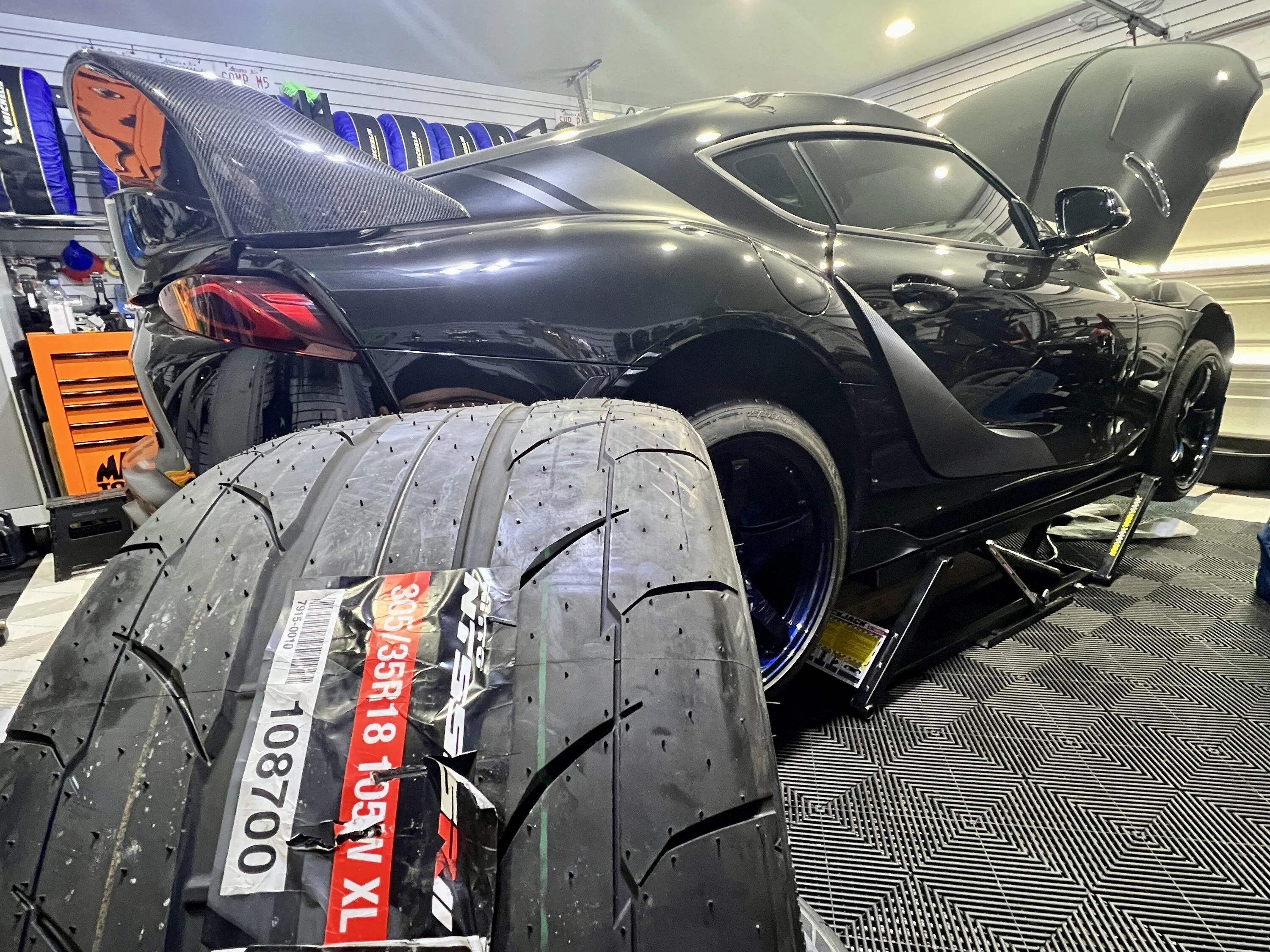

Ill throw my 2c in here
The quickjacks are super easy to use. I do use the low profile pads with BMW puck adapters. Its quick and easy to set them up as long as your car isnt super low. If it is, i suggest getting these:
https://www.obsessedgarage.com/products/bock-rubber-lift-ramps
2 of these will give you enough clearance to get the quickjacks under.
You don’t need the pucks with the quickjack, you can just center the large rubber pads that it comes with under the jack points on the car, it won’t damage them. That gives you a lot of slop when positioning things before jacking it up, it’s pretty fast/easy.

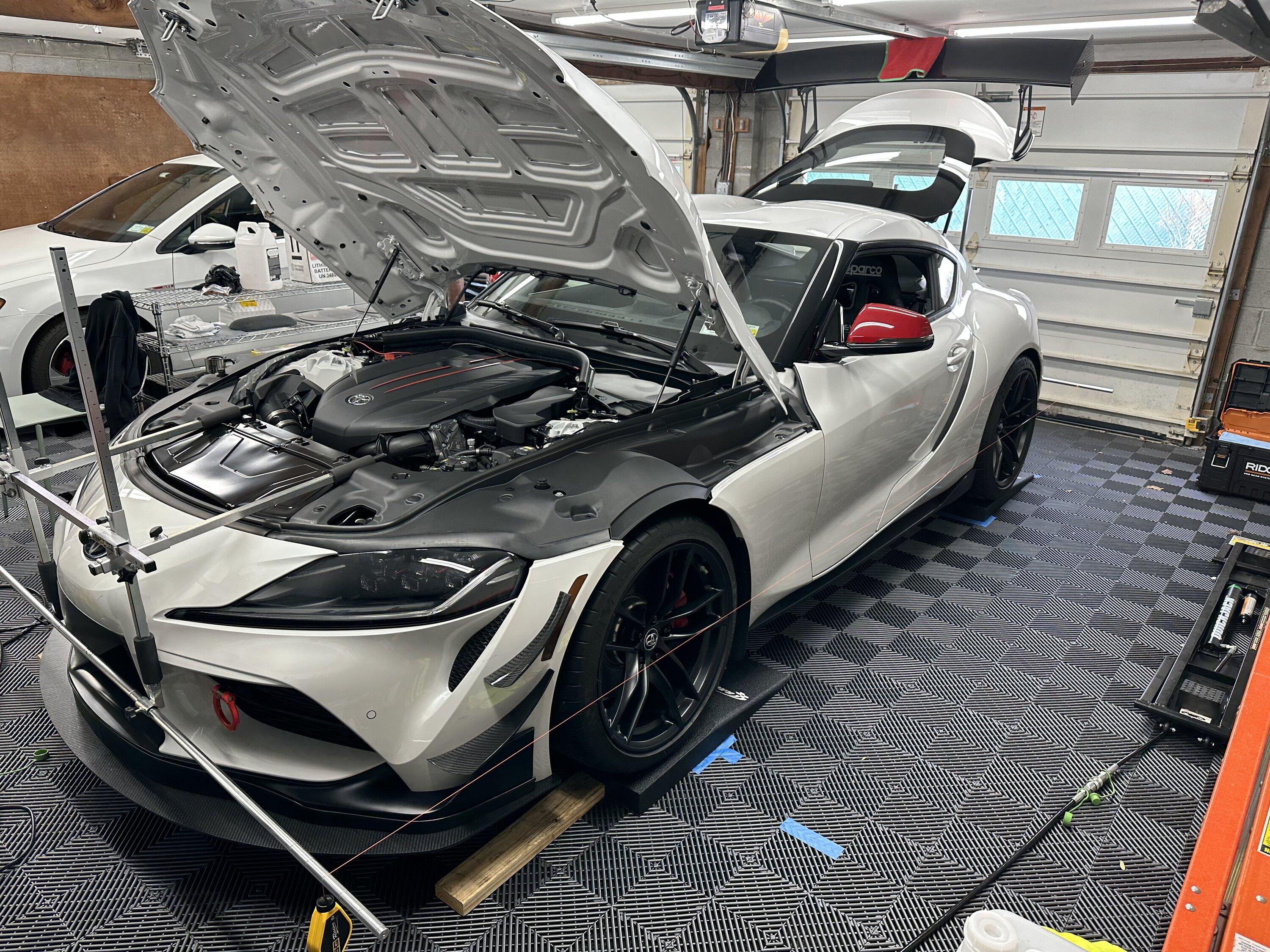

Otherwise its SO much easier to use quickjacks than jacks/stands. I love mine and will keep them until I have my next garage complete, which will have an in ground scissor lift.
$160 each?!?!? Lol. Sounds about Obsessed Garage.
or buy the 2.5” race ramps for $123 for the pair. https://www.raceramps.com/ramps/scale/p/rr-scale-2/
I have a set of four and they work perfectly.
This is what I was trying to understand.. so we DON'T "NEED" to have the puck that goes UP INTO the jack point? We can literally just have a flat rubber pad press up against that jack point housing and it won't just crumple? If that's the case that just completely sped up my lift time! This is my first car with the BMW style jack point and I thought we MUST use a puck/pad adapter that fits up inside that jack point

I found that anything light tended to slide on swisstrax. the Bock weigh 50 lbs each and dont move once placed. For me the cost was worth it.
Yea I get that. I have wood planks with a screw in the front that fit in the tile groove since I had the fronts move. The rears never move though. The wood planks and screws with all four ramps are still cheaper than rip-off garage though ;)
No pucks needed for quick jacks. I’ve lifted my Supra hundreds of times at this point with zero issues and my lift points still look brand new.
Same. This is all I use with my QuickJacks:
https://www.quickjack.com/accessories/1-5-low-profile-blocks/
The medium blocks that it came with were fine when I was at the stock height, but once lowered about 1" I had issues getting them under the front lift points. With these low profile blocks it's not an issue.
