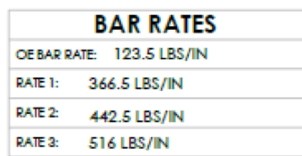

Yeah, I skipped Eibach since they didn't publish their torsion rates. :dunno:
Below are the rates straight from Eibach.
I've been running an Eibach front bar on the stiffest setting with SPL Endlinks for a year. Sadly the SPL Endlinks have started to clunk, but the bar is great.

I also have the Z4 springs and eibach front sway on the middle hole. I had it on the hardest setting for a few days but hard cornering made the outside tire hop/slide. Love it it where it is.
~ I thought of placing it on the softest setting
(rate 1) for its still a vast improvement regarding stiffness over oem.

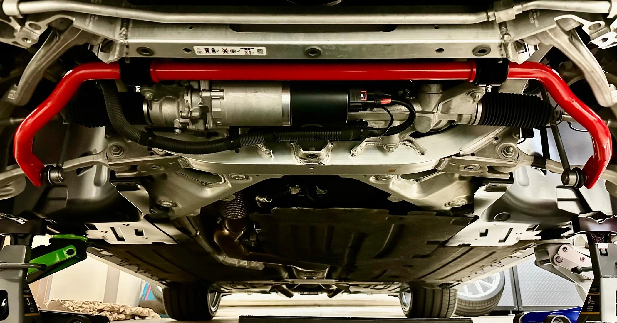

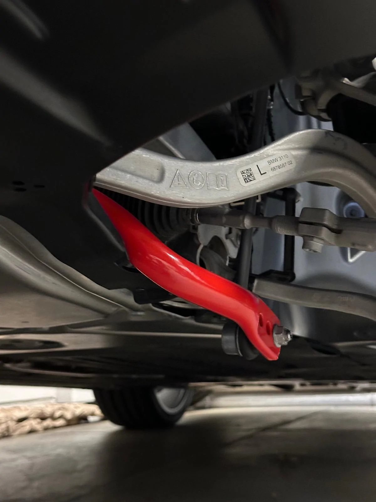

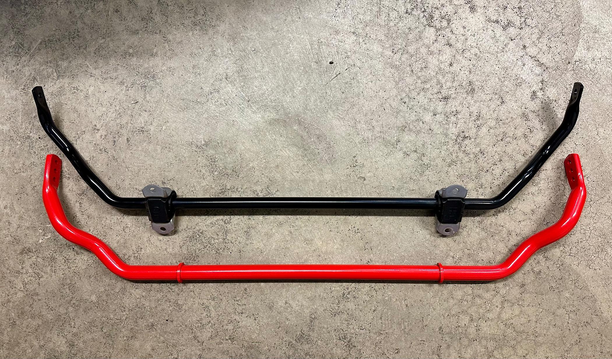

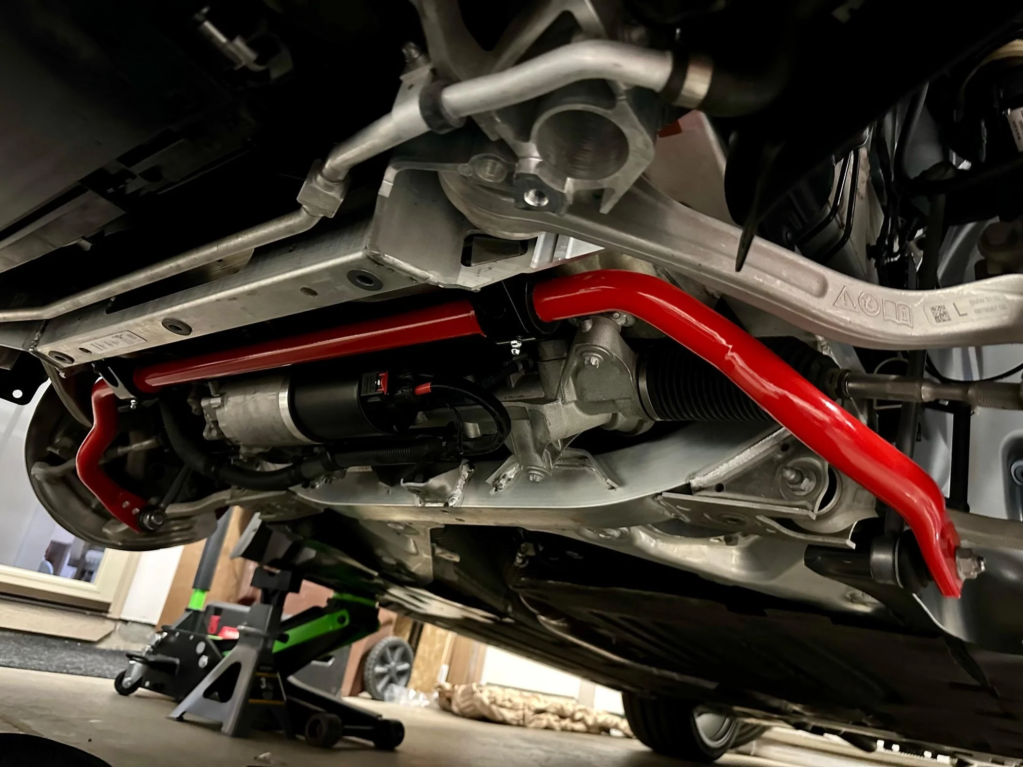

I installed the Eibach front sway bar tonight. Really straightforward with basic hand tools. I did opt for the softest setting but yet to drive it. I hope to provide additional feedback in the upcoming days.
I've attached a few pics to share.

I installed the Eibach front sway bar tonight. Really straightforward with basic hand tools. I did opt for the softest settle but yet to drive it. I hope to provide additional feedback in the upcoming days.
Glad to hear it was straightforward. FedEx delivered mine today so I'm looking forward to the install (hoping this weekend) once my ECU returns from the latest FEMTO trip. Based on everything I've read for the Eibach FSB, even on the softest setting there's a noticeable improvement. Excited to hear your feedback!

kinda like Popeye just ate his can of spinach 💪
btw, check out forsvara jack adapters for your stands.

~ Note: from everything I've read... the Eibach stamping sits upside down when the bar is installed in the correct position / direction. Seems strange I know.
From another members posting as well... see below.
