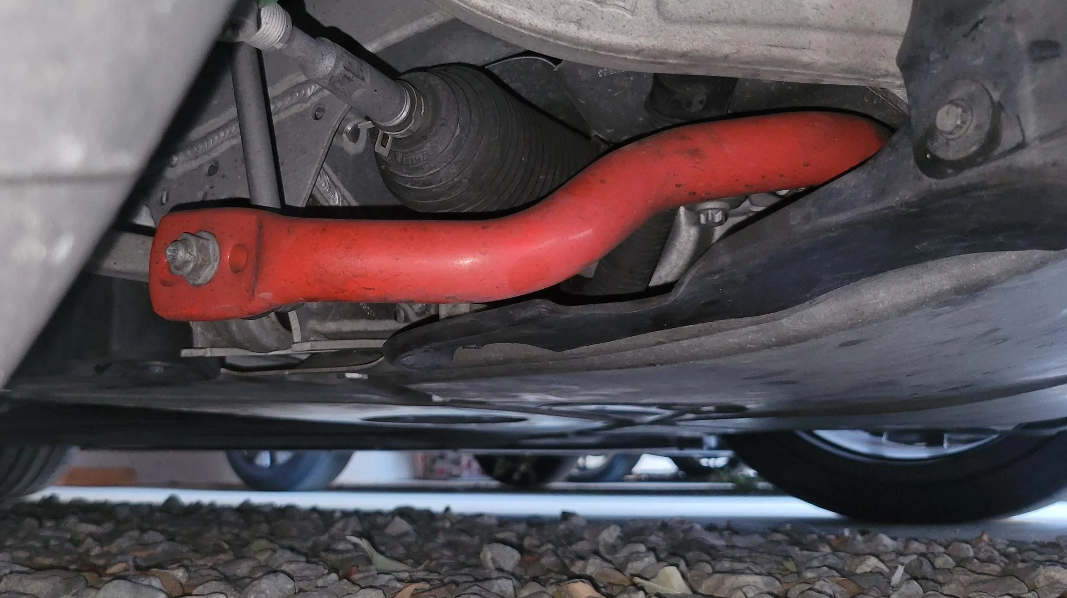

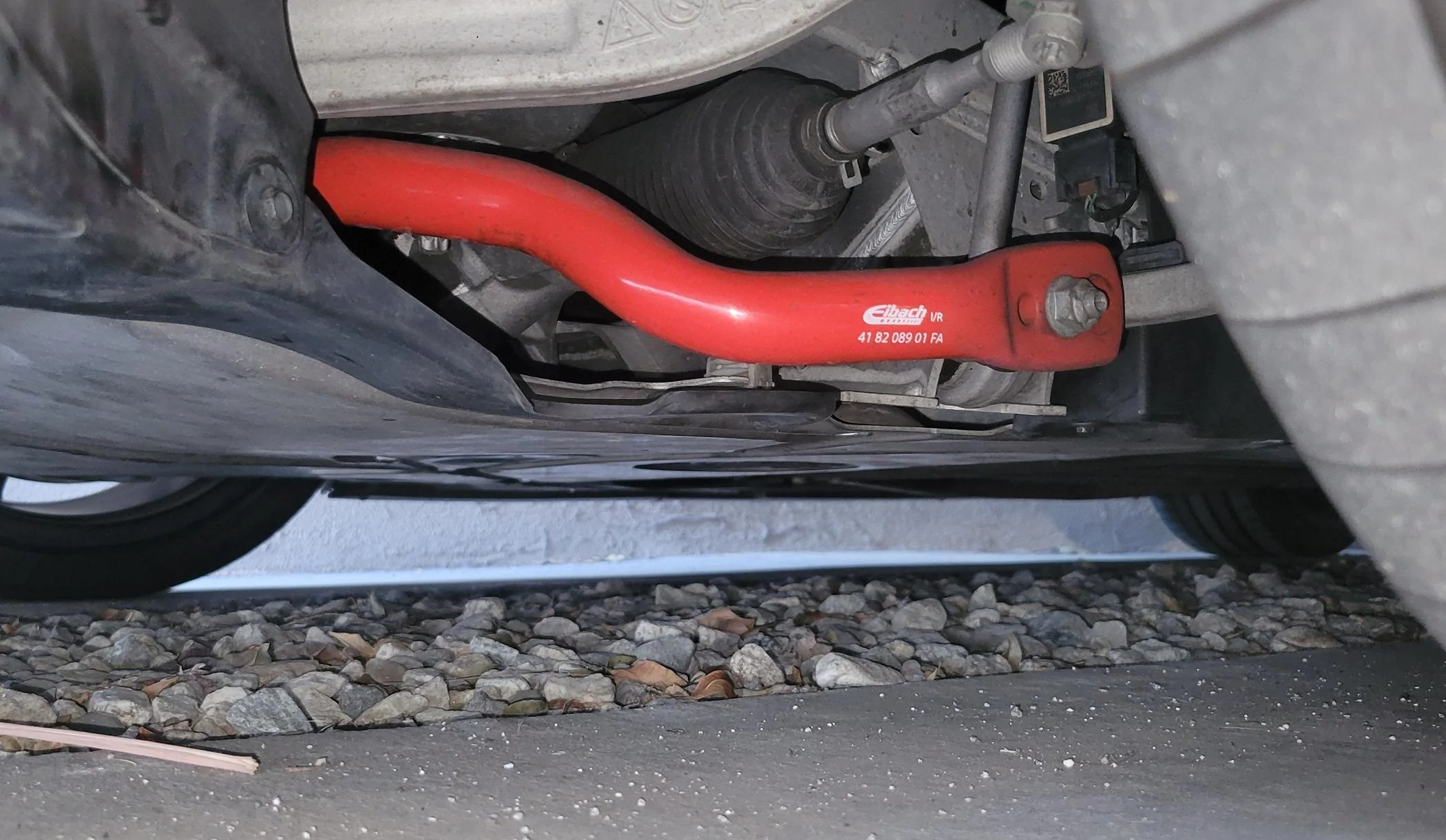

I installed the Eibach front sway bar tonight. Really straightforward with basic hand tools. I did opt for the softest setting but yet to drive it. I hope to provide additional feedback in the upcoming days.
I've attached a few pics to share.

~ Note: from everything I've read... the Eibach stamping sits upside down when the bar is installed in the correct position / direction. Seems strange I know.
From another members posting as well... see below.
Makes me wonder if Eibach changed their printing orientation. I just went to check mine out after reading this and the Eibach logo is right-side up even though the orientation of the bar looks the same as yours. I've been running it since November '23 and haven't had any issues. So strange.
~ Yeah I call Eibach and they had notes in their system that stated some stampings are upside down. Strange indeed. In the past their stamps were centered in the middle of the bar.
Such a big improvement when driving the car now ... heavier steering, quicker turn in, much more connected to the road and flatter in the aggressive turns. Money well spent imo.
