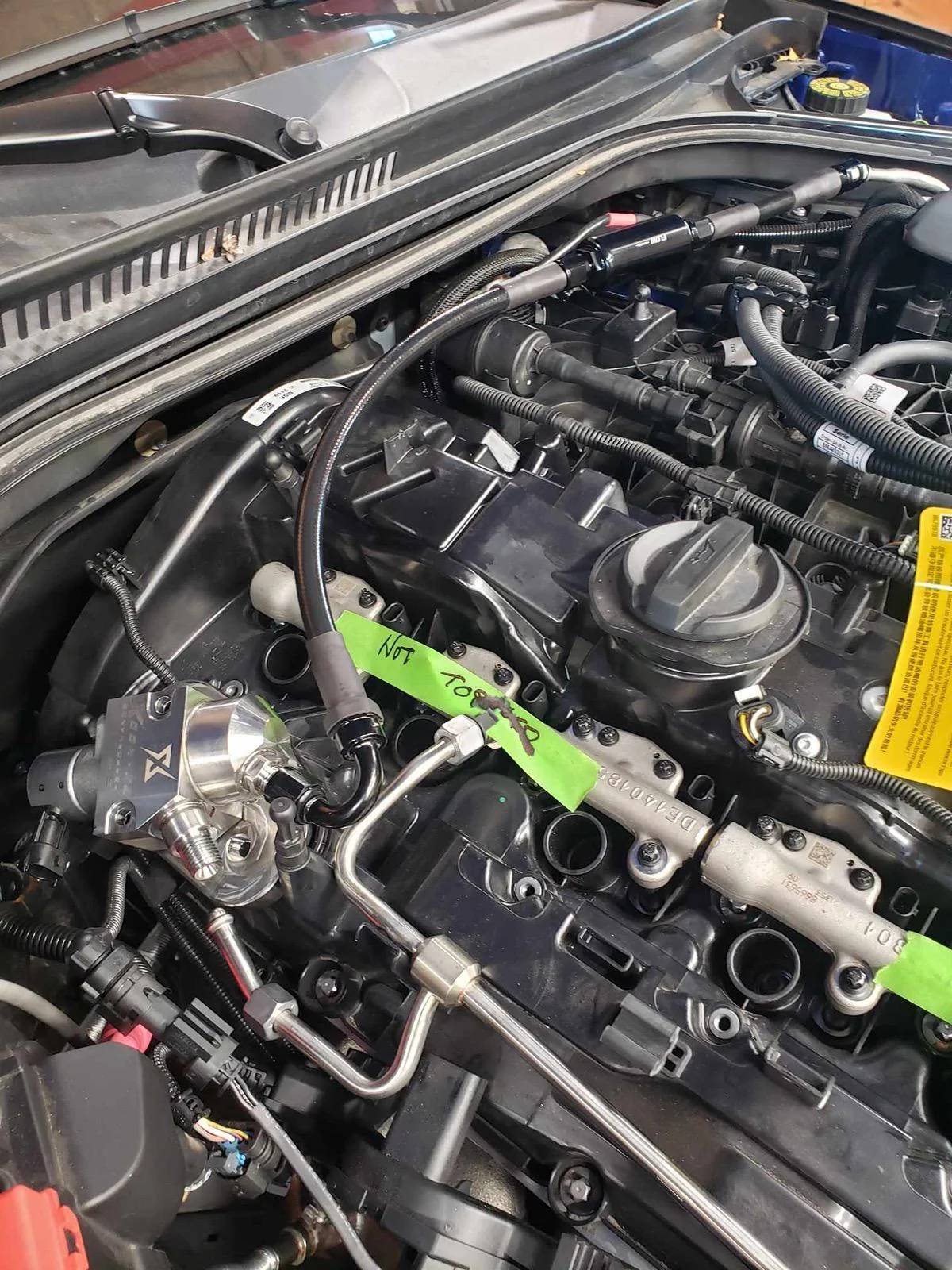

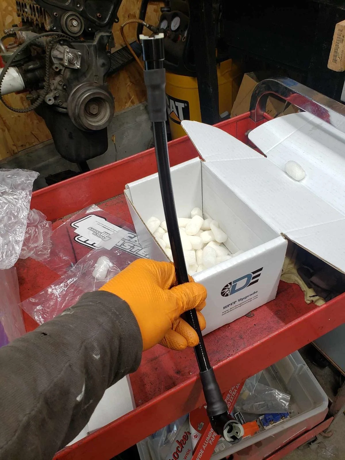

I think spool may have sent me the wrong low pressure line. Did yours look like this:
Sorry. I started a new job after taking months off and it's taking ALL my time right now.
I sent them pictures of my setup preinstall and they custom made the lines to fit. So mine don't look exactly like yours.

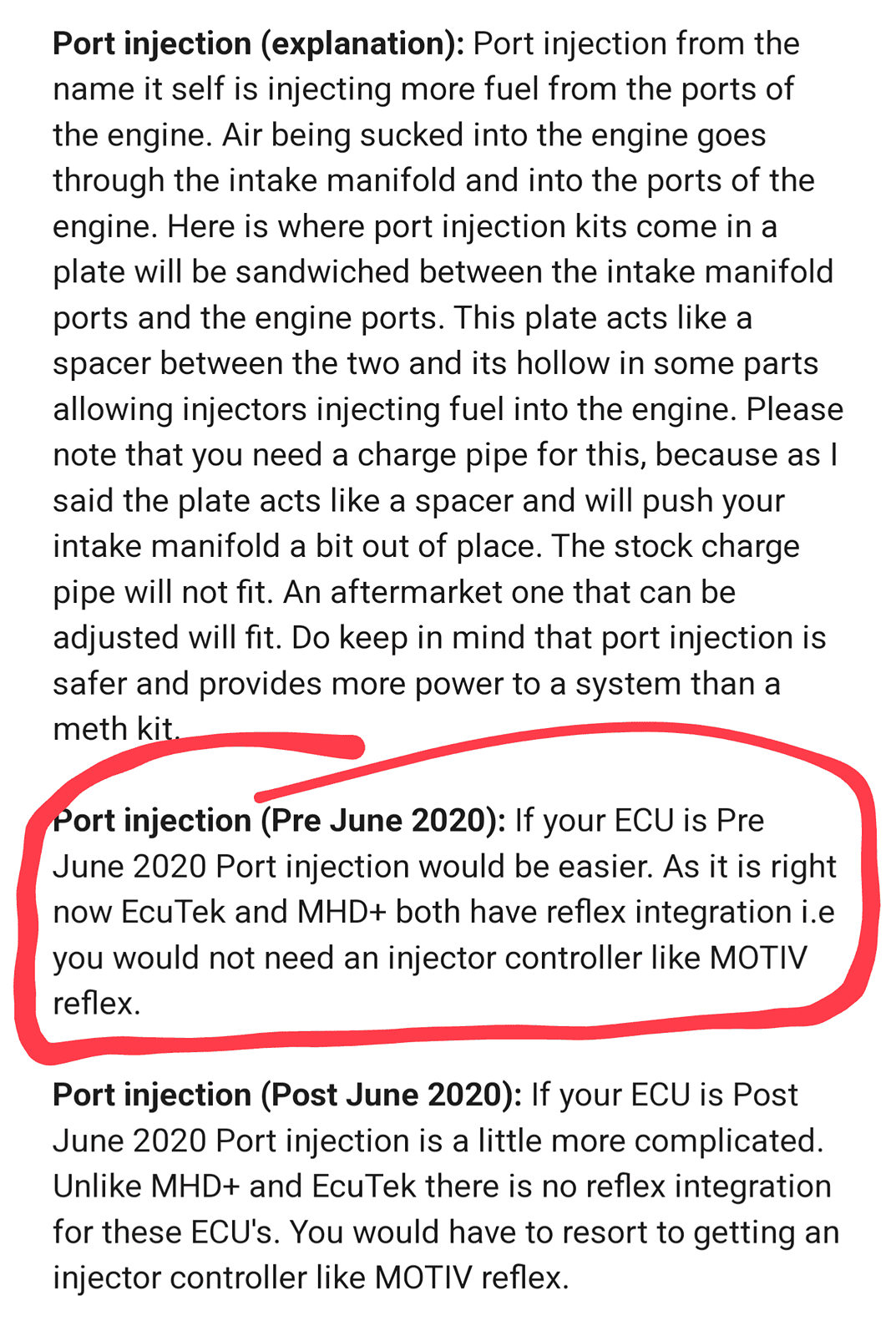

Am I reading this right? I have a 2020 LE and I'm going the pi route with. Did I waste money buying the Visconti pi kit with motiv controller?

This is... bizarre.
The ECUs are the same, it's just the unlock process that's different.

Mpower3jz said:
So I do need the Visconti pi kit with motiv controller I ordered?
Long story short: You don't need the Visconti kit, but the Visconti kit comes with everything you need to get started with port injection, excluding the fuel rail. There's other kits, such as the TMS kit. The only thing these kits do is make it much easier to install the Reflex unit. (I think Visconti has some sort of special firmware? Doesn't seem important).
At the end of the day you only really need something to control the port fuel injectors. MOTIV reflex is one method to doing that, but there's AIC, or Maxxecu, or the BM3 Rev2 (whenever it comes out).
The main benefit to MOTIV Reflex is that the tuner can talk to the Reflex through the ECU using MHD+ or EcuTek, rather than program the Reflex independently. It can also dynamically control port fuel injection.
Thanks for explaining. I went with the Visconti harness kit with motiv so I should be good. I'll be pairing it with an intake manifold, fuel rail, ID 1050's, and a lpfp.
