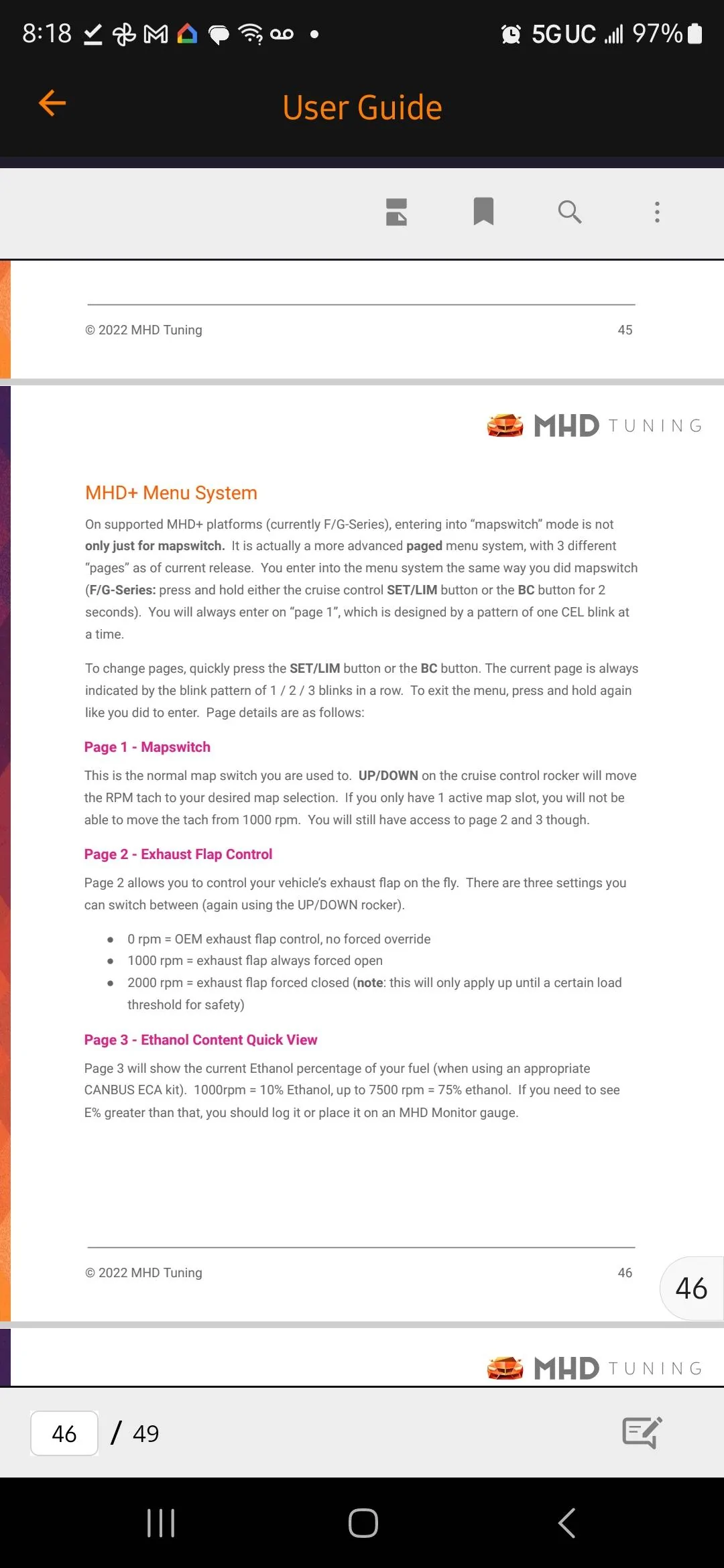

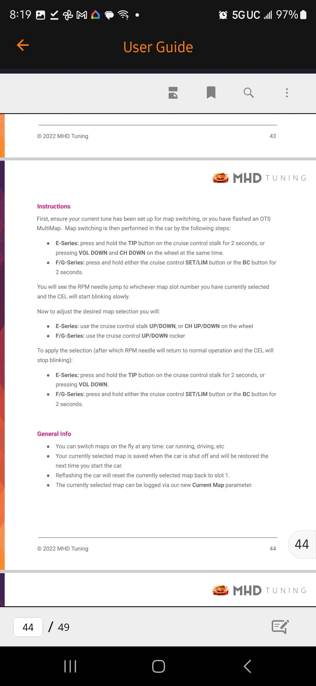

Hi guys, can anyone clarify on how to map-switch on the wheel. I tried to hold the cruise buttons when the car was on, but nothing happened even after trying to press the up/down button on the cruise side. I do have 3 maps flashed so not sure what I'm missing

Hold BC down for a couple seconds then that lets you enter map switching

How about the exhaust valve control from the steering wheel?
Not sue why MHD haven't updated their user guide yet.
The MHD manual lists how to do that. Maybe im misunderstanding what you are asking this is pulled right out of the app user manual
