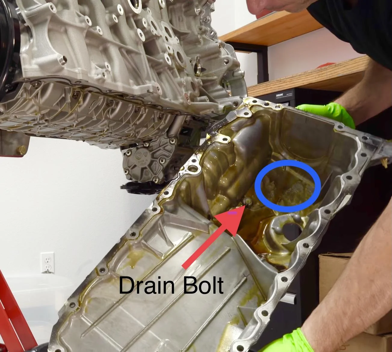

Any side Left, Right or Middle more advantageous to getting all the old oil out? Hard to tell from the parts diagram if the drain plug is on one side or the other.

Thank you. Looks like the passengers would get more out from the way the pan looks to be made.

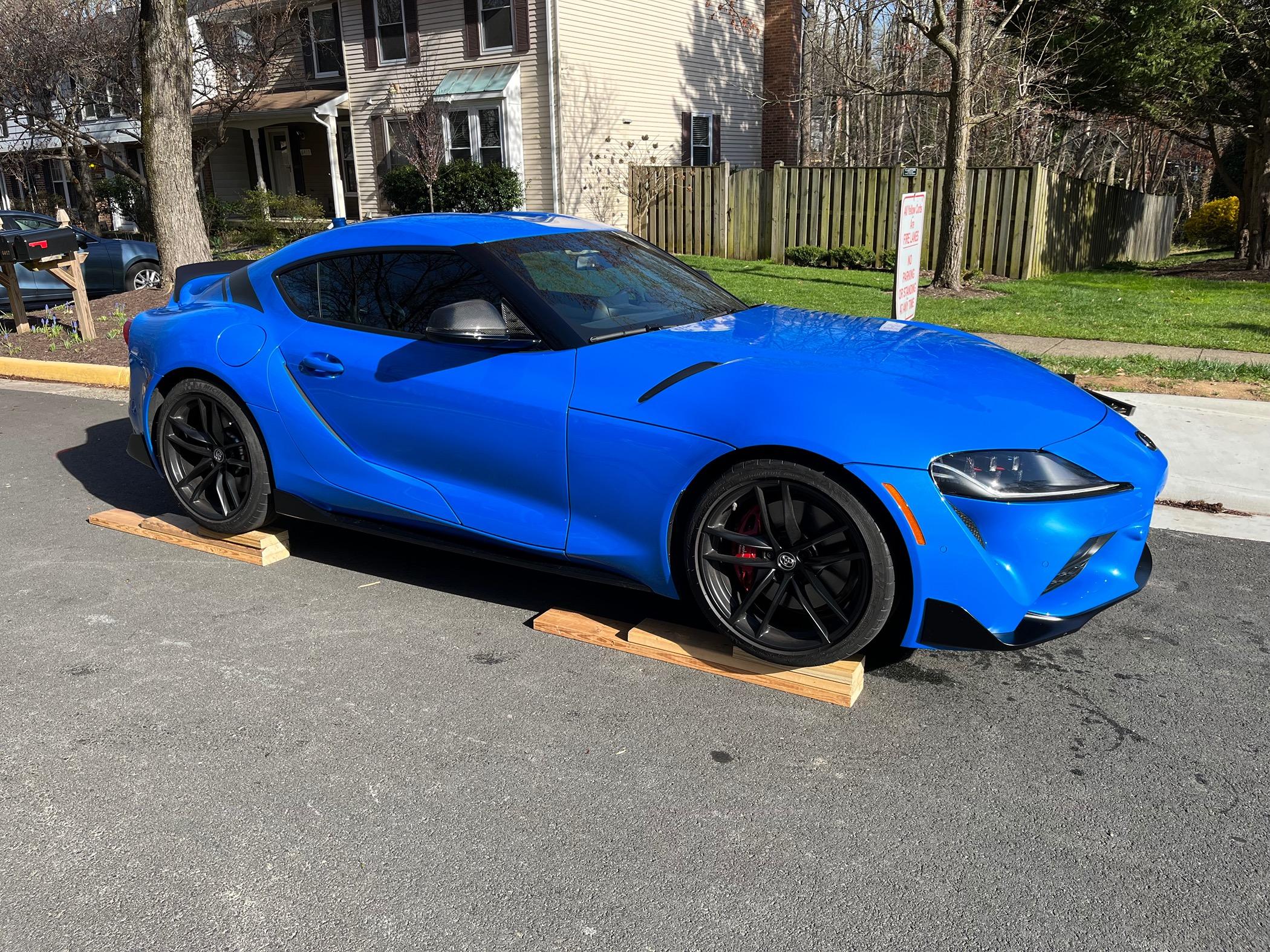

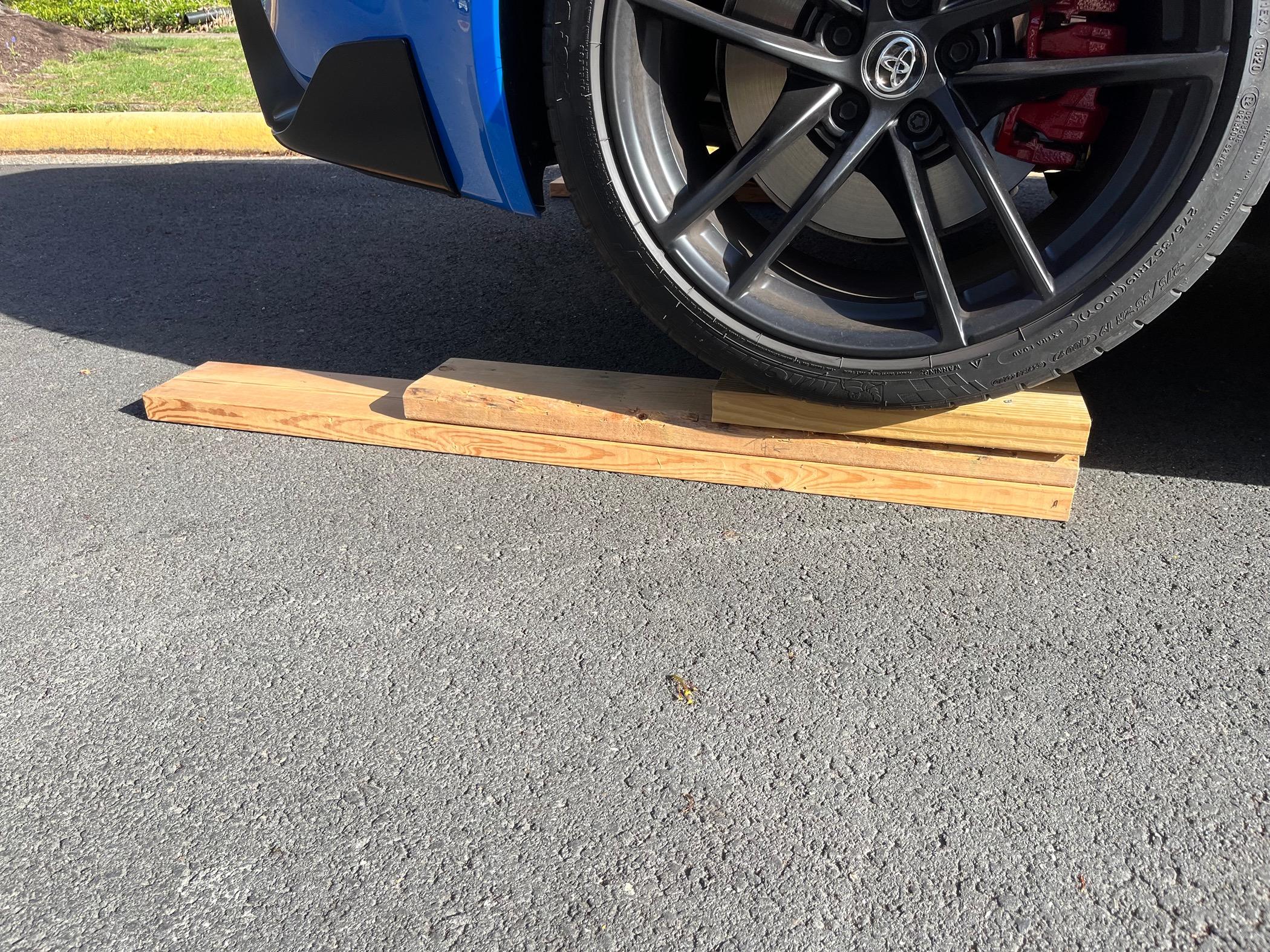

I drive the car up onto these ramps that I made with scrap 2x8 lumber. Car stays perfectly level, and no jacking required.
Very cool. Yeah I just lowered mine down to make sure to get all the oil out
