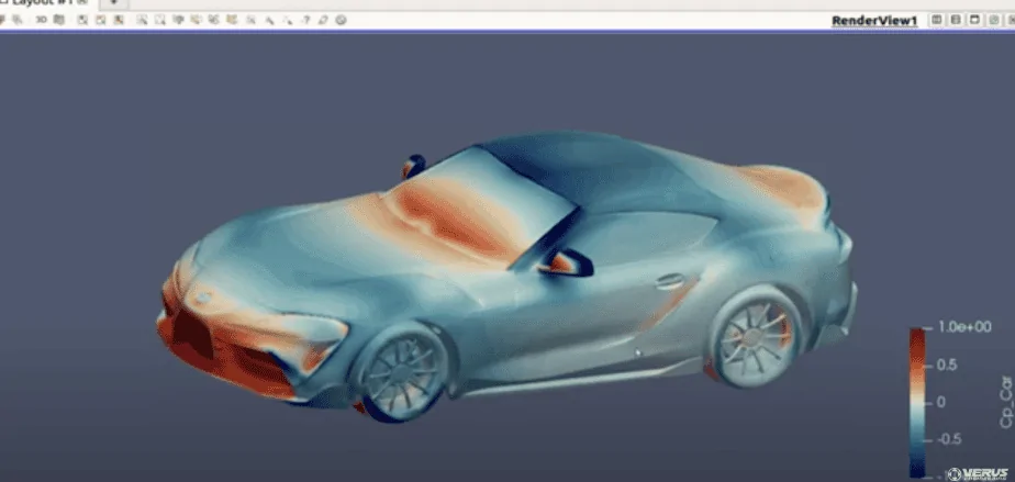

@i3igpete shared nice compilation in other thread so im reposting this here, since i didnt see it before, maybe some1 will benefit.
Looking at this, Verus V1X seem to perform even better than Spage wing? Also, UCW seem doing pretty well, 9LR being very cost effective
