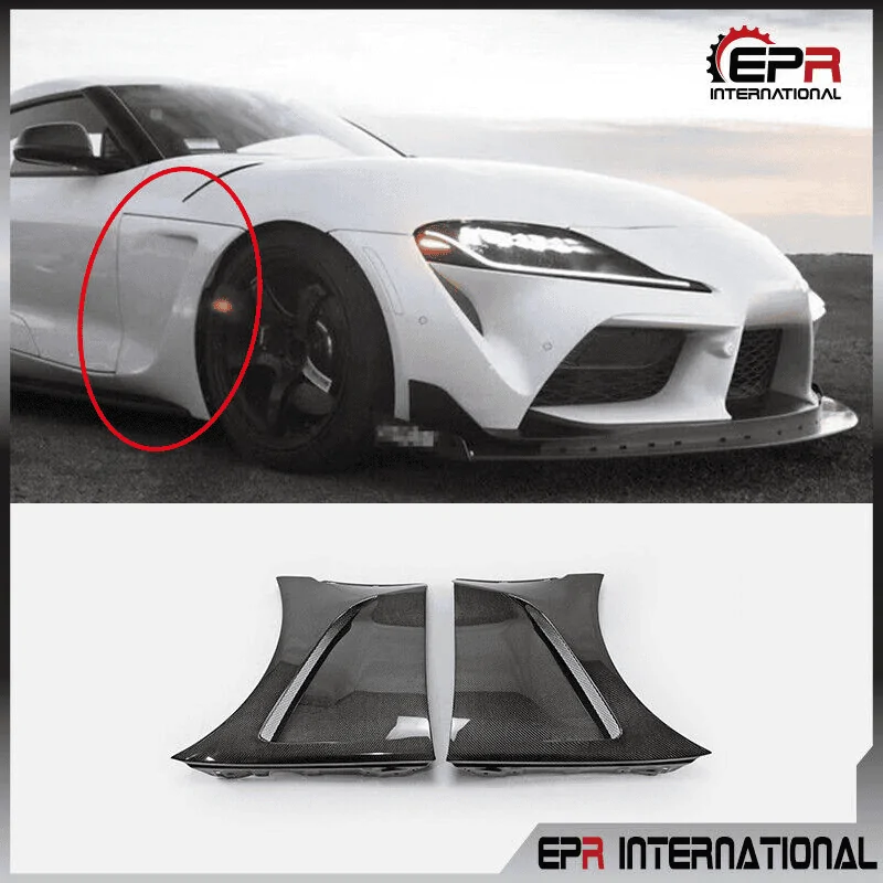

I've had my eye on carbon versions of the Sayber's.
https://www.ebay.com/itm/185559759388
From what i've seen on here, the Saybers look great but the opening is definitely huge. I was looking through this thread on here and I'm having a love hate relationship with it. Design looks awesome but as mentioned above, a lot of things can get behind there.

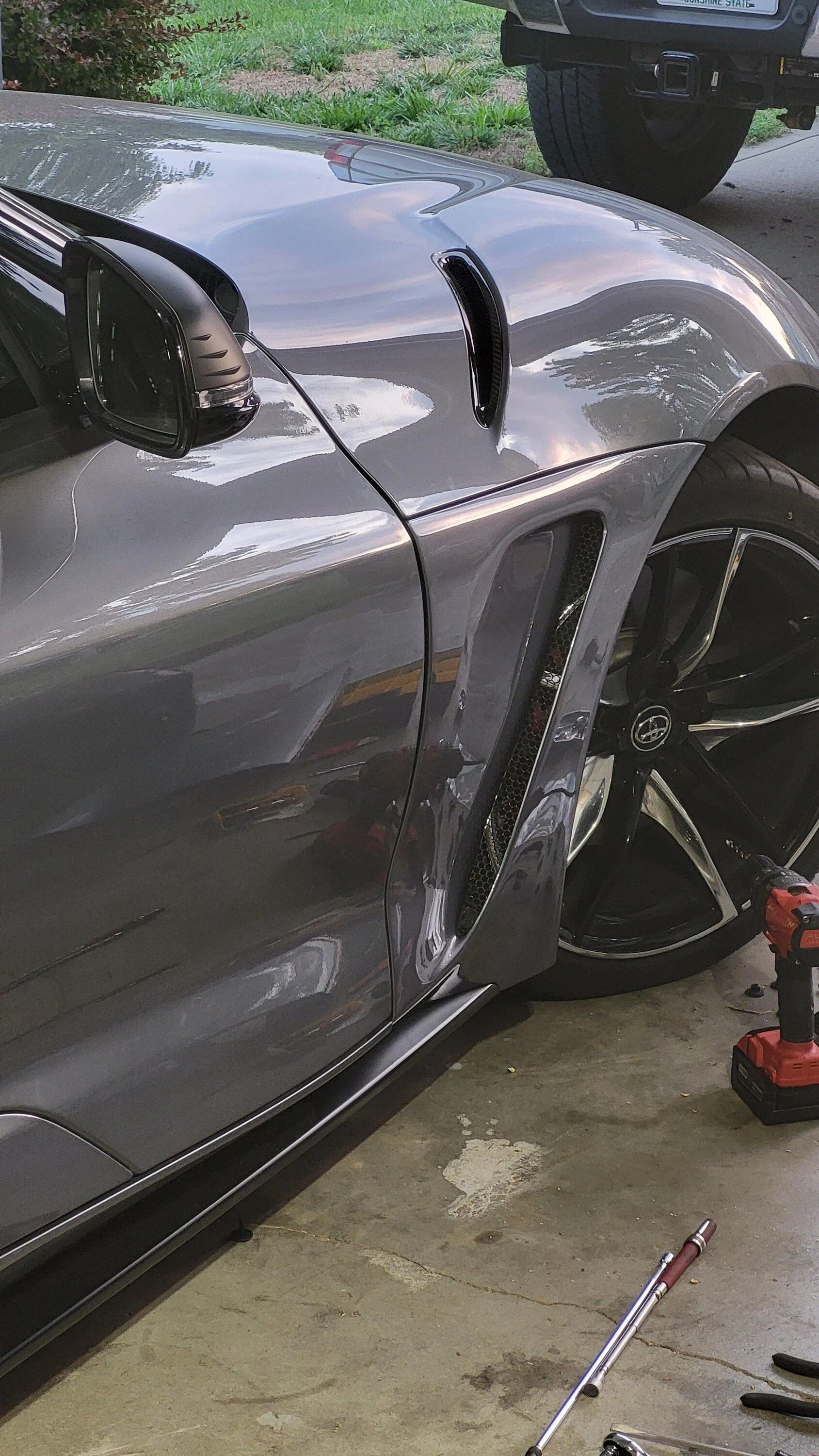

Spent around 80 hours fixing the Sayber fenders and 100% don't reccommend them to anyone.

They look really good from your picture but what is it about them you don't like? It looks like you cut the fender liner as well, were you able to do anything to cover the exposure? Nice touch too on the honey comb grille. If i were to get this, i was planning on doing the same.

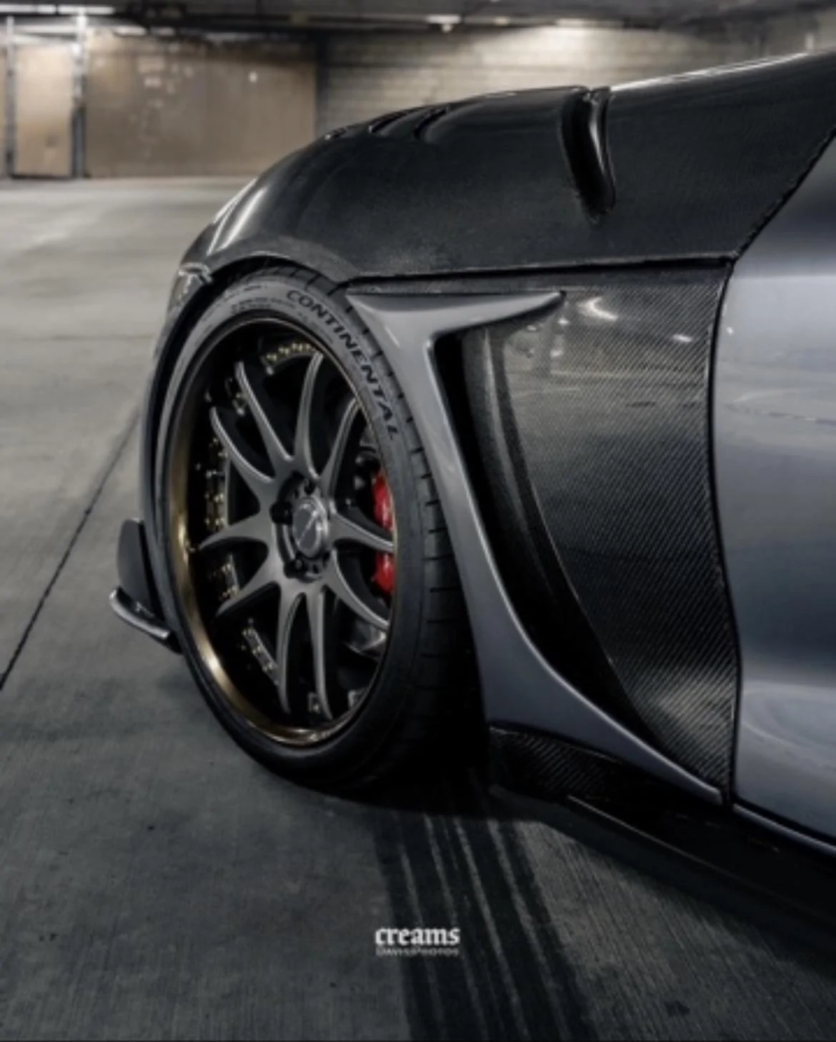

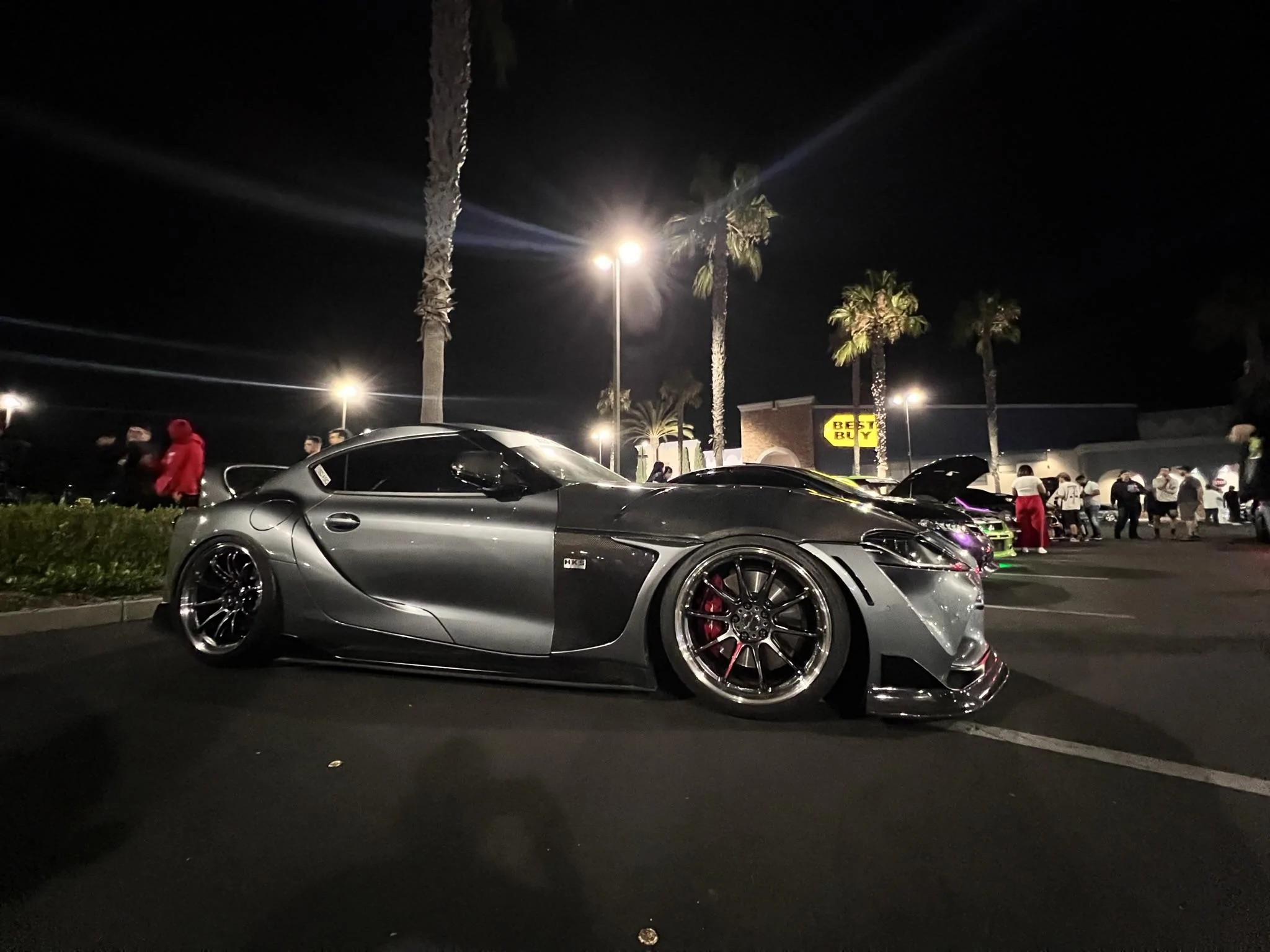

I have them.
Those look gorgeous, got any other shots of the fender up close? I'm interested in also seeing the "duct" opening as well. Did you put any grille on it or left it open? How was the install/fitment on these? I'm assuming fender liner has to get cut to accommodate the shape of the fender, was there any issue getting it attached to the fender?
If I go with this option, i'll paint the fender and cover body color and see if the shop can mold the cover to the fender to make it seem one piece.

They came in damaged. (cracked)
They fit like poo. (Stay 5ft back)
The bodylines are severly rounded off or did not line up (took some effort for sharpen up, 80% better now.)
The cut opening is severly thin and the "blade" wiggles, causing the cracking.
When I say 80 hours. I MEAN 80 HOURS of doing bodywork/paint, which I do professionally. A lot of that was reglassing the backside, strengthening tabs, sucking in the center to match the door, getting the grill fabricated, and modifiying the windshield washer resivor to clear it all.
If you were to pay a shop to spend even 40-50 hours (at $145/hour) on then you would be looking at around 5k minimum. Add on the fenders costing $900+ shipping and a shops billable materials cost... ugh! Part of the reason it took me so long to get the project done, having had them in the basement for almost 3 years now.
They offered a measly amount for a refund and blew off my attempts to return the fenders. Even if Caleb has cool as designs, my business is lost for good.
The design is great IMO but, I'd rather buy the rexpeed knockoffs. Your spending on a lot of money on what is essentially 1/2 a fender for it to not be ready to paint out the box.
The liner is out in that pic. I ended up cutting slots in the top to make it semi-functional without allowing too much gunk inside.

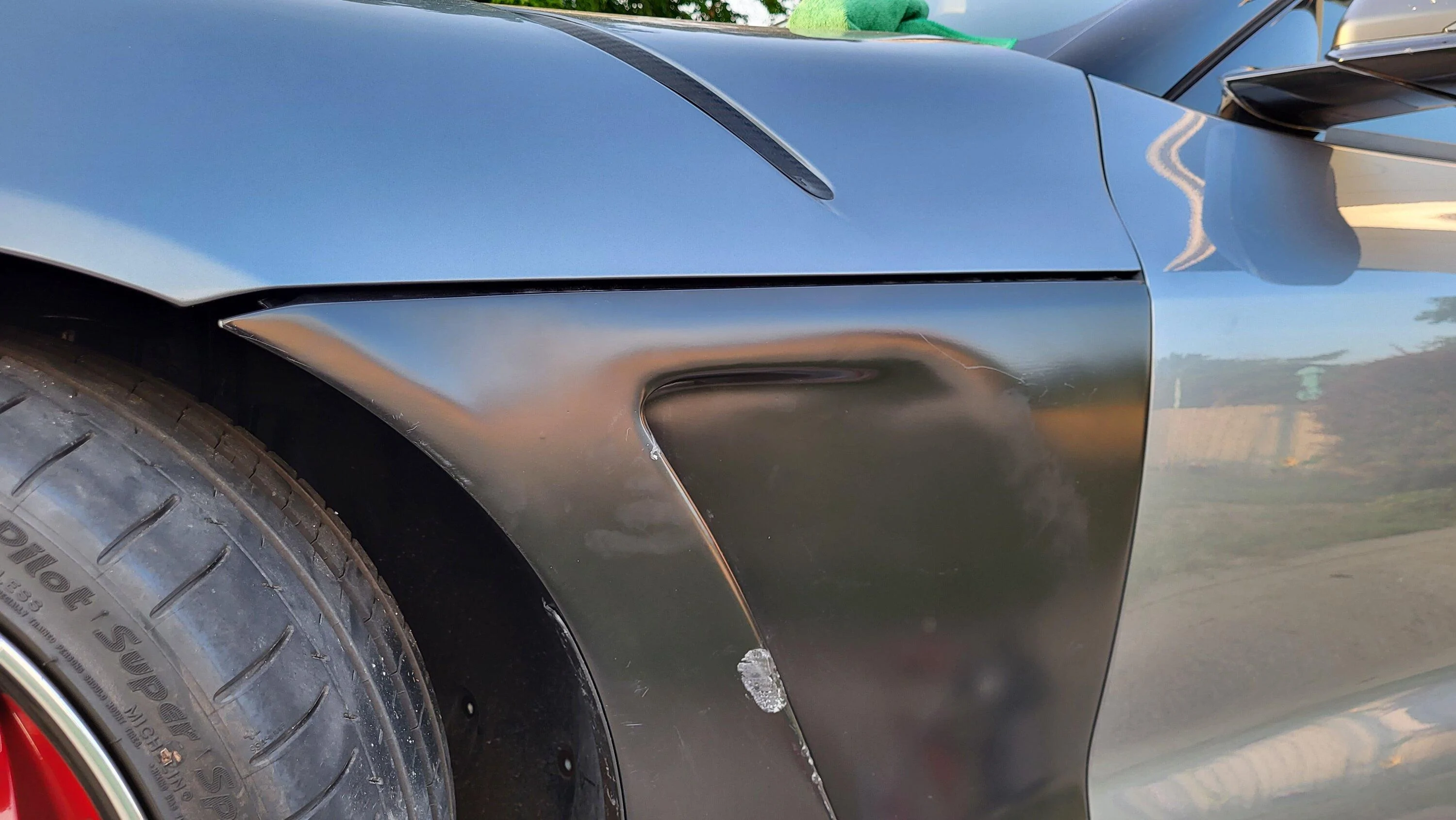

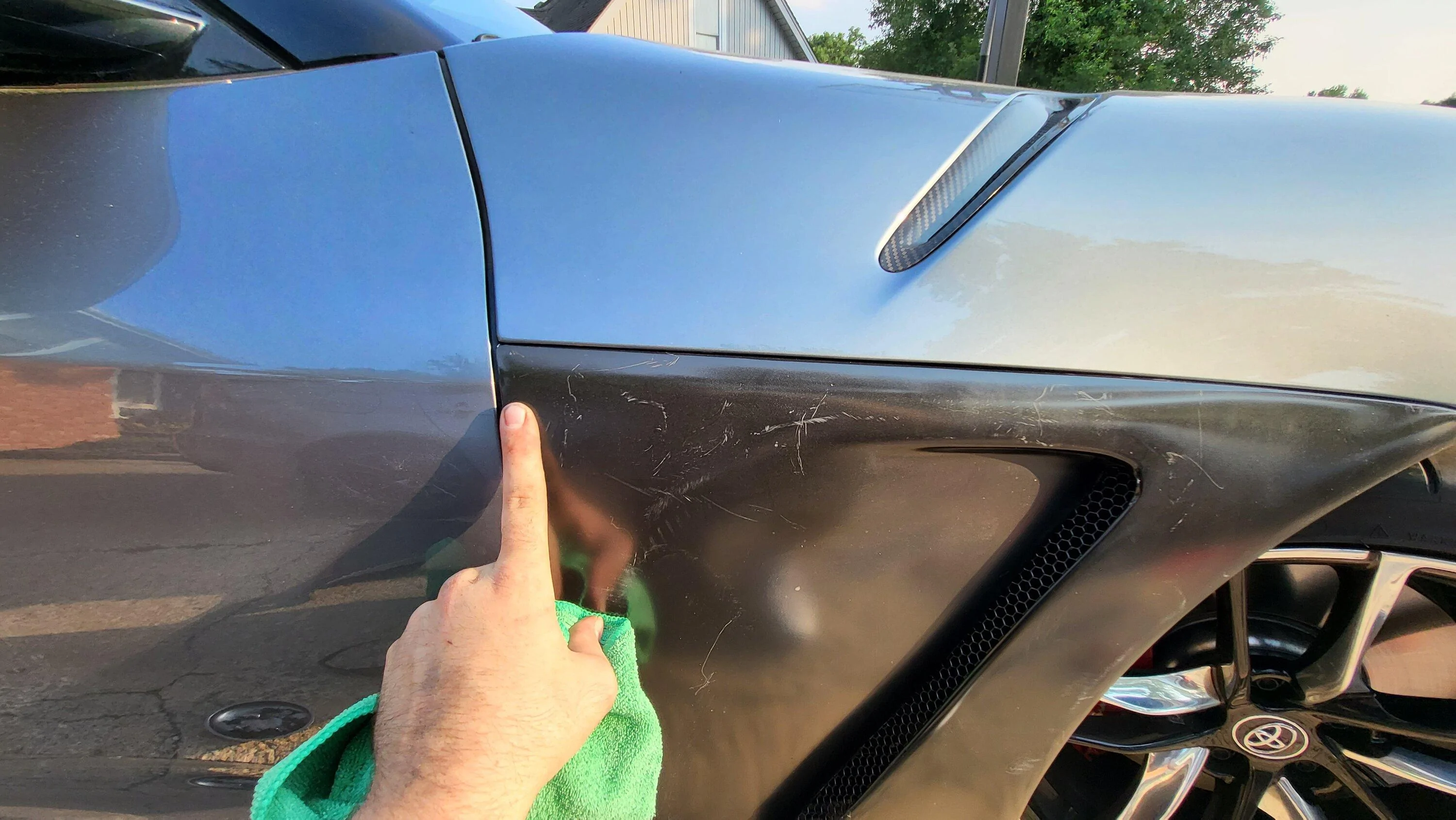

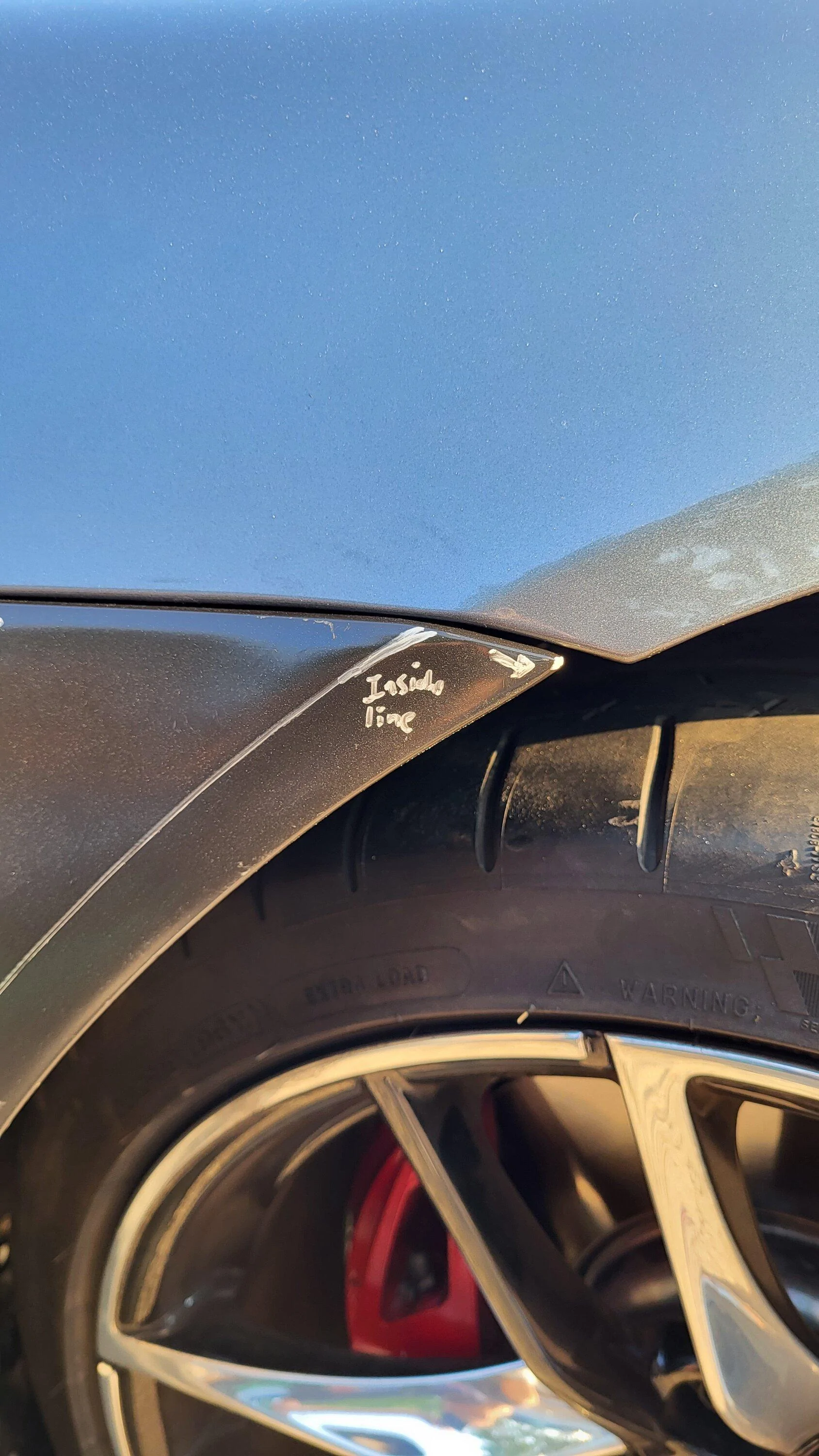

Here is some of the before pics. The black os a primer (black gelcoat) I put on it after repaing the cracks and prior to fitting. It was very hard to tell with the white gelcoat they came with. Black reveals all. Ugly!
Fitment it good other than one of the covers had a slight “twist” to it so one corner doesn’t quite sit flush to the fender. May just be the cover I received but nothing that can’t be fixed with a little two sided tape or glue. I didn’t put no grill. Left it open. No rock chips. I can take a closer picture later this evening.
