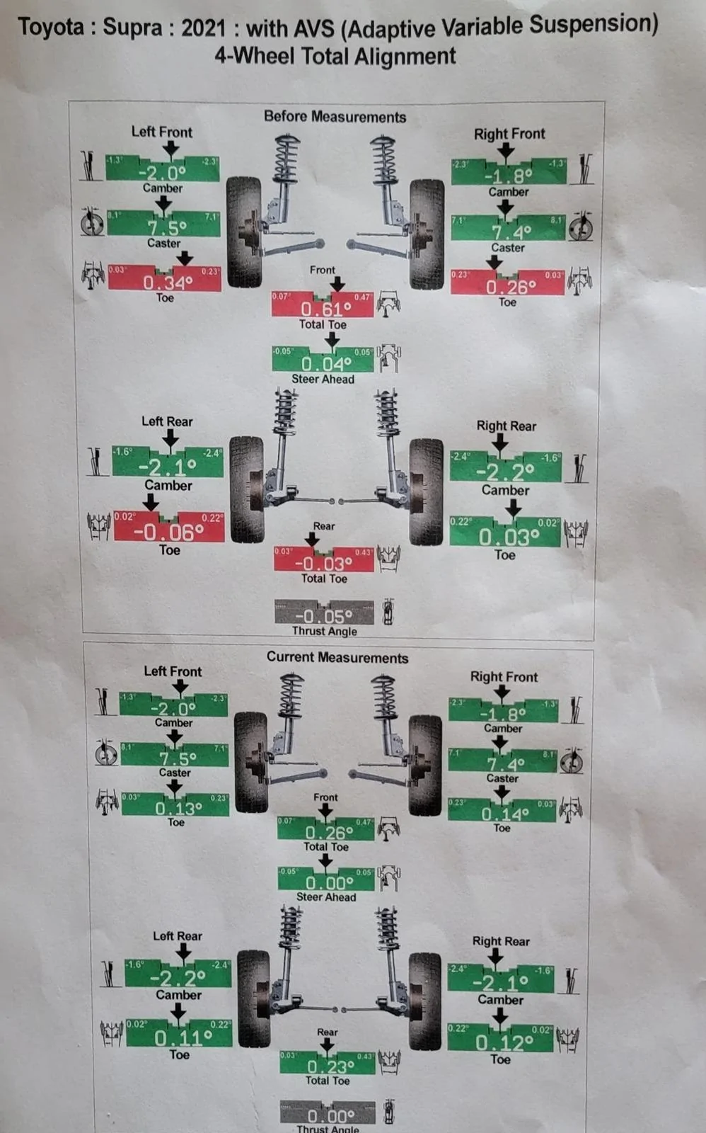

For additional info, I'm running stock suspension and wheels. Only thing is that I have P4S on the front and PSS on the rear, but I've noticed the issue since I was fully on PSS. I got an alignment as well, but no fix:

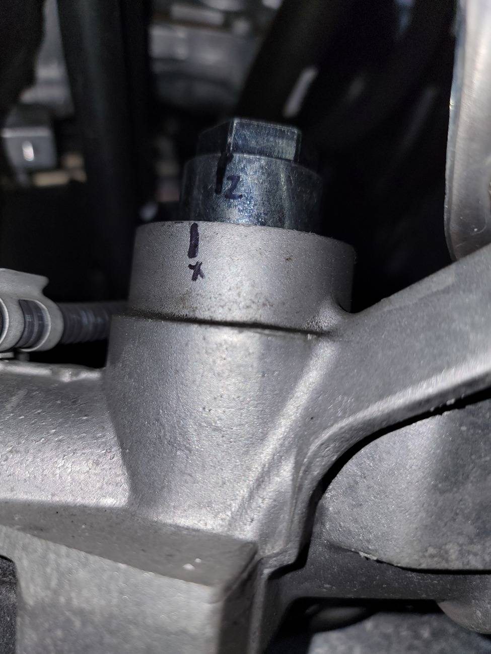

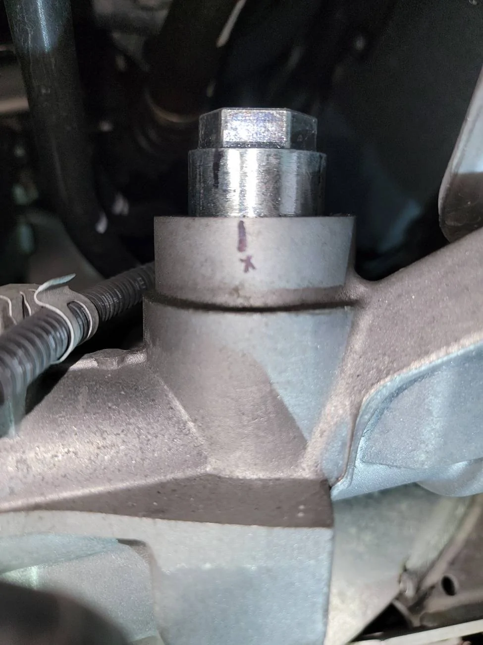

You can adjust the preload on the steering rack by tightening or loosening this on the rack. DO VERY SMALL CHANGES and see how it feels. If you tighten it too much it gets very stiff and doesn't return to center naturally.
You need this $10 tool to adjust it. https://a.co/d/bltg6HQ
This one's new to me. Do you turn it right or left for tightening? How many turns - 1/8th, 1/4th?
