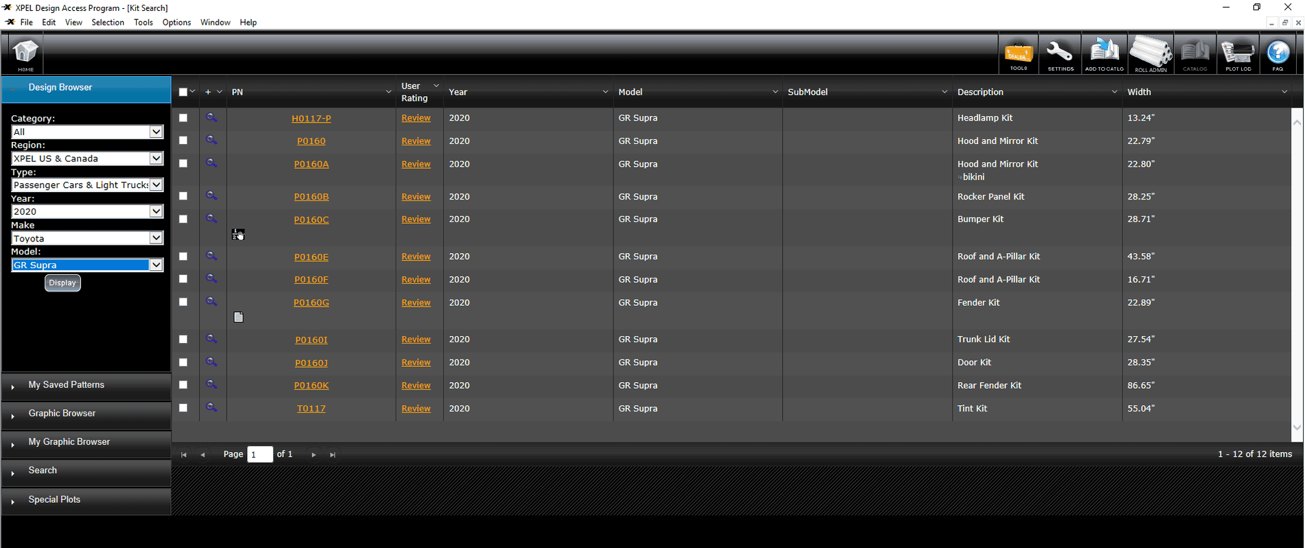

We are proud new sponsors of SupraMkV and are happy to be here.
For those of you seeking paint protection for your Supra, we now have patterns for the GR Supra in our DAP (Design Access Program) template software!

Nice! Assuming this would at least "help" with the cost a bit vs a custom installation? Is a template available for the entire car?
Thanks! The cost of a custom installation can be more than a pre-cut kit install because the labor hours for a custom install go up. But that said, pre-cut kits are the way to go as you can wrap any edge possible giving you the same amount of coverage as a bulk custom install without all the extra blade time on your paint.
@XPEL Looking at the part list I think I'm seeing everything needed for a full install, correct?
Correct. We have full patterns for the Supra. You can wrap your entire car in XPEL PPF.

Hi, I've reached out to support. They did respond in a flash.
For everyone's sake here, I'm asked to search on the site for P0160, which the picture in OP's post also suggests.
Anyhow, looking at all the patterns I'm not quite understanding the Hood and Mirror Kits.
Judging by the size and pattern, both offered patterns seem to only cover quite a small portion of the hood (and the lack of vent cut-out). Will there be a full hood option?
Front bumper pattern looks super scary! (as expected)

Great question - as the Supra is one of about a dozen cars where the hood is so massive, we don't supply a full hood kit as it's easier on sizes and shapes like this to just bulk the hood since it requires so much stretching and fitment. I would highly recommend getting full hood protection. The partial hood kit (while a standard pattern we always get) will not protect enough since the car is so low slung to the ground.
