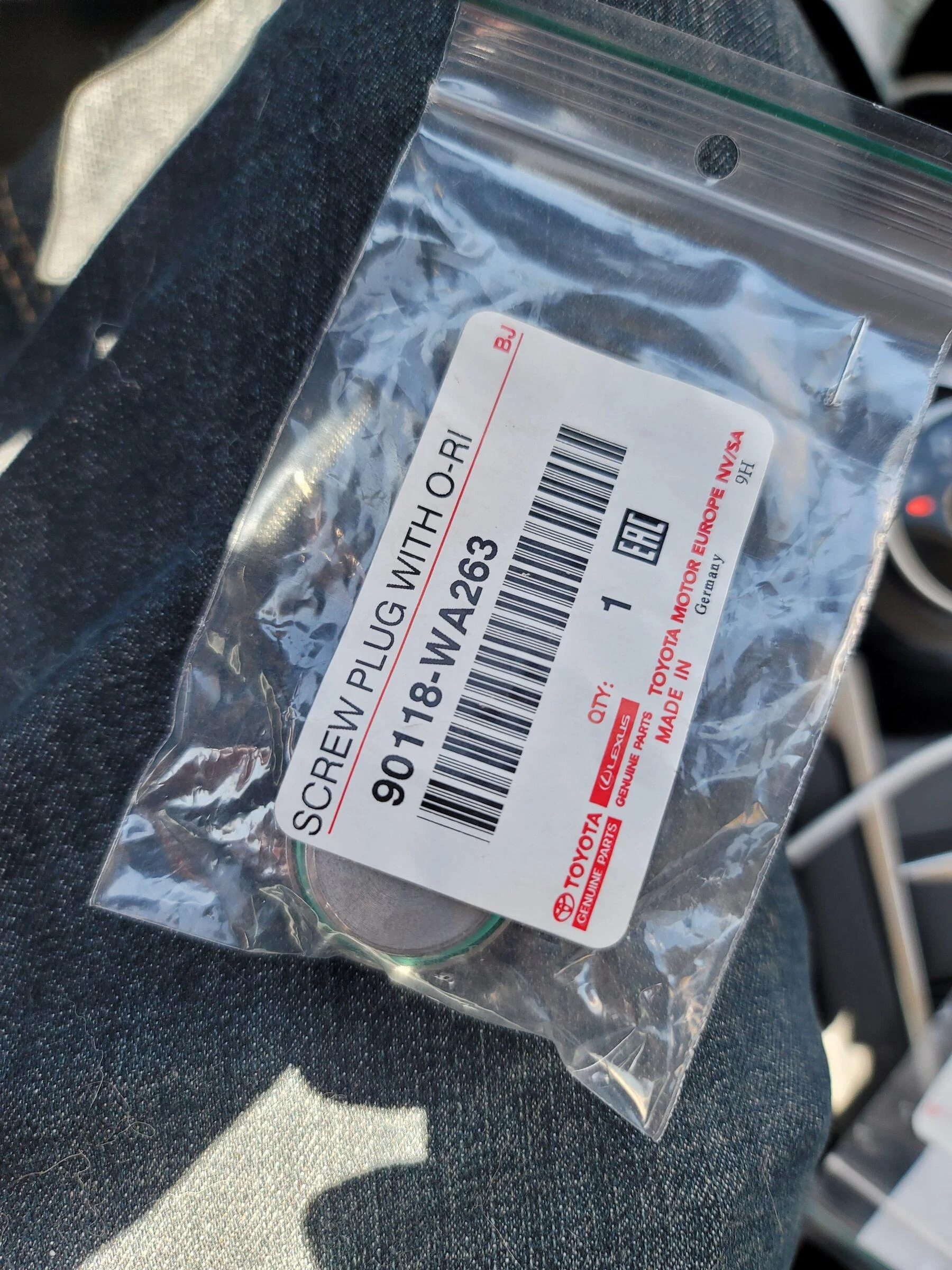

Does anyone recommend a Rear Differential oil service kit. Or have any part numbers for Refill Diff plug. Planning to do a service soon for track days.
RichSC
Rich
Dec 3, 2019
214
285
Parker, CO
2020 LE Supra #86, 2018 Raptor

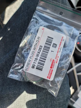

Kits I'm not sure on. I ordered the fill plugs from my local dealer and had them in 2 days. O ring comes on the new plugs and went to Redline 75W90.

Thank you for the post reply. So you ordered the Fill Plug and the lower plug where the oil temp sensor fits in the Diff ???

Just the fill plug. I'm using a pump to pull the old fluid out and to refill.

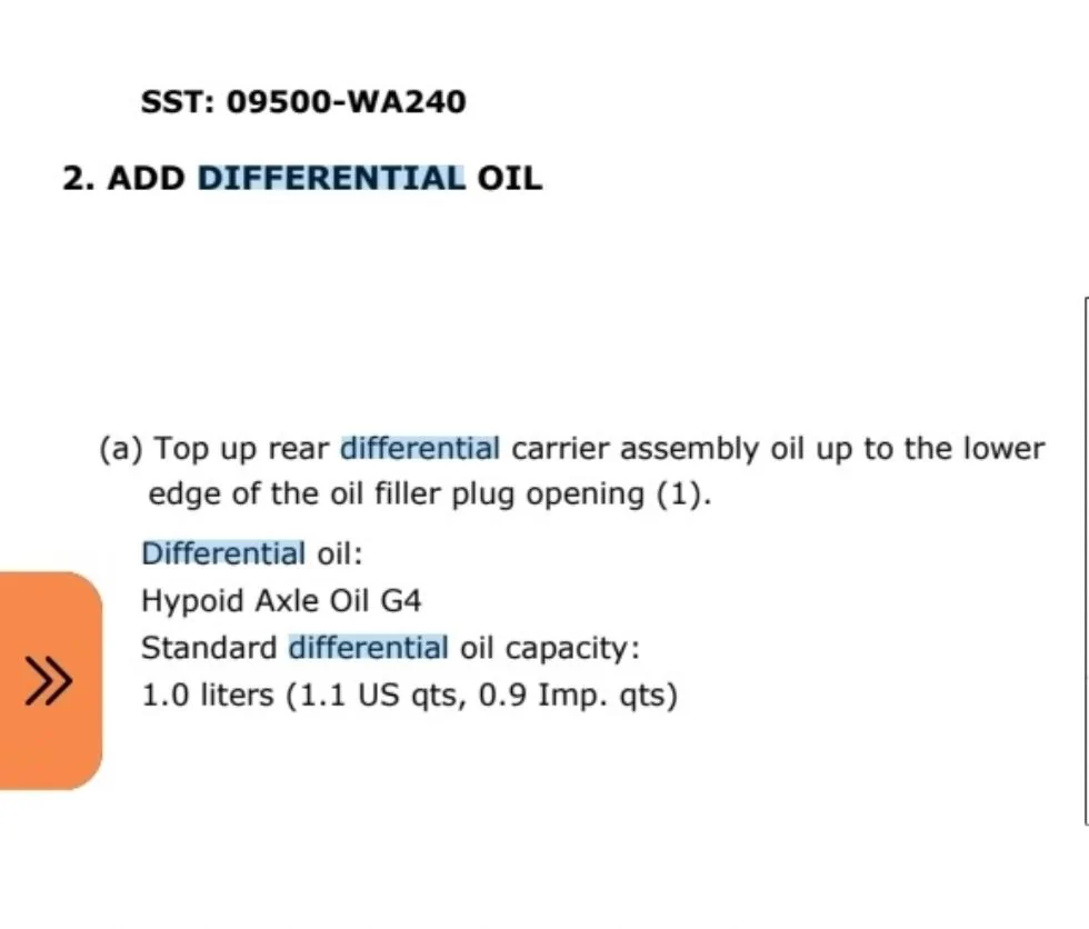

It seems like Redline 75W90 is the way to go for replacement differential oil. For those of you who have replaced the differential oil, how much did it take? I'm guessing that a quart would be enough to do the trick.

I use a quart of Redline 75-140. Per the manual it takes 1.1qt/1l.
