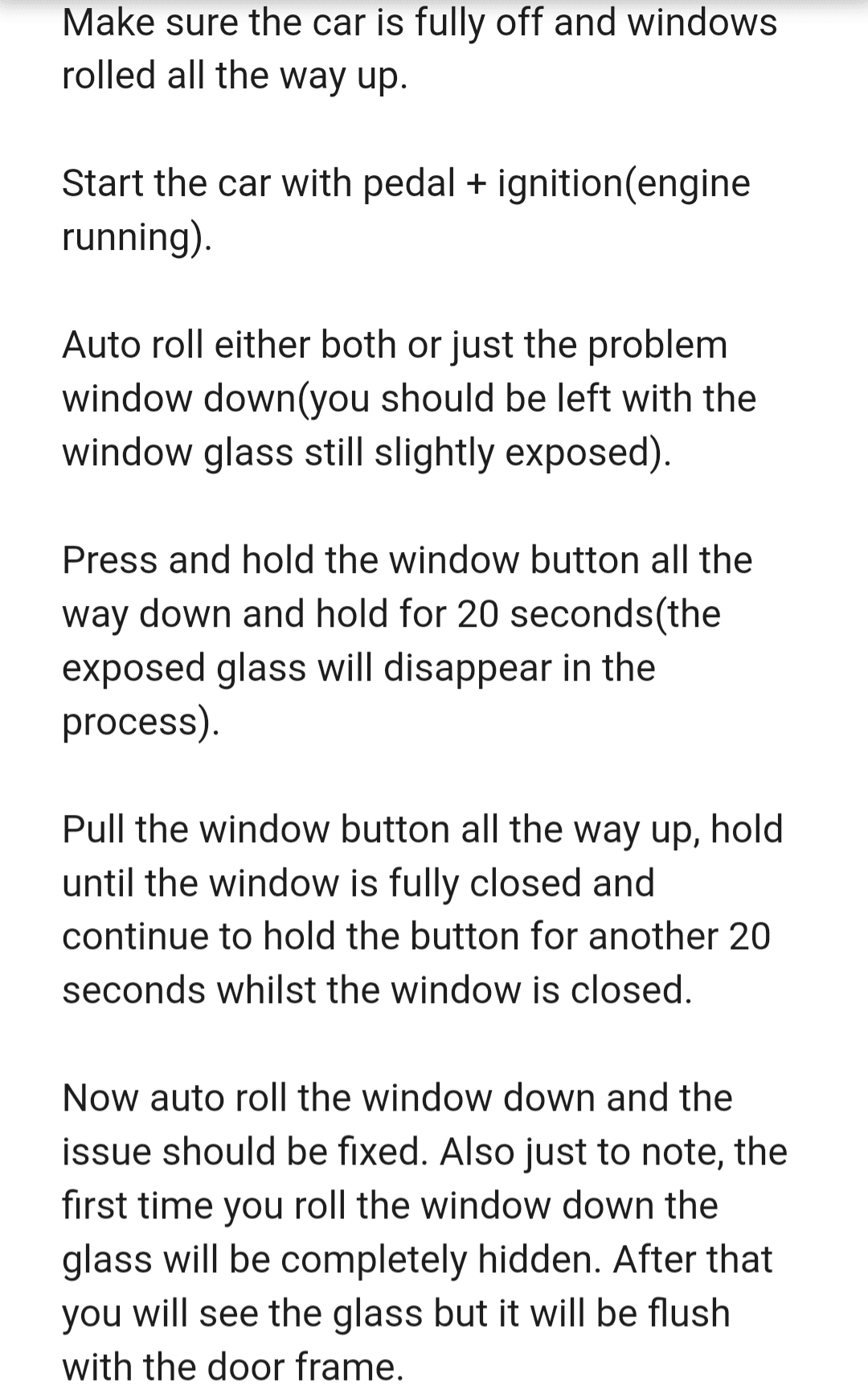

same issue here, two times this past week but only driver's side.
i just keep resetting it.

Yes same here!!! Seems like it only happens when I open a door. Usually my passenger door and the window will just roll halfway down for no reason. I've tried the reset method mentioned above multiple times and it still randomly happens.

Common problem if not reset properly. I had it too for a bit. The reset thing above works most of the time. Now it’s completely gone. Almost forgot about it until your post ;)
There’s other threads on the forum search if you type window reset.

No luck with the reset. Toyota dealer near me said i need to remove my aftermarket tint to troubleshoot this issue. My drivers window is intermittently dropping about halfway when I park/close the door.
