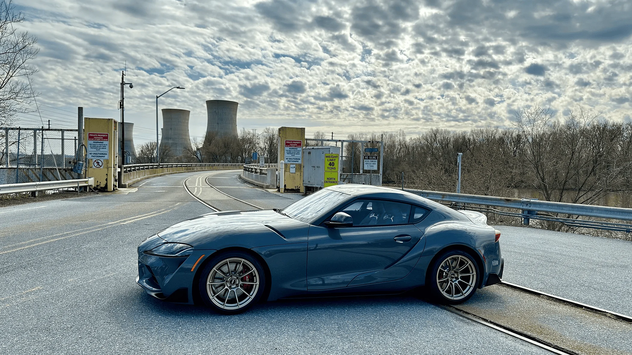

Hi Apex,
I've been looking at SM-10s for a while. I have a turbulence gray and was wondering which size wheels to go for? This is my first time trying to find wheels so all the keywords/offsets/numbers are a blur to me.
I have been leaning towards the bronze vs the anthracite gray.
edit-- I also would like a more "aggressive" look, would doing 18 in the front and maybe 19 in the back work or how does that work out?
Thanks for reaching out!
I'll shoot you a PM so we can dive a little bit further into recommendations for you without cluttering the thread.

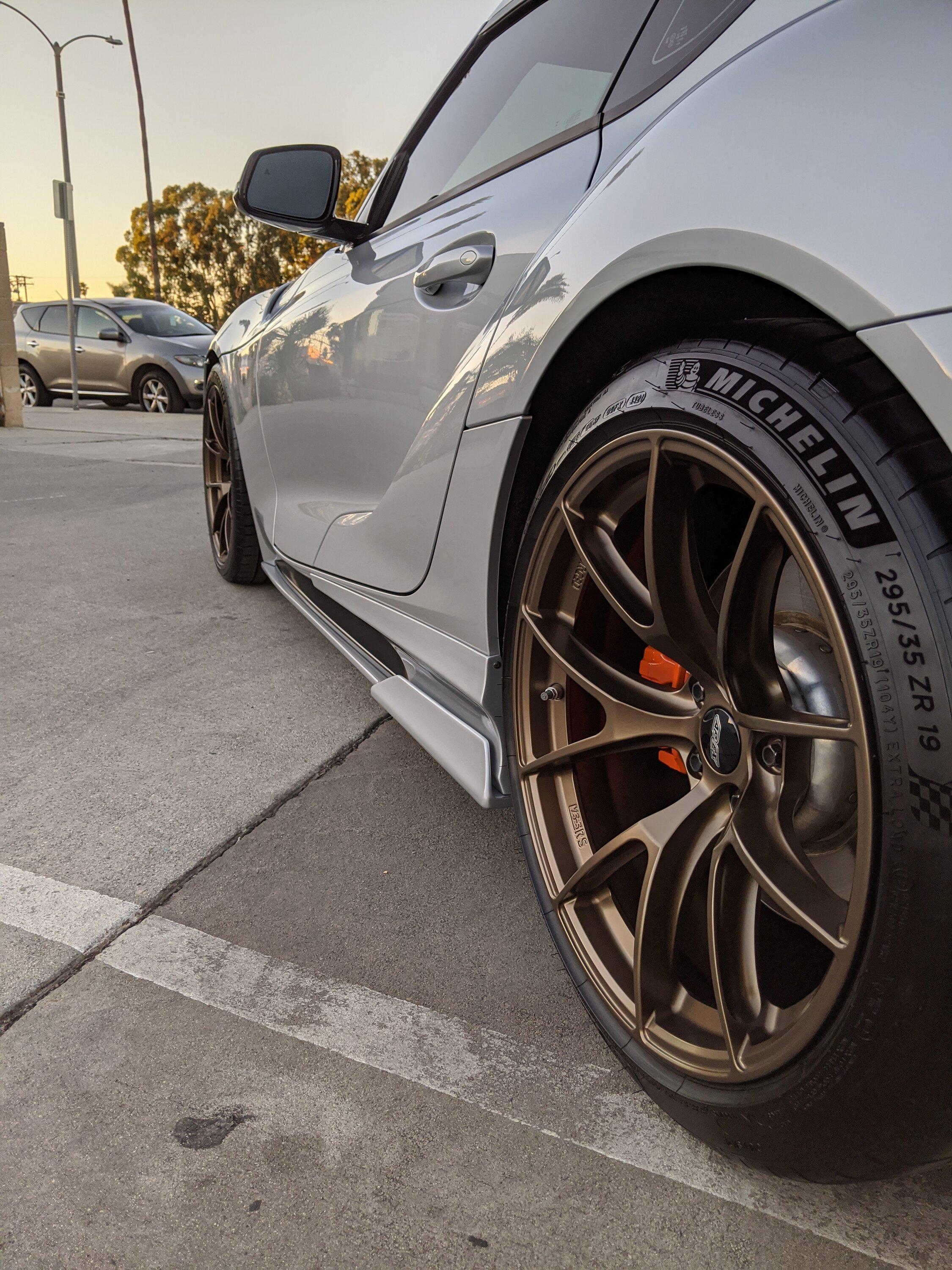

Had these for a few months now, lovin' em.
APEX VS-5RS in satin bronze, on stock suspension and brakes
Fronts: 19x9.5 +25, Michelin Pilot Sport 4 S 265/35/19
Rears: 19x11 +40, Michelin Pilot Sport 4 S 295/35/19
They are ceramic coated, so there is a slight shine to them here.
Sorry off topic but what lip/side skirts are these???

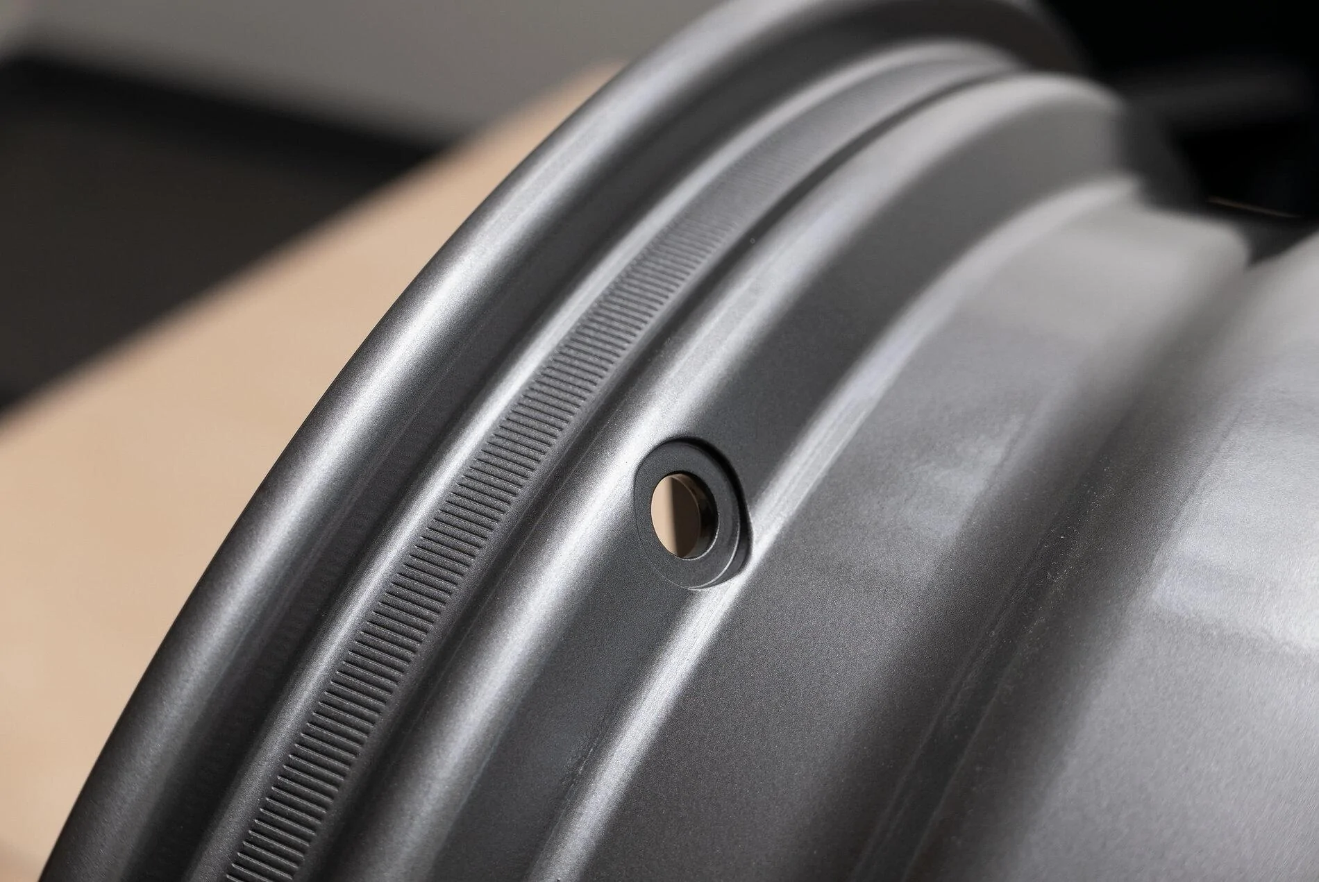

Both the inner and outer portions of our SM-10 wheels have knurling along the bead seats. These are small machined cuts that run along the surface of the seat:
This knurling helps keep your wheels and tires balanced on track or in situations where you are braking heavily or accelerating rapidly. On a standard smooth bead, the tire can slide along the surface over time which gradually unbalances the wheel and tire. The knurling helps reduce this slippage ensuring your drive home from the track is smooth.
These small cuts can make getting a seal at the bead when initially mounting the tires more difficult. We generally recommend airing up the tire that is leaking to the maximum pressure specified on the sidewall for a few minutes to help seat the bead. You can drive slowly around the block if needed at the higher pressure to help them seat as well. After a few minutes, deflate the tire to the recommended PSI for your car. This fixes the leaking beads without the need for any bead sealer in the cases we've seen so far. Your car should be safe to drive and you can monitor the tire pressures as needed for the first week or so just to be sure.
Let us know if you have any other questions!
-Tom
