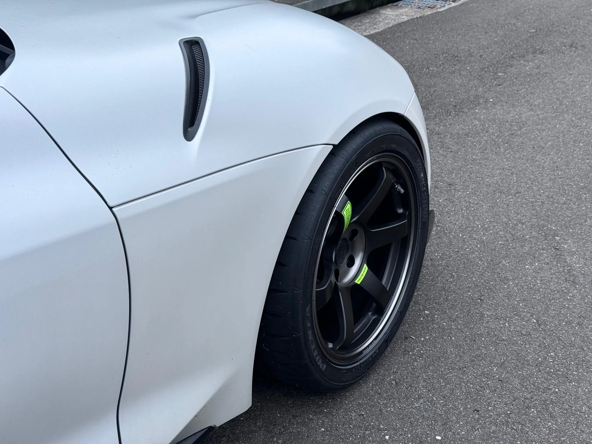

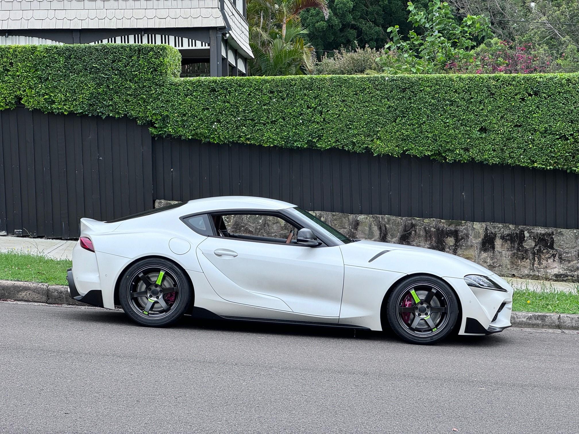

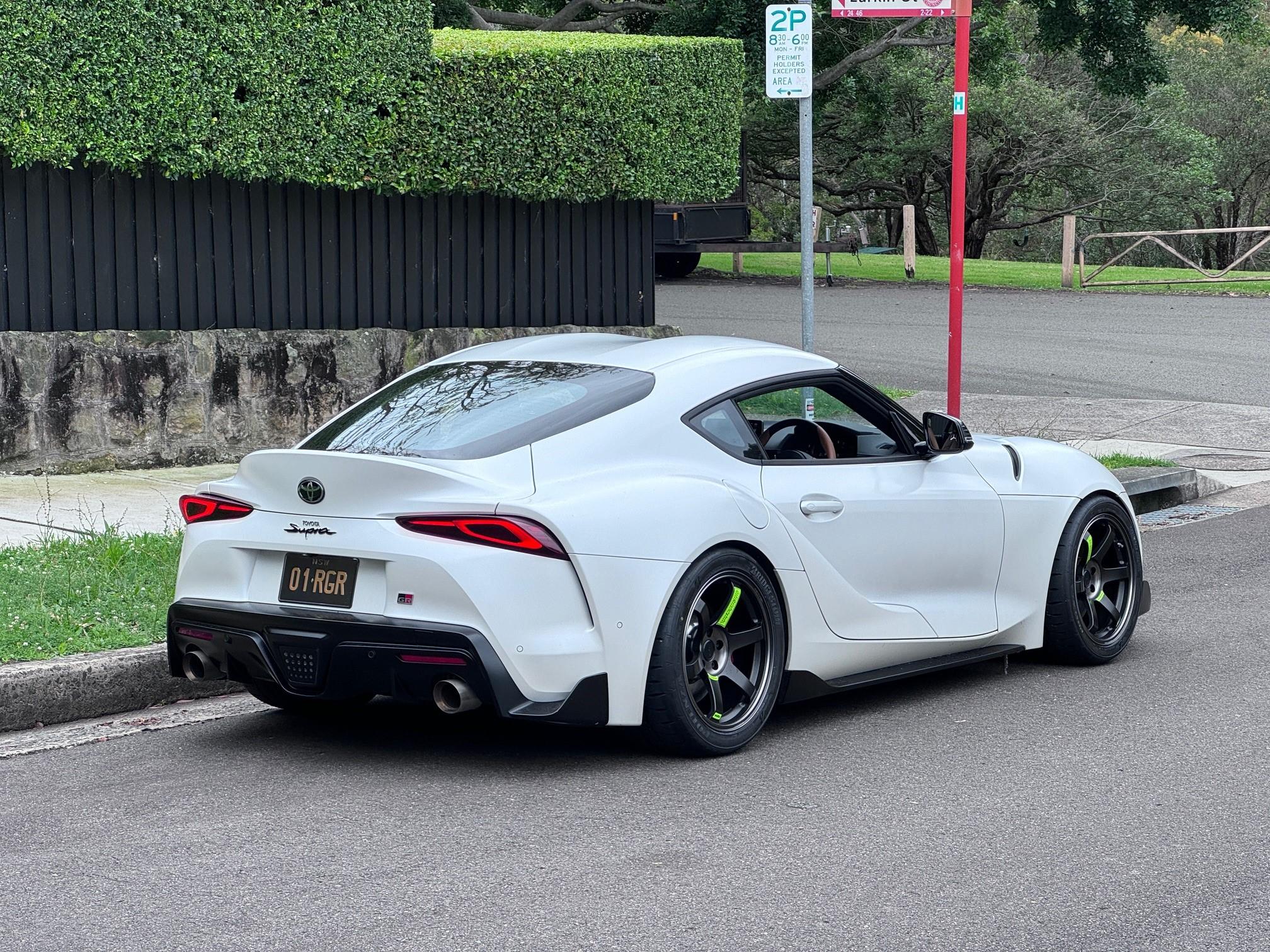

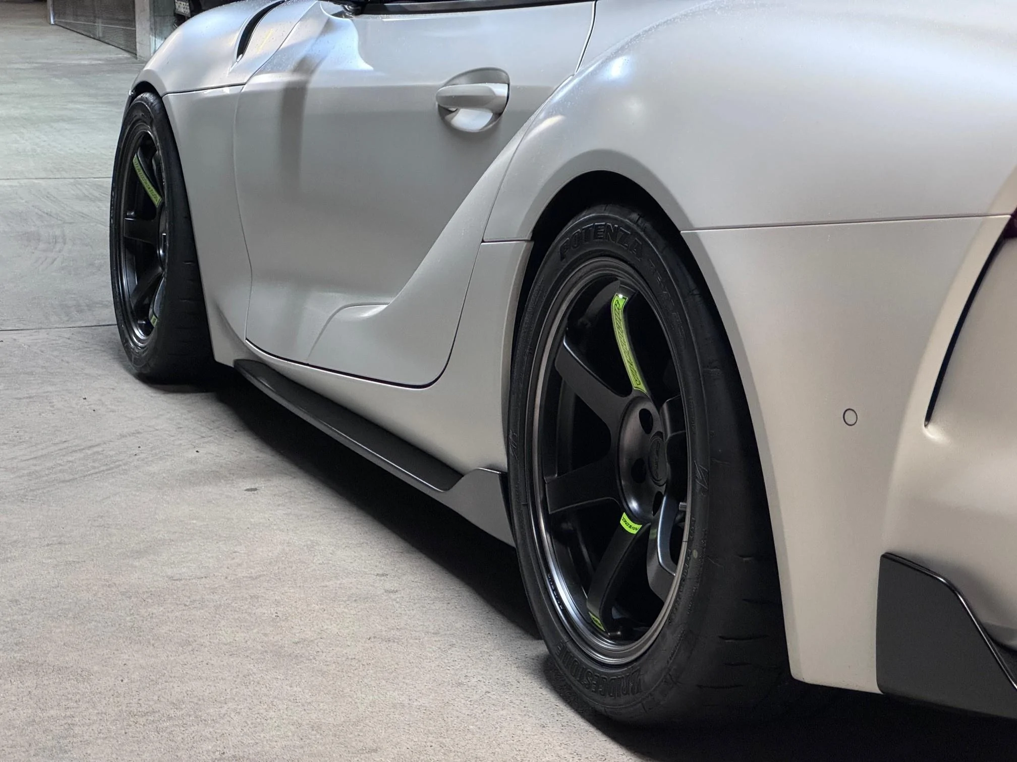

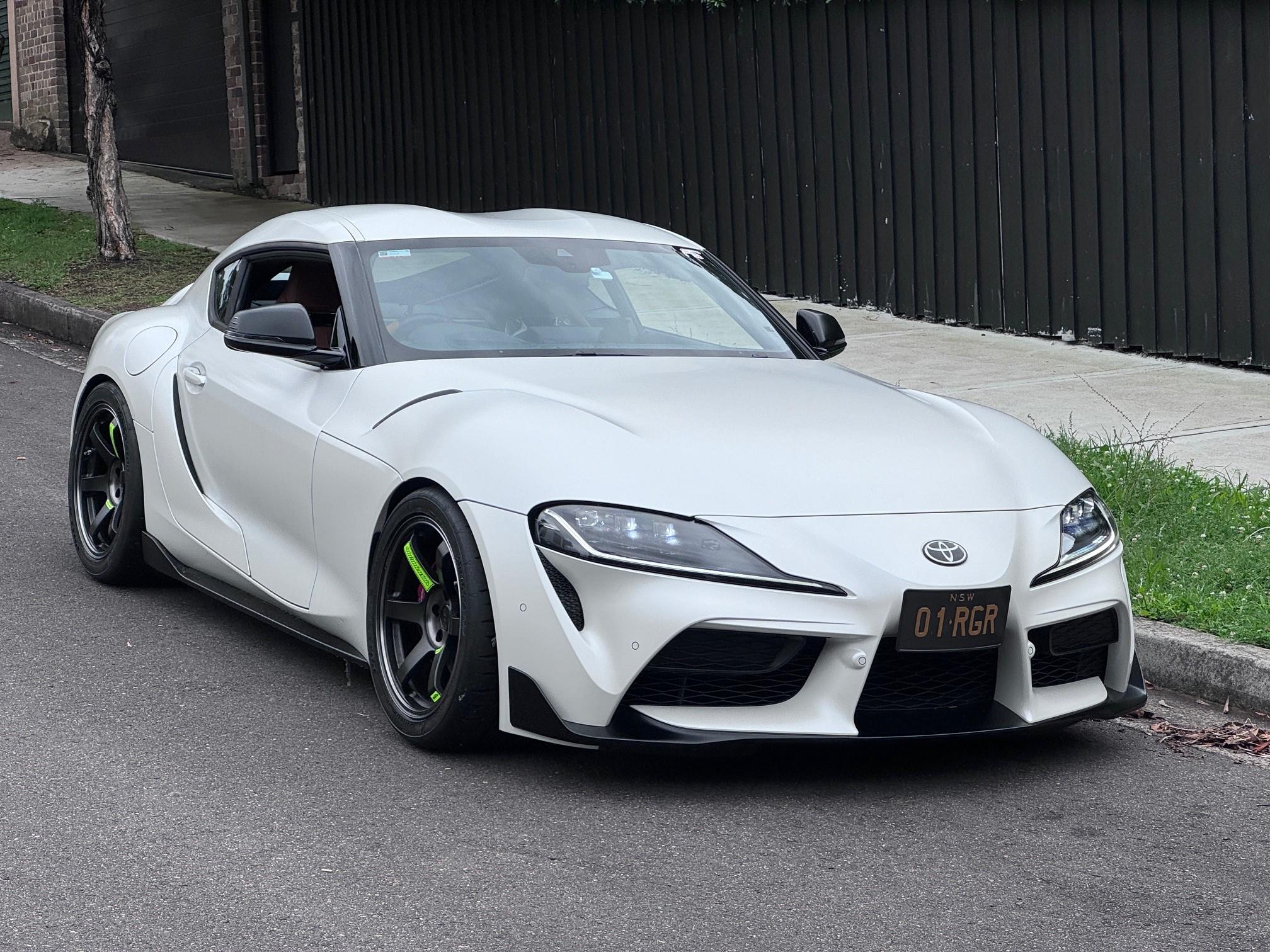

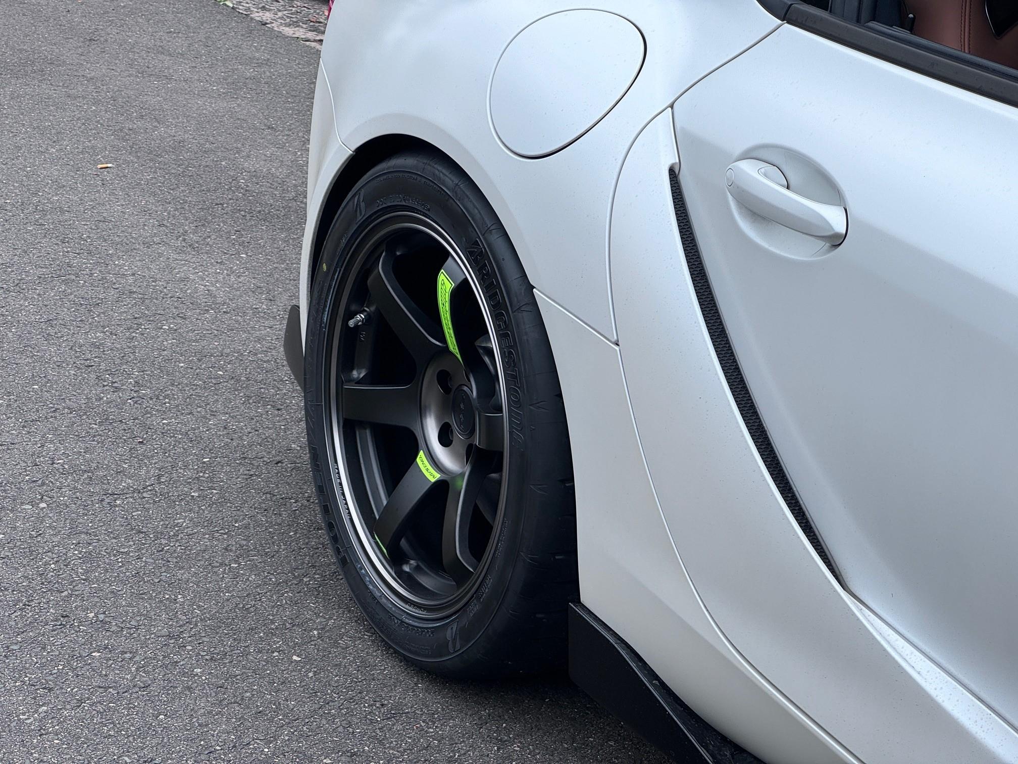

Hey guys, thought I would share a few photos of my 2023 Supra 6MT on TE37 SL Saga M-Spec.
18x9.5+20 on the front with 275/35
18x10.5+34 on the rear with 295/35
Tyres are Bridgestone RE71RS.
The car also has SPL front control arms which I believe increase the track.
Lowered on H&R Sport Springs.
Fitment on the front is really tight, looks like it will rub but doesnt.

Rears looking good. Front offset's a bit low for me. that's surely going to rub during hard cornering. See if you can find an Audi guy to trade front's with, audi's love +20.

Took it for a pretty spirited drive yesterday and it didnt rub. If it does rub on the track I will swap out for a 265 on the front.
