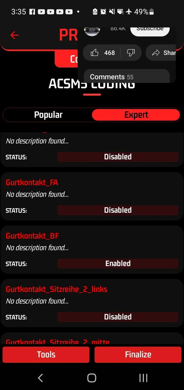

Can you code out the stock seat belt buckle too?
718_2T
Tim
Nov 17, 2019
34
2020 Supra Absolute Zero, 2017 718 Cayman White
Appreciate it! I think I may have figured something out. There are some ghost errors but not creating CEL
1. Unplugged the belt buckle first from the harness.
2. Disabled Gurtkontact_FA
