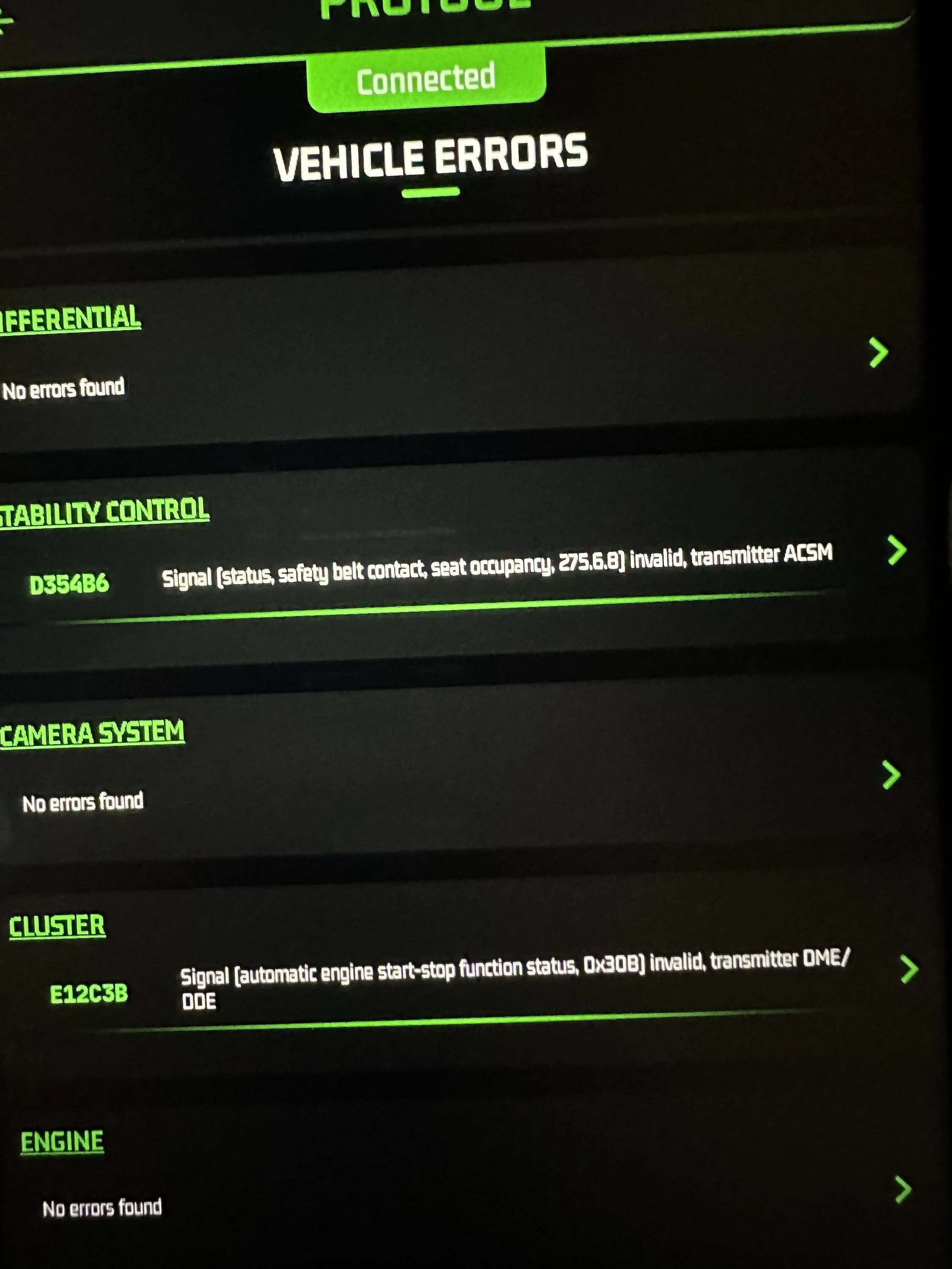

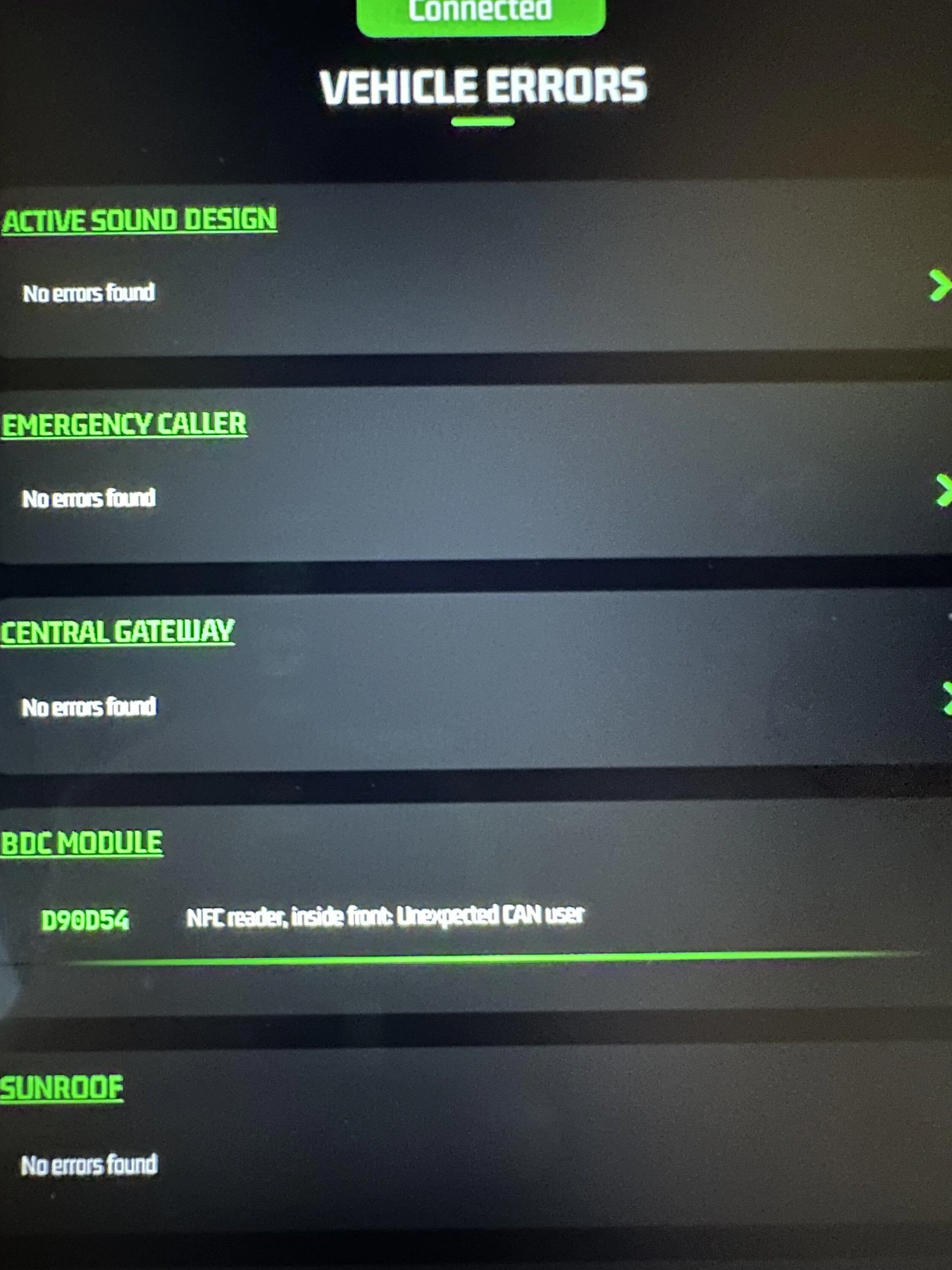

these are the codes i'm throwing:
CAS [BDC_G05] | D90D54: NFC reader, inside front: Unexpected CAN user
IHKA [IHKA_G05] | E7140A: Message (FAS status, 0x232) missing, IHKA receiver, BDC-ZGM / SMFA transmitter

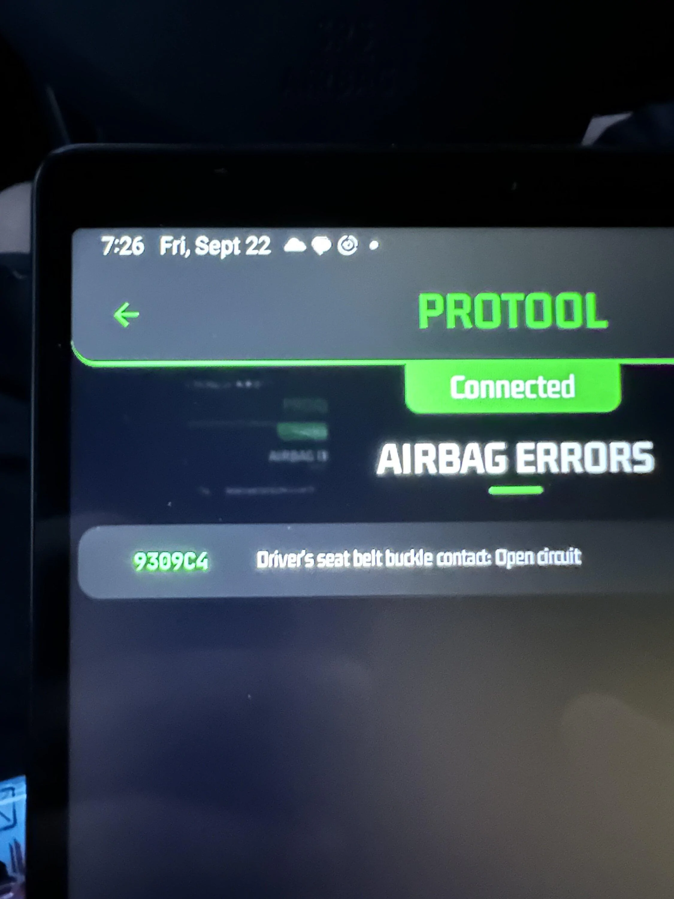

AIRBAG [ACSM5] | 9309C4: Driver's seat belt buckle contact: Open circuit
KOMBI [KOMB_J29] | E12C3B: Signal (automatic engine start-stop function status, 0x30B) invalid, transmitter DME/DDE
DSC [DSC_G20] | D354B6: Signal (status, safety belt contact, seat occupancy, 275.6.
invalid, transmitter ACSM

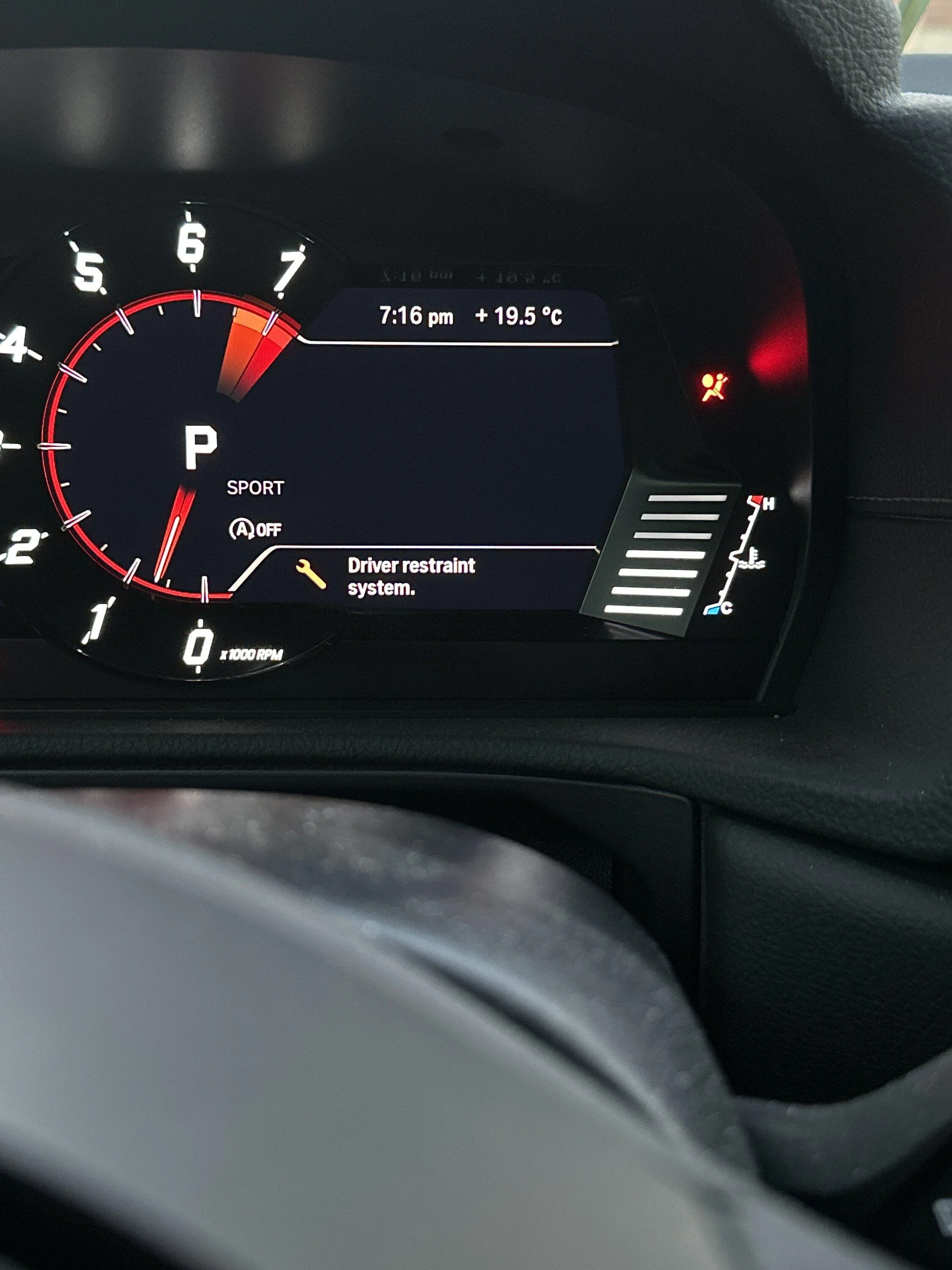

Currently trying to make both these lights go away

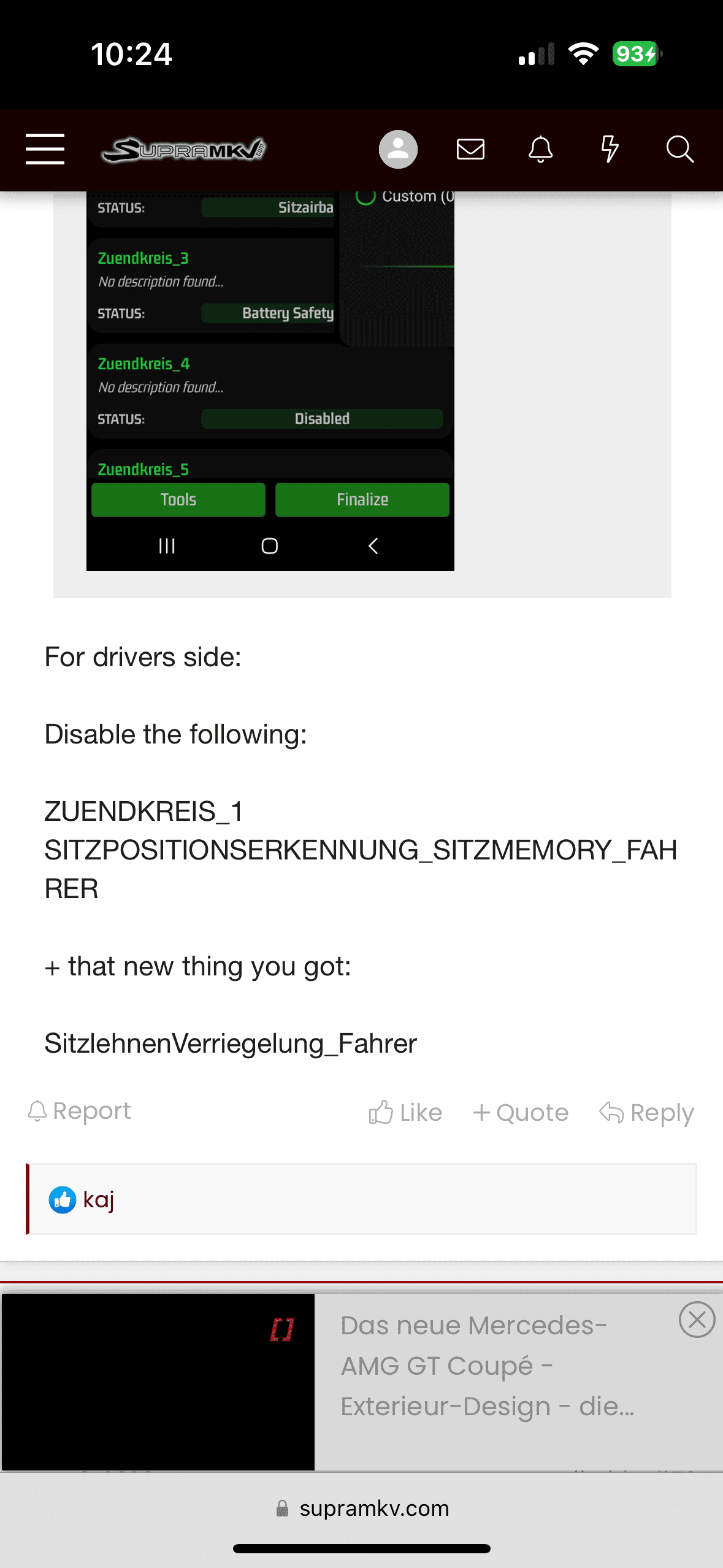

I have a '21 and latest version of ProTools. These settings are the ones to change:

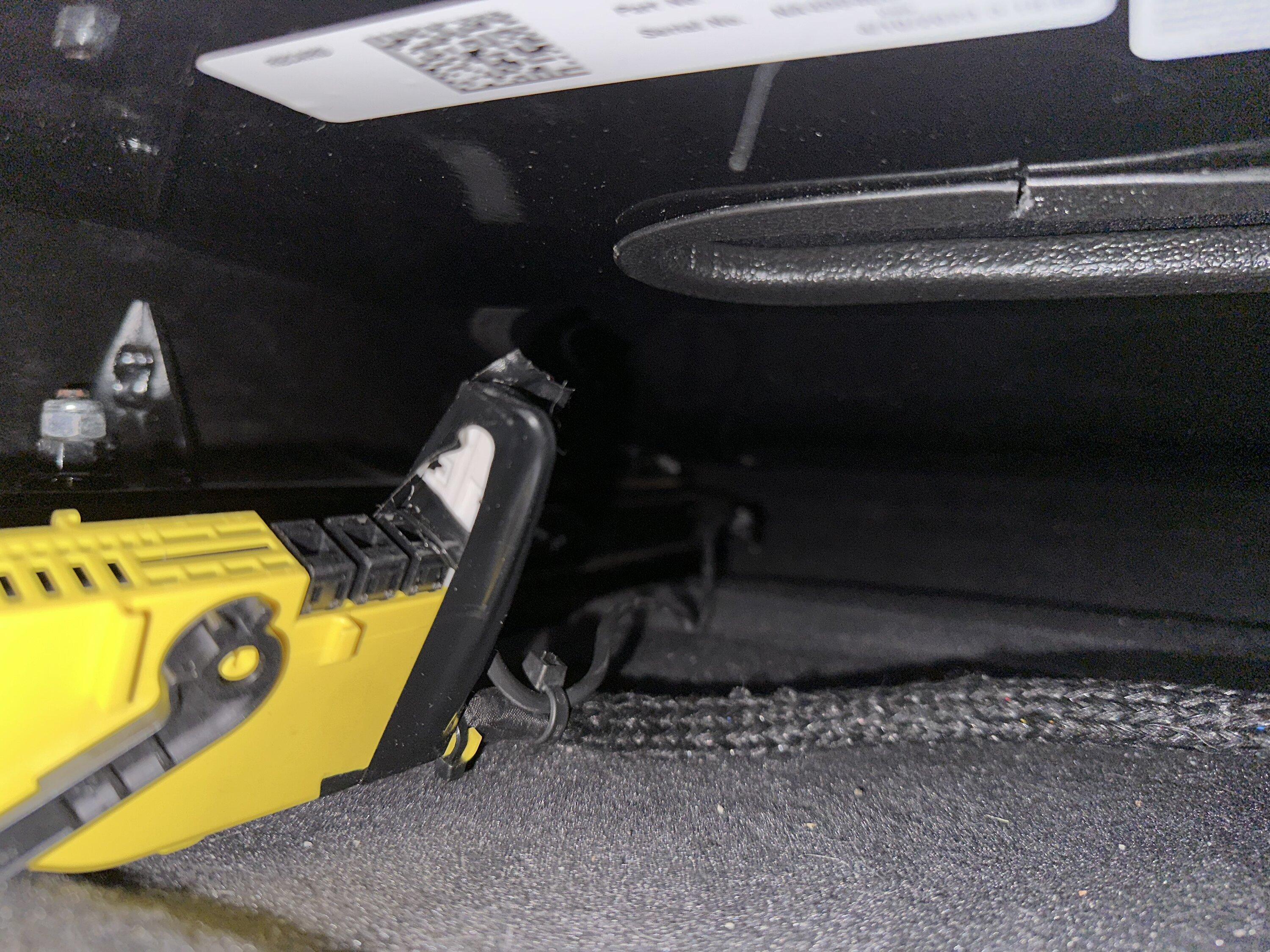

for me, the trick was finding where these were. My dongle broke and BG was supposed to send me a new one about a month ago. Still waiting. So, I can't even go back and look through the menus. Anyway.. I did all that then made sure the seat belt plug was in the far, outside plug of the yellow plug on the car side. I zip tied it on for good measure. LOL.
I then went in and cleared the code. All fixed. Even with it coded out, you will get a CEL for unplugging the seat. Just clear the code, again. Once it's coded, you can just clear the code any time the seat gets moved.
I hope that helps. If i get a new dongle any time soon, I'll get some screen shots.

Here are the current codes i get from Protool:
