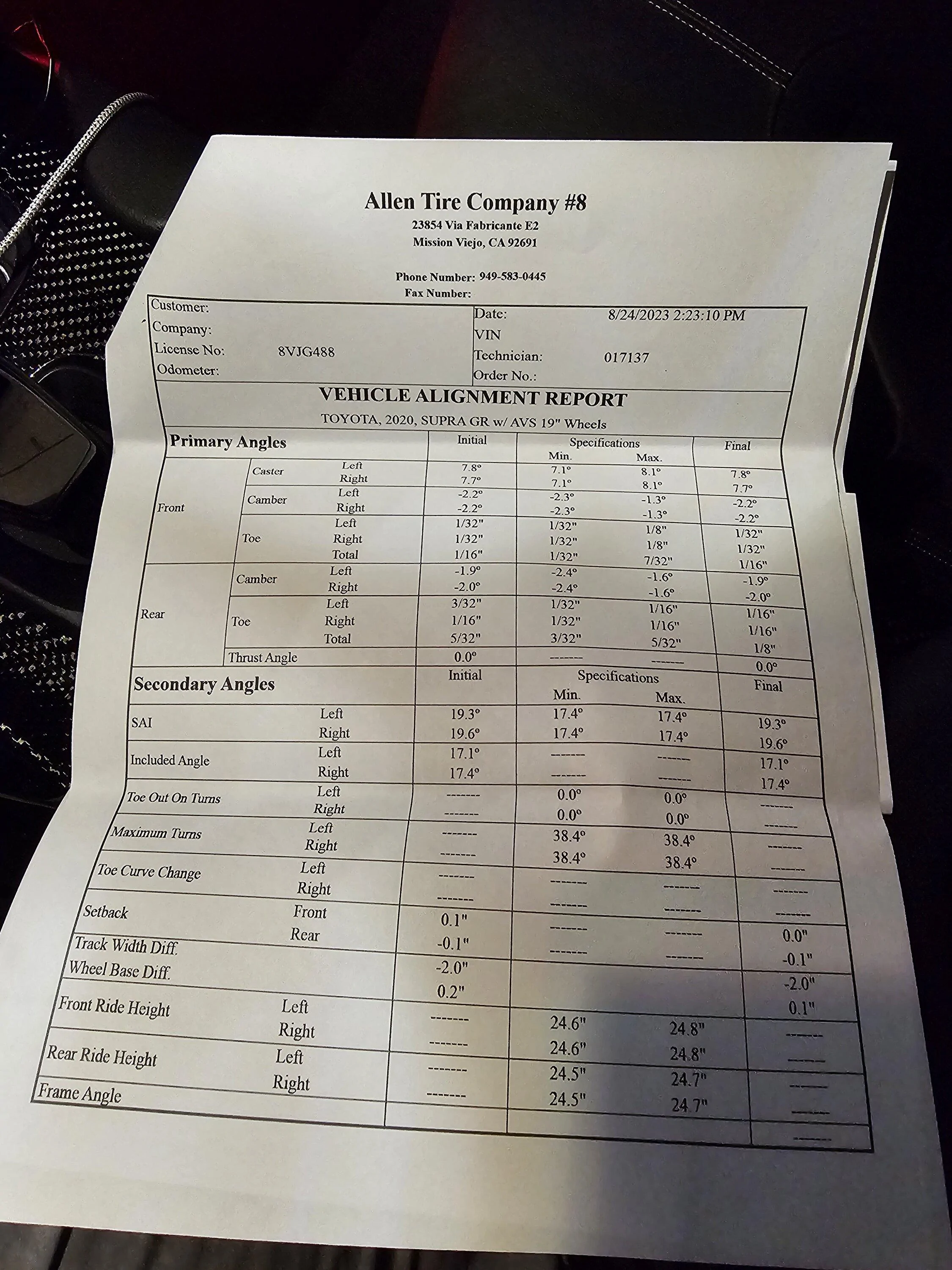

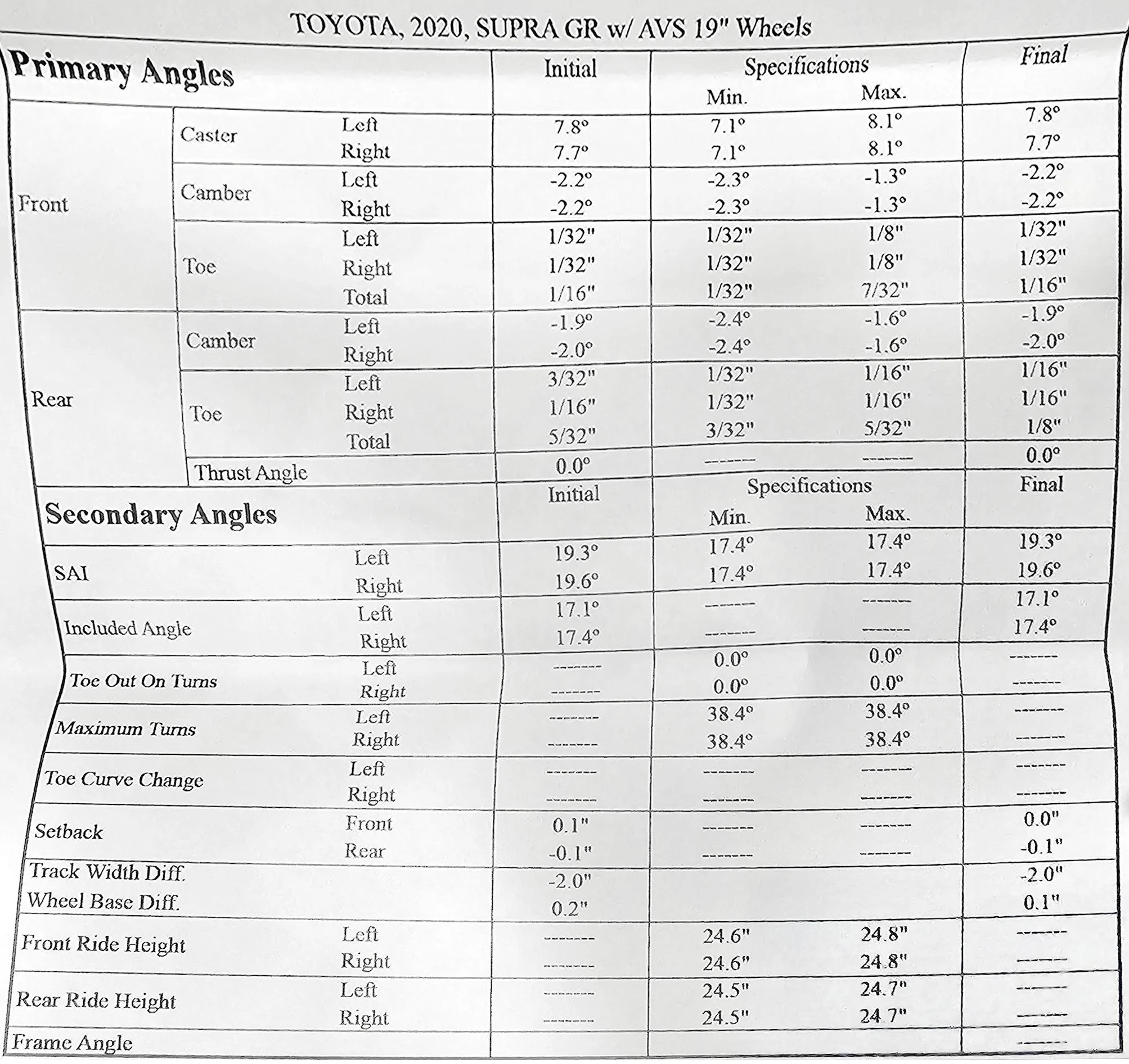

Please post alignment sheet. Stock sway bar?

Will post in a bit but yes stock sway bar and made sure everything was tight.

yeah sorry that picture job irks me. some improved attempt
