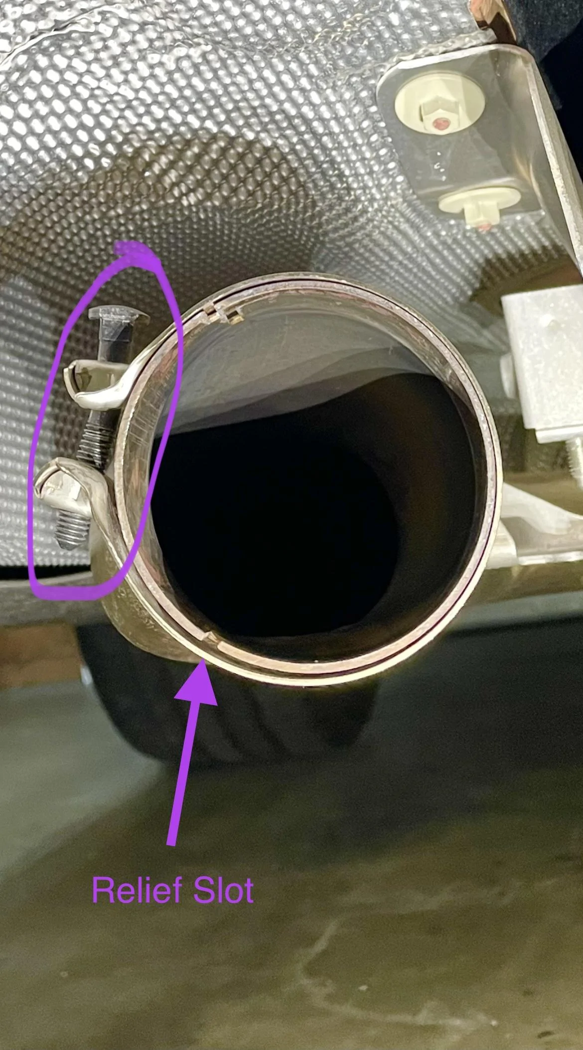

No gasket, the downpipe feeds into the mid-pipe and is clamped.
-RJM
wack
Aug 22, 2020
2021 A90 3.0
-RJM
I also bought a new Vband clamp for the downpipe. Probably not necessary but I've seen it recommended . The clamp for the DP-to-midpipe looks pretty beefy, so I'm not gonna replace it.
Thanks for the photo! 👍
