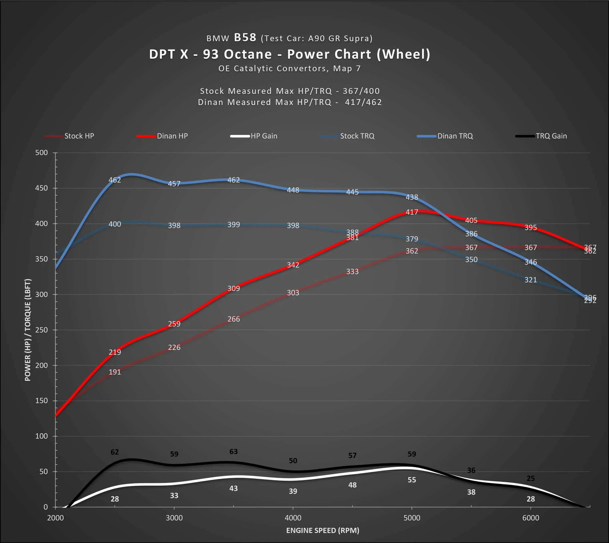

Easy install, approx 15 minutes to splice the three cables. Hid the module in the upper right corner under the cover instead of their suggested spot. Can't test the upgraded power yet because it's raining.

This is a remarkable option for those with a locked ECU. The JB+ didn’t do very much for me.

JB+ adds a flat 3psi across the band. Dinan tuner is likely the same, though for the price, it seems like JB4 is a more solid option.
The JB Plus only taps into the boost sensor plug. Dinan taps into the boost, manifold absolute pressure sensor, and the camshaft sensor.
No need to be distasteful about a new product. I’m another Supra enthusiast just trying to pull out more fun from the car too.
79
8,447
13,869
Not being distasteful about a new product, definitely good for folks to try it and gauge performance. Just suggesting that Dinan products tend to be a little overpriced, and JB4 is likely a better option if you're looking for an upgrade.
Given the provided dyno curves, it looks like they come from the horse's mouth. What do I know though. ¯\_(ツ)_/¯

The JB4 you can have a custom map done as well. I did not find anything on Dinan's site that stated you can customize/add maps. Personally its hard to go by Dyno numbers on a products site. Always seem like they fluff them a bit to sell. jm2c.

Not to throw shade at Dinan. But I agree, I can't justify the price when it's very close to Jb4. The custom tunes is a big advantage for JB4.
