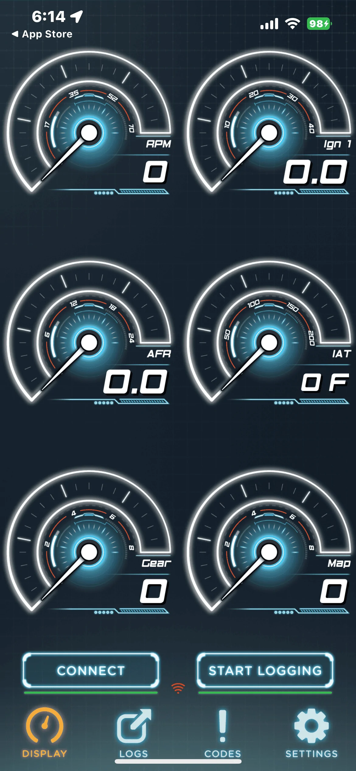

Ok starting this thread because y’all are like tech wizards or engineers and I’m looking for the most basic lingo definitions and where to start. If there’s an idiots guide thread for this, lemme know (I’ll gladly delete this, if possible lol)!
1) Find a good custom tuner (such as @Jesse DaBears) or decide to use the JB4 app program maps.
2) After installing the JB4 ,
download the JB4 app (yes you have to pay for a quality product- found a thread on that)
3) Create an account in the app via settings.
4) Connect via Bluetooth (I believe the JB4 with Bluetooth recognizes our Supras - I found my engine in the firmware and it connected!!!)
5) Do some logging for your custom tune if not using a map. When connected hit the start logging button before you floor it and hit the button again when at top of target speed.
6) The app has a “logs” button at the bottom. After you’ve done a few “pulls” or “logs” you will see only one entry. Despite doing multiple logs/pulls/runs during the same day.
7) You should rename each log entry for better description. Clicking on the most recent log entry to rename (such as adding the date in front of the log).
8) From the same log entry screen, you can email your logs to your tuner.
9) Your tuner will send you back specific instructions on what to change and how to do it.
10) Keep repeating this process until your tune is complete or you make significant change to your car again.
11) So far, this process has been ultra-smooth. More than I expected! Any other suggestions or videos, please comment or add for other non techies like me 😗😜
Appreciate all the advice in advance and will keep updating (editing this post) ✌🏼

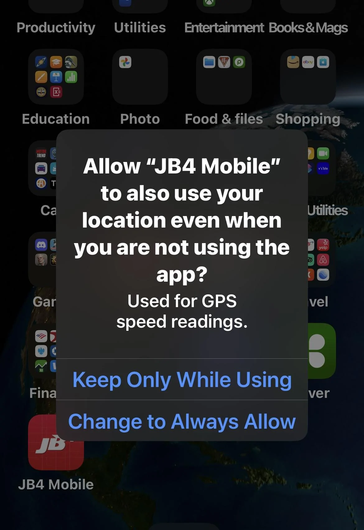

Assuming I can keep this only on while using. Will update when I find out
It doesn't need to know your location. It has some shitty thing built in that tries to give you 0-60 times, but it's trash.

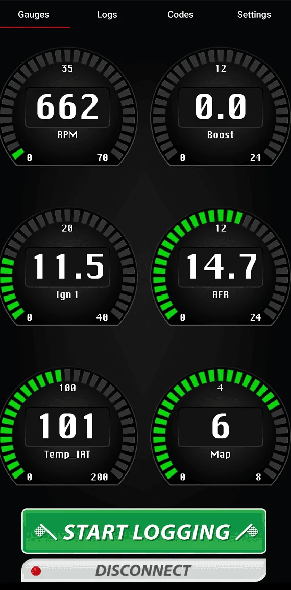

Is there some setting I'm unaware of to change the display style or is this an iOS vs. Android thing?
I feel like I'm stuck in the 90s:
Yeah, it's in there somewhere. You can change it.
