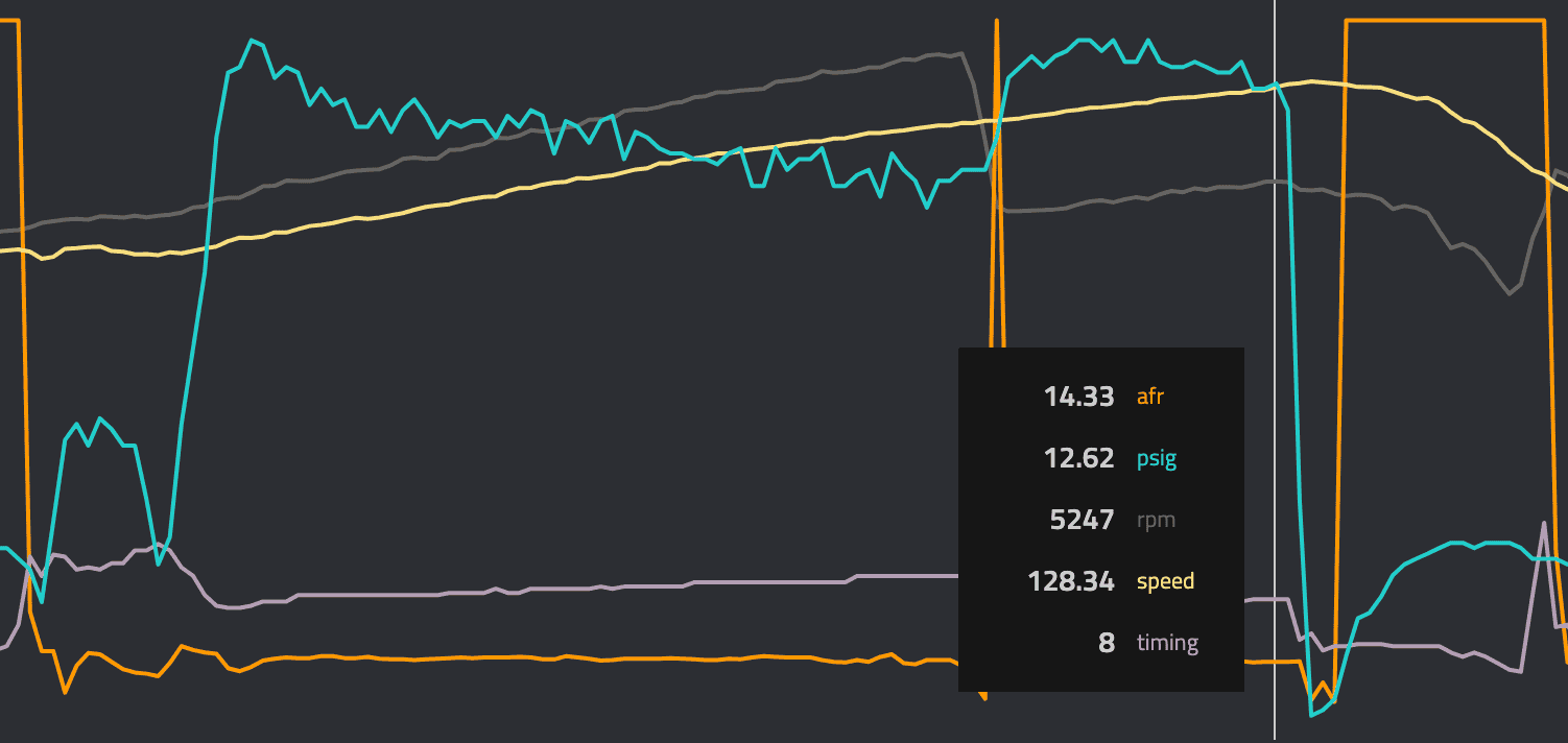

Incorrect. The OEM B58 programming is around 14.X for WOT as well. 2020's stay in the 14's. 21+ are a little richer and dip into the high 13's. I have many logs of my OEM tune 2020 on track with 14.X AFR's all day long.
These are DI engines. VW also uses this fueling strategy on their DI engines as well.

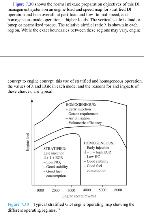

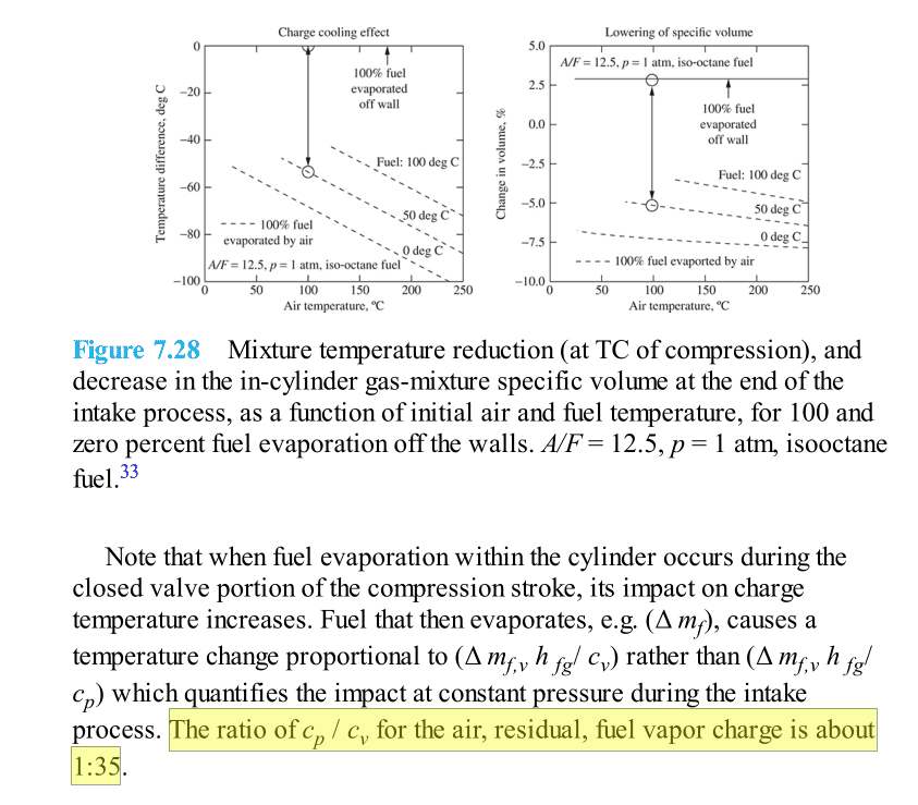

to provide some context to what @razorlab mentioned, DI engines can generally run leaner at low and moderate boost levels due to their heterogeneous charge (locally rich, overall stoich/lean)
quick example from Heywood 2nd ed.
Also, when fuel evaporates in a CLOSED cylinder, the cooling effect of evaporation is drastically more effective.
