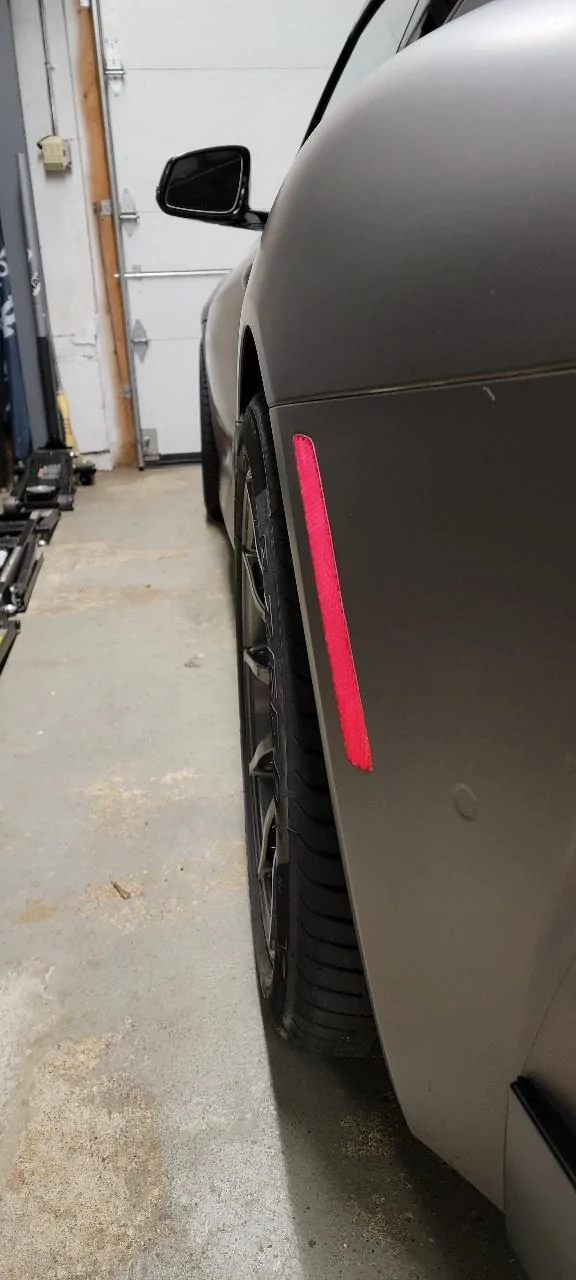

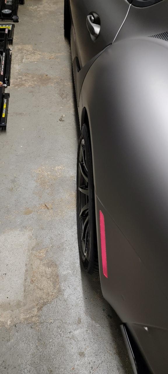

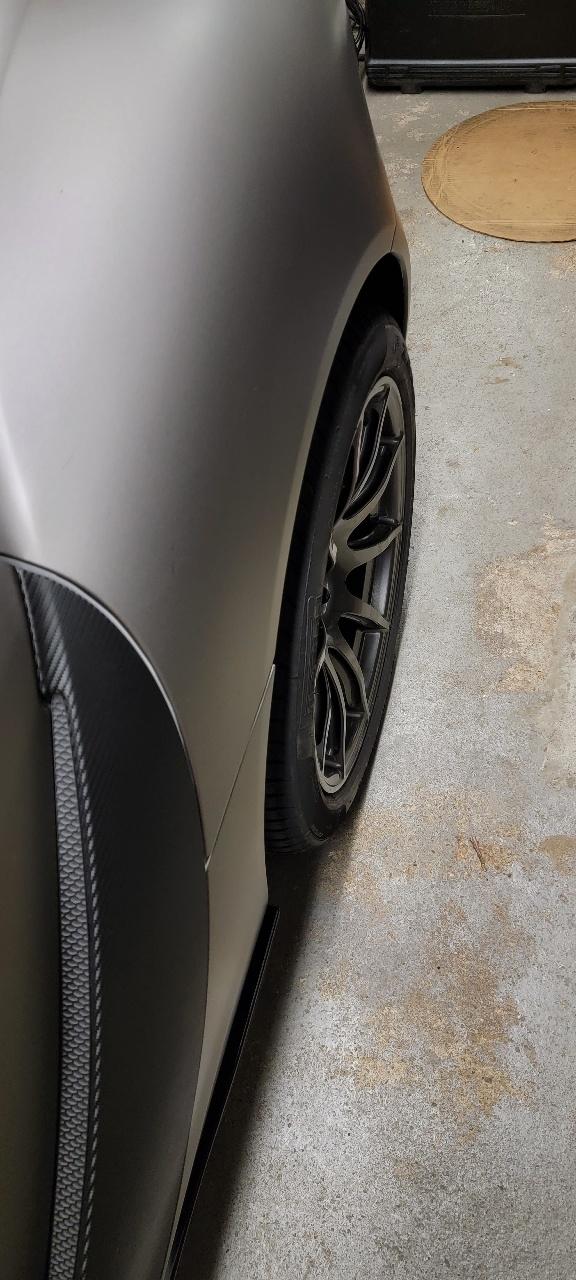

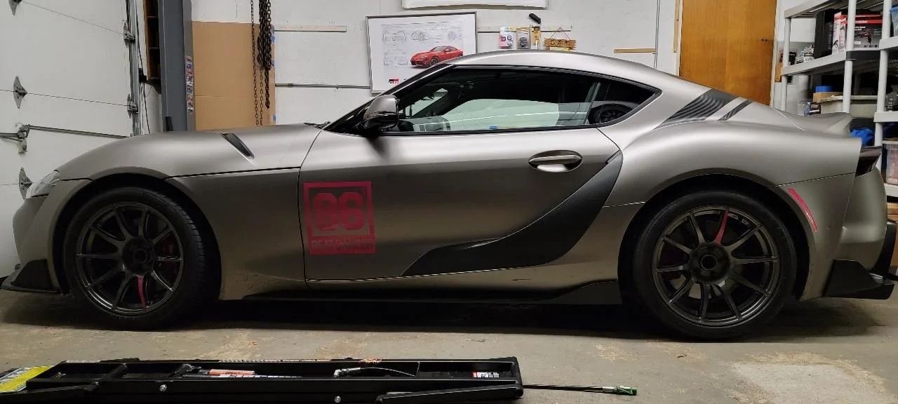

I am going to attempt to add the door and side accents today to mine...fingers crossed. Any advice?

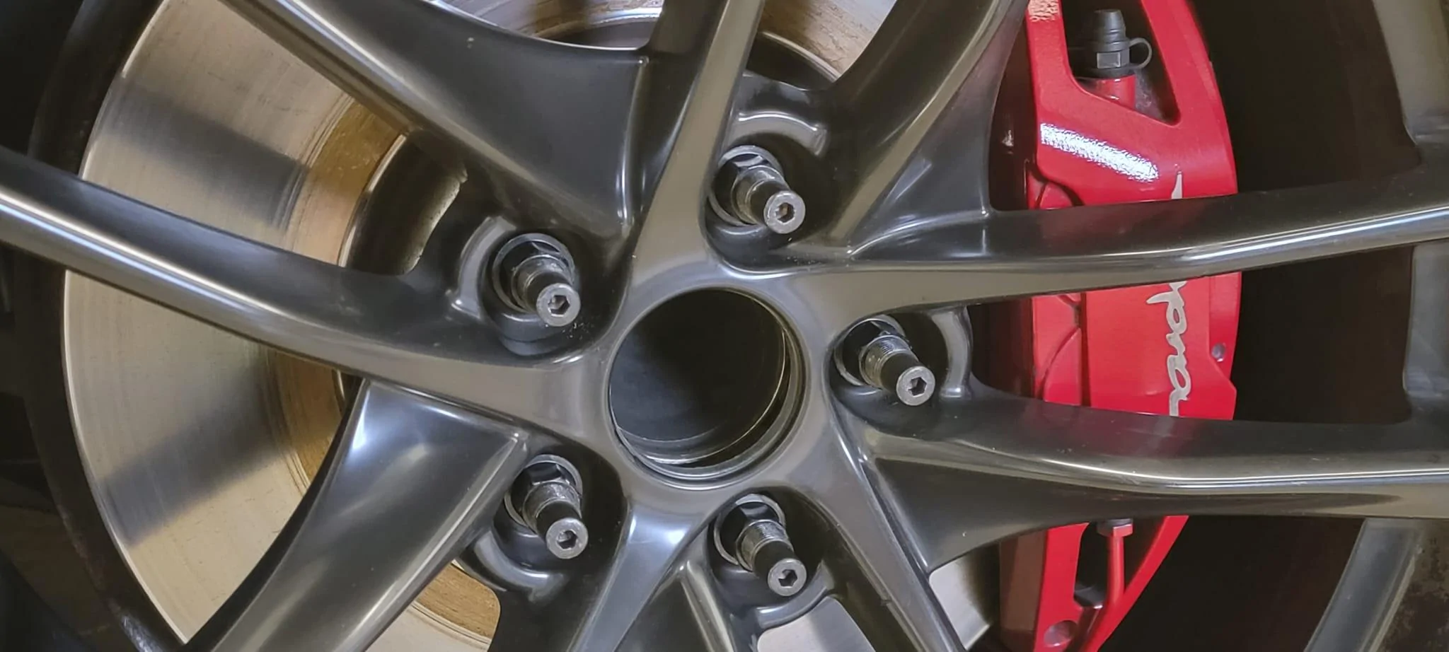

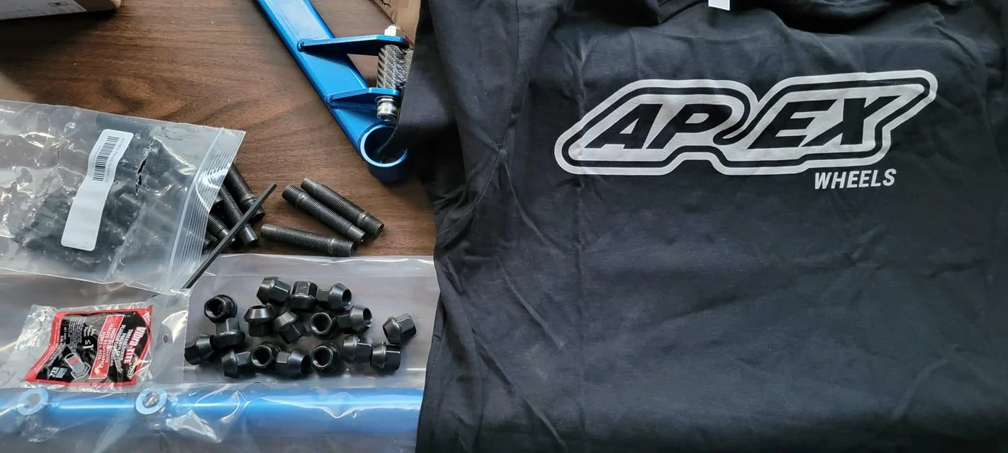

I like that lug nut stud kit, can I ask where you got it?
I found them at Apex and will order a set next week. Gotta confirm size with them first.

Its M14x1.25 hardware, same as F chassis and G chassis BMW. I need to re-label these on our website so folks know they are compatible with A90 Supra as well.

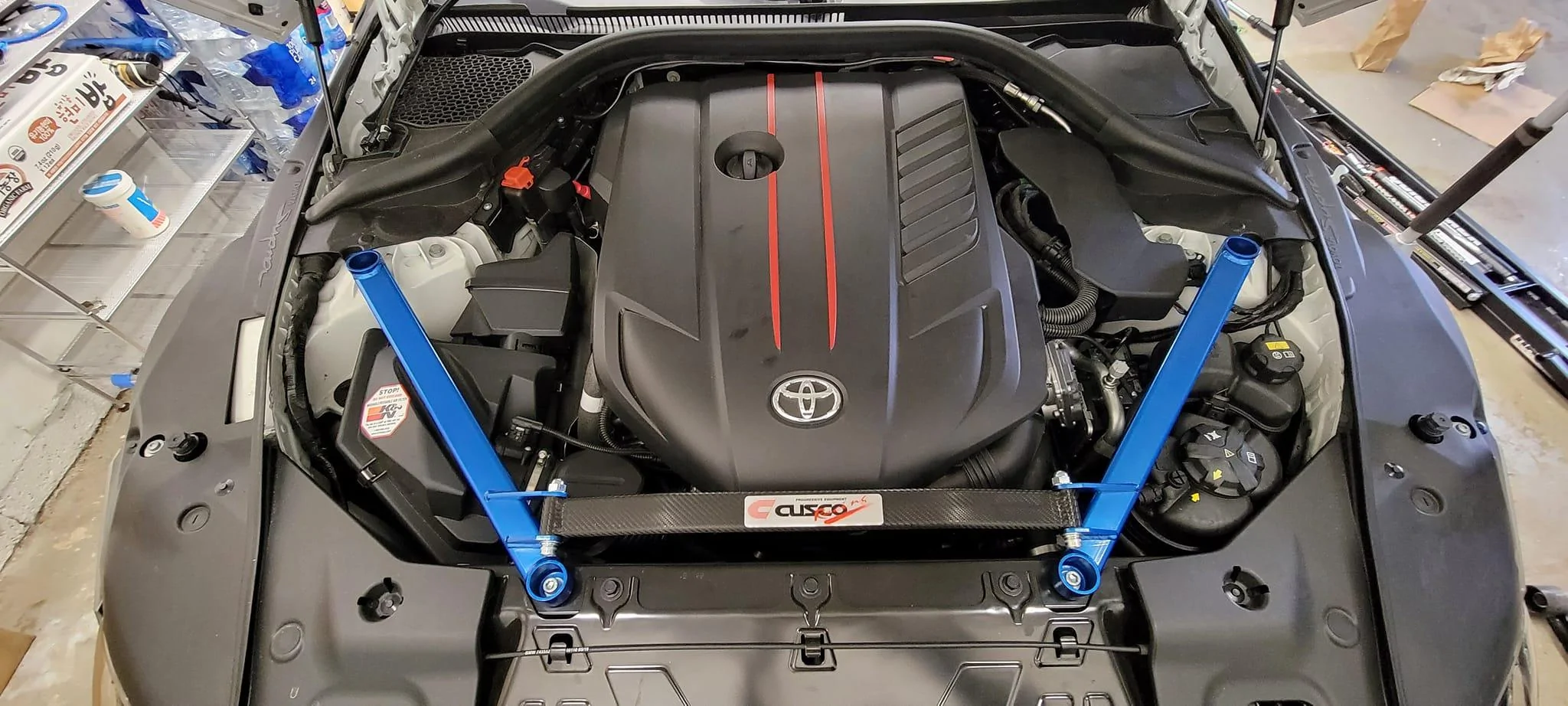

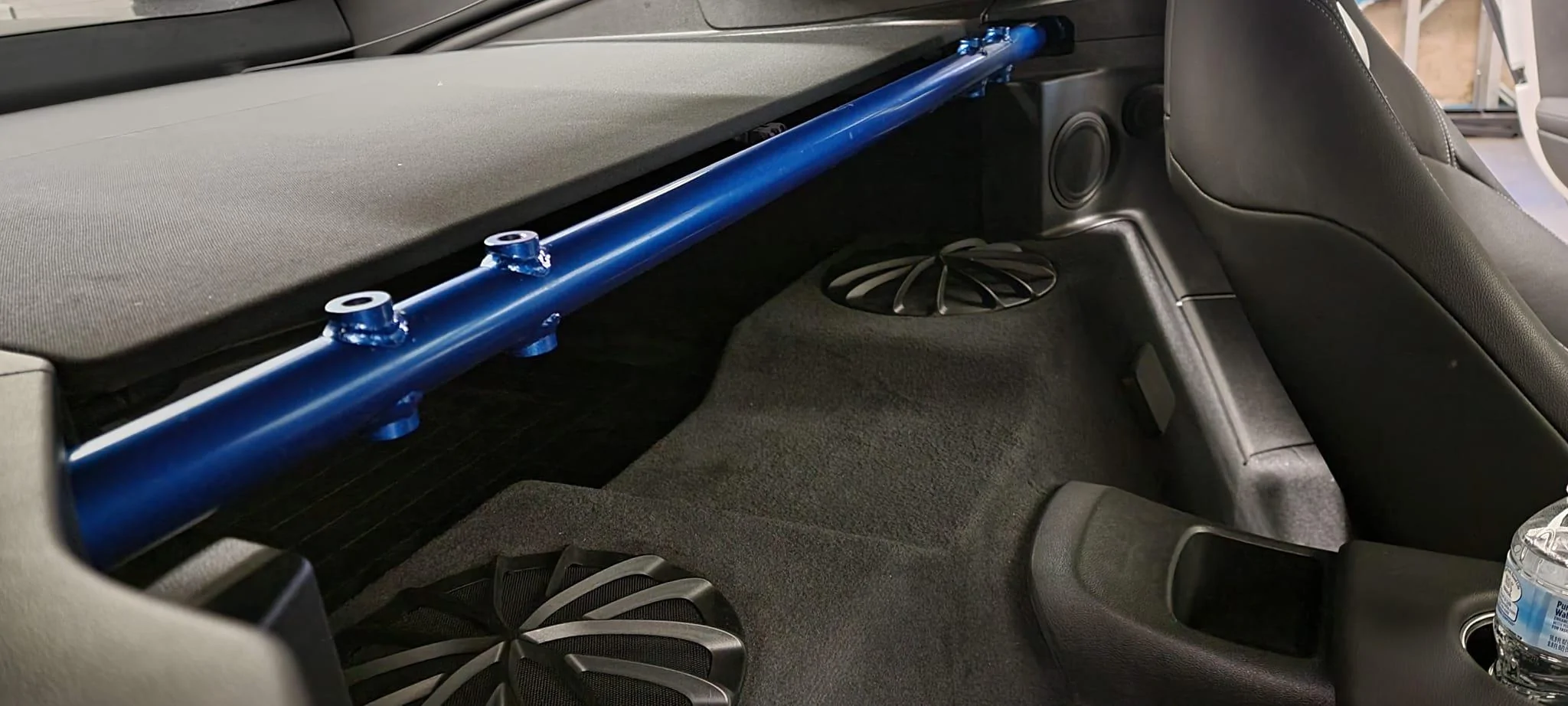

installed few more parts yesterday.
These lug nuts are lighter than I expected.
Did you notice any different with these braces? My cats behind the seat bat makes so much noise! The mounting points are so weak . Someone should improve on the oem mounting

TBH, NOT at all on the street. when I go to track, I may... - I tried to eliminate placebo effect although not sure if it worked.. Cusco Trunk Harness bar has 4 bolts (2 each side) compare to 2 holding OEM. So it will hold better but if you are planning to use 5 point harness for track use such as TT, I recommend to have "welded" cage over this setup. FYI. I don't plan to have 5 pt harness at the moment and if I do change mind, I will go with welded cage.
