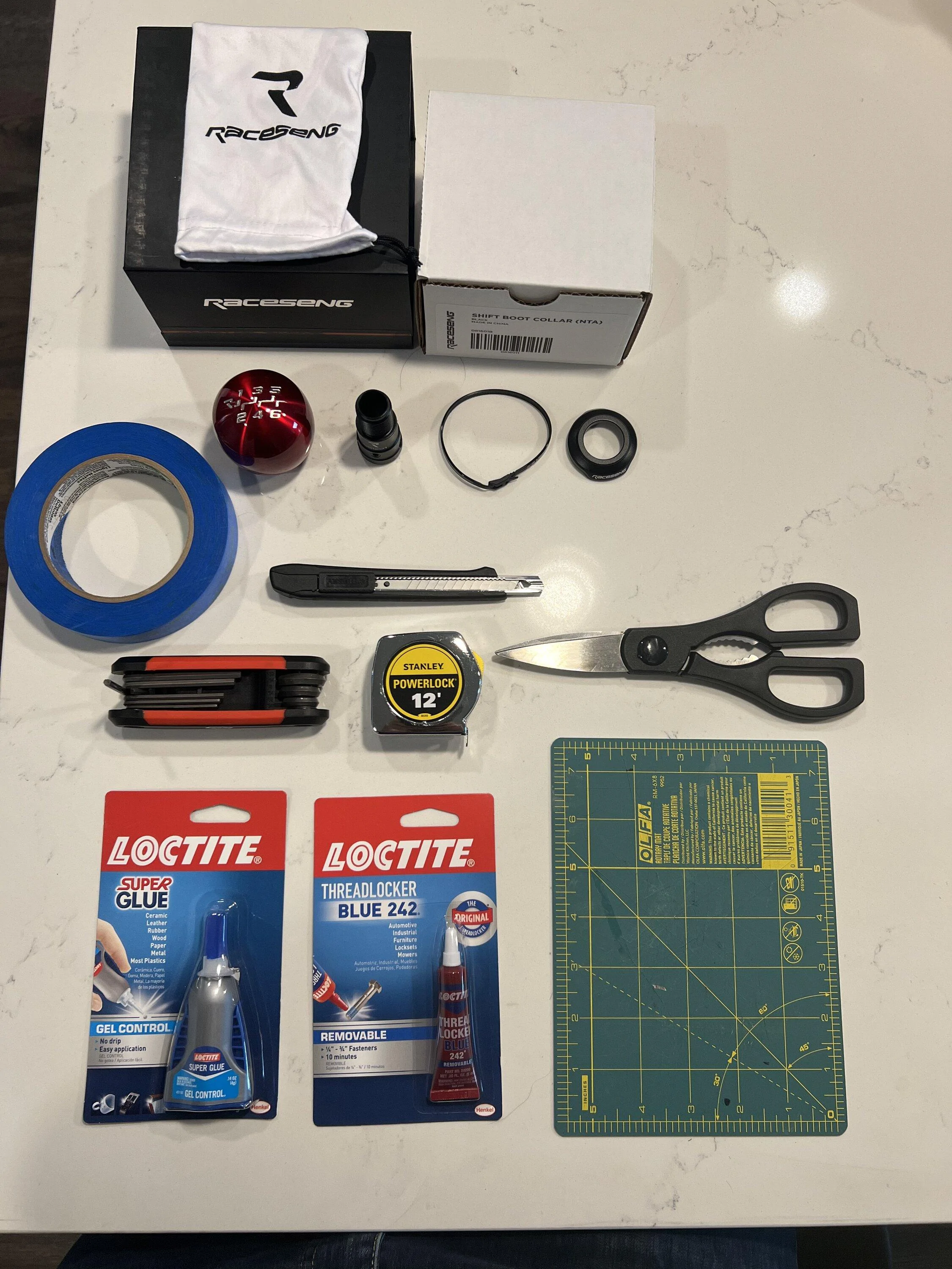

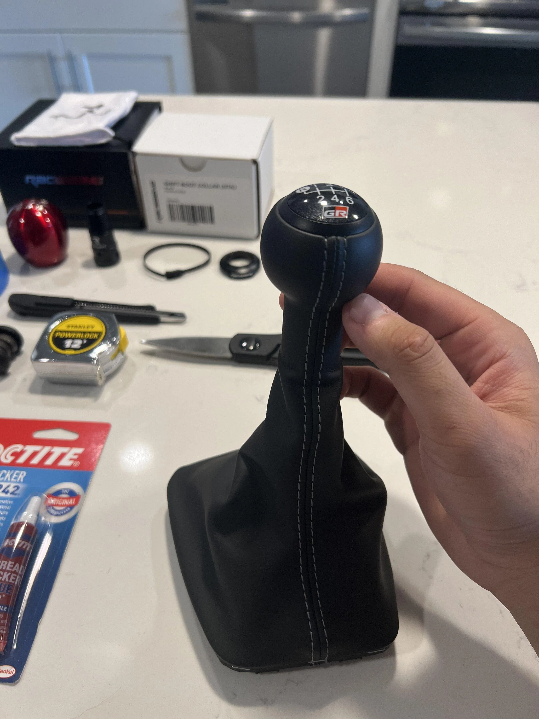

Supplies needed:
-Stock shift boot and knob assembly
-Measuring tape
-Cutting blade
-Loctite threadlocker BLUE
-Super glue
-cutting surface
-1/8” Allen wrench
-pen or sharpie
-Raceseng Shift Knob (I got the Slammer - 635 grams)
-Shift boot zip tie (included in the box with your shift knob)
-Raceseng Non Thread Adapter (NTA) (included in the box with your shift knob)
-Raceseng Shift boot collar (NTA) ***not required but cleans up the boot below the knob.

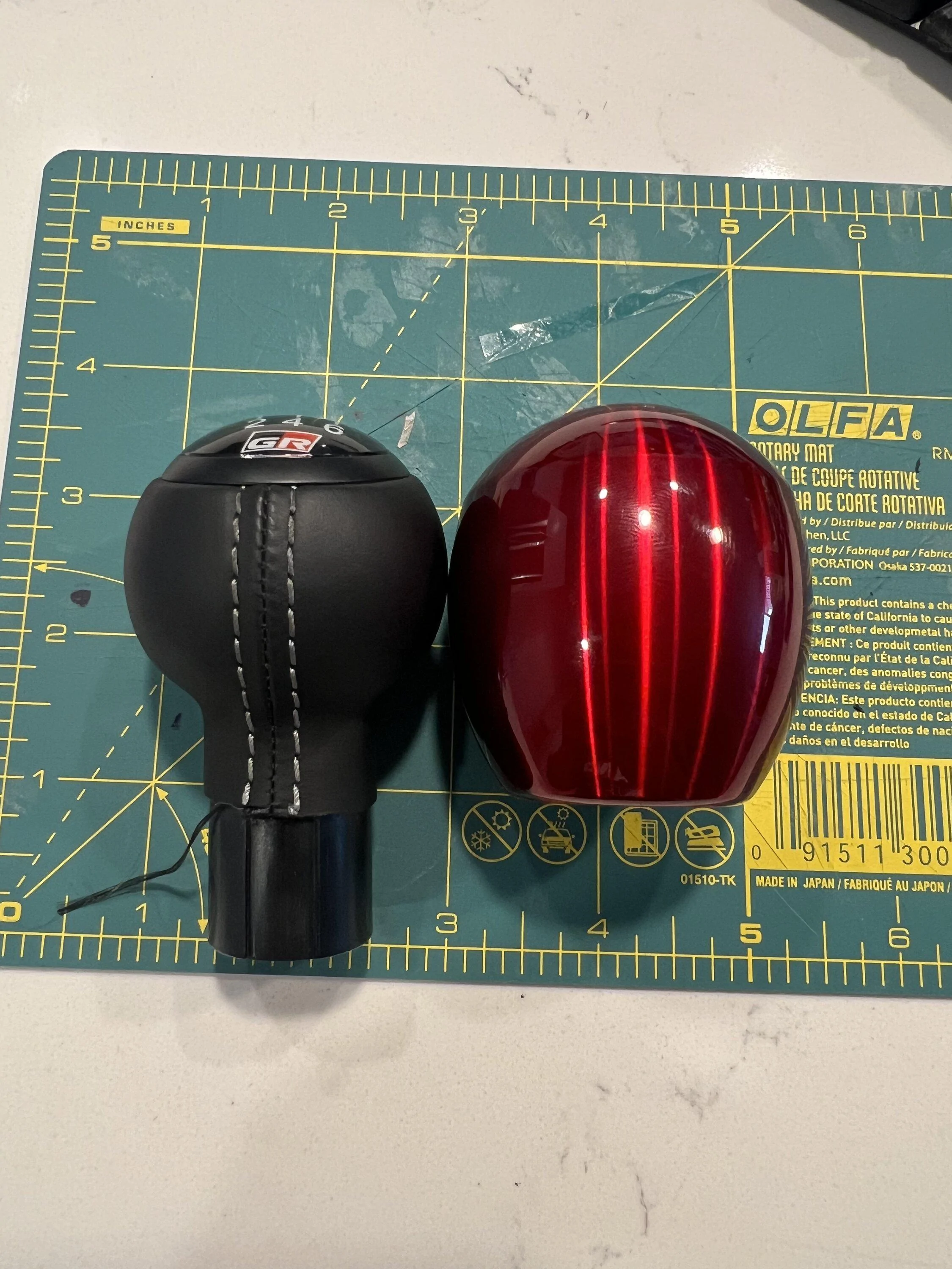

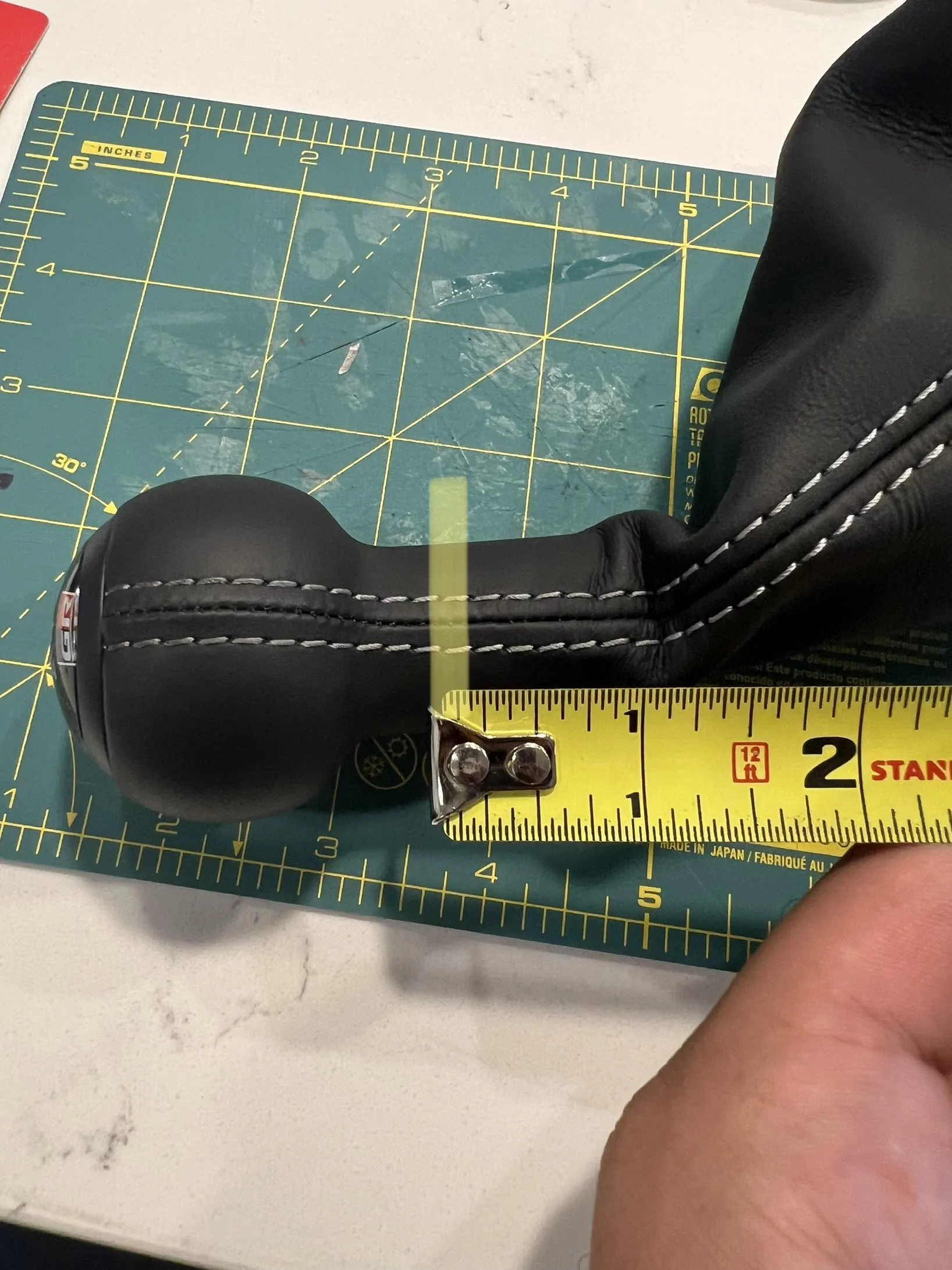

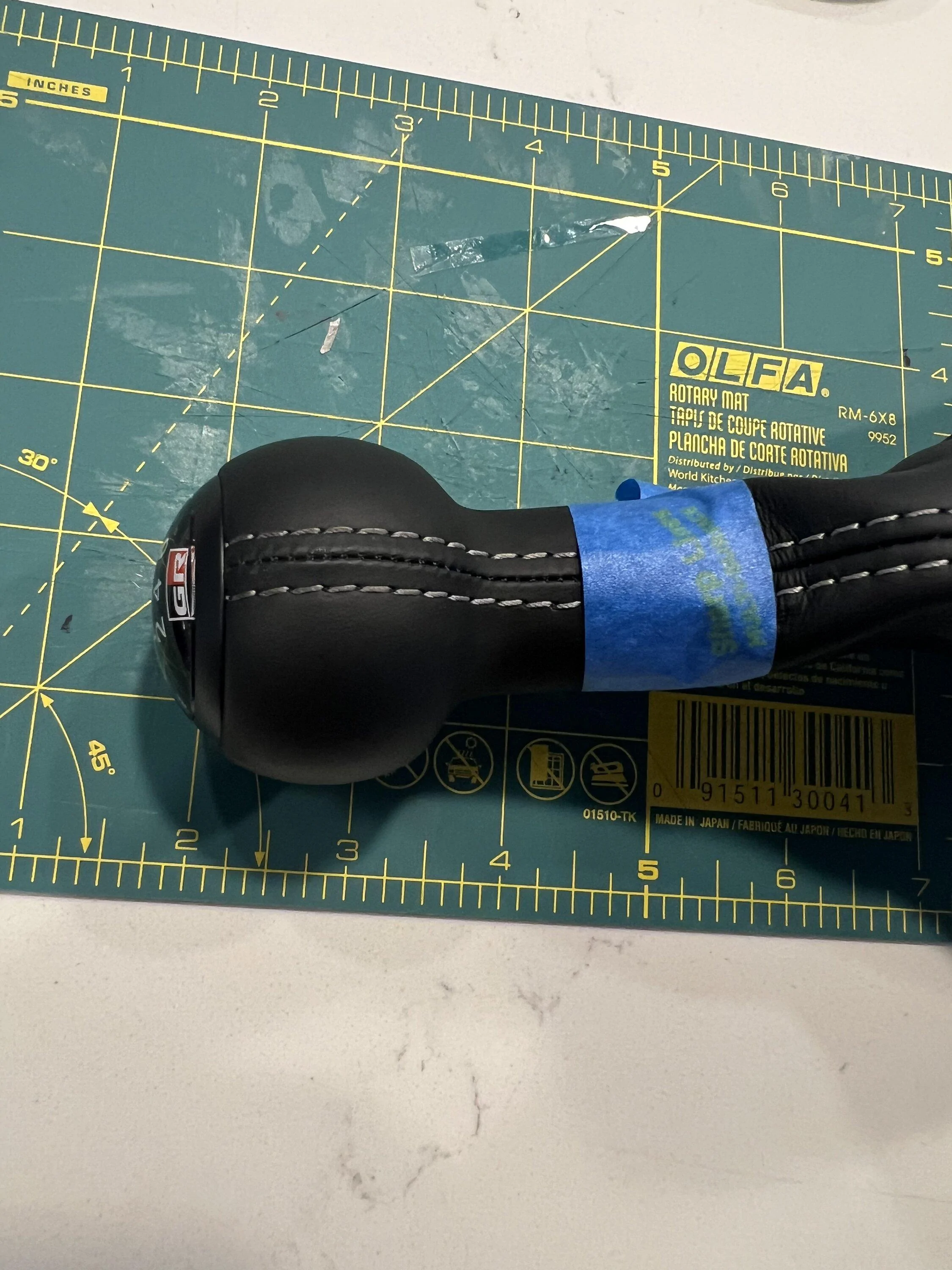

Step 5: find the base of the stock knob and measure 1” from the base. Mark with a pen or sharpie. It’s important to not cut too low so that you have plenty of leather material so when you’re rowing through all 6 gears and R there is not tightness on the boot in any position.
Step 6: use tape to wrap around the base of the knob to use as a reference for cutting around the boot
Step 7: use a blade to cut the boot

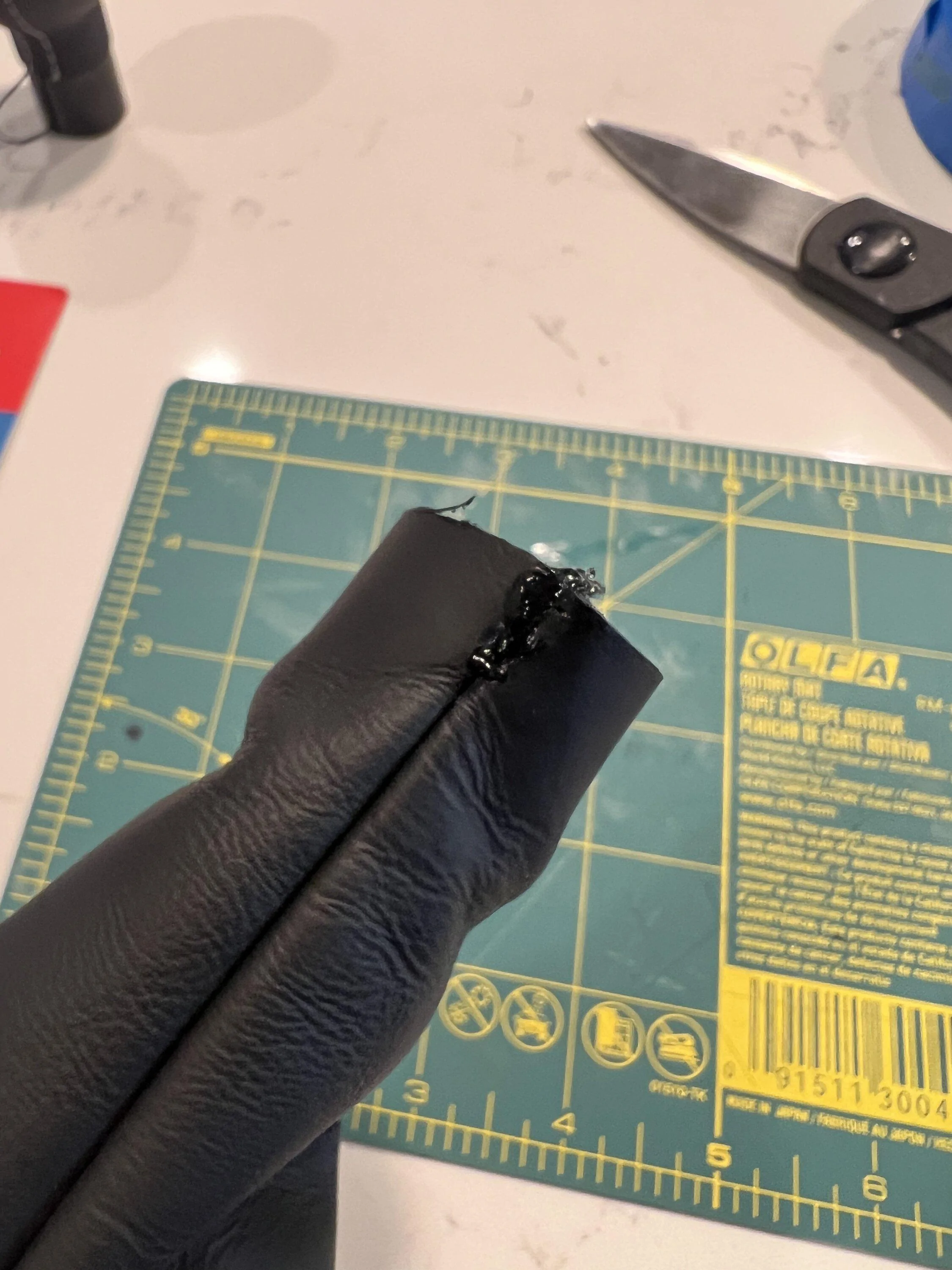

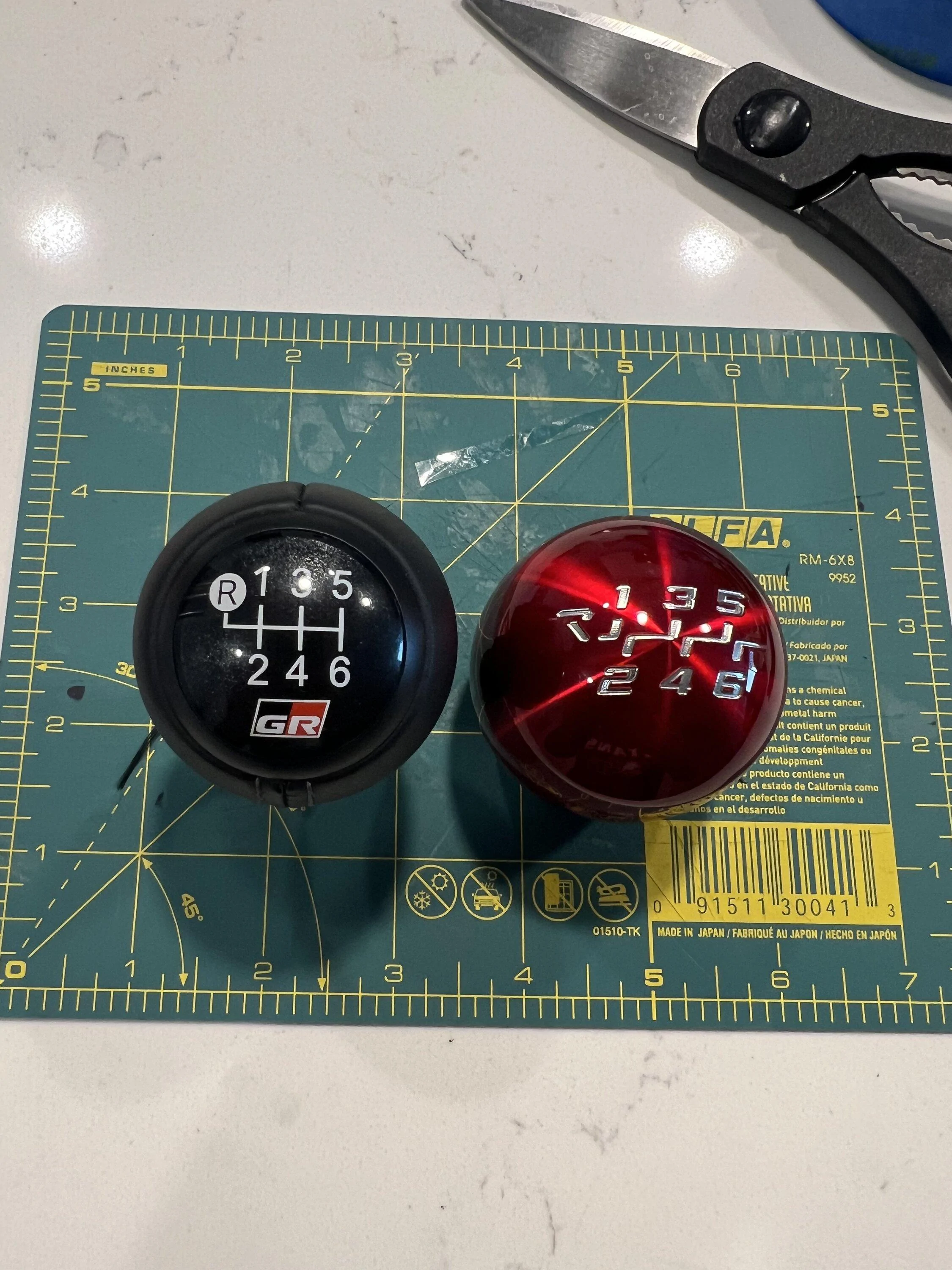

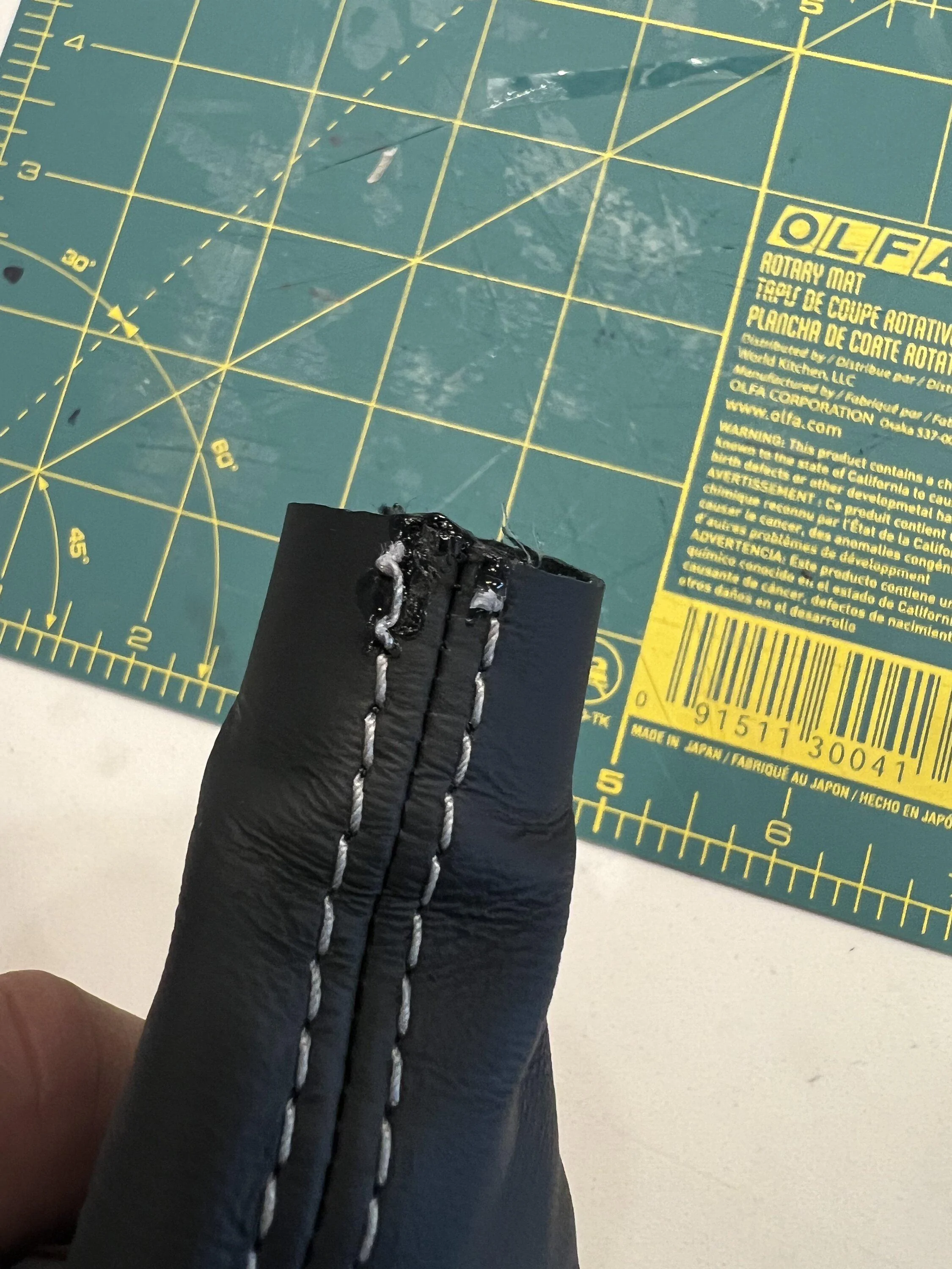

Step 8: separate the boot from the knob. Be really careful as you might get a little thread fraying or even coming loose
Step 9: I had a little fraying and some threads that popped out so I super glued them to the boot and super glued the top of the boot where the two sides of leather meet, on both sides, just for the reassurance because I didn’t want the threads to come out slowly over time. Others may not have this issues.
You now have a shift-knob-free shift boot! Yay, no more uncircumcised knob *silence* …..😳…..

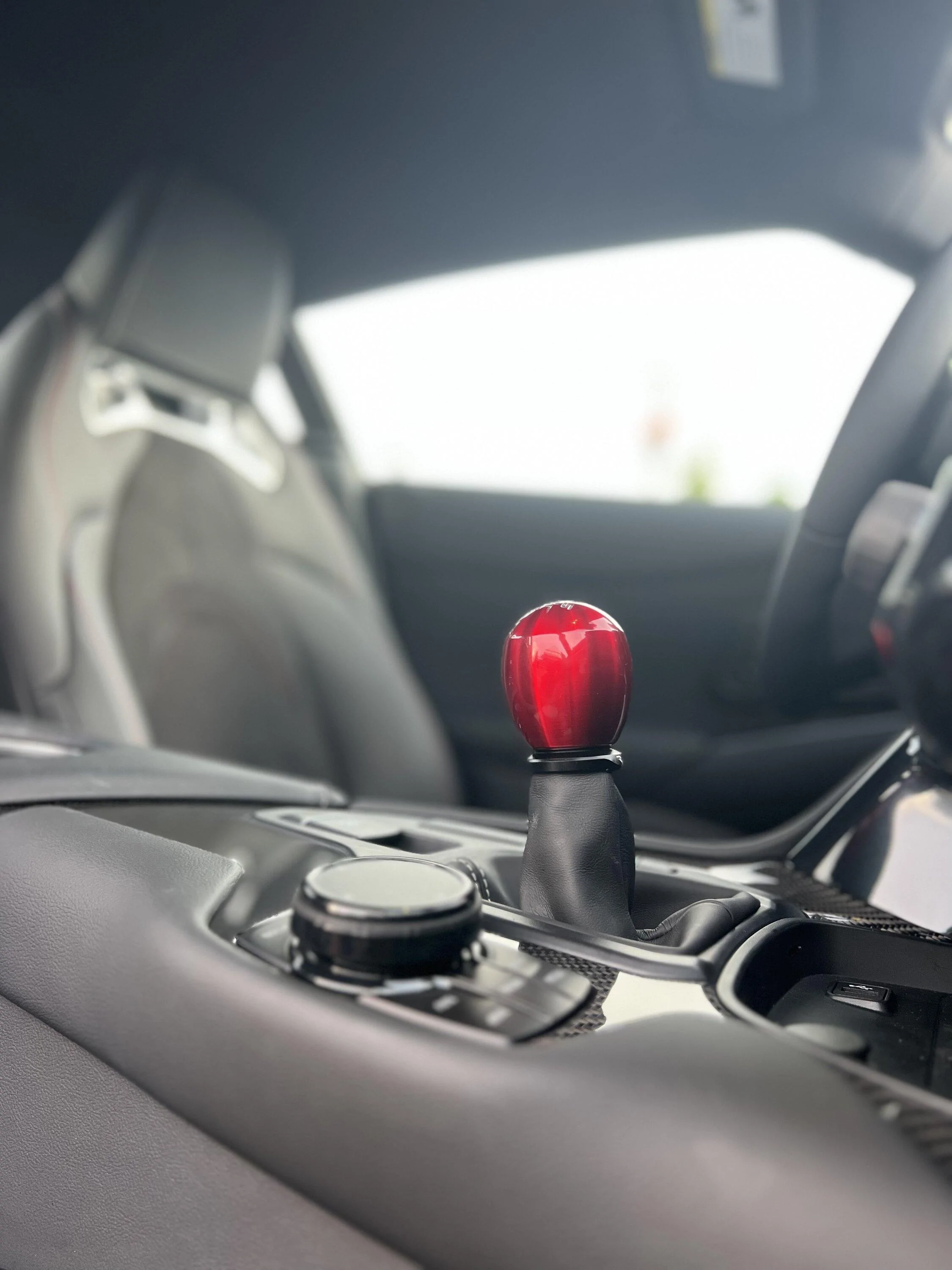

Step 21: test all 7 gears and make sure the boot isn’t too tight at any gear location.
Step 21: admire the new sexiness.

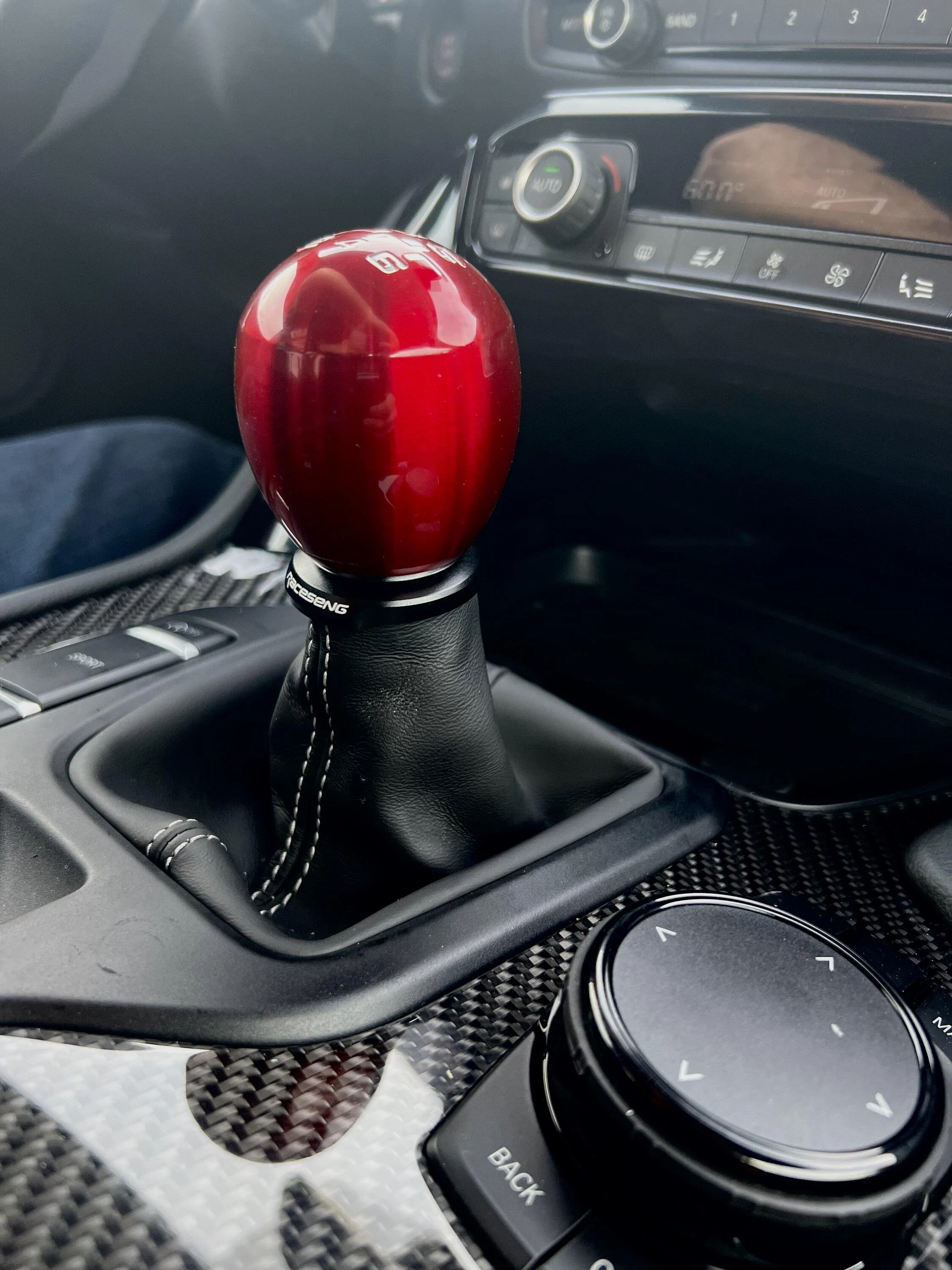

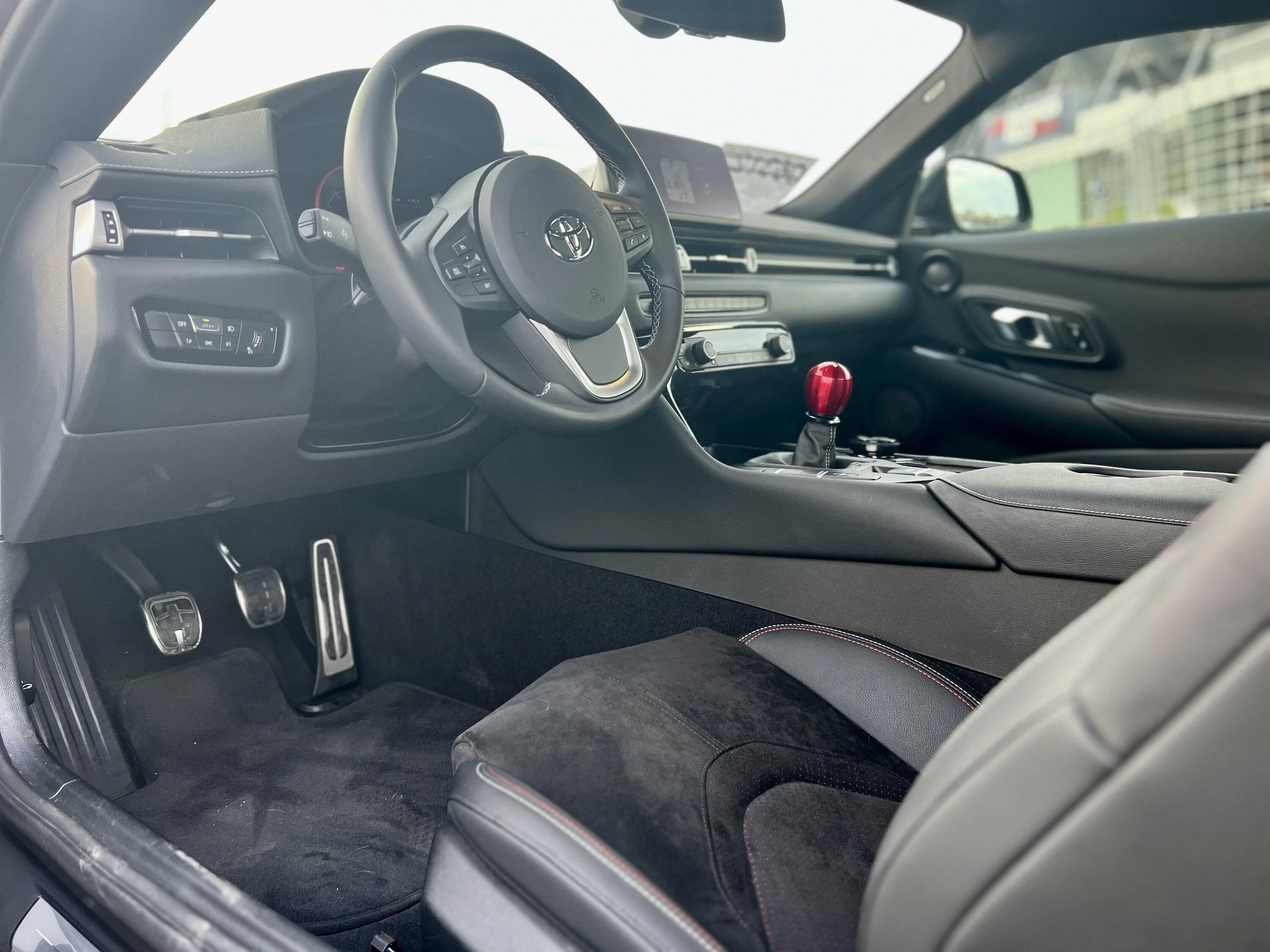

Nice write up and it's a good looking shift knob sitting on a table but totally out of place in the Supra interior in my opinion. In a nice anodised black I might be tempted but, red, no.

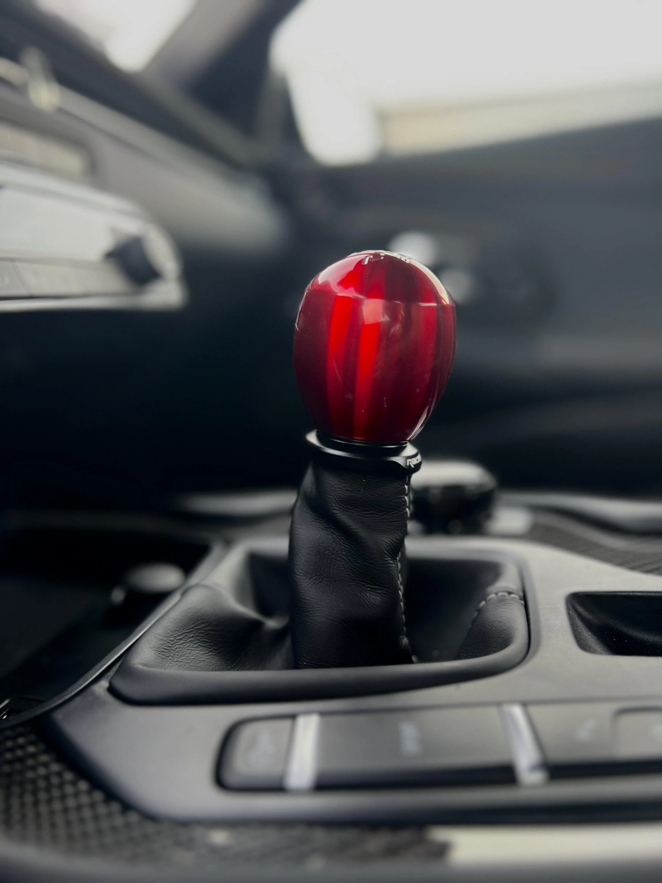

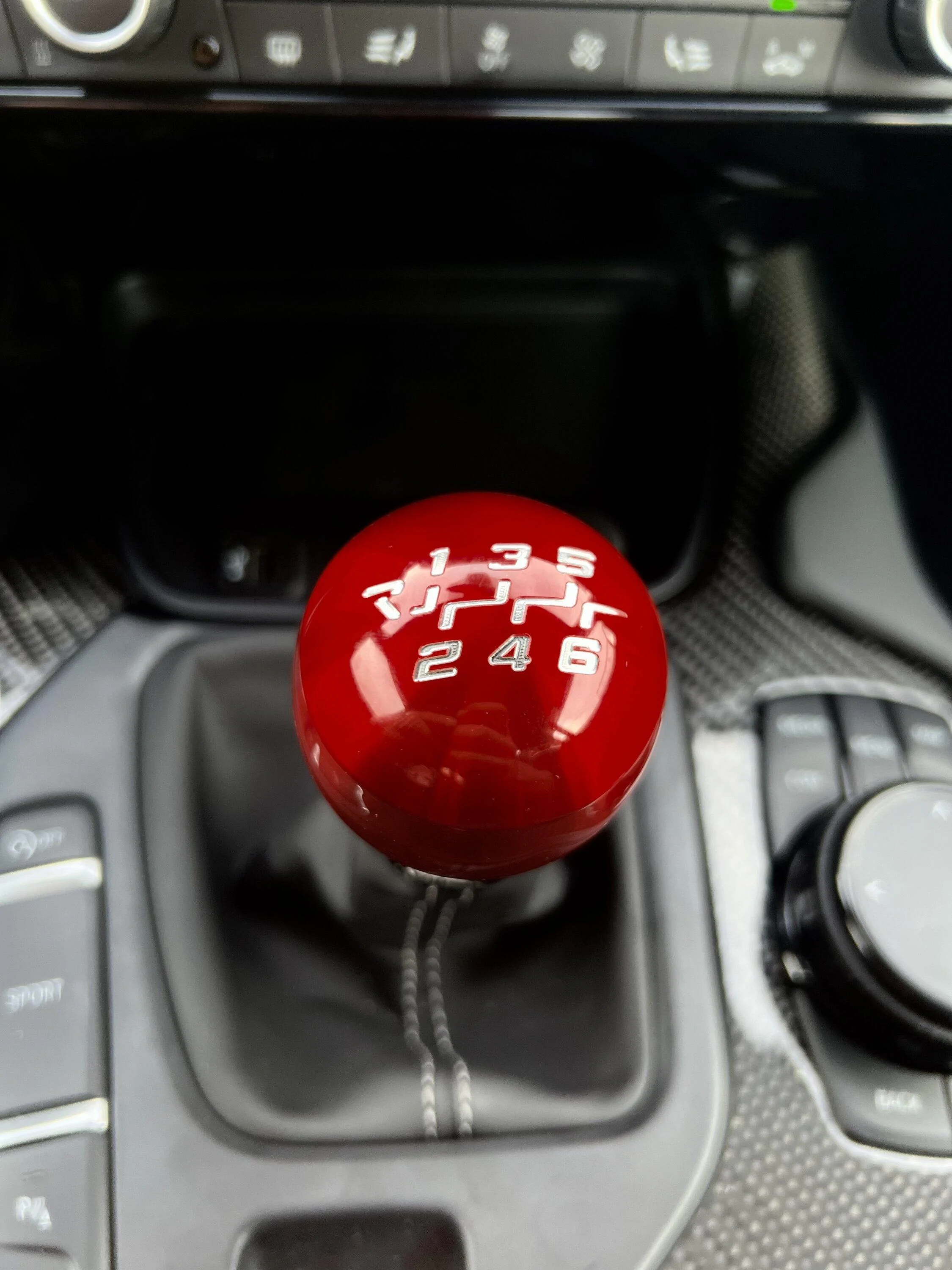

Absolutely gorgeous, looks factory too! A few questions, what stops the boot collar from rotating and moving up and down? Also how does the 635 grams feel? I had a steak around that size and that weight condensed into a small ball seems pretty heavy.

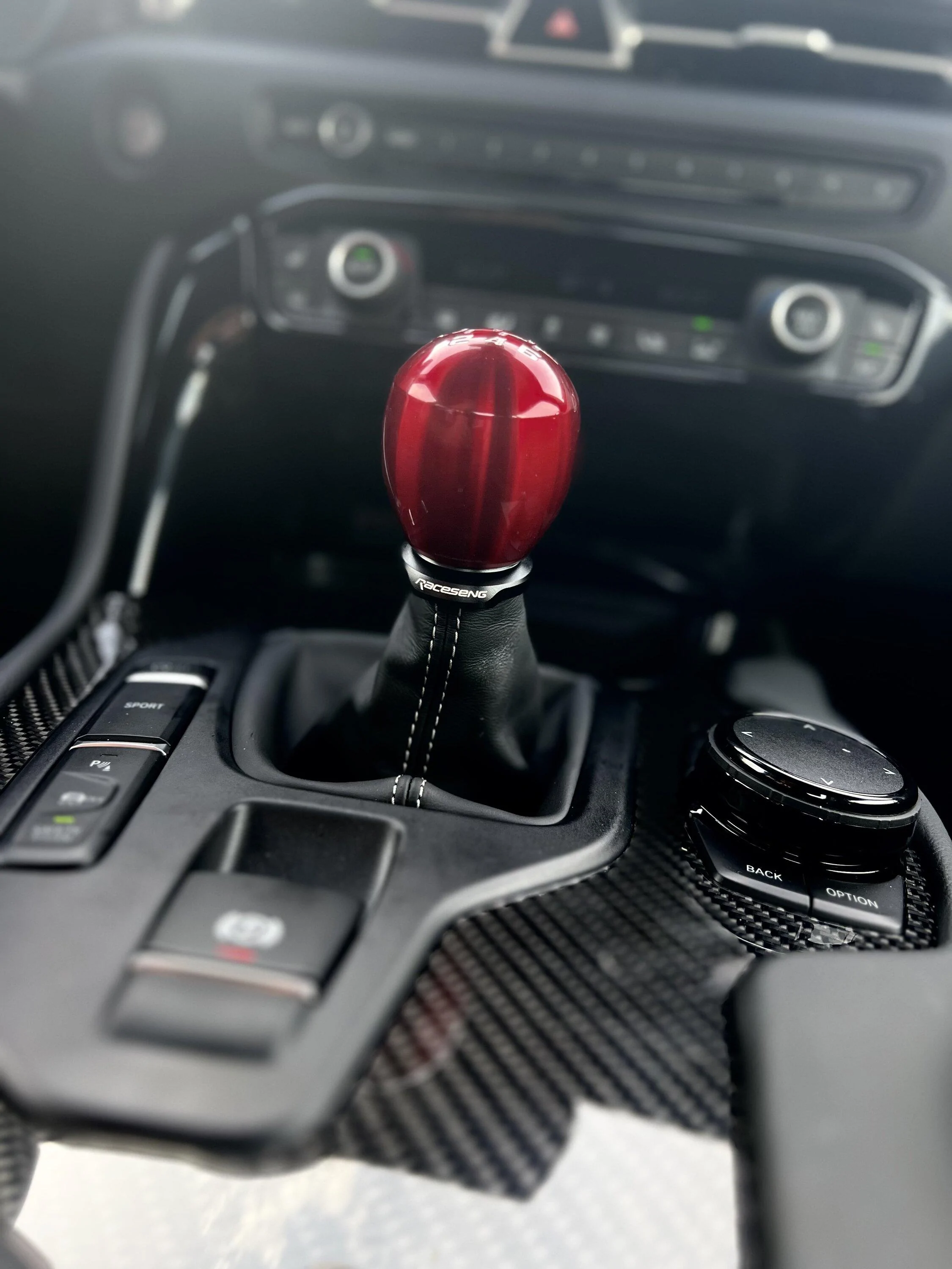

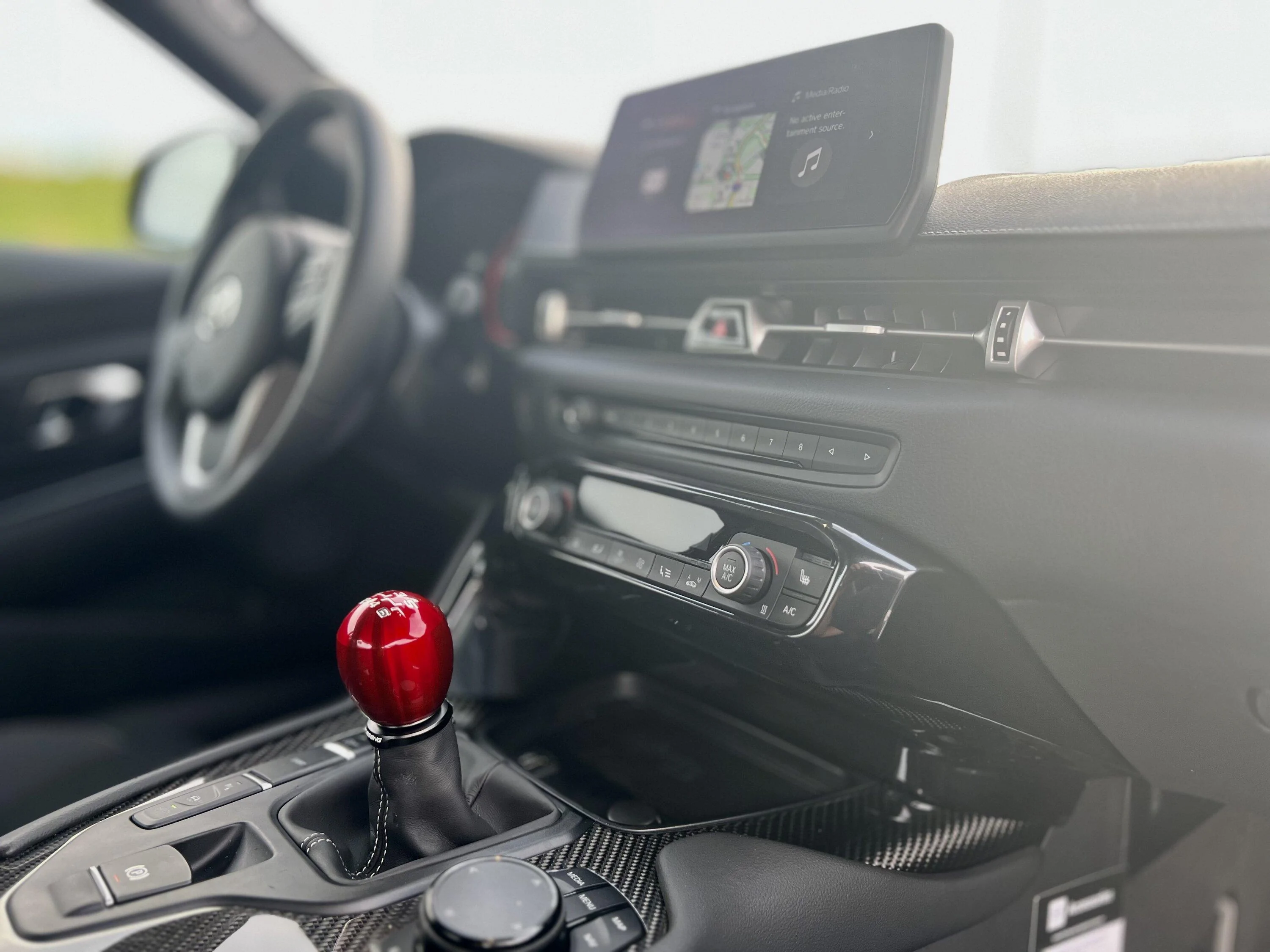

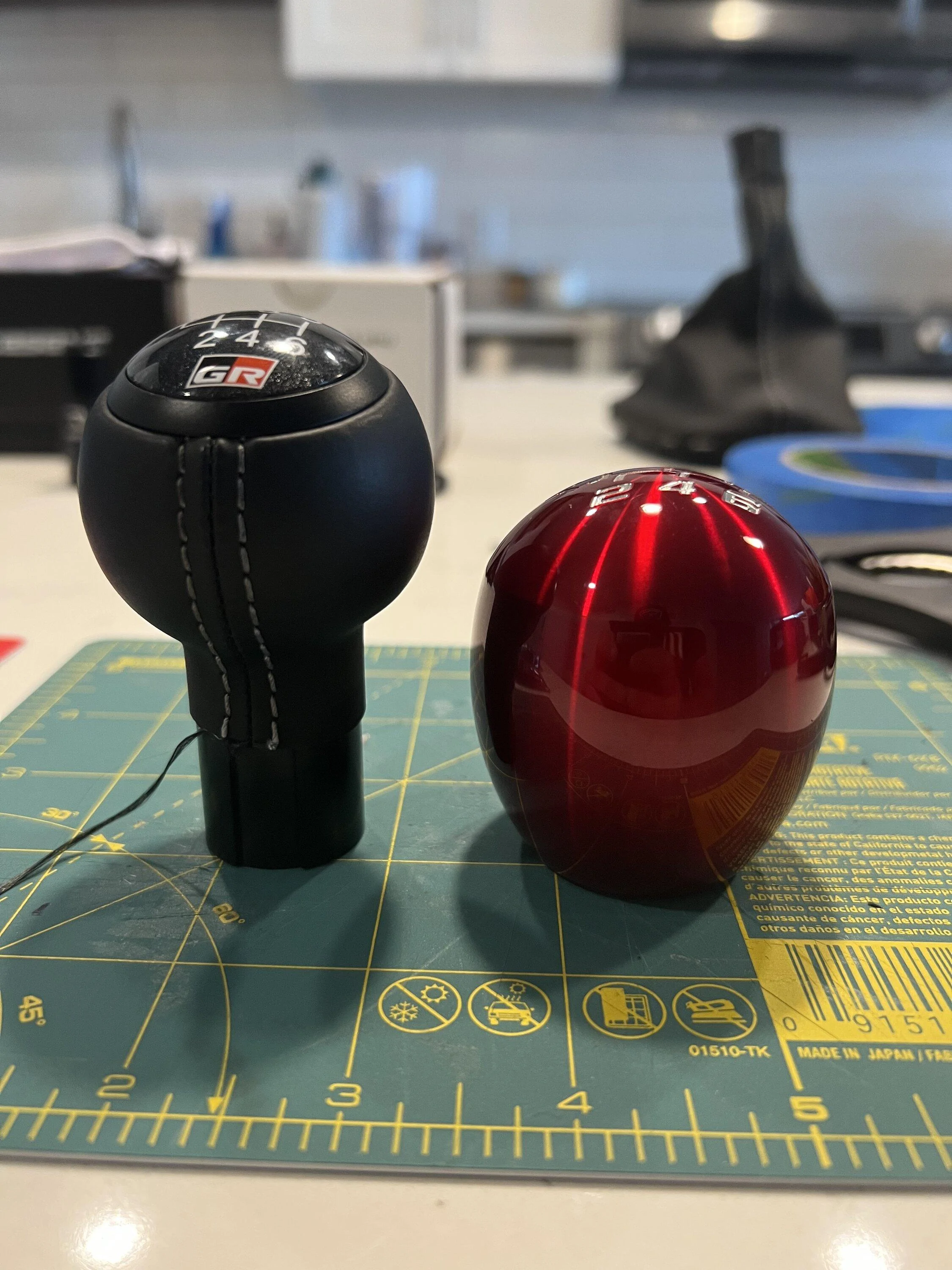

Hi Phil, thanks for the props on the write up! I actually chose the red for the exact reason of wanting the shift knob to stand out in the all black interior. To me, the huge reason why I finally picked up a Supra was because of the manual transmission. It is the highlight of the car in terms of my interaction with it. So, I wanted a piece that would emphasize that--A shift knob that would pop in the interior so that peoples eyes would be drawn to it when they look inside the cabin, almost like a crown jewel per se. And because I have the base seats with the alcantara with red perforations and red stitching, it actually all ties together really nicely, especially when the car is running and the red in the gauge cluster shows. I bet if you saw it in person, you would maybe change your mind about it being out of place. Regardless, different strokes for different folks. 😃 That's what makes life interesting. If we all liked the same stuff, life would be super boring. Luckily for you and everyone else, Raceseng has dozens of options. I am a really big fan of their stuff. Very High quality even down to the packaging.
The boot collar stops rotating once the knob is finally tightened down all the way. The pressure from the knob tightened down and where the collar sits on the NTA is what keeps it from rotating and moving up and down. Which is actually really nice because you can fine tune the collar up until the last second of knob tightening. I got the letters to center up on the stitching.
Yeah, it is a pretty hefty part for sure. The extra weight is definitely noticeable. It feels nice on the throws. Getting it into the gates is a little easier and smoother. When I first got the shift knob in the mail and took it out of the box, I was blown away by how heavy it was. Almost felt too heavy. But once I got it in the car, it feels right at home.
Yeah I would do black or silver but it does look very nice! Don't like how the OEM leather goes over the boot AND shift knob so it all looks like one piece, this style breaks it up more which looks better I think
I actually liked how the stock knob felt, but I agree, I definitely didn't like how the OEM leather from the boot goes over the knob from a visual perspective. Uncircumsized is what came to mind. If they would have done the shift knob in leather but made it a separate removable piece that would have been more ideal imo. And I feel you on the black and silver. But like I said in my reply above to Phil, I wanted the shift knob to pop, like a crown jewel. Thanks for your post!

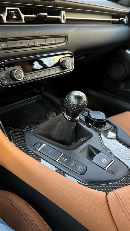

I tested this black nitro when I first got in contact with Raceseng. This might be a bit more up your alley.
Yea thats more my line. I don't want something that shouts at me every time I get in the car. Nice Alcantara boot as well, or suede maybe. I'm not a big fan of the shifter boot integrated with the knob as the standard one is either.

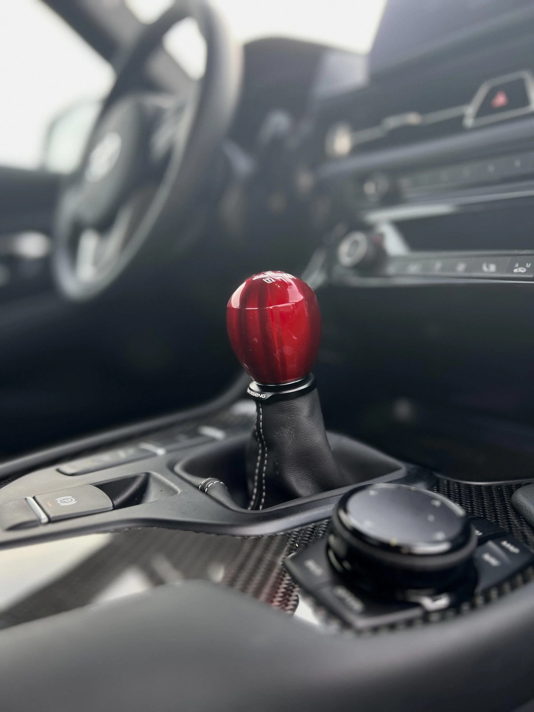

Update! Switched to a Raceseng Contour knob awhile back. I like the shape better than the Slammer and the brushed aluminum finish of this shift knob looks great in the interior with the silver on the dash and seat inserts.

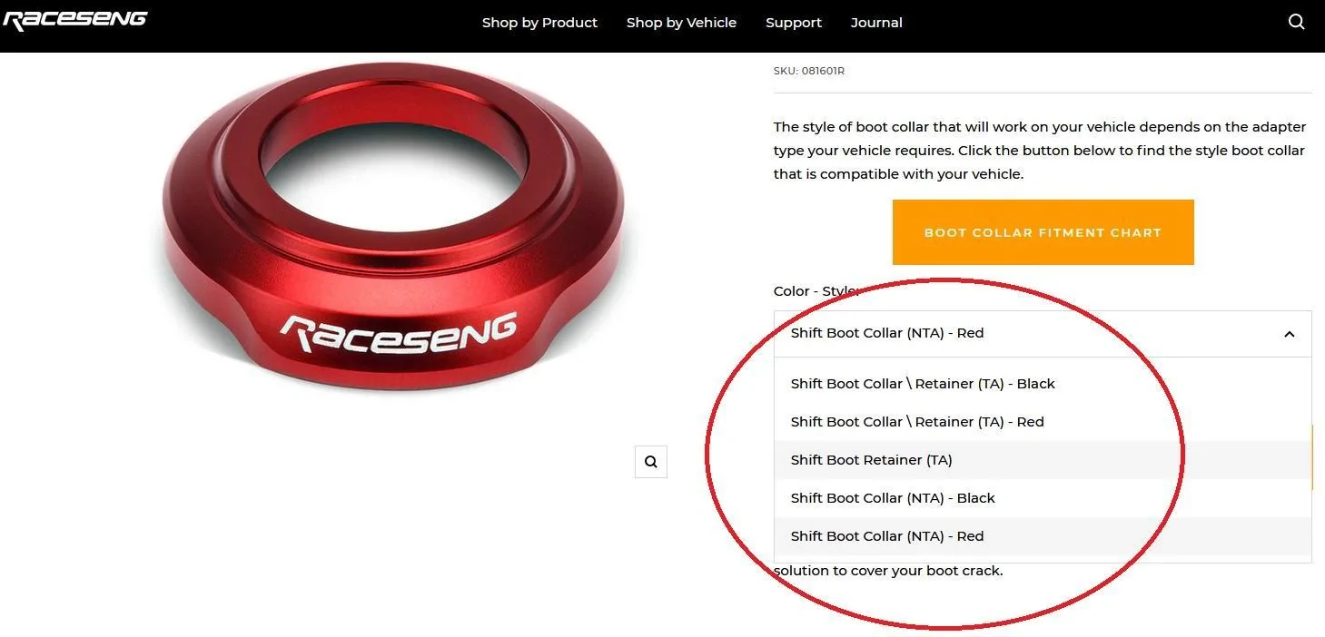

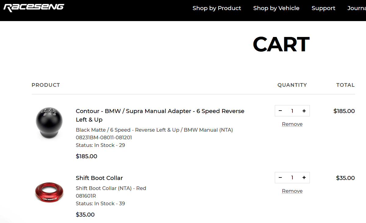

Can you guys please confirm which collar option I should be going with? I'm likely going to order the Raceseng Chicane Knob or the Contour knob but can't figure out which of the three collar options I should be getting.
UYCR
Ubec
Dec 5, 2022
195
164
Harrisburg, PA
A91-MT
@Jmanlevan & @UYCR
Any of the two NTA (non threaded adapter) are what you want to get to match the adapter for the shift knob.
