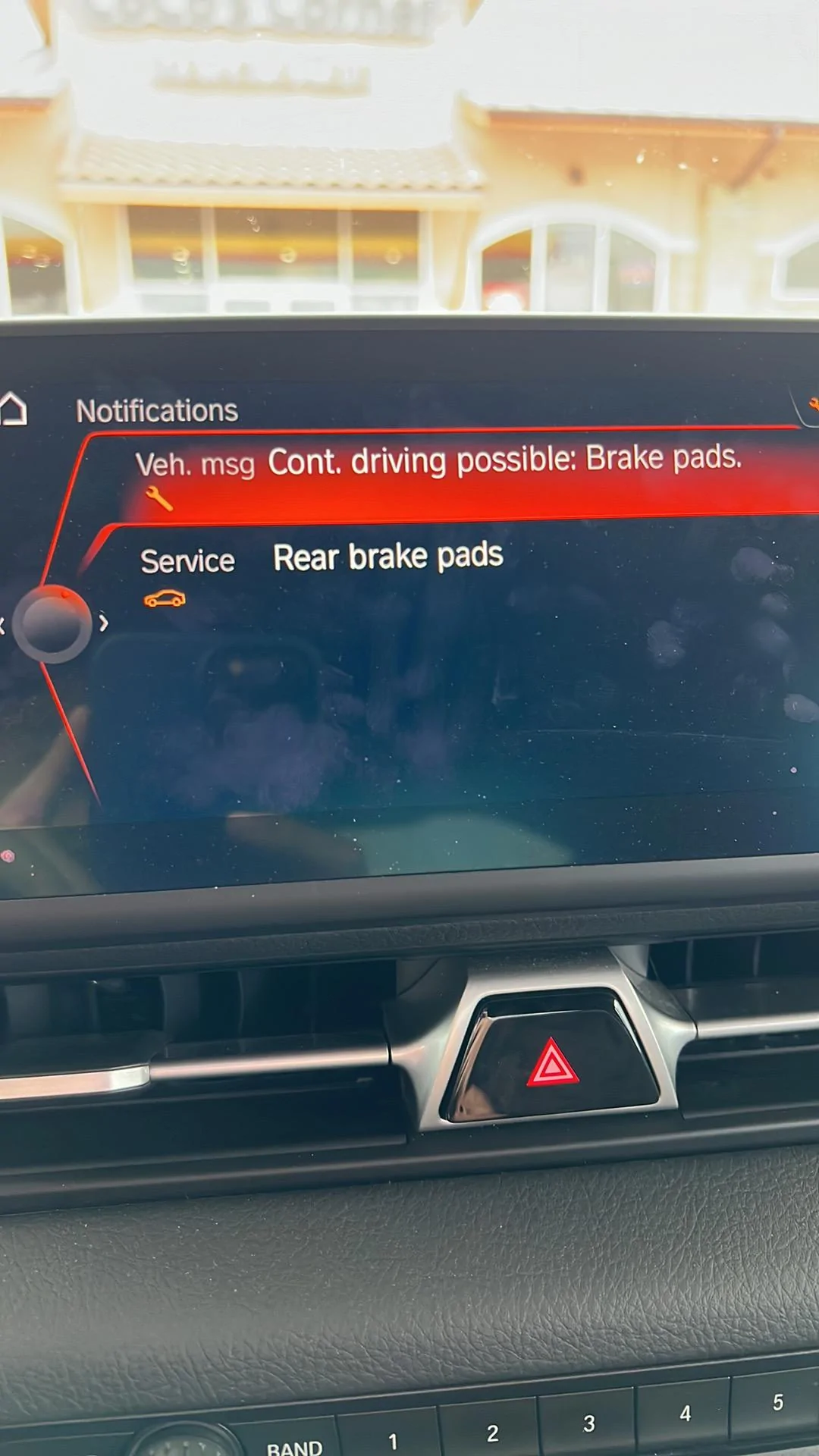

Seems I need to order sensors as well. Does anyone know where to get these? The rear pads tripped a warning first, then I got a more serious warning about brake service.

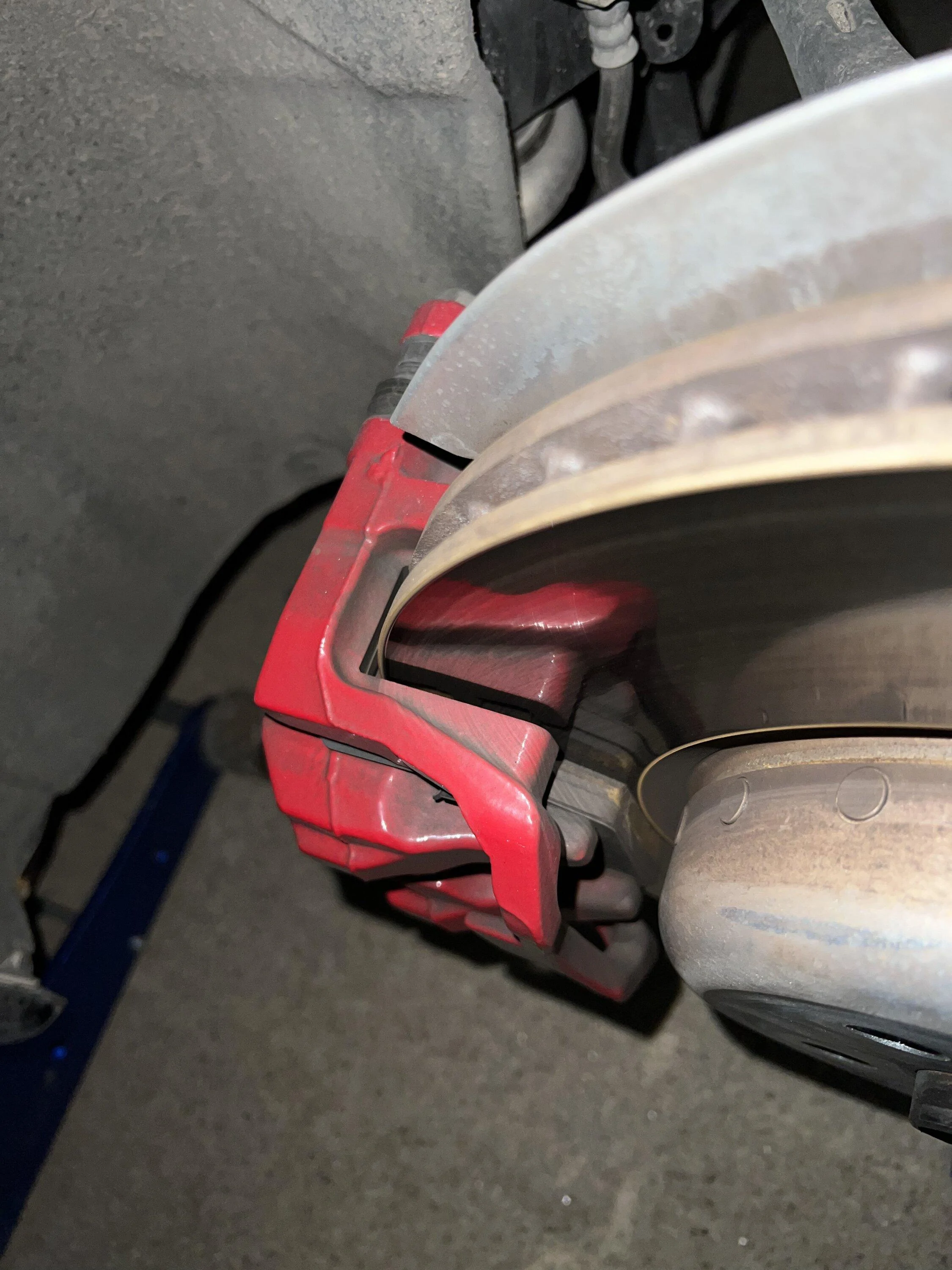

I checked the pads and they do indeed only have a few mm left in the rear.

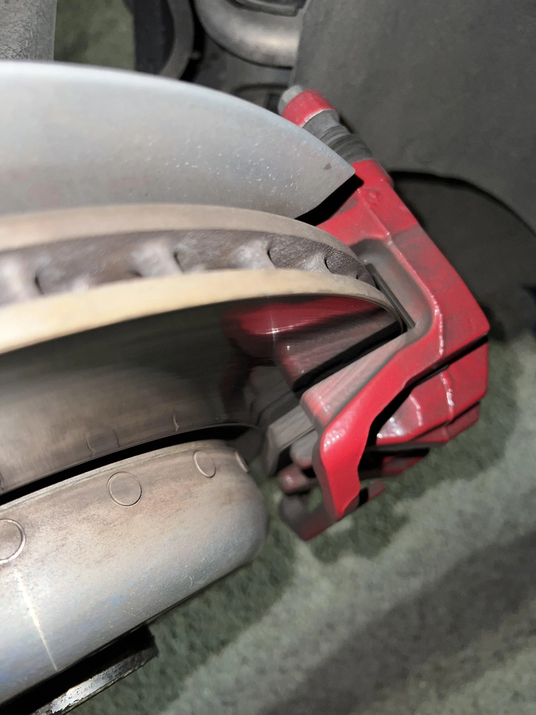

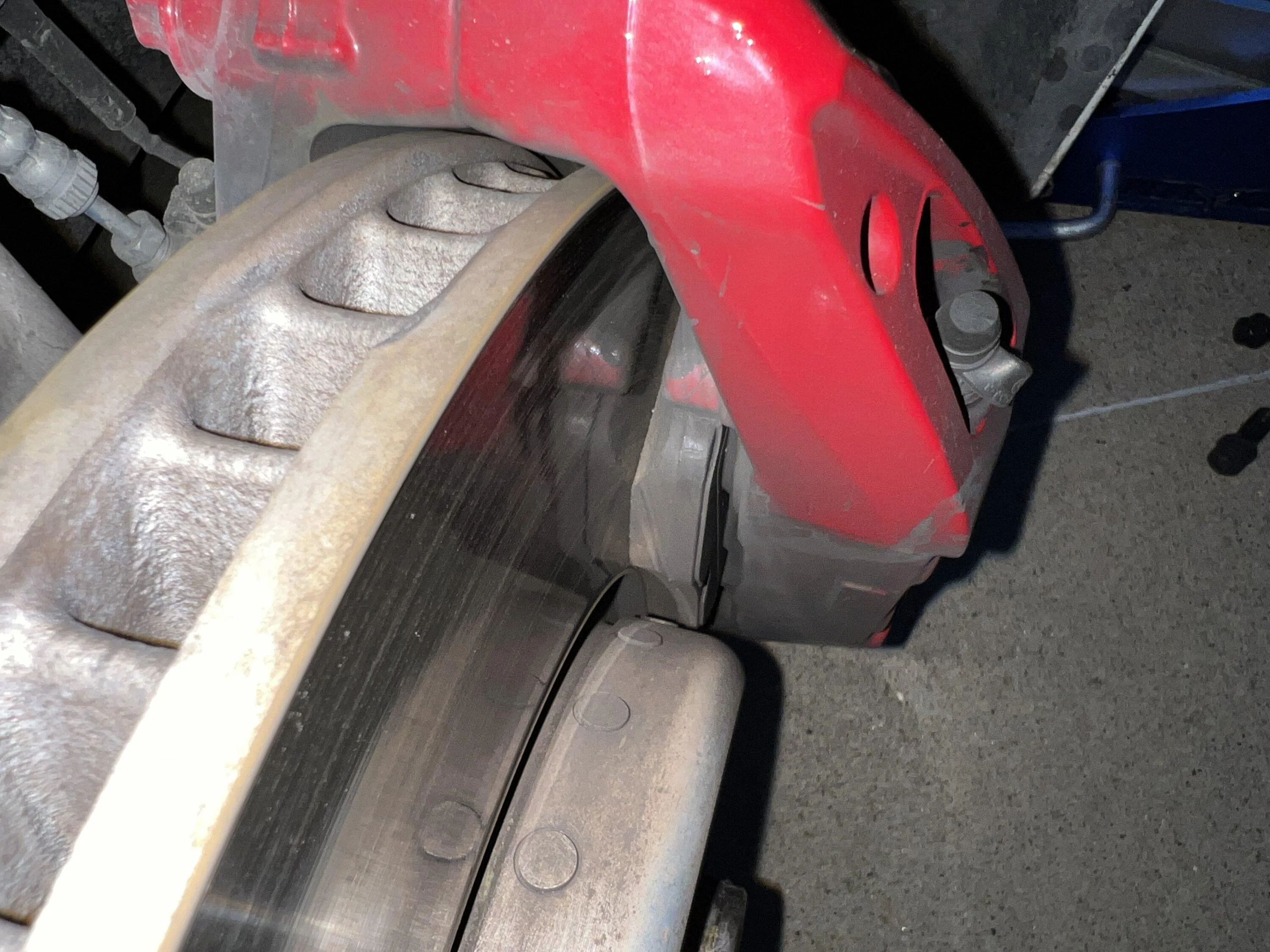

Fronts:

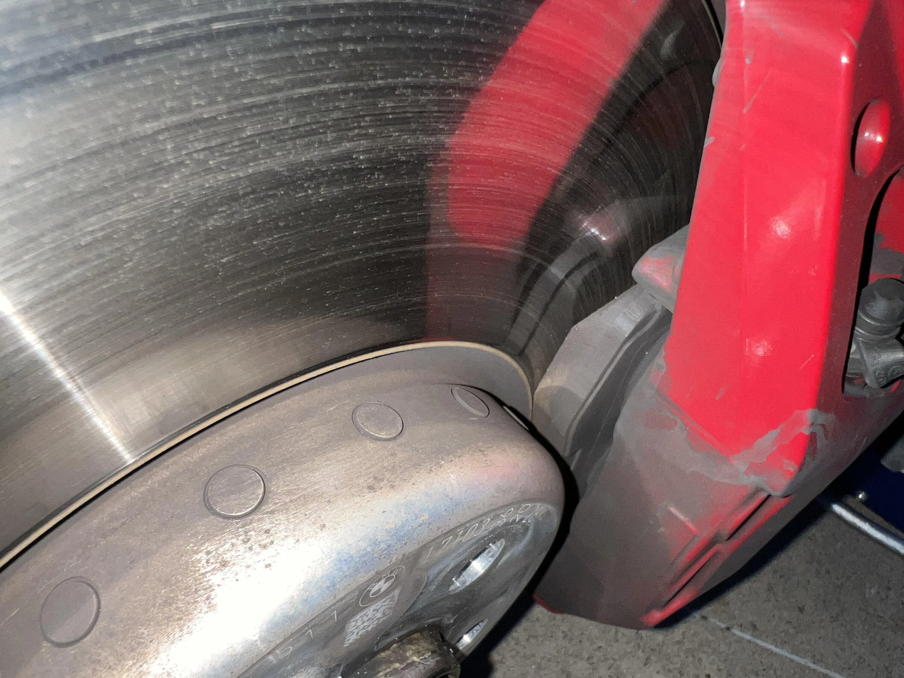

Rears:
Errors:

OEM rotors, although from your photos it looks like you have a ton of life left in your current rotors.
Here are your options for those:
OEM rotors (BMW part #'s)
Front Left: 34116860911 (348mm)
Front Right: 34116860912 (348mm)
Rear: 34216860925 (345mm)
Brembo Rotors (people that make the OEM rotors)
Front Left: 09D09413 (348mm)
Front Right: 09D09513 (348mm)
Rear: 09D09613 (345mm)

Front wear sensor: 34356877085 (bmw part #)
Rear wear sensor: 34356870354 (bmw part #)

Would I need to resurface the rotors? My rotors do have a tiny bit of a lip to them.

You can, just note that the slightly thinner size after resurfacing will cause them to change temperature more rapidly.

The front pads appear to have a ton of meat left on them. I'd just throw a set of rear pads on and be done. I highly doubt you need new rotors either way.
I am surprised the rears went away with that much left on the fronts, though. My experience tracking the car has been the opposite. I started with a new set of Endless pads F/R and have burned through a set of fronts while the rears still have at least 1/2 their life left.
