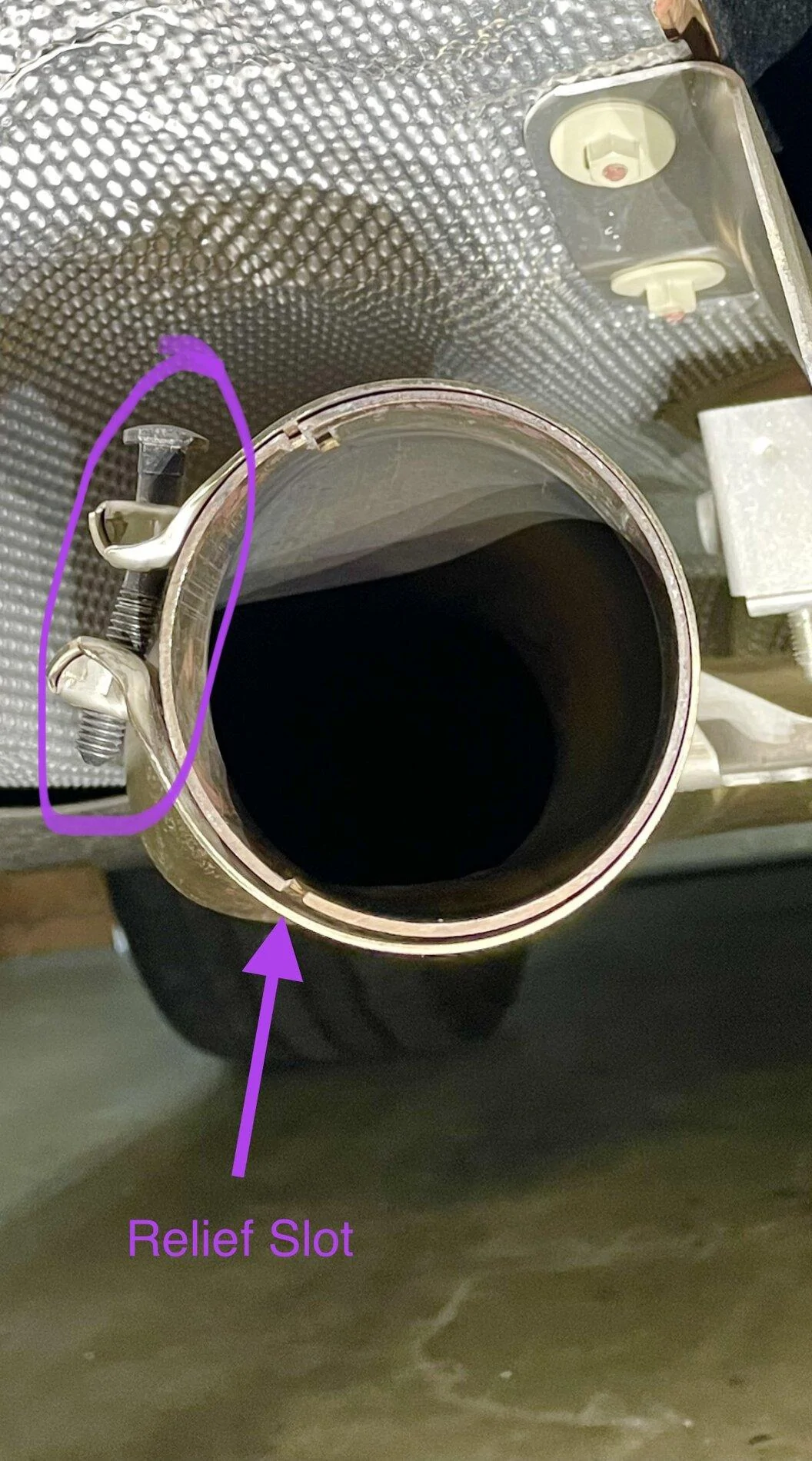

You need to pull apart the band clamp from the bottom side. Underneath it you will find a slot with a relief cut into the pipe. Use a pry bar or large flathead screwdriver to open the joint and release the exhaust from the downpipe.
