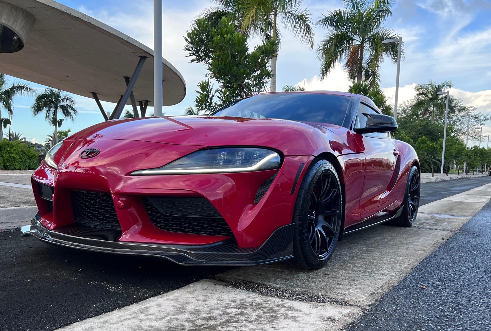

MB Style Front Lip:
I give it a 95% fitment. the front fit was near perfect but the sides had to do some foam filling on the bumper for it to stretch and stick to the sides of the lip.

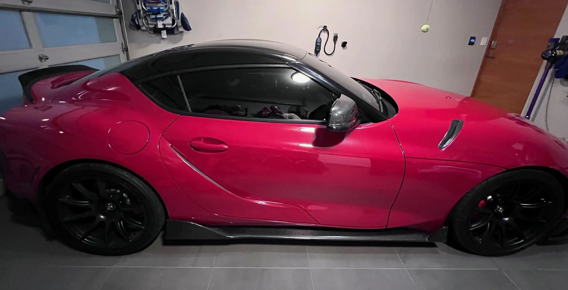

MB style Side Skirts:
Fitment was also 95% but the front side hangs loose. I have the armaspeed rock guards and drilled a hole thru the guard towards the sideskirt and inserted a push pin and that made them pretty solid.

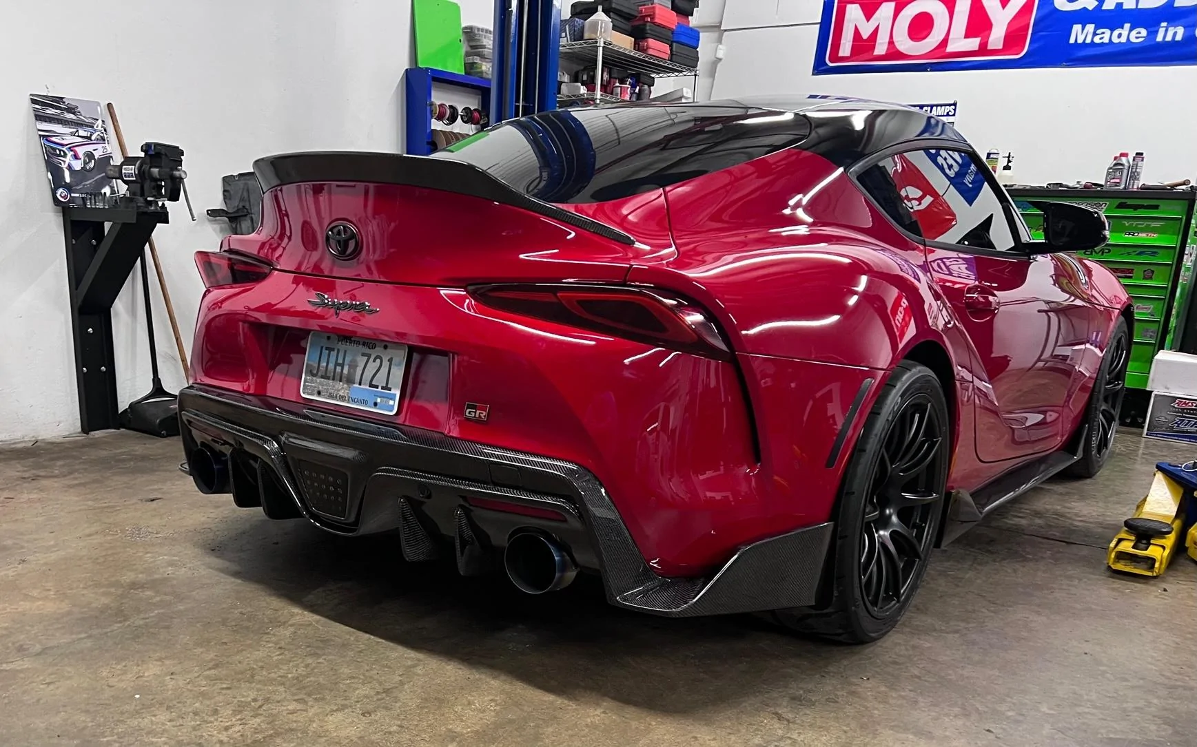

MB Style Rear diffuser:
I give it probably a 85% fitment. The rear side fits perfectly BUT the sides were it curves with the bumper I had to drill the bumper and install push pins to make the bumper flush with the side spats. Fitment was not so good on them.
The issue with all of these Seibon parts is that it replaces the clips on the original pieces by some tabs that dont really hold on to anything and that makes this pieces feel loose. Even if you bend those tabs after installed. If they could only make those tabs to clip on the original slots the fitment will be much better,

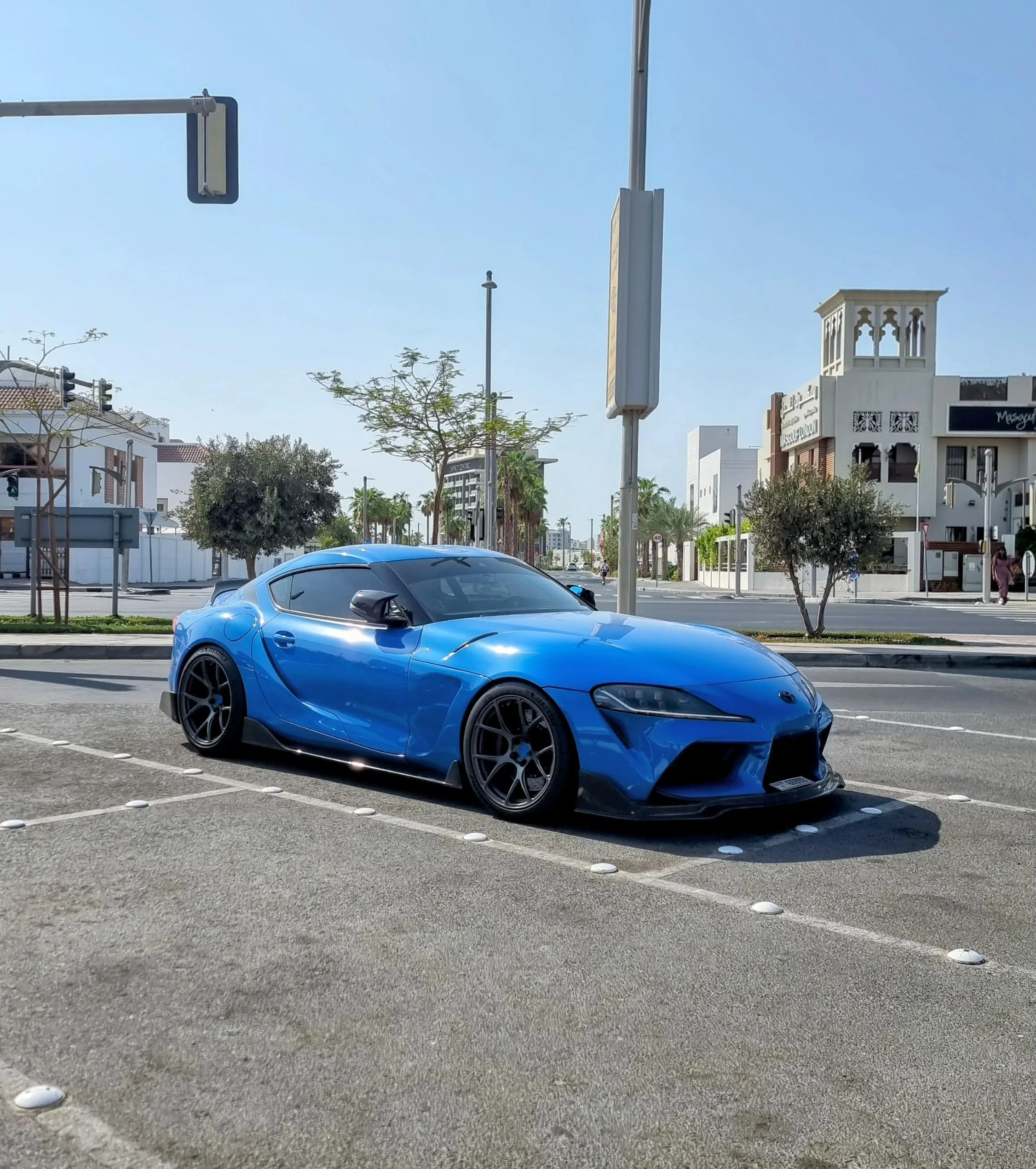

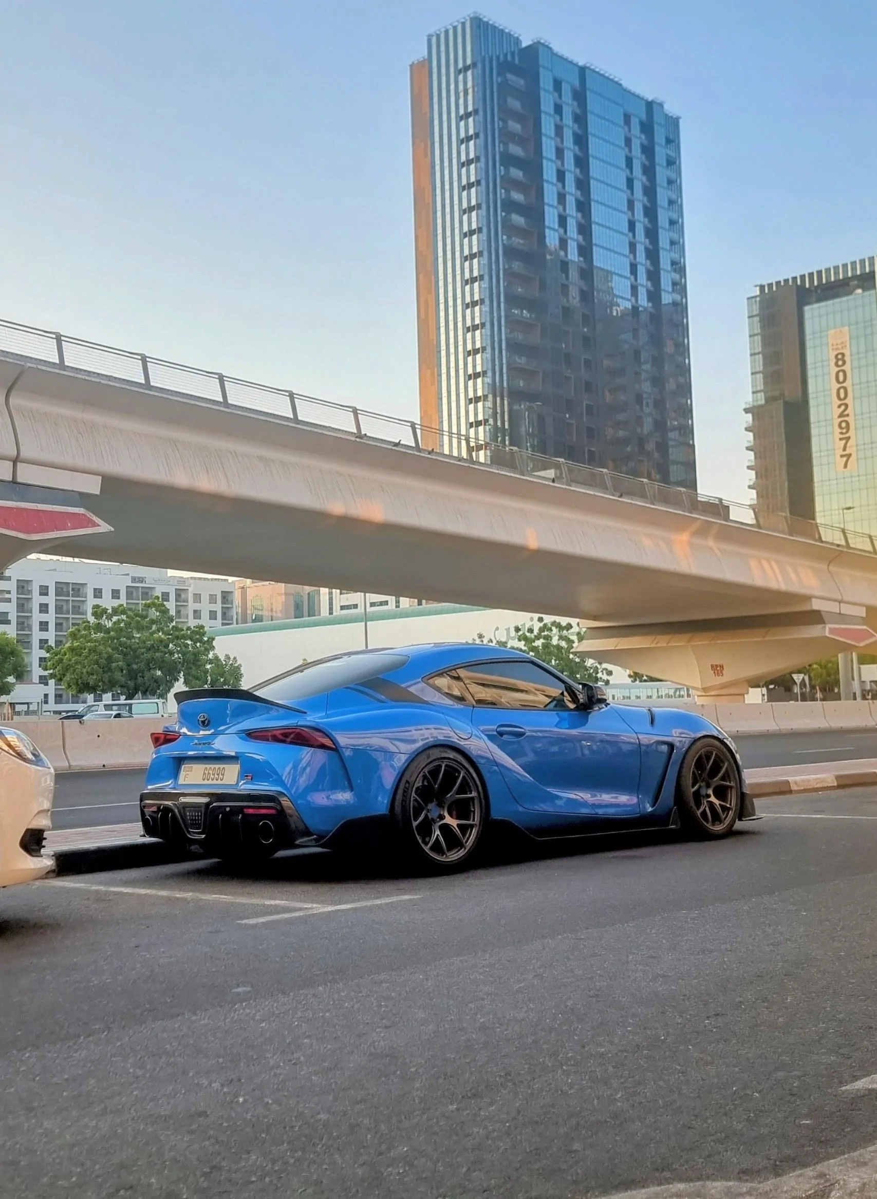

Hello there,
I will add to it because more the merrier, lol.
I too have the same set up as you in terms of ground effects and would like to share my feedback because it might be slightly different to yours.
The front lip for me was 80%, the edges were bad, u could see the body colors mounting points of the factory lip. So I messaged Seibon, and Roger sent me a pdf (attached in next message) that really helped the edges tuck in a lot. Now the lip fits 90% my only issue is the center section. The Seibon lip doesn't occupy the entire area it should in the center.
The side skirt was 95% like u said, agreed. If I really look for it I can see the mounting point a bit.
The diffuser was 90% for me, the edges did not sit in all the way, but din't stick our enough to be obvious.

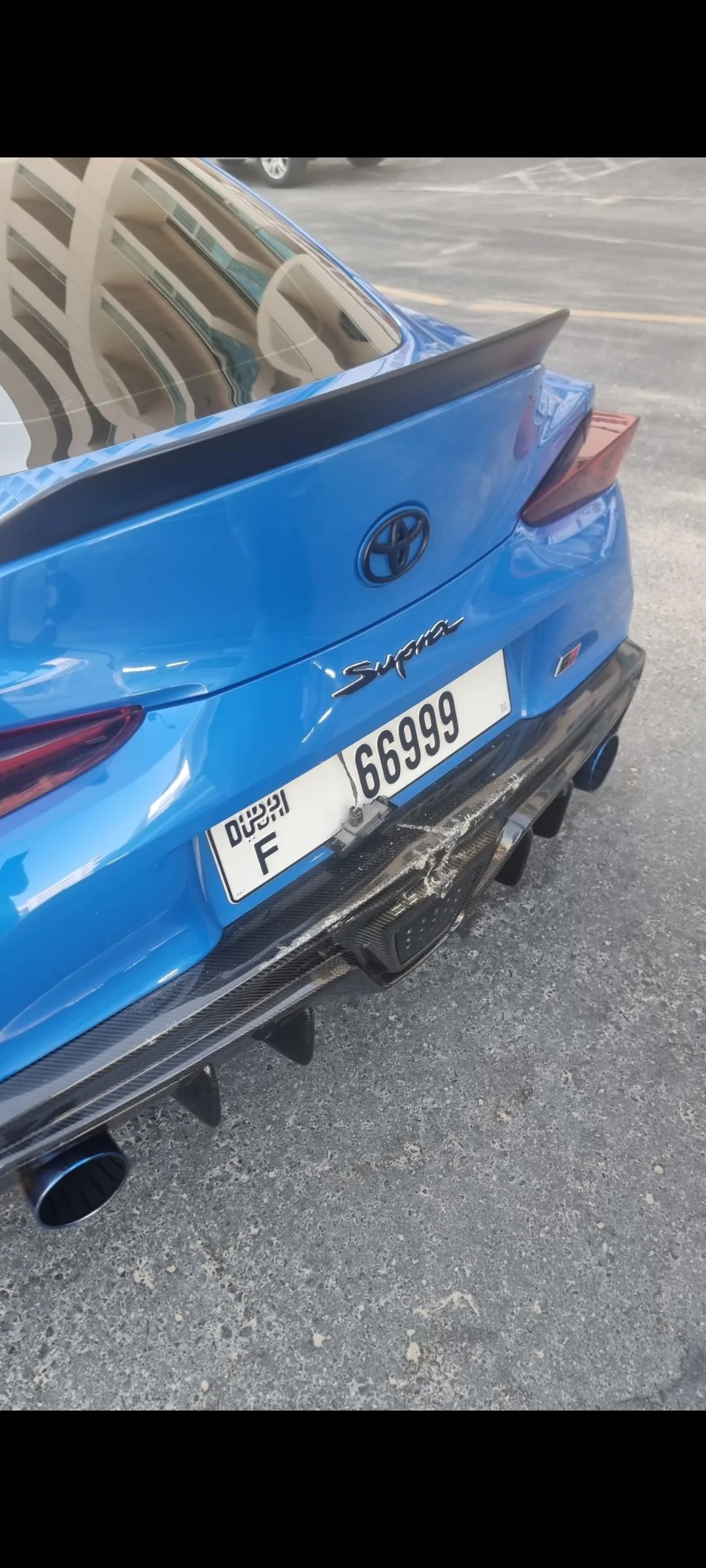

Bonus info: I did have a car rear end me at about 20kmph and the diffuser took it quite well actually, It does need some work done, but the structure is intact. Got a quote of 1/3 the price of a replacement for the repair.
