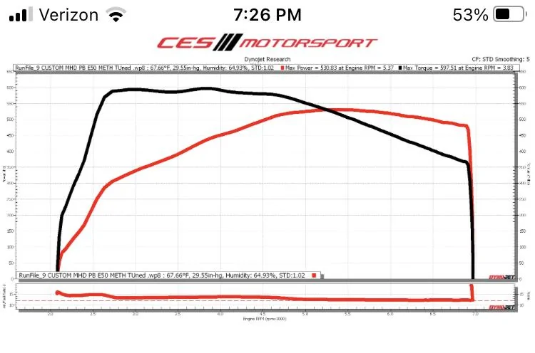

From my research, looks like the max whp for e50 is around 480-500whp.
(Currently Tuned on bm3.) If that makes a difference.
What's the most the turbo can push for torque numbers?? I've seen over 600....

500 whp, 600 wtq are solid, mostly realistic numbers for a B58 with downpipe, E50, and custom tune.

Itā€™s probably 500-515WHP and 575-590WTQ pretty much the limit of the stock turbo Iā€™m getting custom tuned by pureboost soon on E50
