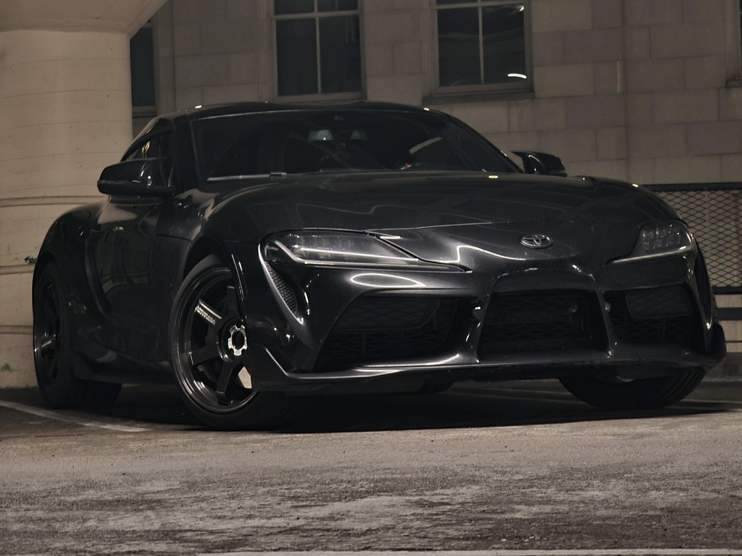

I've been meaning to do this for a while, so I figured I'd put something together.
I'll add some post-dated progress pics in the future, but as it sits.

Current Form

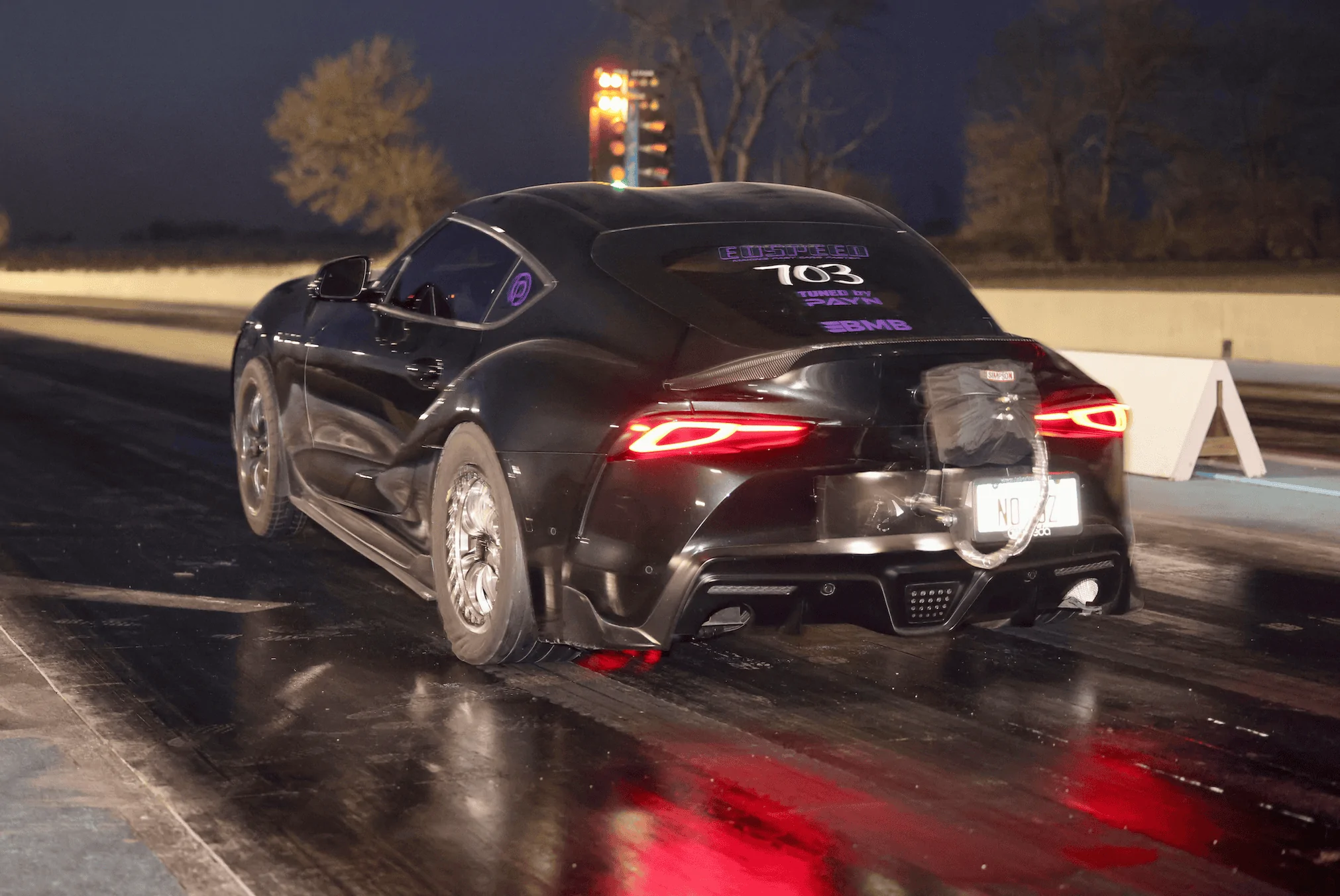

After all that shit, it's finally in the 8s. Next up: something to control the wheelies and push a little harder to get onto that top 20 list. It would have been enough two days ago, but it was a busy weekend for the supra drag racers.
