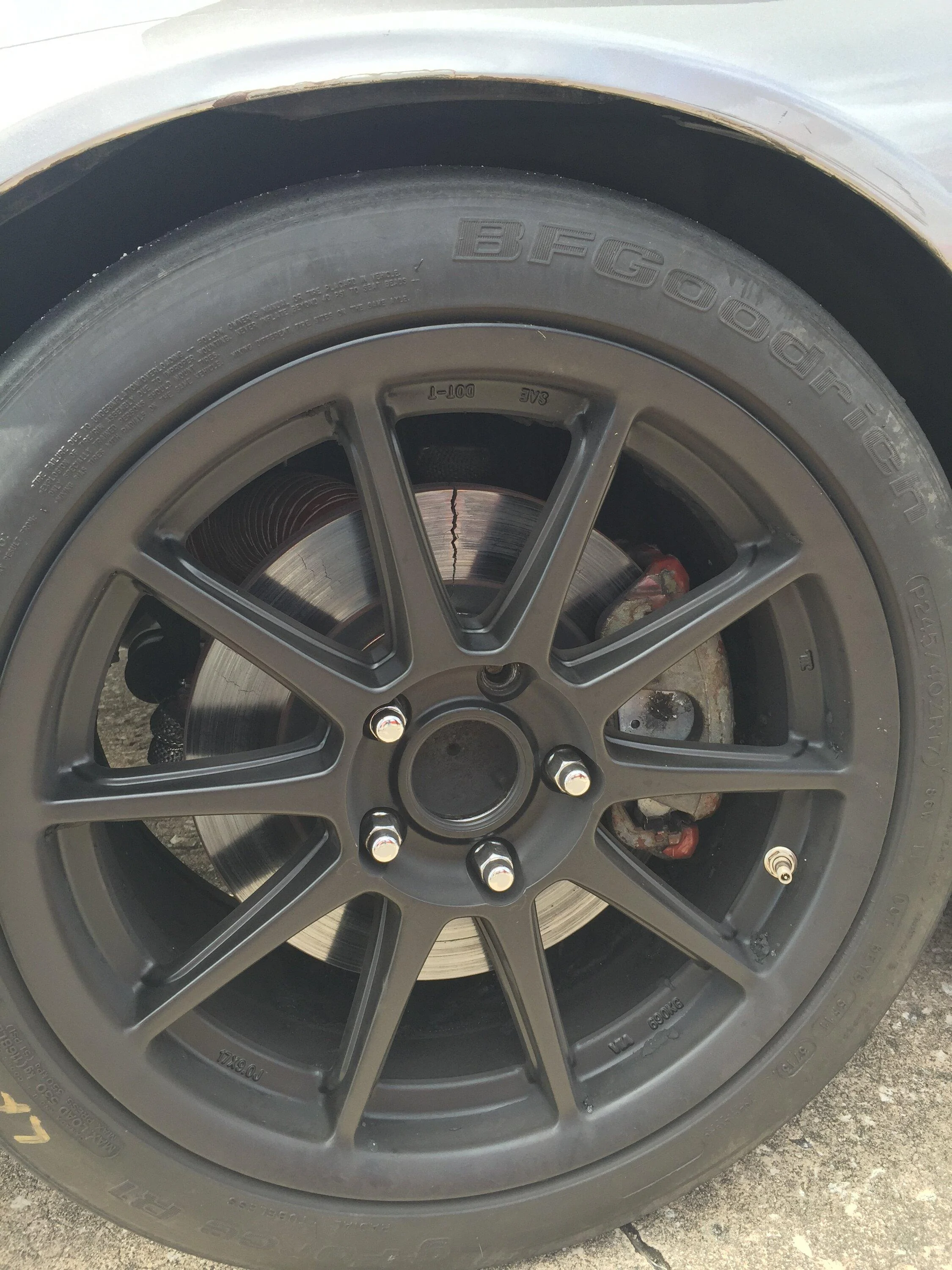

Cross drilled rotors that are good are actually a bit of a misnomer. If they have been drilled after casting. That is bad. They will most likely crack and fail. "Cross drilled" rotors that are good are actually cast with the holes in them.
Slotted rotors obviously won't have that problem.
Both types of rotors were useful because brake pads used to off gas a lot and the gas is needed somewhere to escape to. Newer pads don't really do that. With modern pads, cross drilled and slotted rotors aren't really needed.
Now, if you go to ads for current drilled and slotted rotors, they have a list of other reasons why you should buy them. Personally, I remain skeptical. I have never once had any problems with a solid rotor.

Vented rotors, which are what we have, are awesome for track use. Slotted or drilled are nice until they crack. Which I’ve seen happen a lot! If they are changed often enough. However that rarely happens with solid or vented rotors. Hence most of us who track will use vented rotors. They are also known as “cheap” rotors because they are the least expensive of the bunch. It’s not derogatory in terms of performance, just price.
Not saying it can’t happen. But it’s so rare, the manufacturer replaced an entire set of 10 we bought. However, if you can afford really expensive drilled or slotted rotors and change them and the pads more often (or you have a sponsor), by all means go for it. There is a slight edge on paper. But you will burn through both the rotors and pads more quickly. Myself and the MX5 pro racers never noticed any fade from our “cheap” vented rotors 😉
