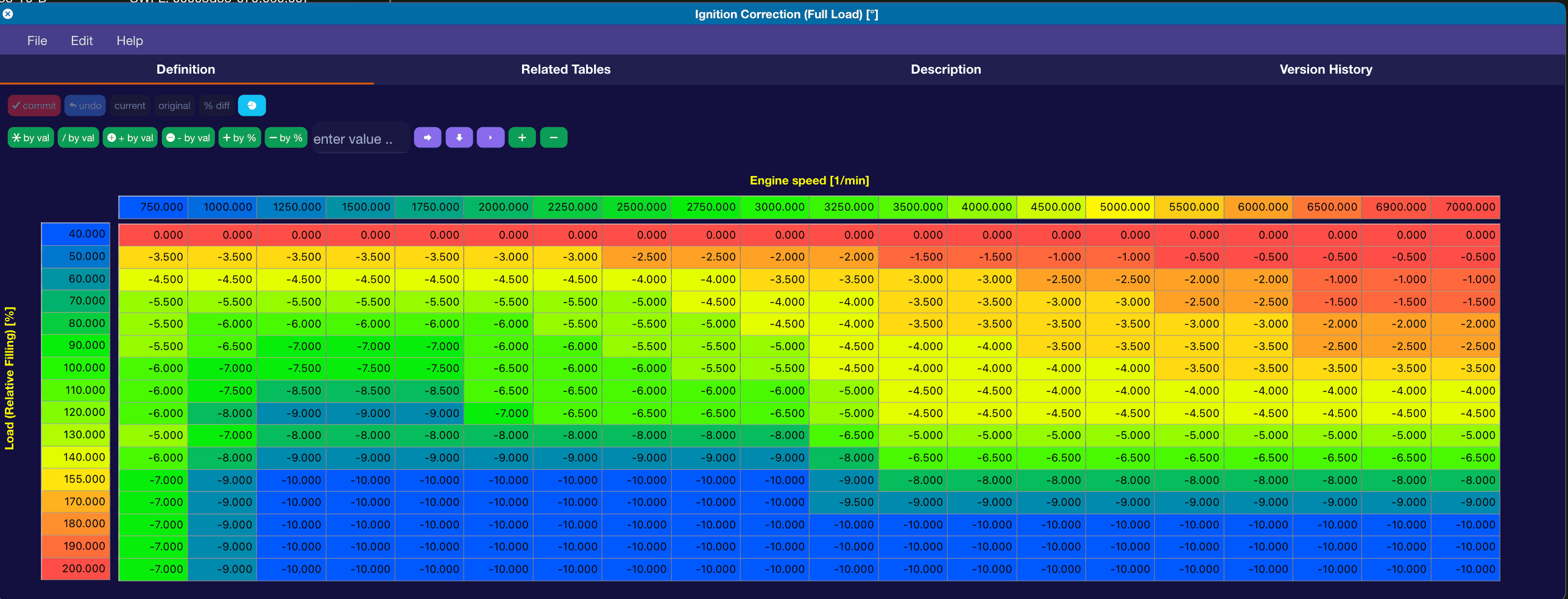

I do suggest taking a look at the actual ECU tables and strategy though.

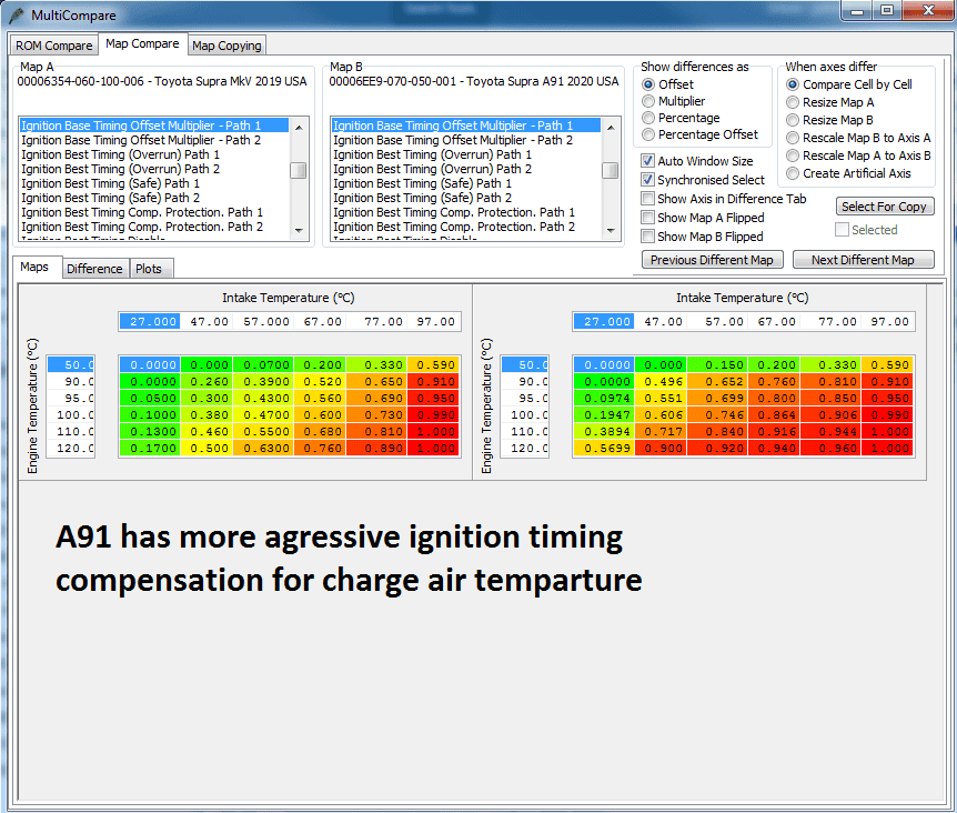

Just wanted to bounce some ideas off of someone else on here to accelerate my learning. Based on what I see here, my IATs of ~90F/32C and coolant temp of 195f/90c is essentially using the second row of IAT timing retard, between the first and second column. Assuming the DME linear interpolates and does not stepwise lookup, this means I'm around ~0.15x of the ignition retard scaling factor.
Since these are normalized tables, do you know what the raw Factor is?

Not quite, I believe that's the raw ignition table as a function of load and rpm. the table I grabbed from the Visconti a91 thread had a table of timing retard as a function of water temperature and IAT. Which I'm trying to figure out is additive or multiplicative with the other retard factors.

Not quite, I believe that's the raw ignition table, the table I grabbed from the Visconti a91 thread had a table of timing retard as a function of water temperature and IAT. Which I'm trying to figure out is additive or multiplicative with the other retard factors.
What I posted is the reference for the tables you showed. The table you showed is a lookup percentage of that table.
ah ha! got it, IAT timing pull is not a scalar value, it's a lookup on top of a lookup. so if i interpret your table correctly, that means IATs (by itself) will never contribute more than 10 deg of timing pull.
