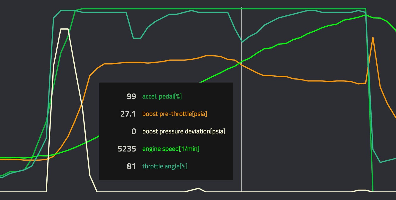

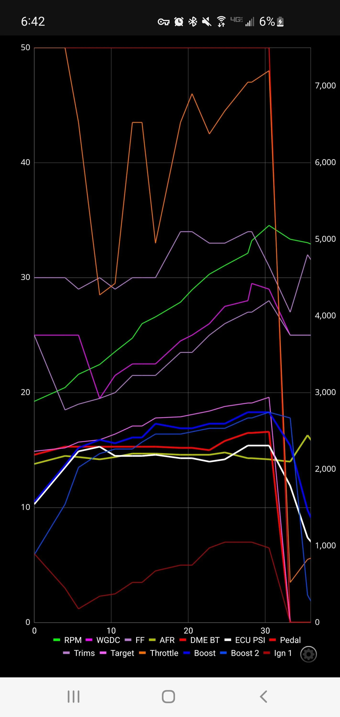

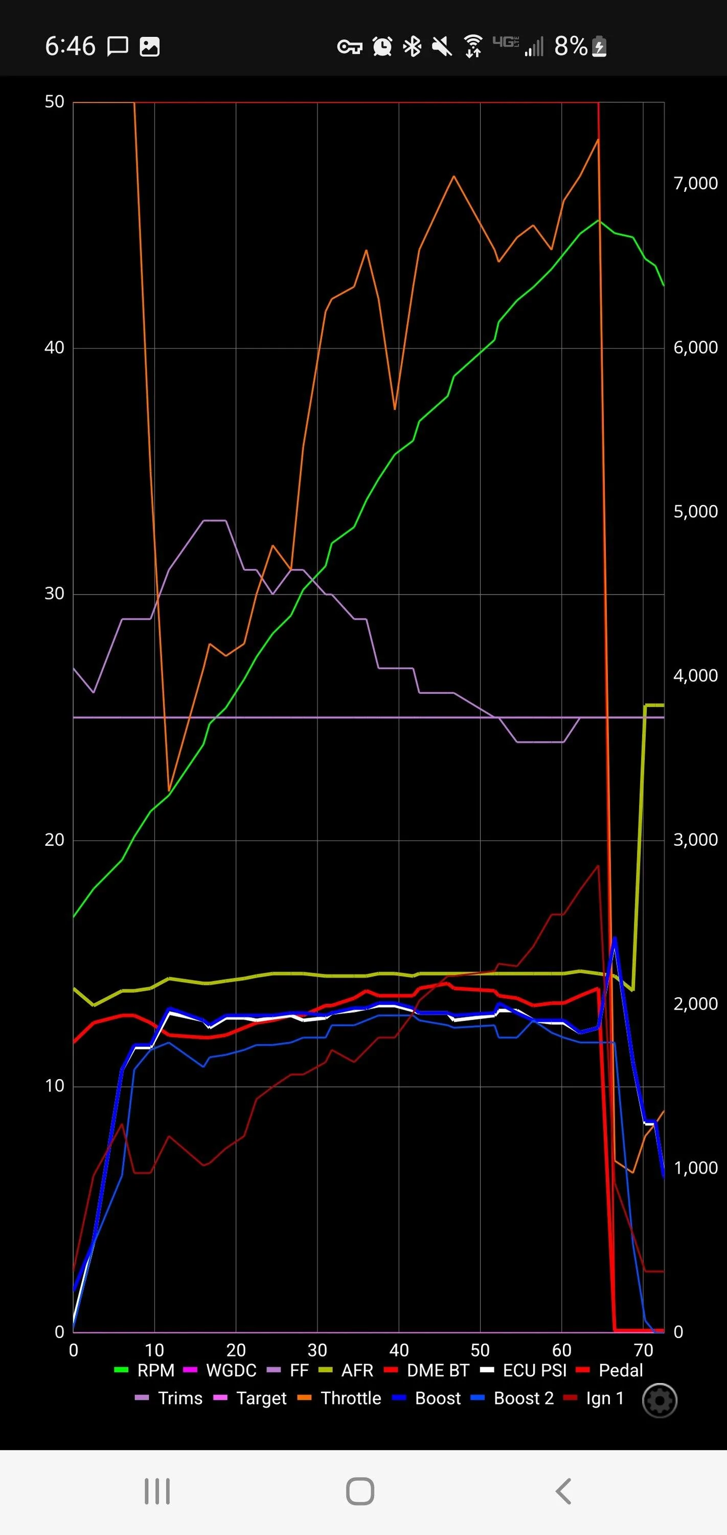

So with my new knowledge of the "on throttle overboosting", I started a new map from scratch today.
I did several logs on Map 0 and I could see that even the stock tune relies heavily on the throttle. I wondered if my random DME BT drops were because it is expecting to close the throttle when it hits target, and doesn't - instead lowering the target.
Now, I'm trying a new map to embrace the throttle closure on initial spool up. Seems to work well, pretty mild map but it feels stock smooth. Log is short but I've never had issues 5k+ anyway.

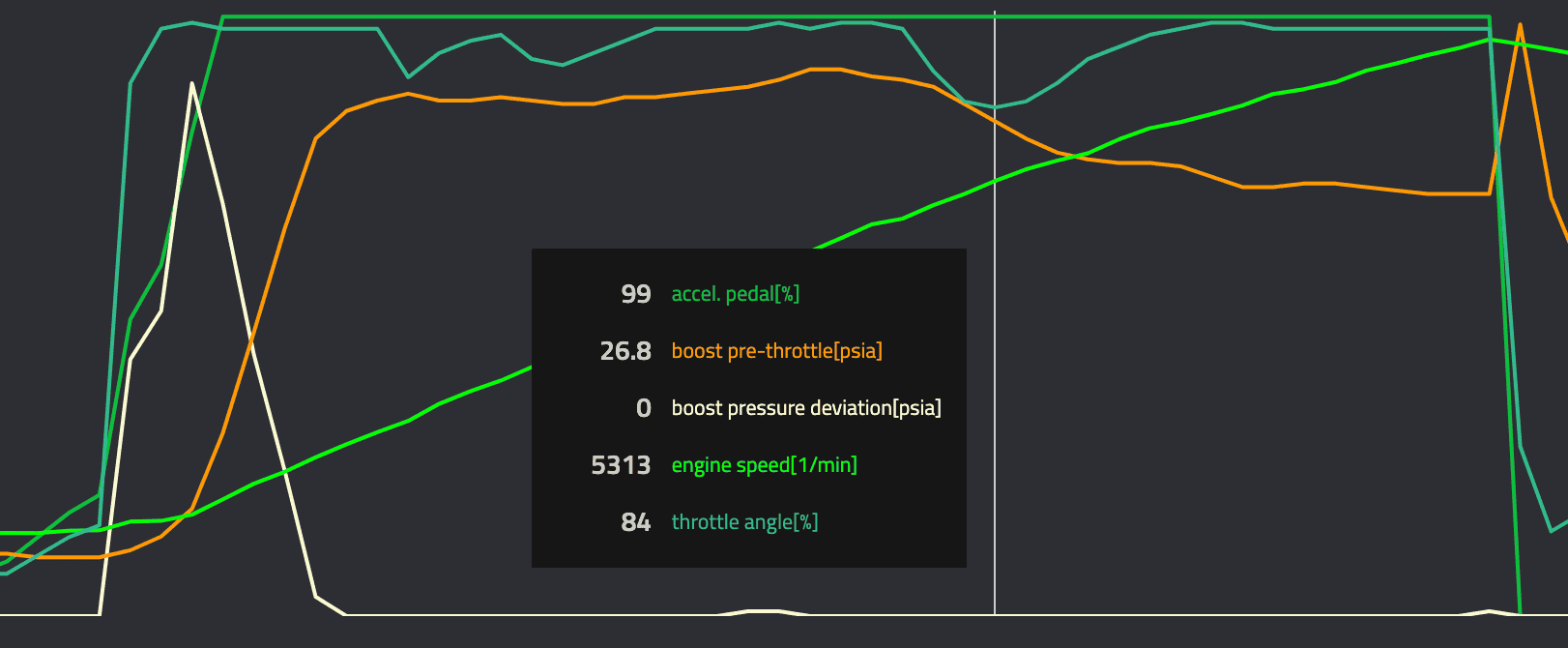

Yup, the oem mapping uses throttle as part of the boost control, it does it well enough that you don't feel it.
Here is a stock 2020. You can see it does it based on pressure deviation.
I was aware that it did, but the throttle cut in map 0 was a lot more severe than I expected it to be. Not surprised if that's from the downpipe.

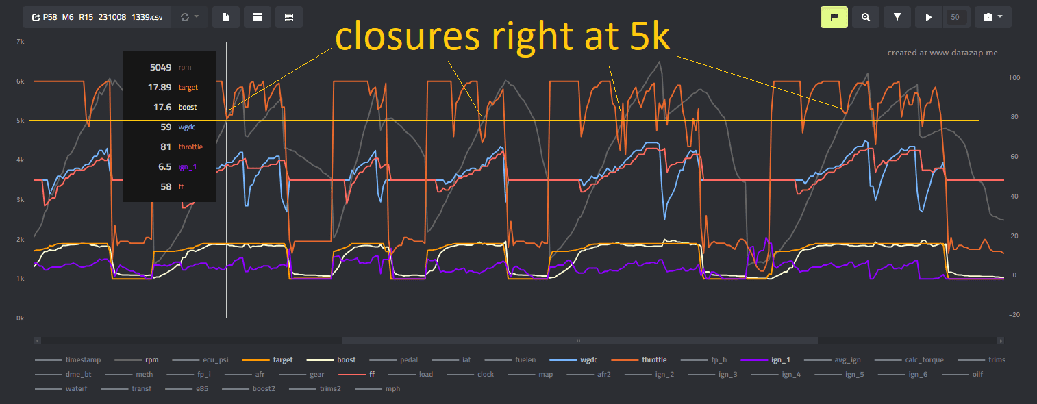

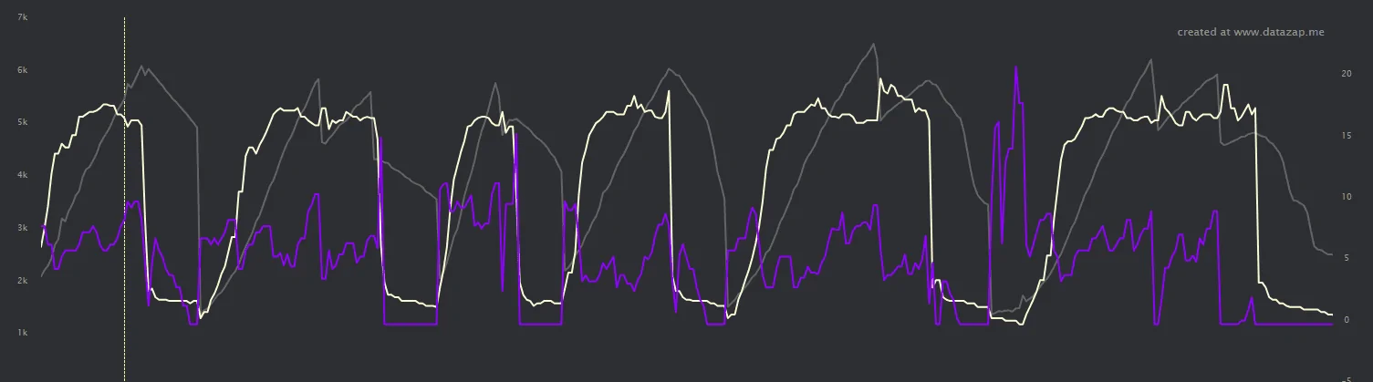

Had about an hour of running errands so I was able to adjust the bias table a bit. Started by flipping bit 1 to disable adaption, and then with each iteration I adjusted duty bias curve to align the shape of FF and WGDC. Each iteration I also reduced the PID gain from 20 -> 15 -> 10 -> 5 to weaken its response. This was the final log of the day where I switch the PID back to 20.
https://datazap.me/u/i3igpete/back-walmart?log=0&data=1-3-4-8-11-20&zoom=236-608&mark=260
It looks like there is a consistent closure at 5000RPM across multiple pulls, so I need to dial back the duty bias at that operating point. Otherwise, I tried to keep the logged FF as a consistent ~2 points below WGDC to ensure a positive PID response without any positive/negative swings. If I understand correctly, turning bit 1 back off will allow wastegate adaption to vertically shift my entire FF curve. so that it's hopefully line-on-line with WGDC.
Boost is within 1 psi above 3500. However, is my 14psi boost target below 3000 going to throw the PID controller off?
Timing looks better than before as well. seems to consistently approach 10 degrees at 6000.
Does anyone mess with the auto shift reduction? I checked a couple logs on jb4 forum and almost everyone leaves it at default.

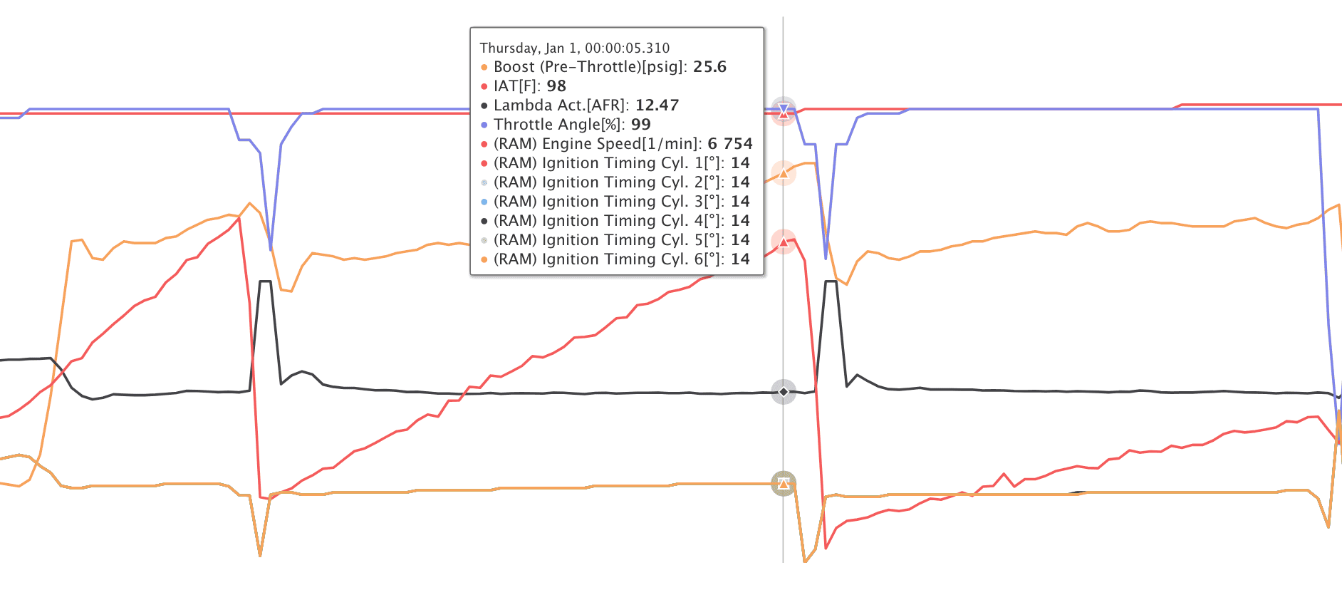

Those timing curves still look so bad. They should be a smooth stair step increasing with revs. The fact that they are going up down like a saw means the car is unhappy.

Yes, you are on the right track. Since you get consistent throttle cuts around 5k, consider dropping DB down a couple there and 4500 a little as well as you mentioned. You can keep PID at 20 for now.
@razorlab , agree timing still needs help. Should start climbing around 4k and peak over 10 deg redline. Lets get the boost control cleaned up more, then we can look into getting timing sorted.
I wonder if the car pulls some timing if it senses you may overshoot boost target -seems like it. These boost targets are totally fine for 93, unless its bad gas. That BM3 tuning guide says the DME only uses load targeting, no boost or timing targeting. It just uses both timing and boost to get desired load. It would make sense that too much boost would pull timing.
After the duty bias adjustments to finalize the FF curve, @i3igpete - you can try turning down FF gain to underboost on purpose. See if that cleans up timing at all. Don't mess with the duty bias any more after the adjustments at 4500 and 5000, we can just adjust FF gain from here on.
Why don't your boost targets in the log match your Map 6 settings? (shown below)

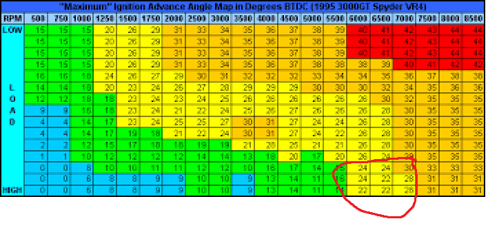

yep, totally agree. Want to see something wacky? On the old mitsubishi 6g72, the factory td04-9b turbos were horribly undersized and ran out of boost at 5000rpm, so the solution was to throw a TON of timing at the engine to make up the difference. People were fighting the stock timing map with piggybacks all the time.
