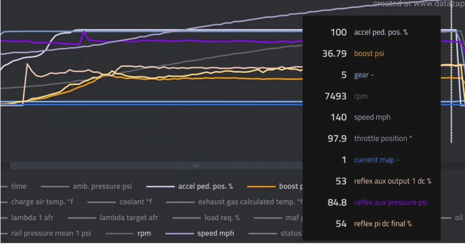

Title says it all. How far have people managed to rev a stock B58TU out without shit coming apart or floating the valves? The thought randomly popped into my head today and I can’t find any info on it anywhere.
stock valve train i tell my customers not to go beyond 7500rpm. This is where we've constantly taken our stock valve train B58 on our EFR9280 turbo. Stock turbo people shouldn't even really be thinking to go that high, but it can serve its purpose on a road course, just wouldn't make much power on stock turbo.
