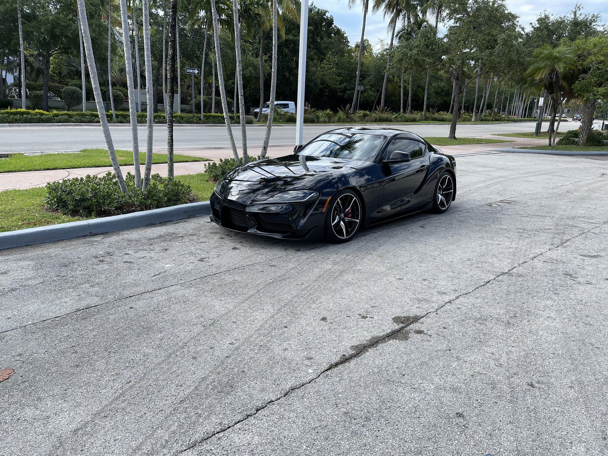

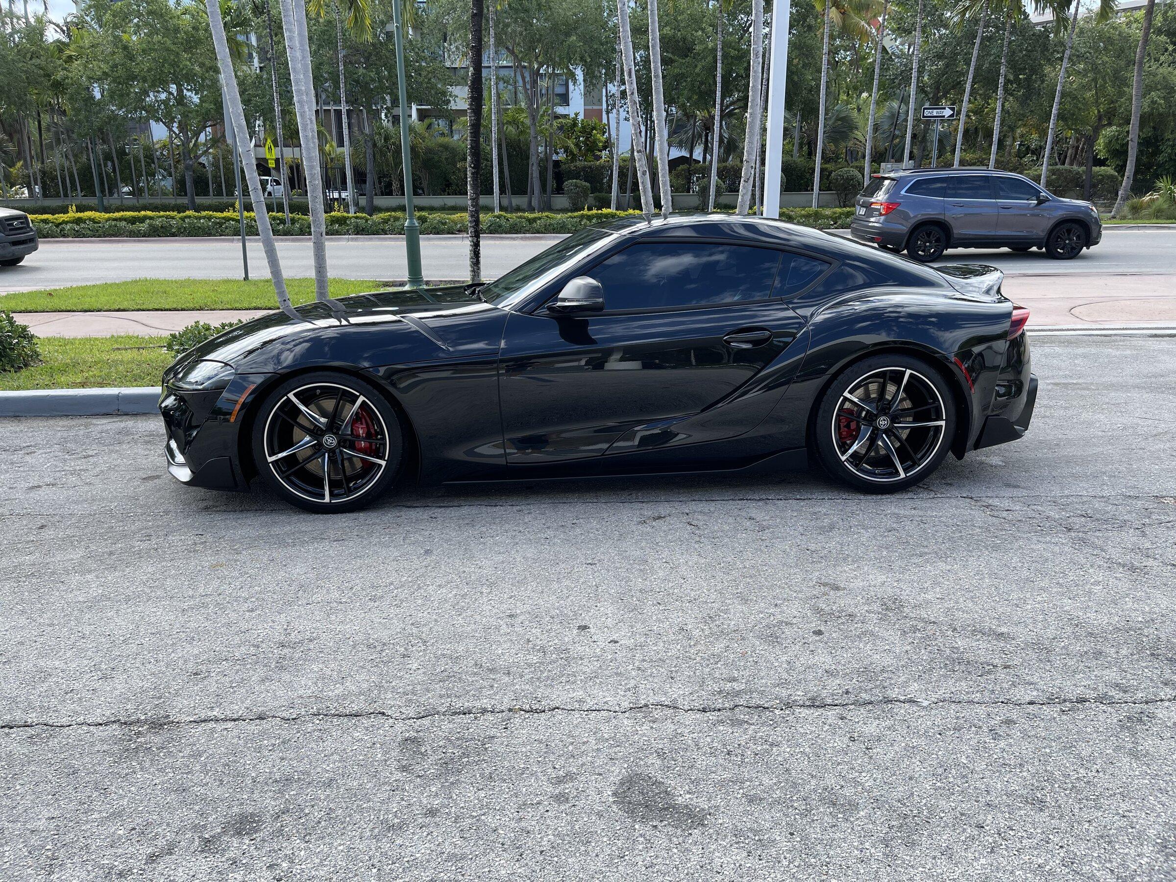

I was able to get the MSS springs on my car a couple of days ago and I am very impressed with them. The car feels very controlled. Itā€™s very obvious that a lot of time was put into designing these to work with the car both when being installed as well as while driving.
Brake dive is considerably reduced, as is body roll. Iā€™ll need sway bars to get rid of the rest but the springs did an excellent job on their own. Whatā€™s really impressive to me is how the car feels now when rotating or recovering from a slide. The car rotates so much better, it doesnā€™t feel like a delicate balancing act anymore and when recovering from a slide it feels so much more planted. Itā€™s not fishtailing anymore which is awesome. I let my mechanic give them a try as heā€™s shipping for springs and was disappointed in how soft the HKS ones were. He said he hates me because now he has to get these for his car.
Car does feel stiffer but itā€™s nothing I canā€™t live with. Iā€™d say that now, normal mode feels a little stiffer than sport did when stock, while in sport is obviously stiffer. They did pass the girlfriend test though. Iā€™m currently running them at 4mm front and 8mm on the rear. Iā€™ll likely raise both ends a little as the springs settle. I highly recommend these springs.
Haha same color as my car. But thank you for the info it was super helpful, car looks amazing and im sure it handles alot better too.
