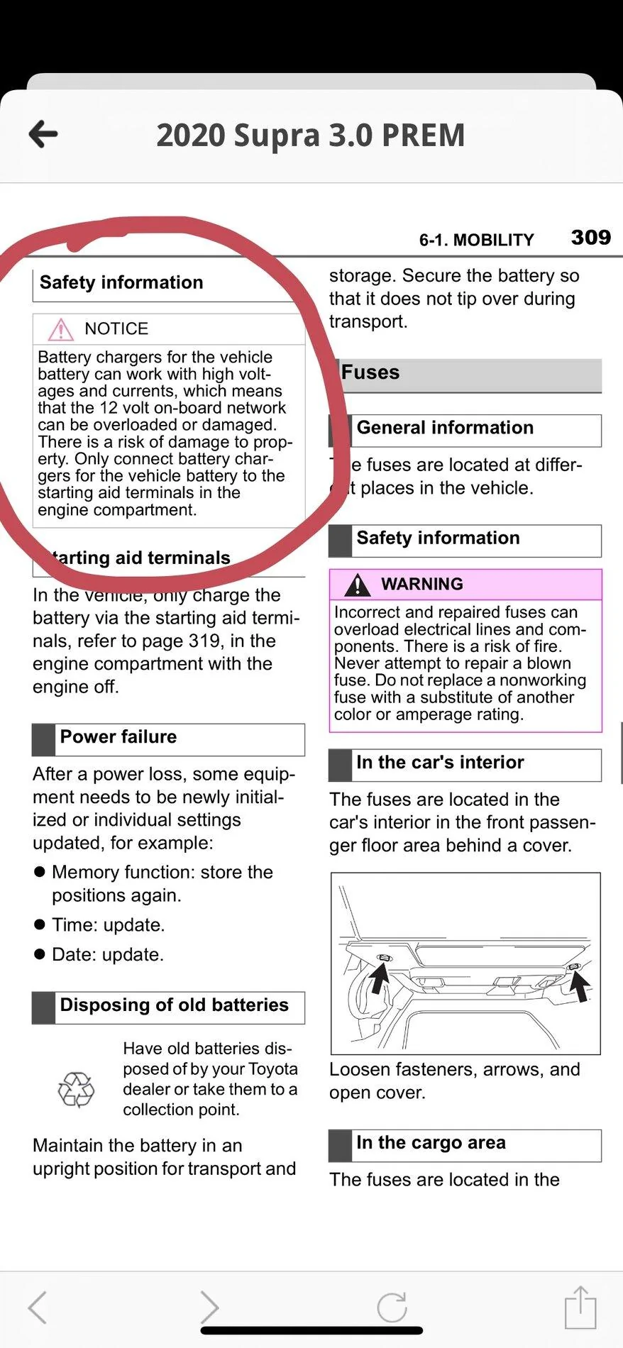

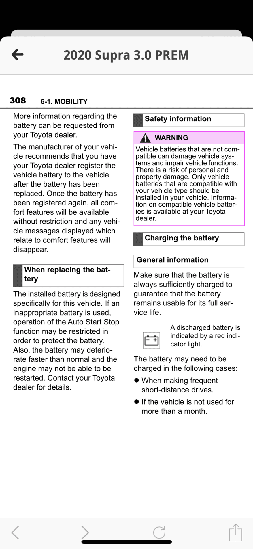

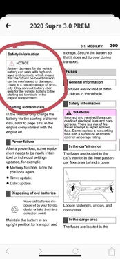

Here is some stuff from the owners manual

Didn't see that one, guess I'll be relocating my leads lol.
i mean you could be fine. Lol it’s probably for morons accidentally touching the wrong cables with wrong polarity. Lol ?
The front posts are a lot farther away so it’s harder to do that. Lol

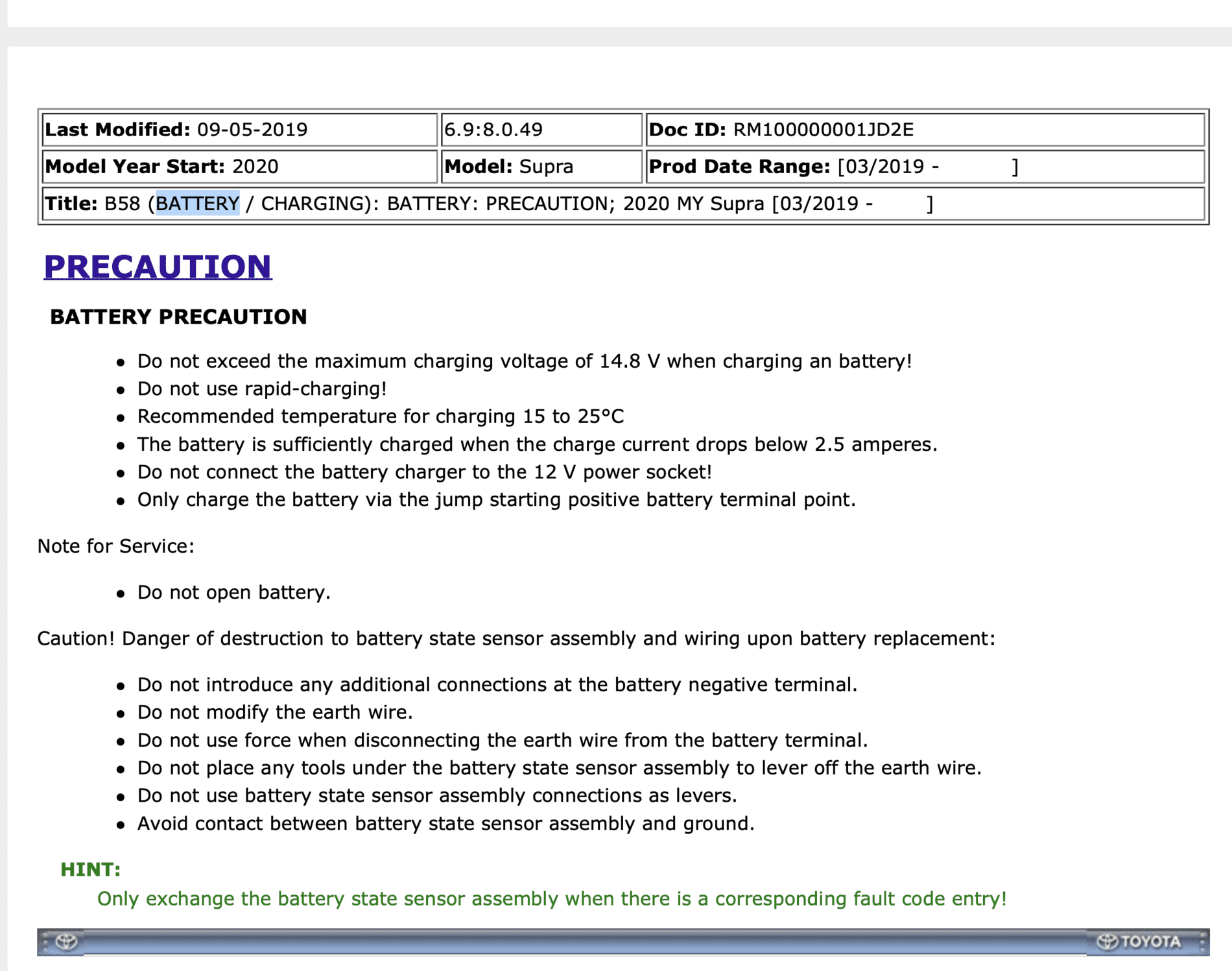

"The IBS is a mechatronic component for monitoring the battery condition. The IBS is secured and connected to the negative terminal of the battery. The power supply for the IBS is fed across a separate cable. For data transmission, the IBS is connected to the DME (Digital Engine Electronics) or DDE (Digital Diesel Electronics) via the BSD (bit-serial data interface). Also the BSD is tied into the alternator and does several things.
On vehicles with IBS, recharging the battery directly at the battery terminals could lead to a misinterpretation of the battery condition and even unwanted Check-Control messages or fault memory entries.
If the battery is recharged while installed, it must be recharged using the jump-starting points in the engine compartment.
Only then can you be sure that the recharging is correctly recognized by the vehicle electronics on vehicles with intelligent battery sensor (IBS)"

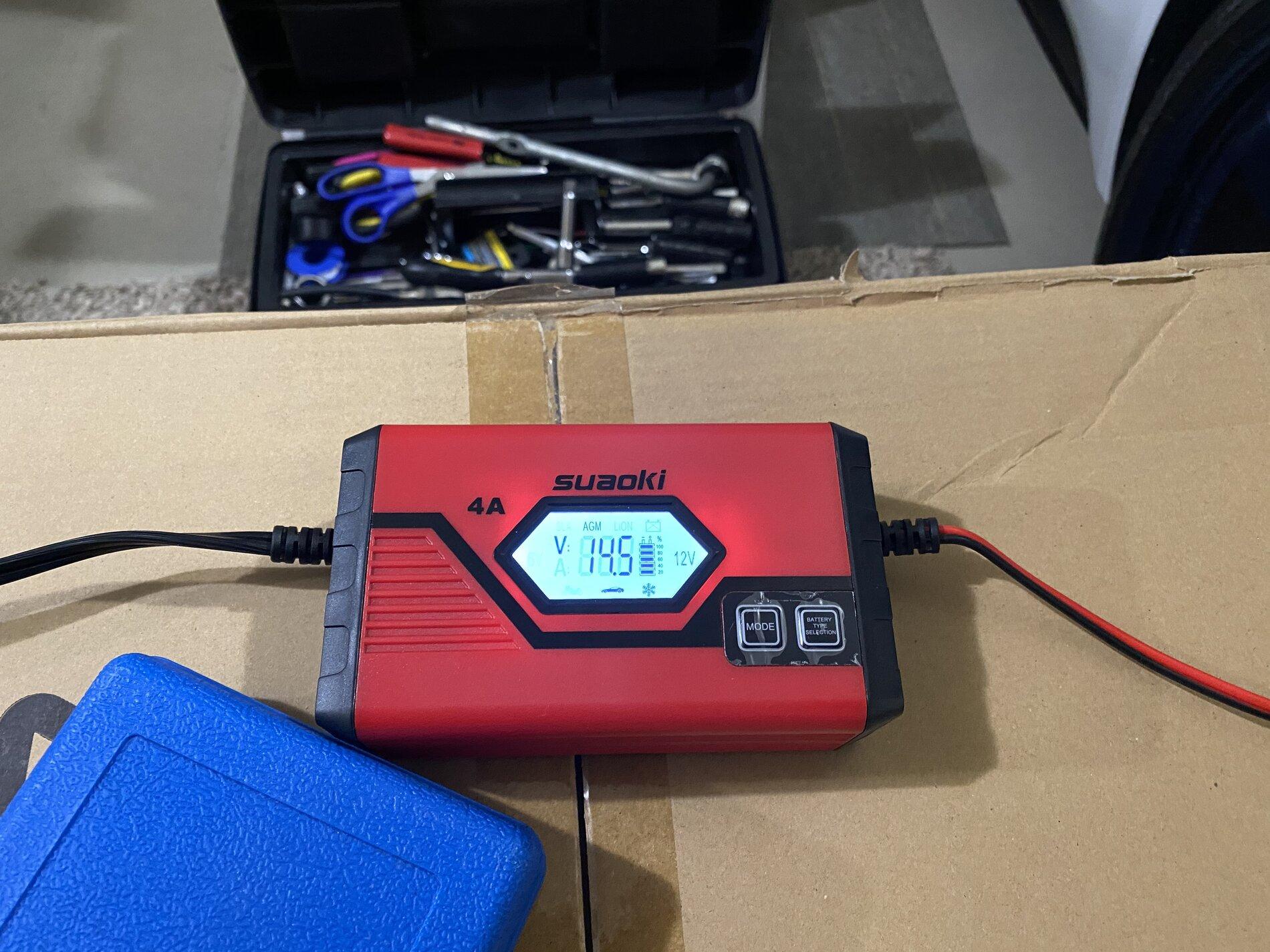

Finally got my ctek Msx 5.0.... before I hook it up to my Supra is there anything I need to do? AMG mode?
