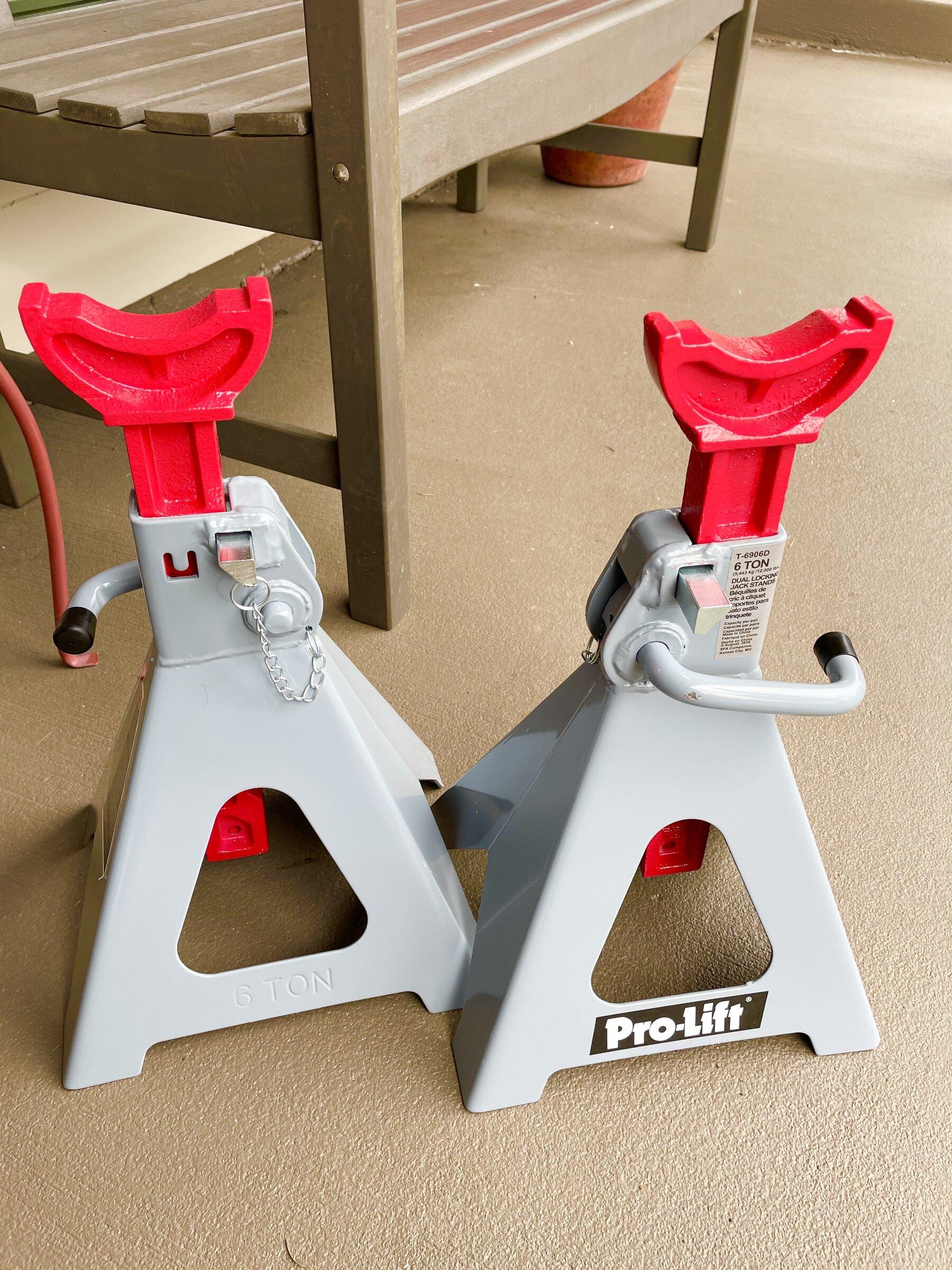

Is there any record of the quick jack mechanical locks ever failing? I did a quick search and didn't find anything. Is it even possible? Using a jack stand (also a mechanical lock) as a back up for another mechanical lock just seems unnecessary.
I mean, sure, nothing in life is ever 100% but it seems the odds of a mechanical lock failing would have to be astronomically low. Like being hit by a meteorite low. See what I did there...

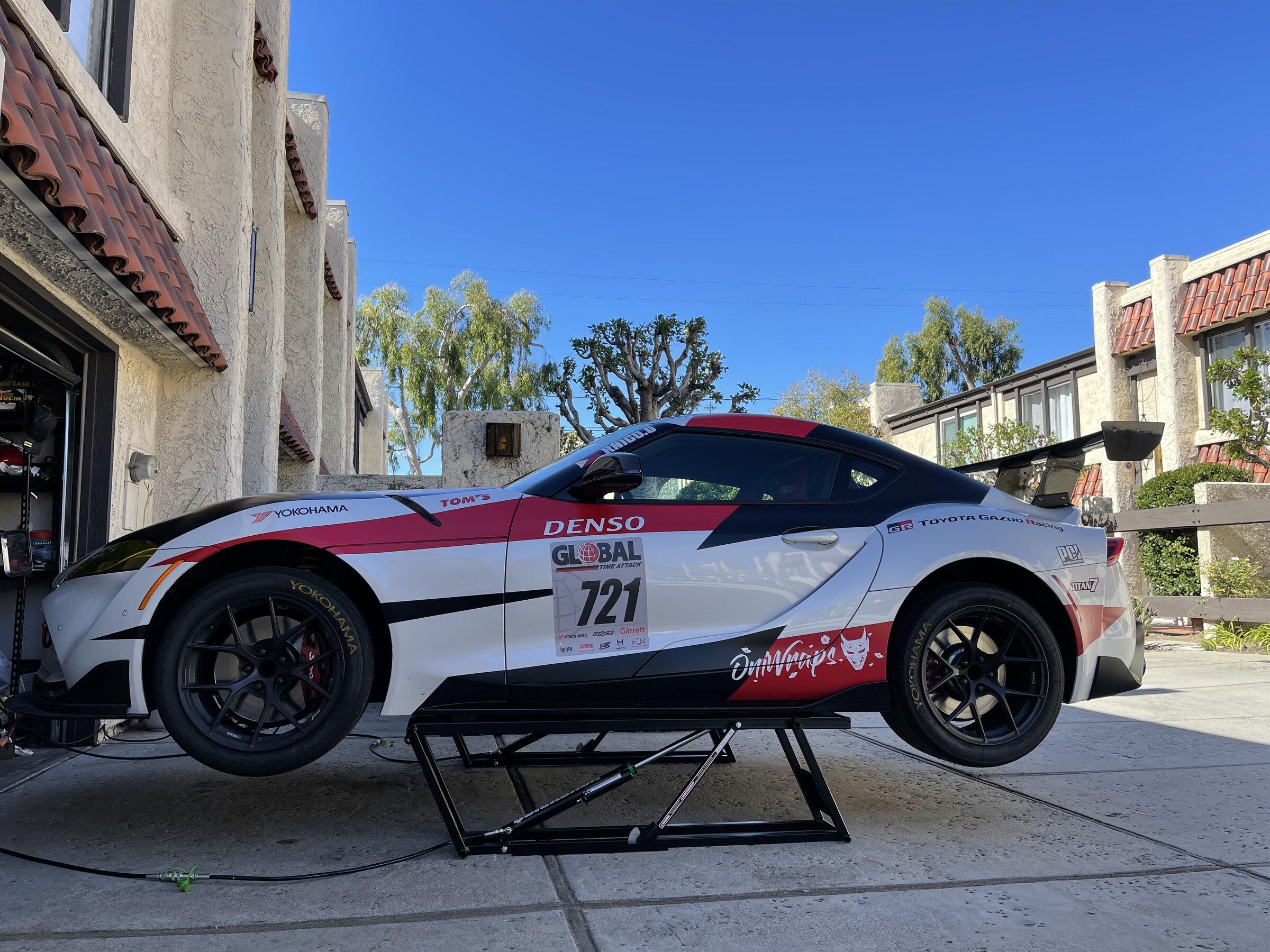

I am considering a QuickJack but am not following about the blocks and how that works with the Supra/BMW jack points. Any insight would be appreciated....!

With the quickjack the blocks that come with it are a rectangle hard rubber that you put on top of the quickjack which has a channel built into the jack for adjustment. Just put the blocks were the jacking points are for the supra. It doesn't damage the jacking point at all. I've used mine over a dozen times now.

Got it ! - I get it now - I could not find any pics online that showed the top of the jack - this helps! - Thanks...!
