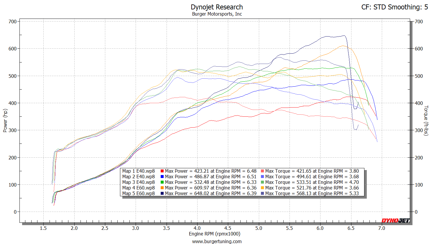

Great example where having total control of ignition timing and fueling would be very helpful. Anyway, I'm not here in this thread to keeping shouting the merits of actual ECU control.

Meth gains are huge lol, like 50whp+. It would need a new tune since boost requests would be much higher when fueling or octane are no longer the bottleneck.
and this wouldnt require anything else like fuel pump upgrades, etc. to get there?

MHD BEF and JB4 is a great combo. It was about 60rwhp more and a bunch of tq as well using the two vs an OTS map for MHD. I’m sure you can get there on a custom MHD map but I love the flexibility of tweaking with the Jb4 and not having to keep reflashing or getting tune updates and then reflashing. I could tweak in the car on demand.
Nah, Meth is the additional fuel. Will reduce the DME fuel demand substantially. Trims drop a lot, which should allow you to run more boost and ethanol.
I have reviewed some meth logs, but I've not custom tuned someone on it yet.
Here is a 99% meth log on an M340 for example:
https://datazap.me/u/coloneladama/log-1714512217?log=0&data=1-2-4-14
It is running 7-8psi over stock and trims are in the single digits and teens. DME is actively removing fuel to keep AFR at lambda 1 (14.7).
A ton more pulls of the same car - Trims bottoming out. In theory, you should be able to add a ton more ethanol and boost and it'd take it fine.
https://datazap.me/u/coloneladama/log-1714512399?log=0&data=1-14-18&zoom=1183-1403
Presumably you'd just reach the limit of the stock turbo at ~25psi, good bit over 500whp.

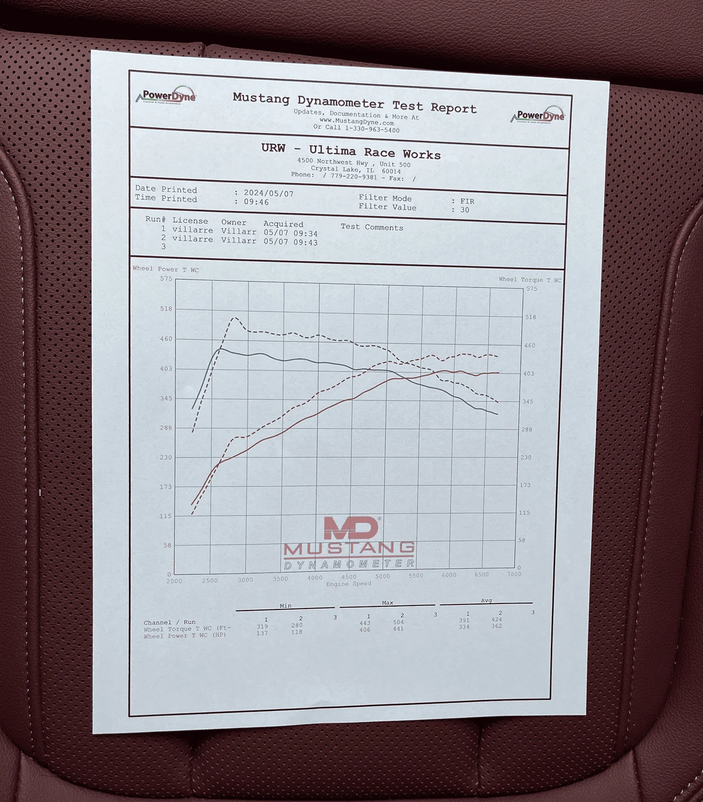

Good dyno results today for a B58 running my custom Map 6 (93 octane) ! 441whp on a mustang dyno
+35whp/61wtq at +3.7psi additive. Timing starts falling apart at any higher boost levels on this fuel due to 100+ IATs
https://datazap.me/u/coloneladama/log-1715109752?log=0&data=1-2-3-4-8-15-20&zoom=286-358 (not from the dyno, but from the street tuning)
AA Catted DP, BMC Drop-In Filter, Stock Tune
406WHP/443WTQ
AA Catted DP, BMC Drop-In Filter, JB4 Map 6 on 93 Octane
441WHP/504WTQ
