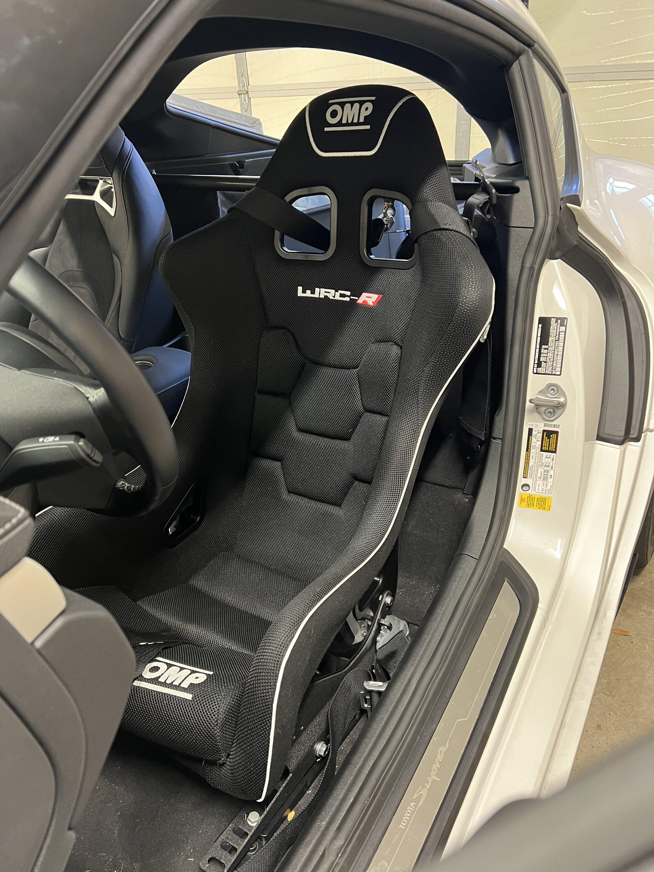

Copied your seat rail setup, but with the OMP WRC-R as my seat. I'm 6'2" and can confirm no need to for removable wheel, more than enough room to work with.
