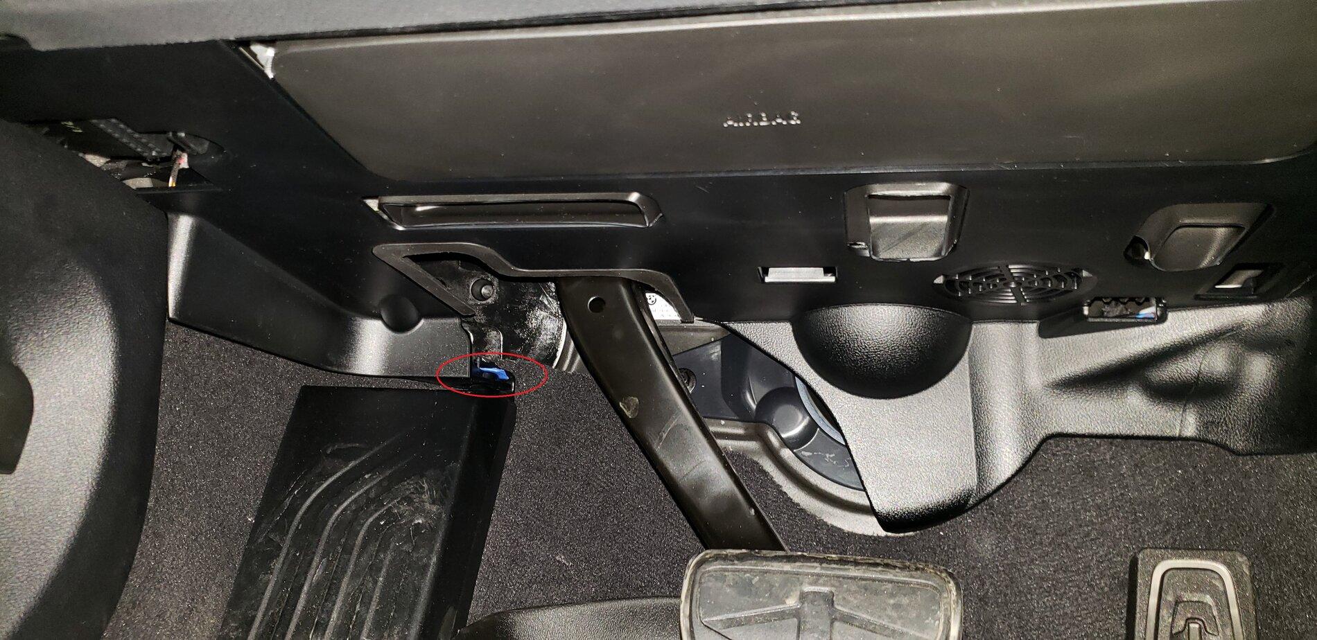

Did you look in the footwell to see if the plastic under the dash is loose. I had a problem with mine on the drivers side. I put some felt between the plastic cover and bottom of dash and it got rid of the noise. see the red circled area.
I am 99% sure it is not coming from the foootwell since I can hear it beside me/behind me.

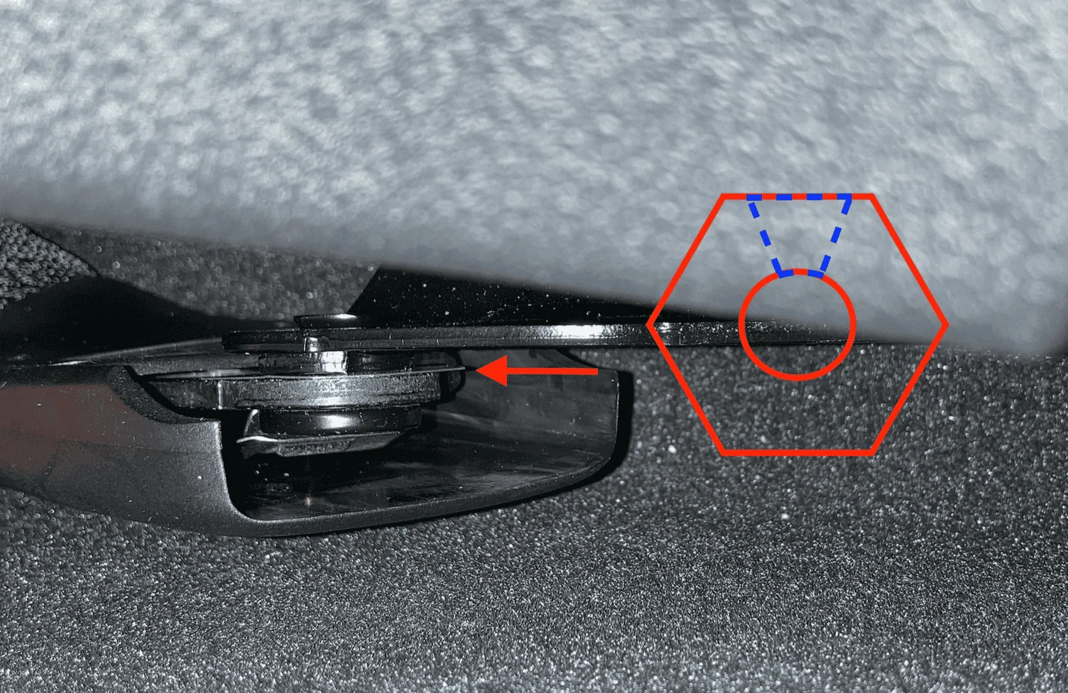

I had this occasional metal to metal rattle over sharp bumps on my Supra coming from the passenger side which I narrowed down to the passenger side seat belt. It did not matter whether a passenger wearing a seat belt was onboard or not.
Below is a picture of the anchor end of the buckle where the passenger would buckle up to between the passenger seat and passenger door. The plastic cover is pulled backwards to expose the metal parts.
I made a spacer shaped like the red line drawing with the blue dotted area cut out so that I could slide it between the metal parts. I used a polycarbonate sheet I had to make this (a little thicker than an over head transparency) to dampen the noise. I suppose one can try it using a note card.
Worked great, no more noise...!

I would not be able to print it as I just made it using scissors and a razor blade.. It's the one for the hip level mounted near the floor between the passenger seat and door.

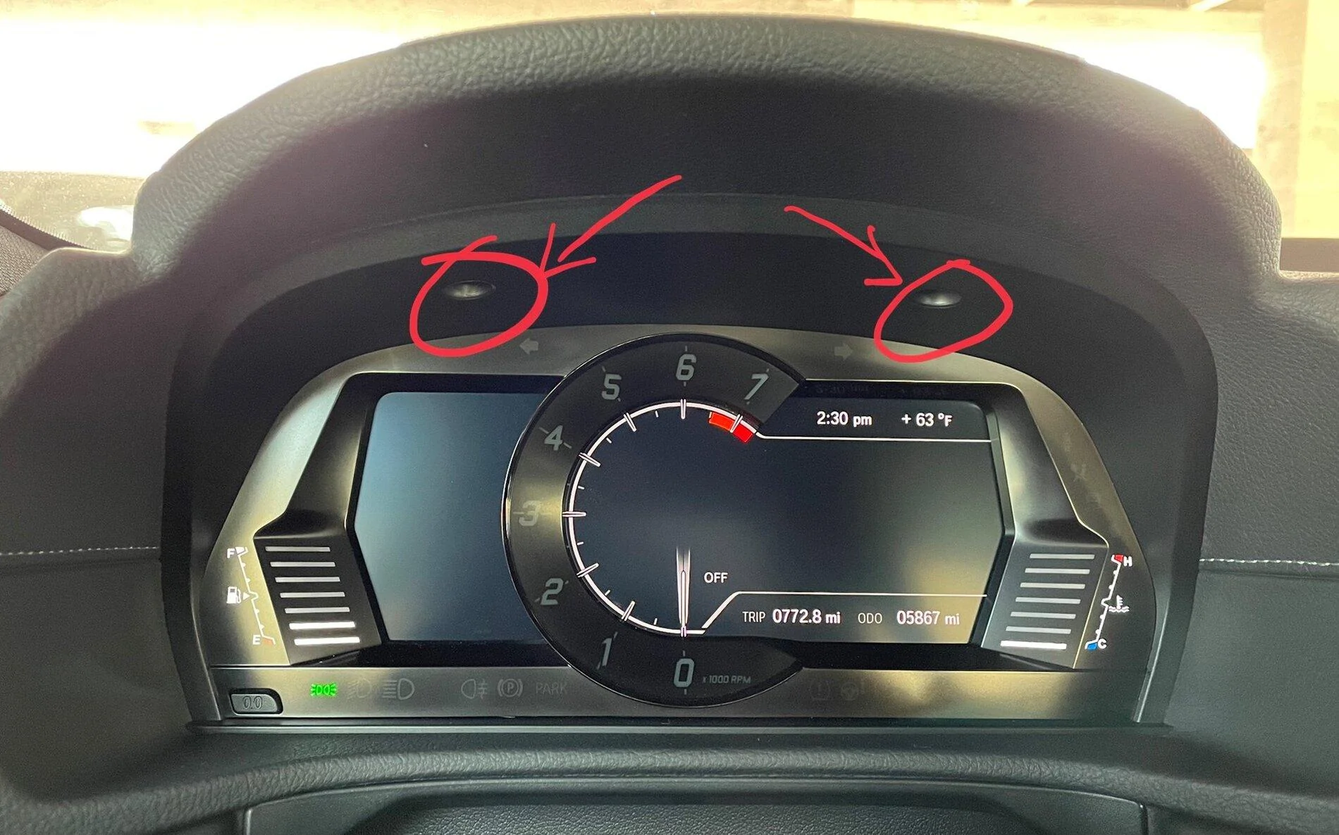

I had a rattle in my dash area also over rough roads or hot sunny days. Tightening the 2 screws above the instrument cluster trim about 1/2 turn each seemed to make mine go away.
