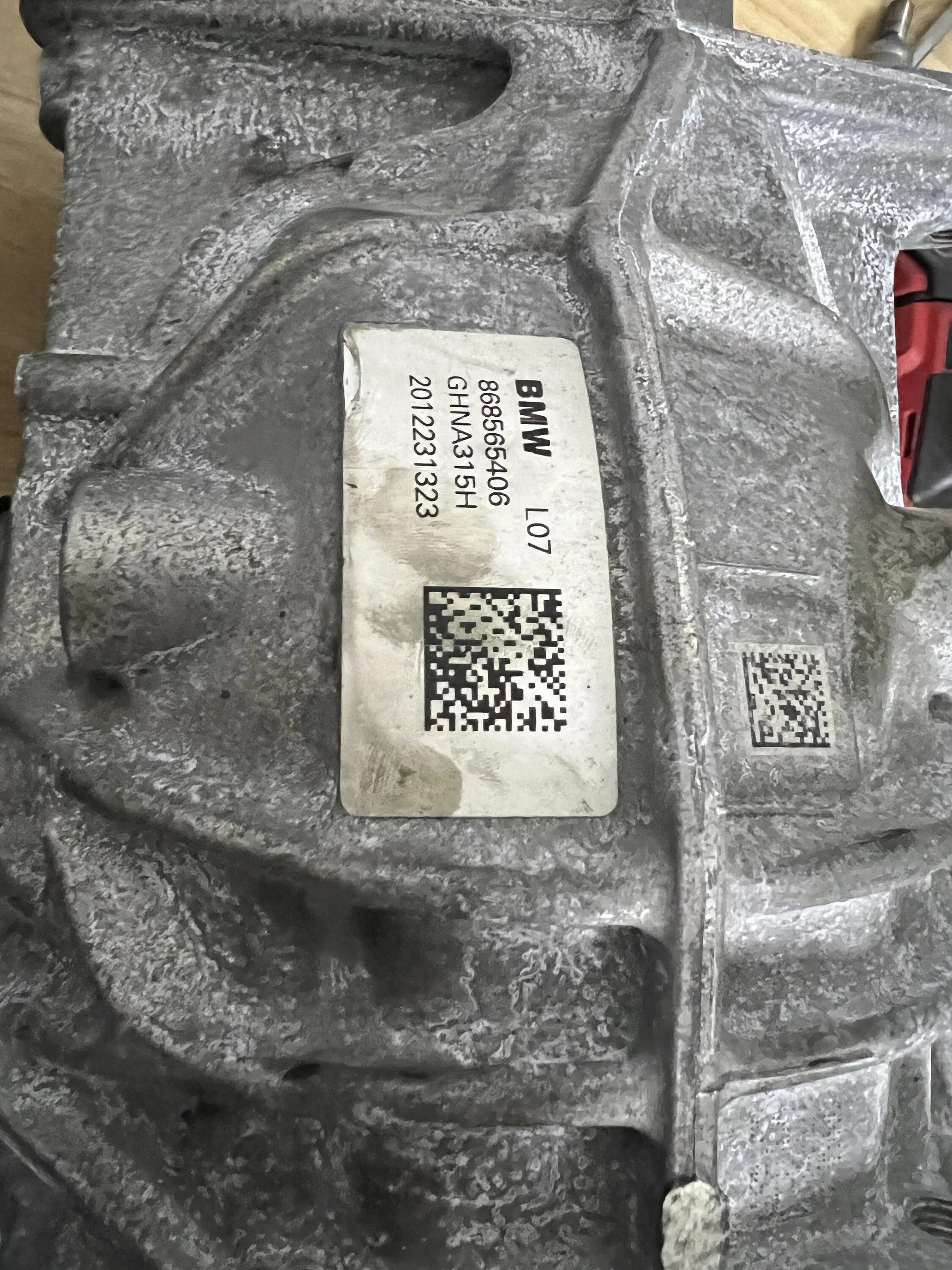

After snapping my driver-side axle during a launch (times coming soon lol), I've decided to swap a 3.0 diff and axles since they are beefier.

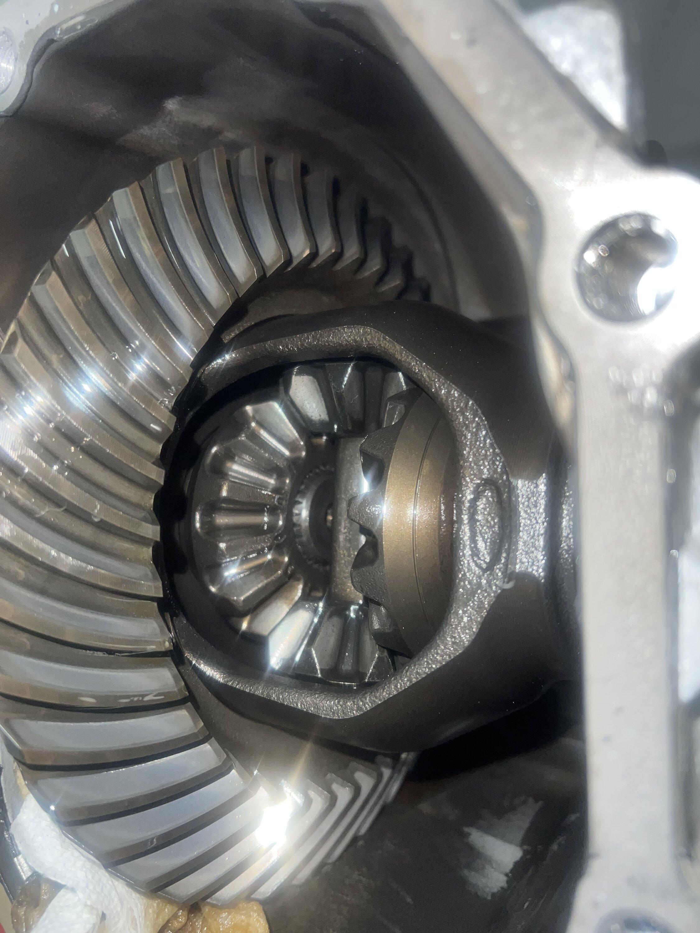

I know whether or not the 2.0 Supra has an LSD is unknown/debated even though Toyota dealerships and reviewers say it has a mechanical LSD. I've always been on the side that it has an OPEN diff since the part number is identical to the same open diffs in the BMW Z4, 330i, etc, and couldn't find of any BMW 190mm mechanical LSD at all which led me to believe it doesn't exist. I thought I would settle this debate and open up my stock diff to take a look.
Verdict: Open diff
Through my searches, it seems like maybe some 2.0 Supras did get an LSD (outside of the U.S.) but it isn't mechanical, it's the same electronic LSD in the 3.0s.
A bit of info for anyone interested in a 3.0 rear-end swap:
The 3.0 diff and axles bolt up directly to the subframe and hubs. You CANNOT use 2.0 axles on a 3.0 diff, the splines are different sizes. Apart from the LSD you also have a much stronger driveline. The 3.0 diff is 215mm ring gear cast iron case vs the 2.0 190mm ring gear aluminum case and the 3.0 axles are 41mm diameter thick shafts vs 2.0 34mm axle shafts. The CV joints are clearly beefier as well which is where mine had broken.
I already had a custom one-piece driveshaft on the car because of numerous experiences in the past with BMW driveshafts that break like spaghetti and didn't play around with the Supra since I was regularly dig racing. My driveshaft has some adjustability in length so it bolted up to the diff just fine. I am not sure if the stock 2.0 driveshaft would work on the 3.0 diff. The 3.0 uses a 3-bolt flange on the diff vs the 2.0 reverse CV joint that screws onto the diff with a nut. You could take off the 3-bolt flange from the 3.0 diff and "maybe" the stock 2.0 driveshaft is just the right length (there is some adjustability).

I mean you can clearly see it's an open diff in the photo.

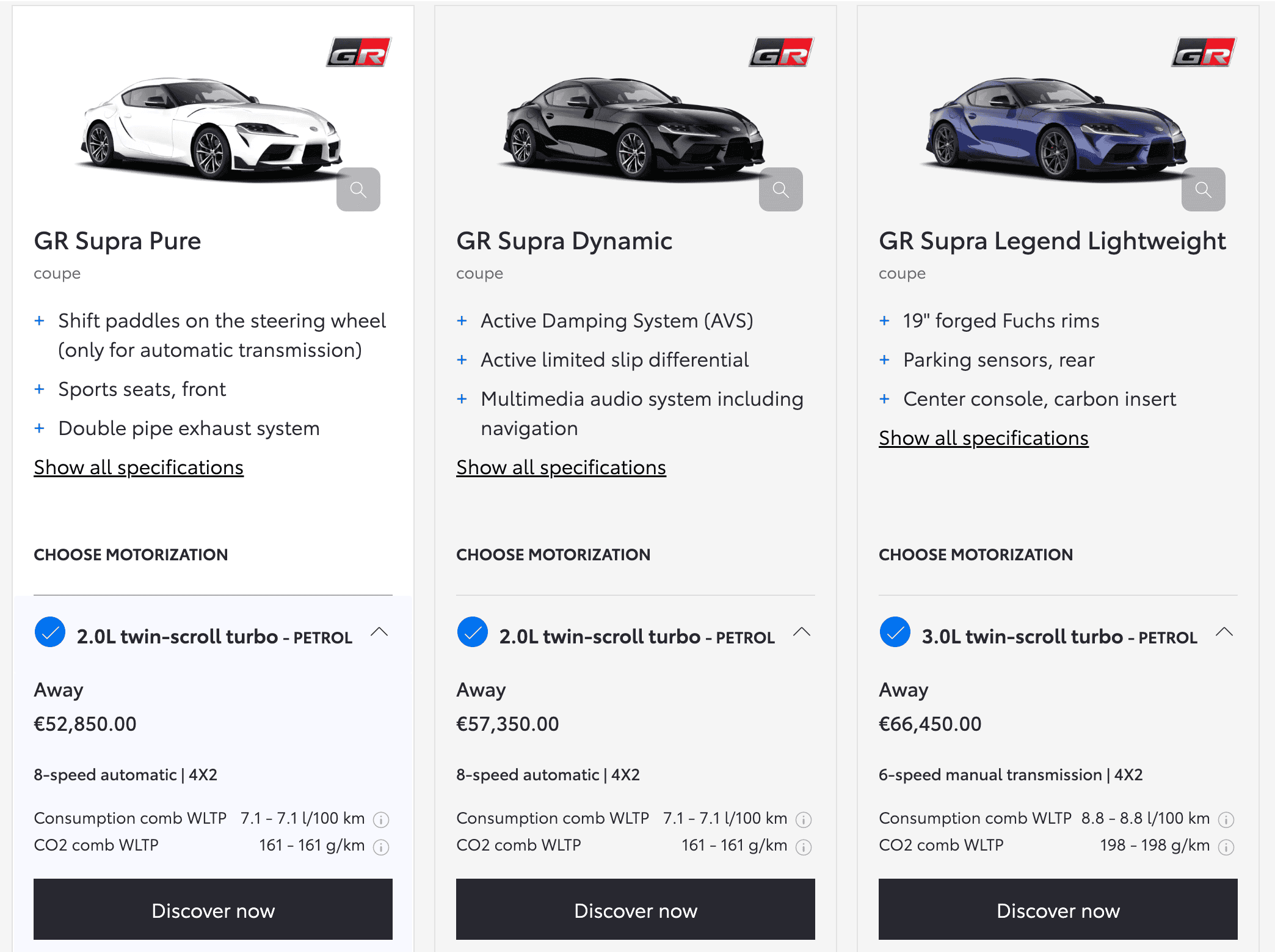

I believe the Euro 2.0L's have a "sport package" that could add the lsd.
Just looked at the German site...
Apparently you can get a 2.0L with the 3.0L active rear diff, active suspension and brembo brakes. Learn something new every day!

Since the German 2.0L has the option for the 3.0L active diff I would cross reference what it has compared to the base 2.0L
