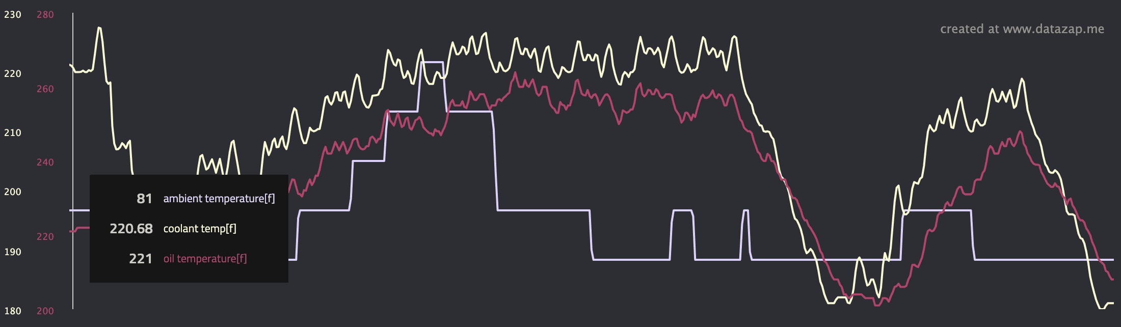

See, this is another example where car bowling and turny track bois live in different worlds. 220F is basically cruising temp. On track it will easily surpass that on the first lap out.
Here are 13 laps. You can see oil temp goes up past 220 on the first two laps out. Chill laps. 280f-300F is just fine with modern oils.

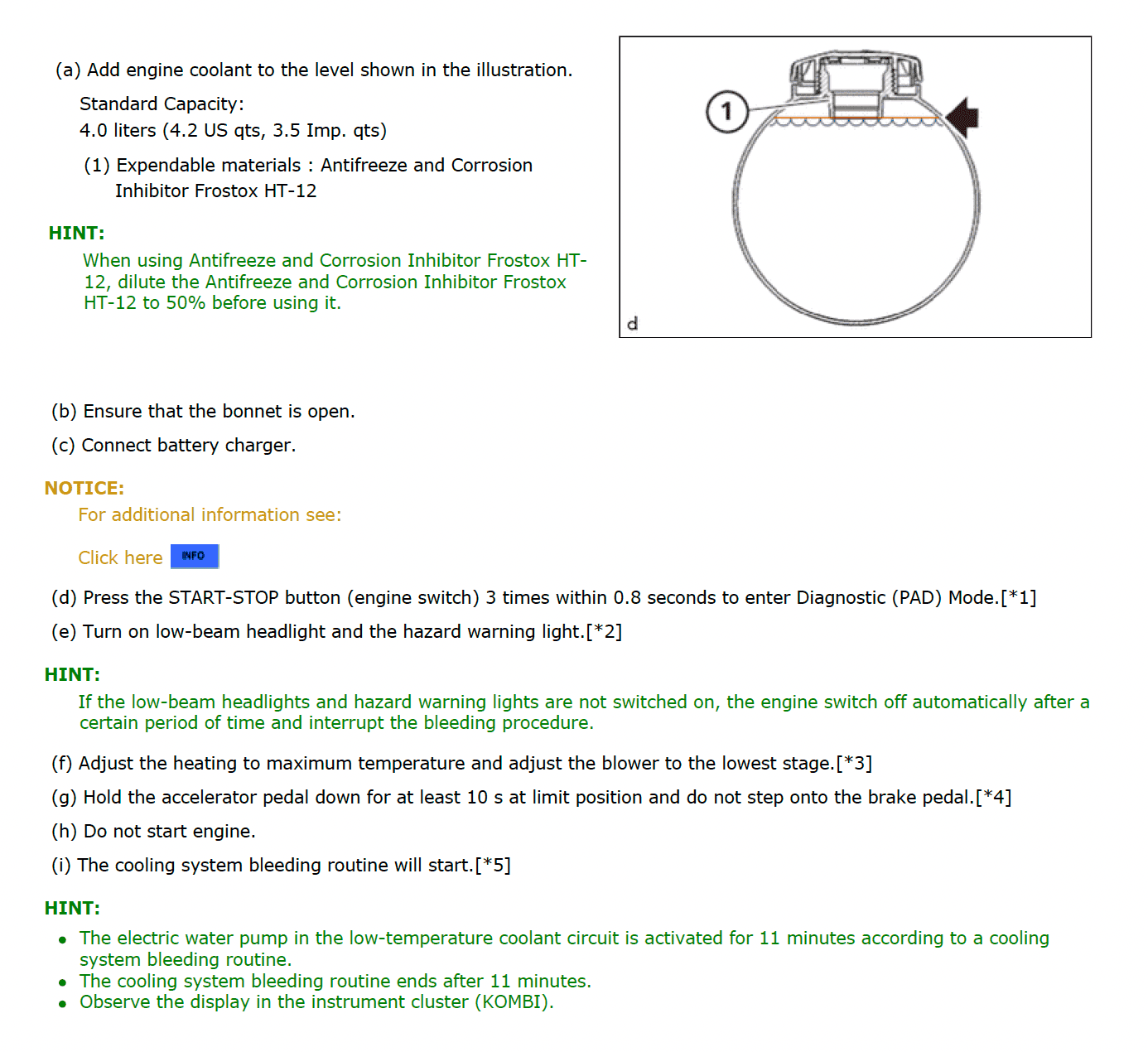

In addition to the vac filling, did you do the proper system bleeding procedure? Might be worth trying that. See below for the low temp circuit procedure.
That said, I bet you are just running too much boost on the stock turbo and turning the turbo into a hairdryer.
Peter
Jul 8, 2021
Zephyr Cove, NV
'20 Supra, '18 TTRS,'13, LP700-4, '07 S6 V10
I DID NOT follow the above instructions, so possibly this is the reason for the 160DegF IATs. I am machining out a billet oil cooler manifold so when I re-install Ill vacuum fill and bleed to the workshop procedure. Glad I am not alone with my findings
