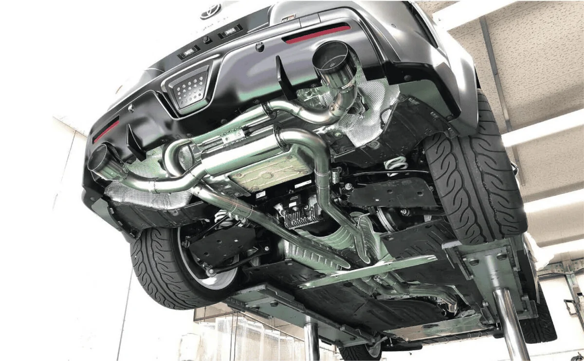

The HKS has a Y before the axle, then both sides go through a muffler and then out the exhaust tip. One side has a valve and the other doesn't. I'm guessing both mufflers are really similar and any difference in sound comes from the one side becoming a big hemholtz resonator when the valve is closed. I don't know this for sure, just my intuition based on how it sounds. It does not seem designed to make a big difference between loud and quiet mode. Not my pic, but here's the HKS routing:
See how both the valved and unvalved side are basically the same?

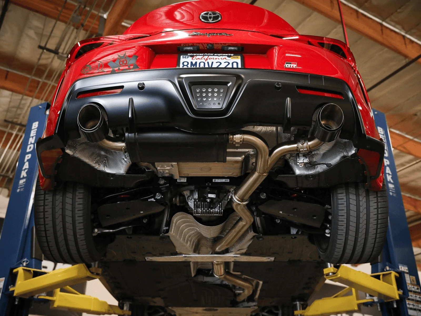

The aFe has a (optionally deletable) resonator before the axle, then a Y after the axle. The right side of the Y goes to the valve, then straight out the tip with no muffler. The left side of the Y goes through a relatively large (smaller than stock but larger than most aftermarket) muffler and then out the left exhaust tip. It does seem designed to make a big difference between loud and quiet mode. Not my pic, but here's the aFe routing:
See how the valved and unvalved side are totally different?
Too bad the AFE is the same size as stock and goes down to 2.5" after the split.
Yes, I'm aware of how they are different. My only problem with the AFE is that the valved side narrows down to 2.5"
I really wish it would continue to 3" afterwards
Which is why I'm leaning towards the Dinan, which is 3.25" and continues to 3.25" on the valved side. The non-valve side goes down to 2.5" and into a muffler. However, I really do not like the tips...
The MAP exhaust is also another I'm considering. Essentially the same as the Dinan, except it's 3.5" including the non-valve side. Just not sure this will be quiet enough in normal.
