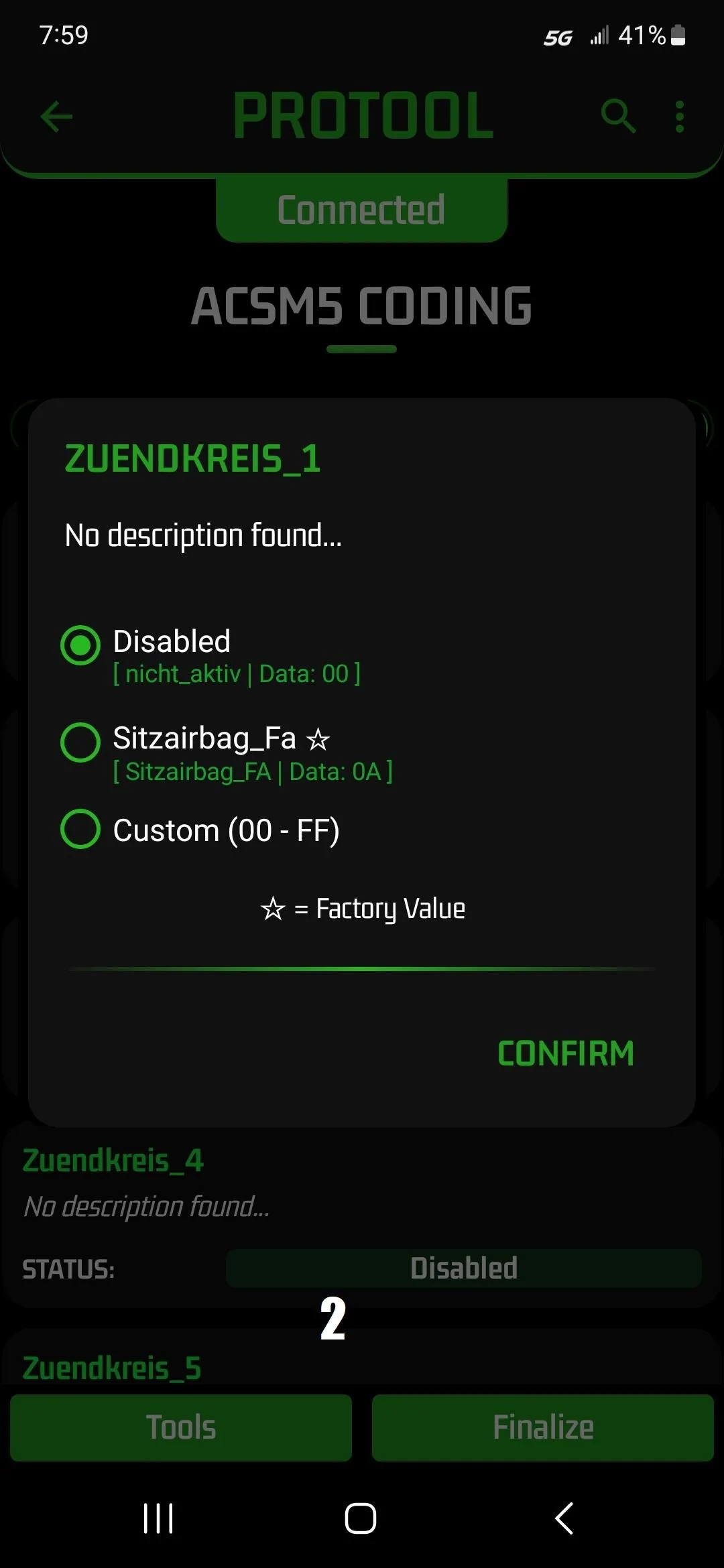

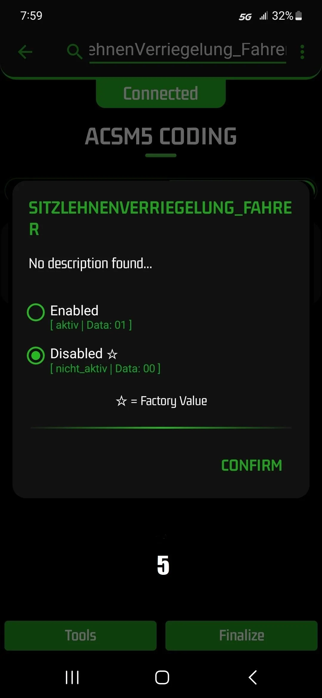

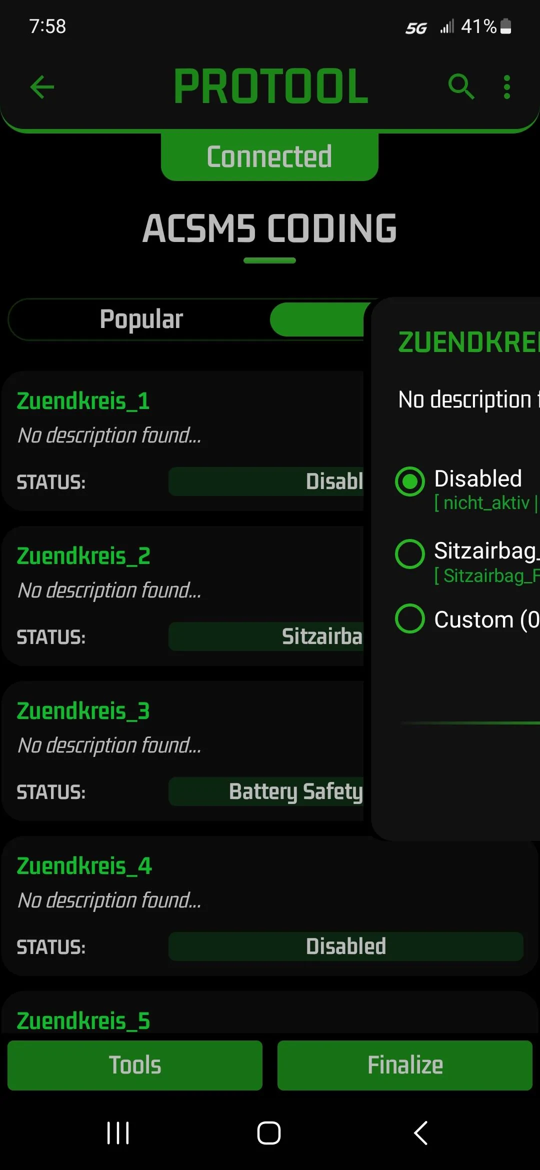

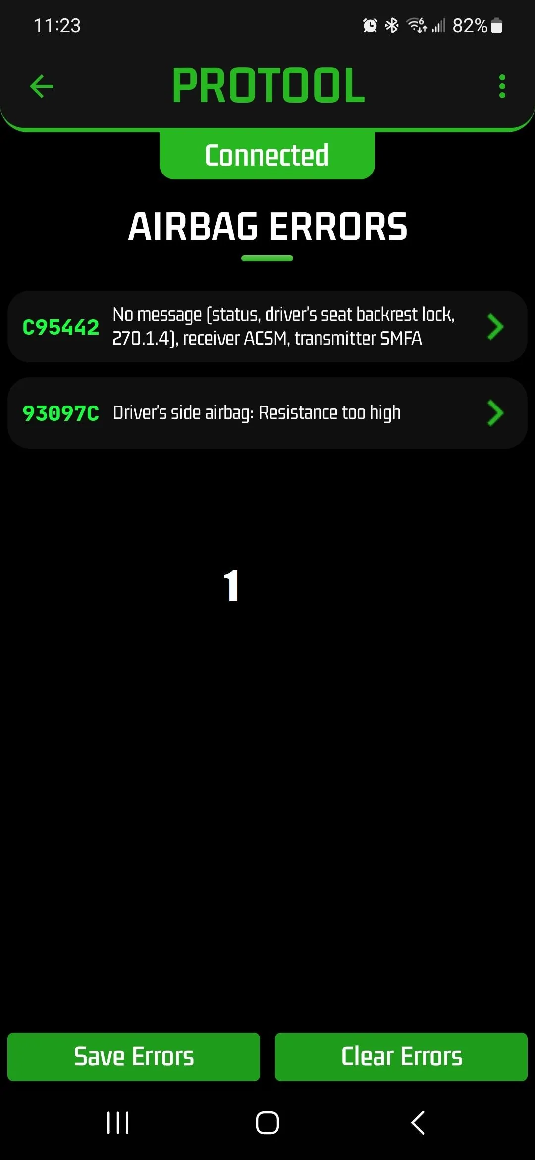

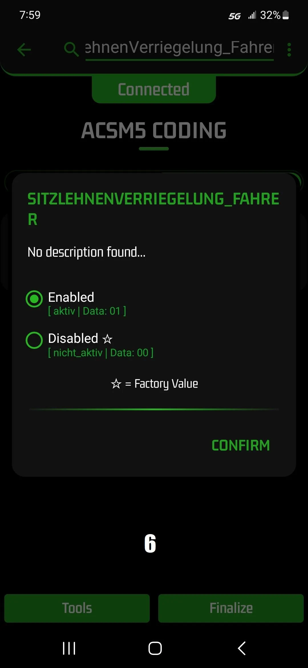

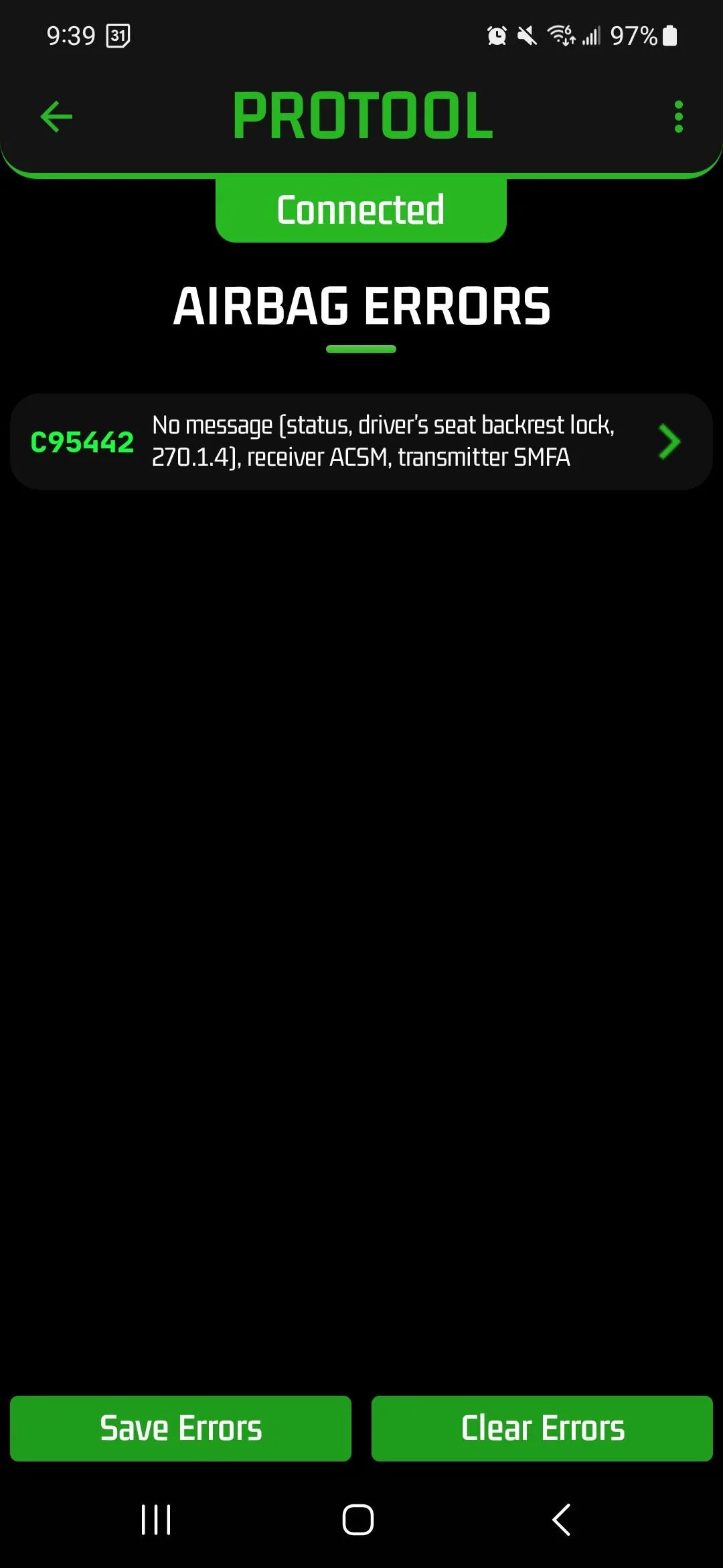

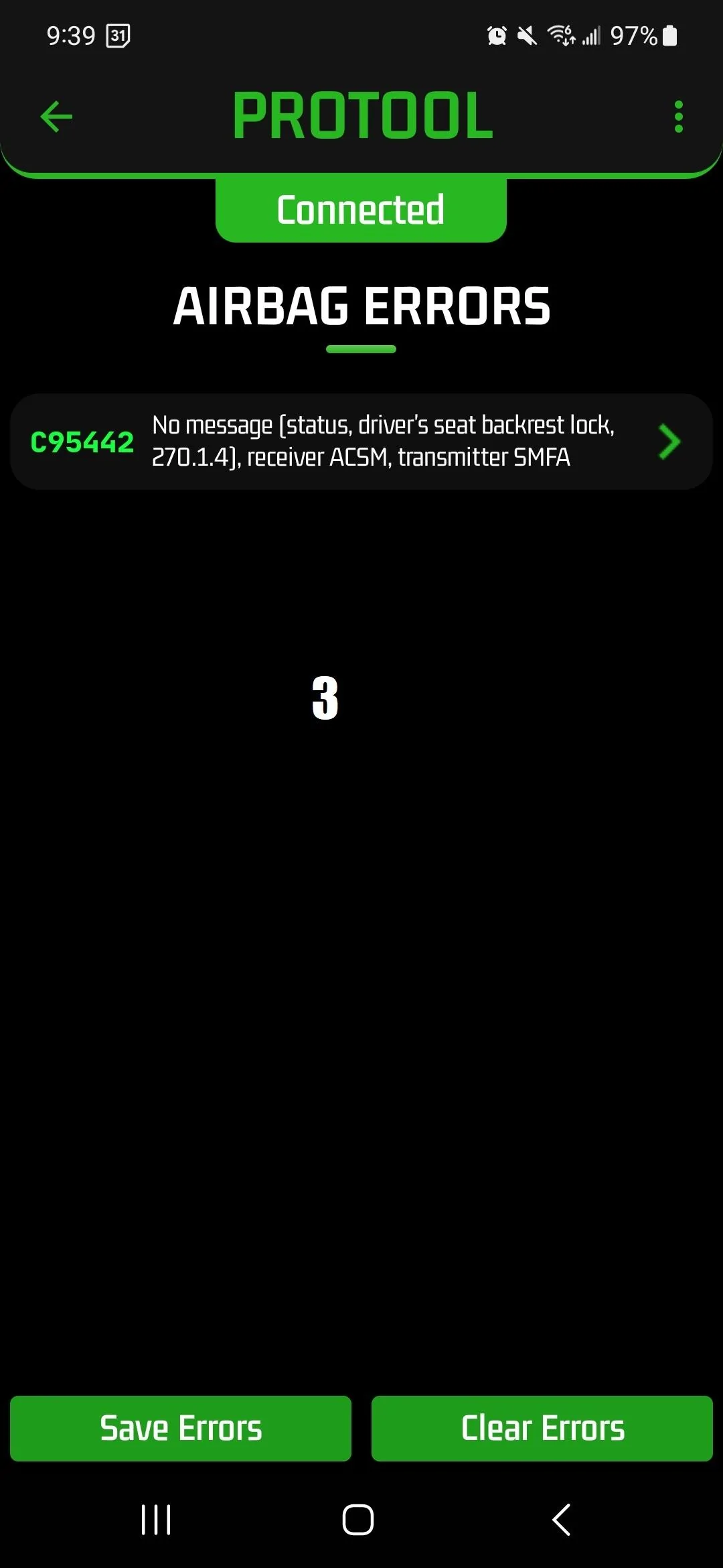

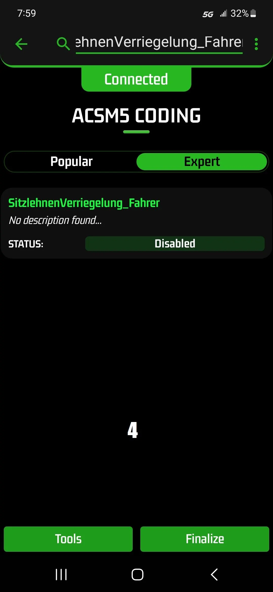

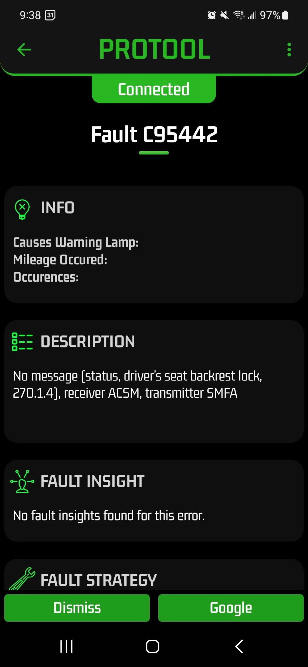

Okay, here is my update:
I started out with two codes, as with picture number 1.
I disabled a parameter as in picture number 2.
This left me with a single code as in picture number 3.
I was then advised by Bimmergeeks to search for the parameter as in picture number 4. "SitzlehnenVerriegelung_Fahrer -> Not Active" but I did not find exactly that verbage.
I found the parameter shown in picture number 5.
I changed it as shown in picture number 6 because I assumed I had to change something.
I still have the single error as in picture number 3.
I have sent the above the Bimmergeeks with the hope of finding a solution. My app menus don't match up with Bryan's. Also, I have the seatbelt plugged in, so not sure why I would be getting a seatbelt error, if that's what it is.

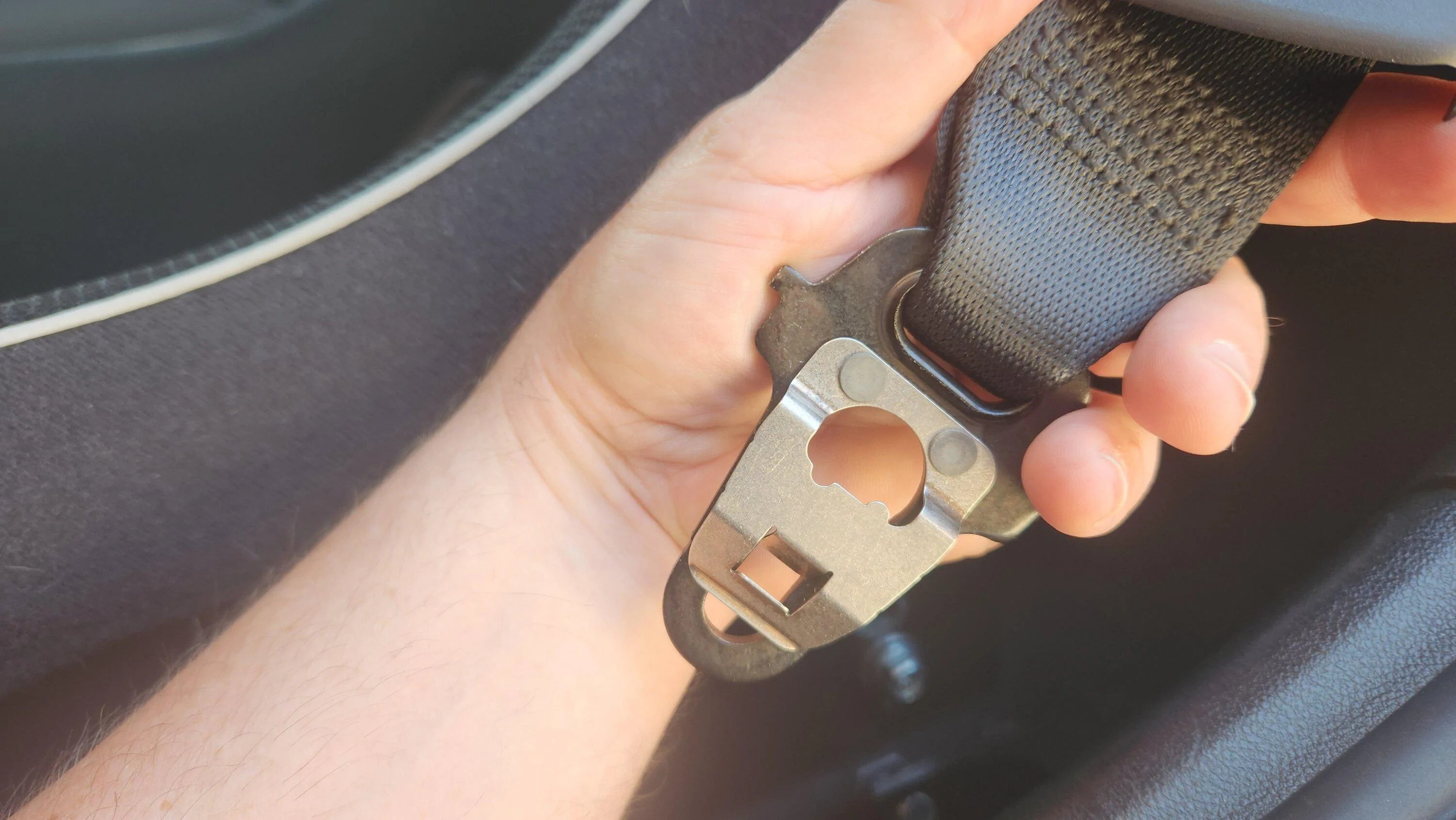

I had my OEM belt plugged into the harness yellow plug at the very end of it…
