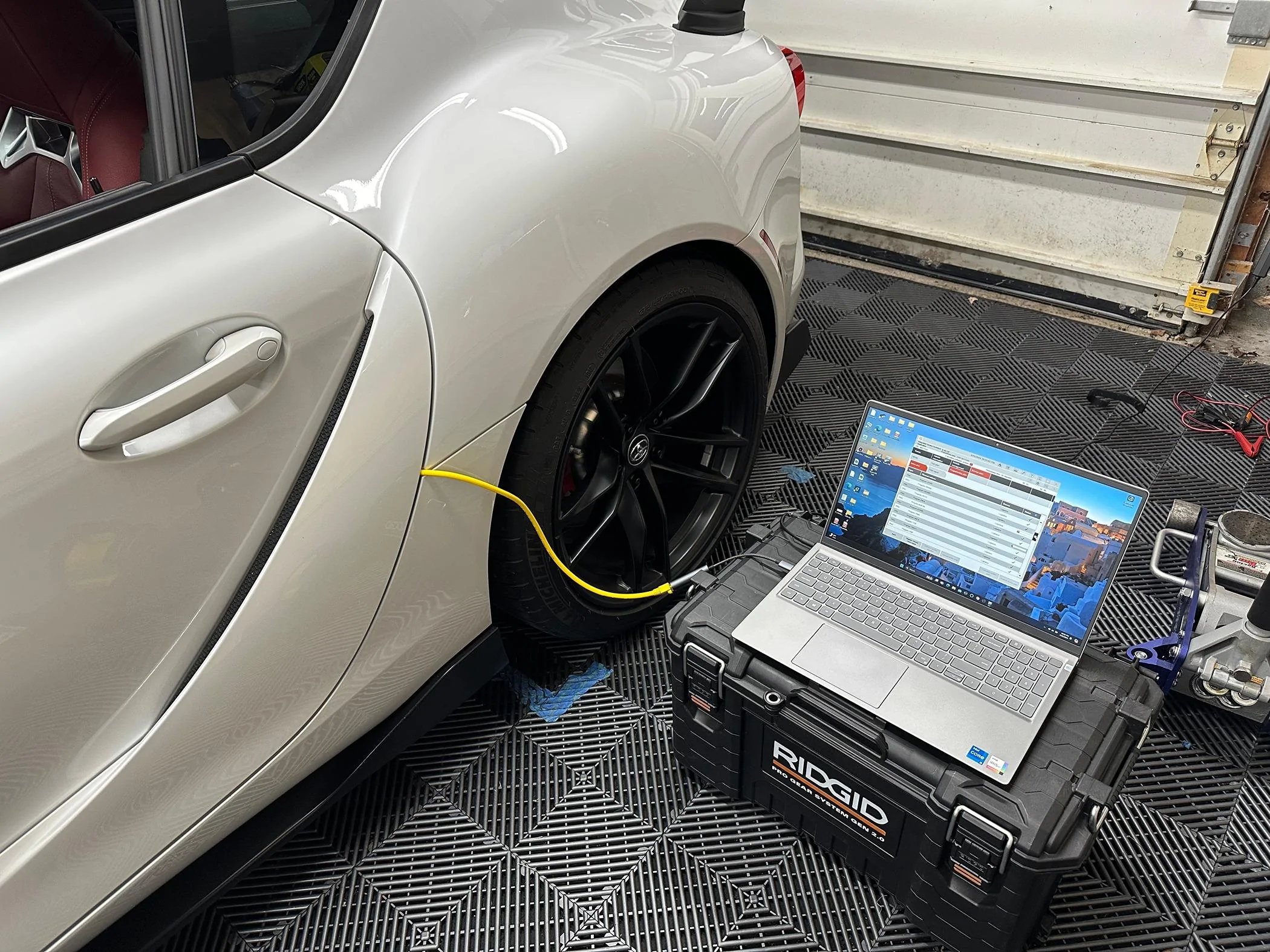

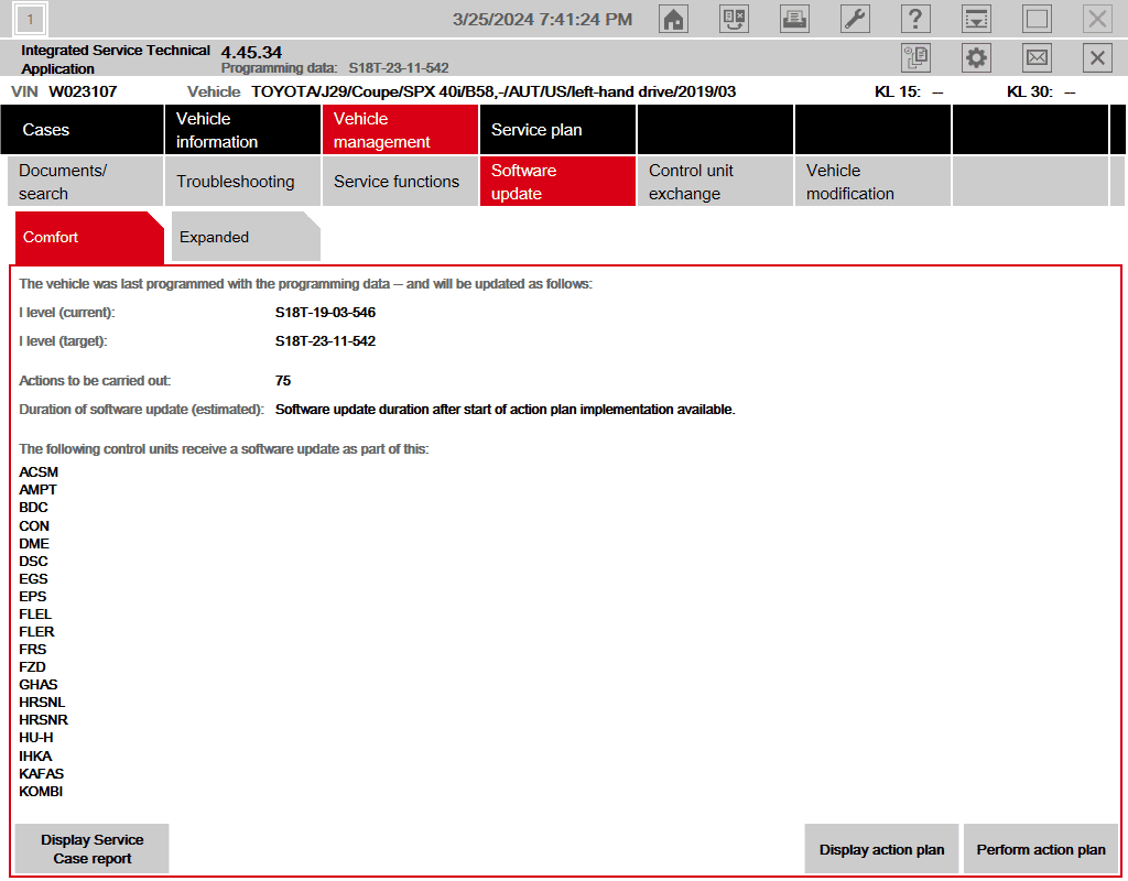

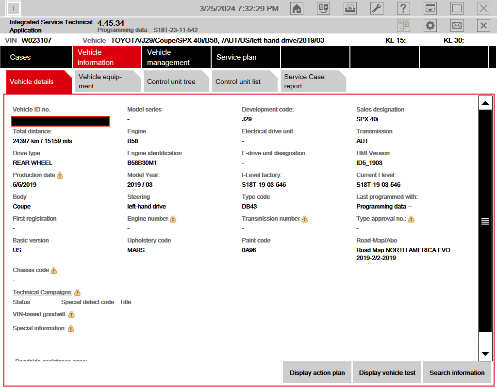

I recently used Techstream and ISTA to update my 2020 Supra from basically the original programming, S18T-19-03-546, (had never been to a dealer post sale) to the newest programming, which at the time (yesterday) was S18T-23-11-542.
This thread was very helpful. I used a windows 11 machine. I didn't need to use VM or a virtual box. I just installed Techstream GTS+ and ISTA off their servers, and payed for a license. Install and setup wasn't bad at all, other than Techstream being ancient and hard to navigate. The good news is that after setting up Techstream, you don't have to use it again. It's all ISTA after that. ISTA is more modern and very step by step and pretty easy to use.

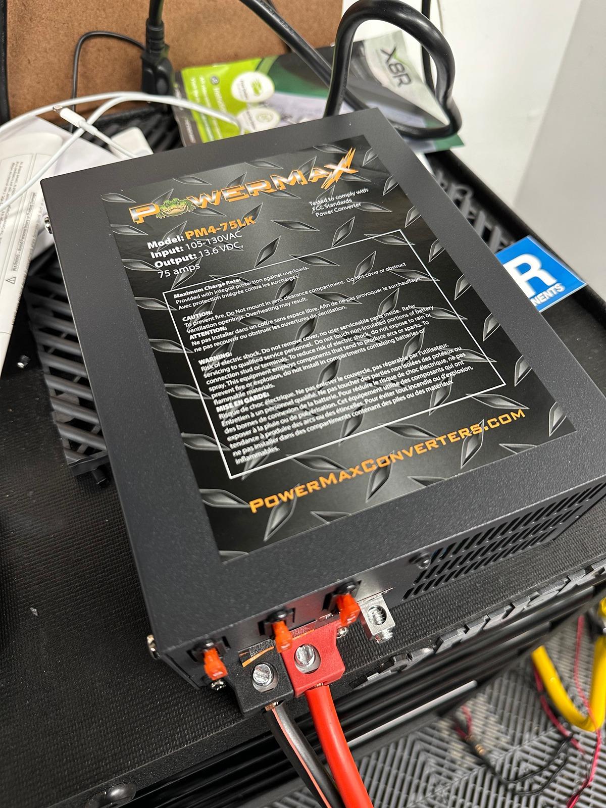

I used the +70amp charger from Amazon that was recommended here. I set it to 13.5v and it never dropped below 13.3v the whole time. Programming took about 35-40 minutes.
The hardest part of the process was putting both my OEM seats back in. Haha.
