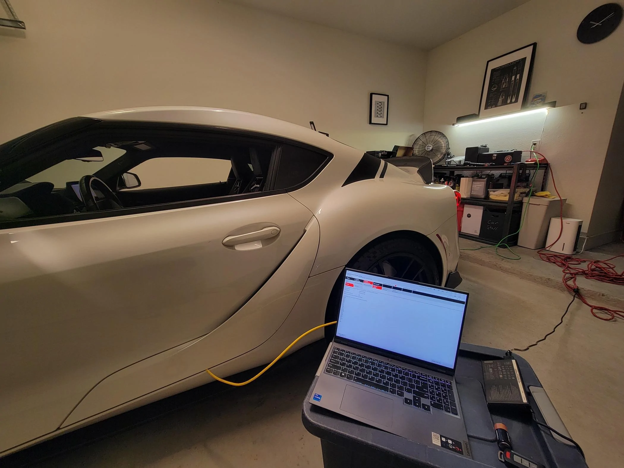

Just finished the update, and it's easy as the others mentioned! The only confusing part for me was understanding Techstream, but after that everything was pretty straightforward.

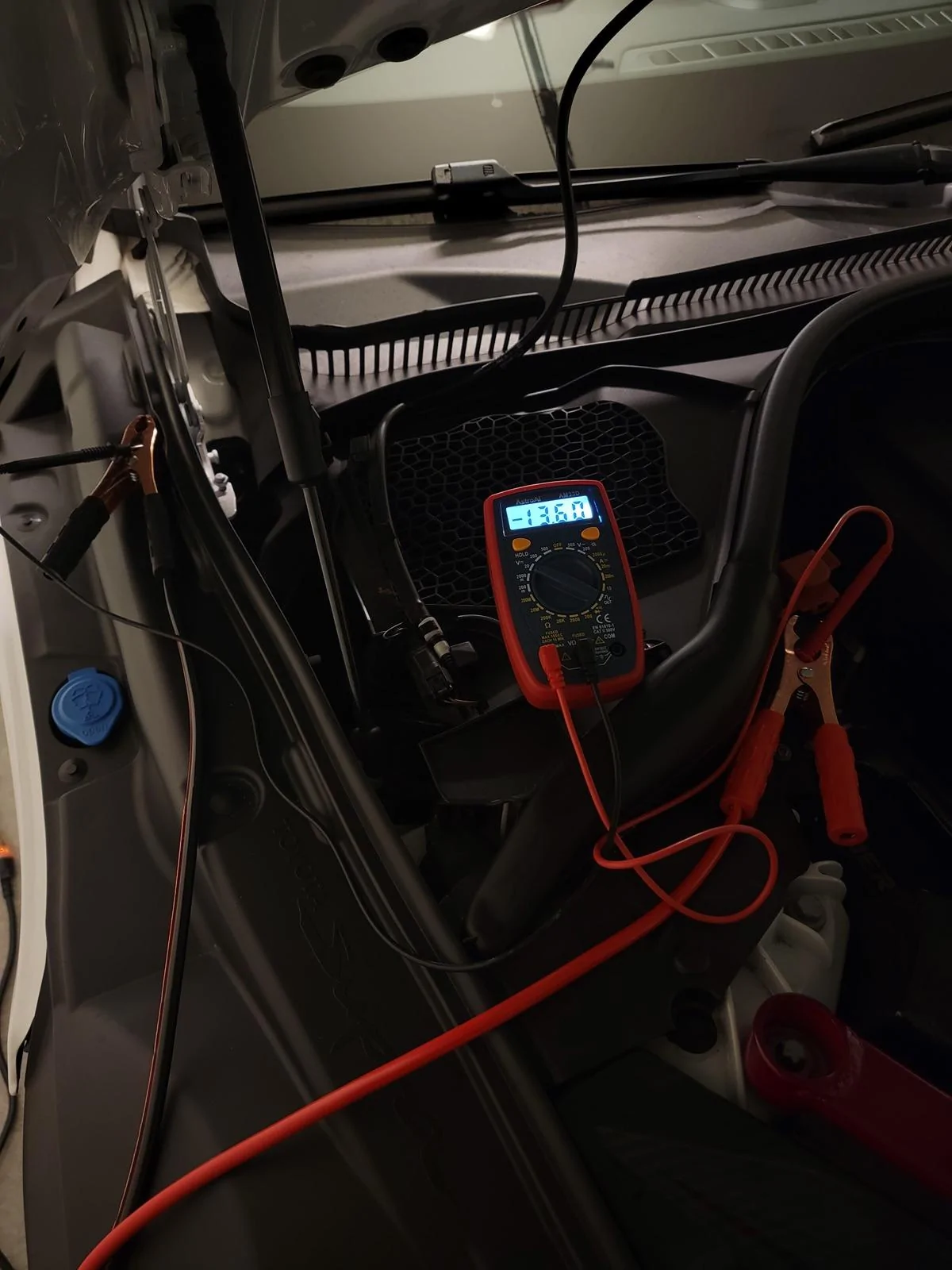

I used the recommended Powermax charger and monitored the voltage. In my case, I did notice the voltage dropped below 13, but gladly that was before I started the update. 1 hour before, I left the charger connected and monitored it to ensure it wouldn't fluctuate, and after a few tweaks it stayed at ~13.6v
Once the update starts, you'll hear the car making some weird noises but it's all part of the process. Update took around 30 minutes. After that I took the car for a quick spin. I didn't feel much of a difference, but I only drove the car for 5 minutes. Tomorrow I'll definitely test how it feels.
Overall easy process, just make sure to monitor the voltage
