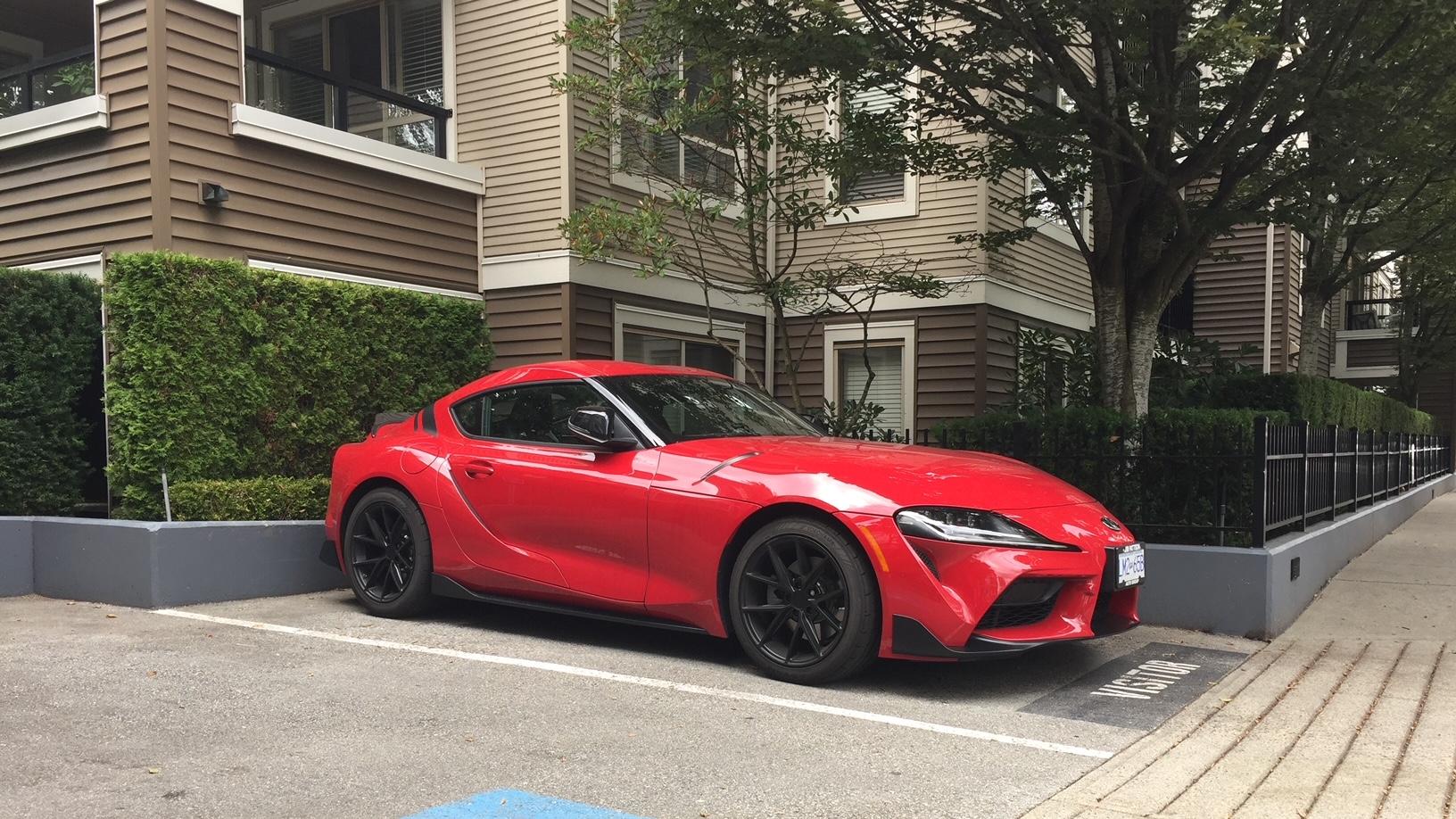

I got 18x9.5 Niche Misano's (matte) on mine. I personally like the looks and not as expensive as other brands. Fits both front and rear OEM tires and you don't need spacers.
Couldn't say how it compares to stock wheels in terms of weight.

So these would fit
so these would fit on the stock 18 inch tires? Cause ik its 18x9 in the front and 18x10 in the rear. I’m looking to buy some black rims but just making sure that 18x9.5 will fit on the stock tires.
SupraBC
Sep 6, 2020
163
251
Vancouver
'21 Supra 2.0
Yes they will
