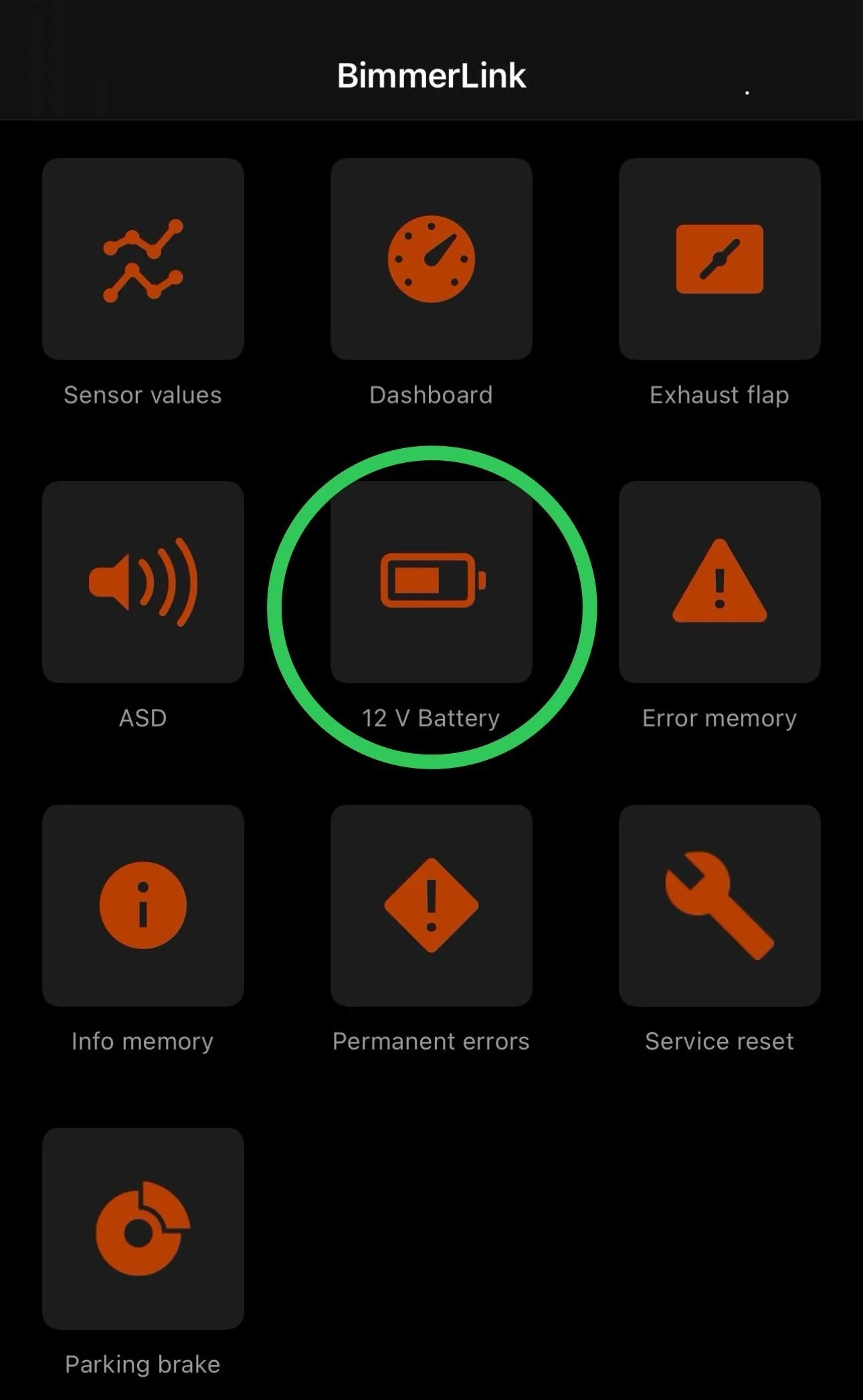

Ok, guys, I finally got it installed. Piece of cake, actually.
Removed the old one, including that little grey "umbilical" cord, lol, and reinstalled the new one. 10mm bolts for the terminals and top bracket and the 13mm bolt for the bottom left bracket.
I did purchase the CTEK lithium charger/tender before the battery, so I hooked it up to the engine bay terminals after installation to keep it charged up while I went through the Bimmercode and Bimmerlink coding.
Did the 3 quick presses of the ignition to put it in Diagnostic Mode, buckled the seatbelt and turned all accessories off.

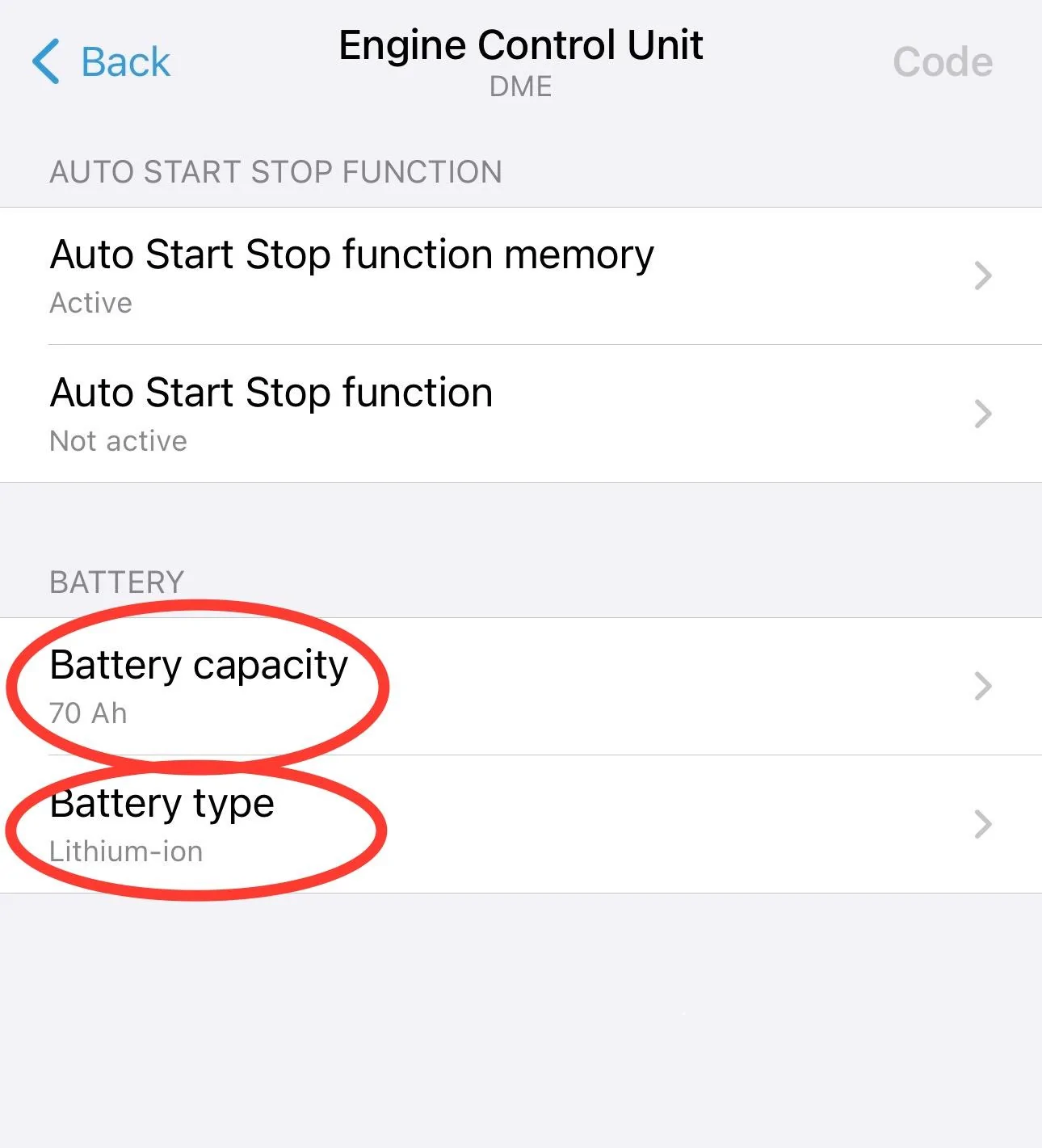

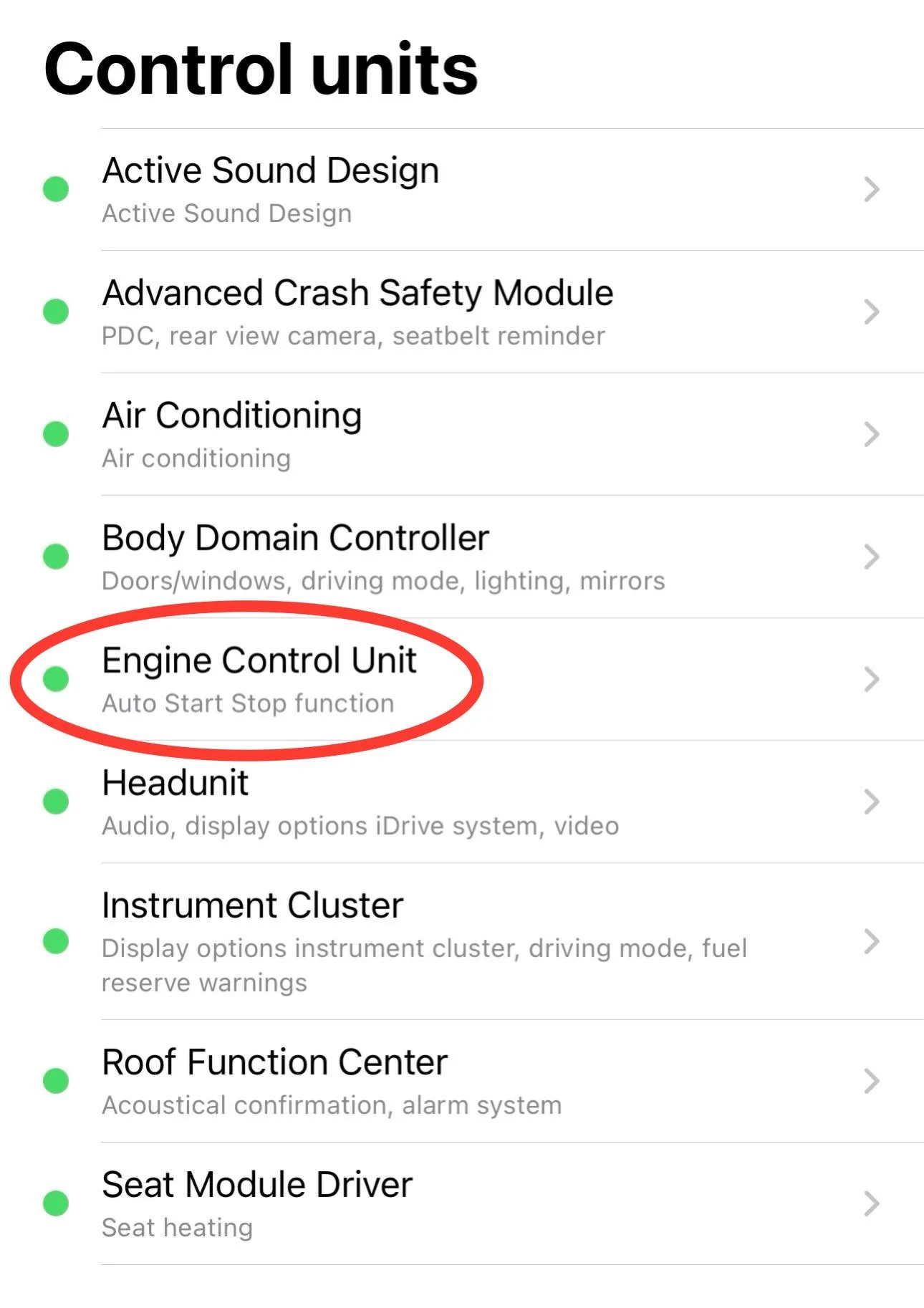

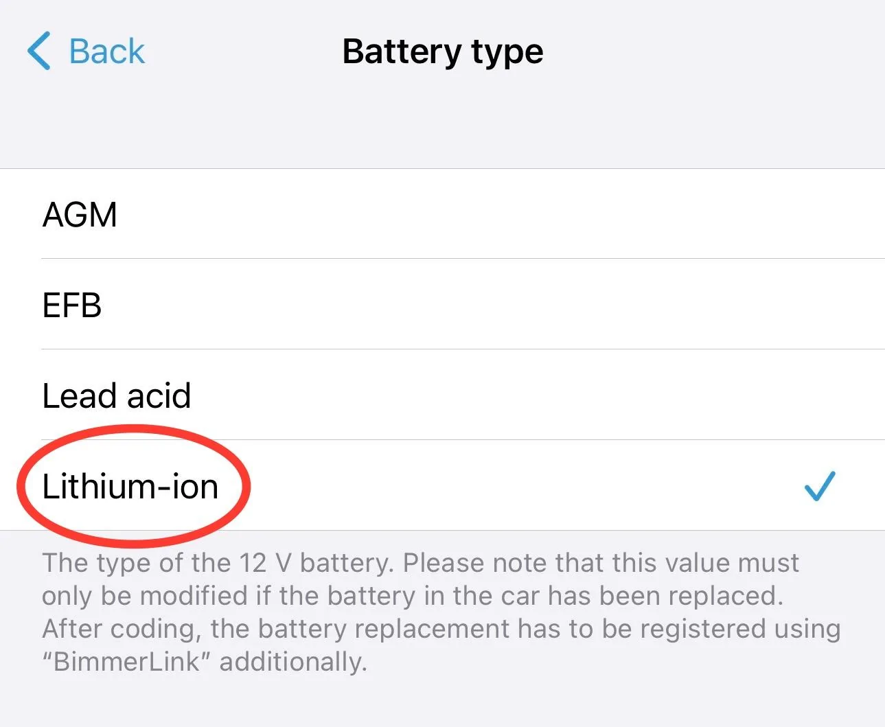

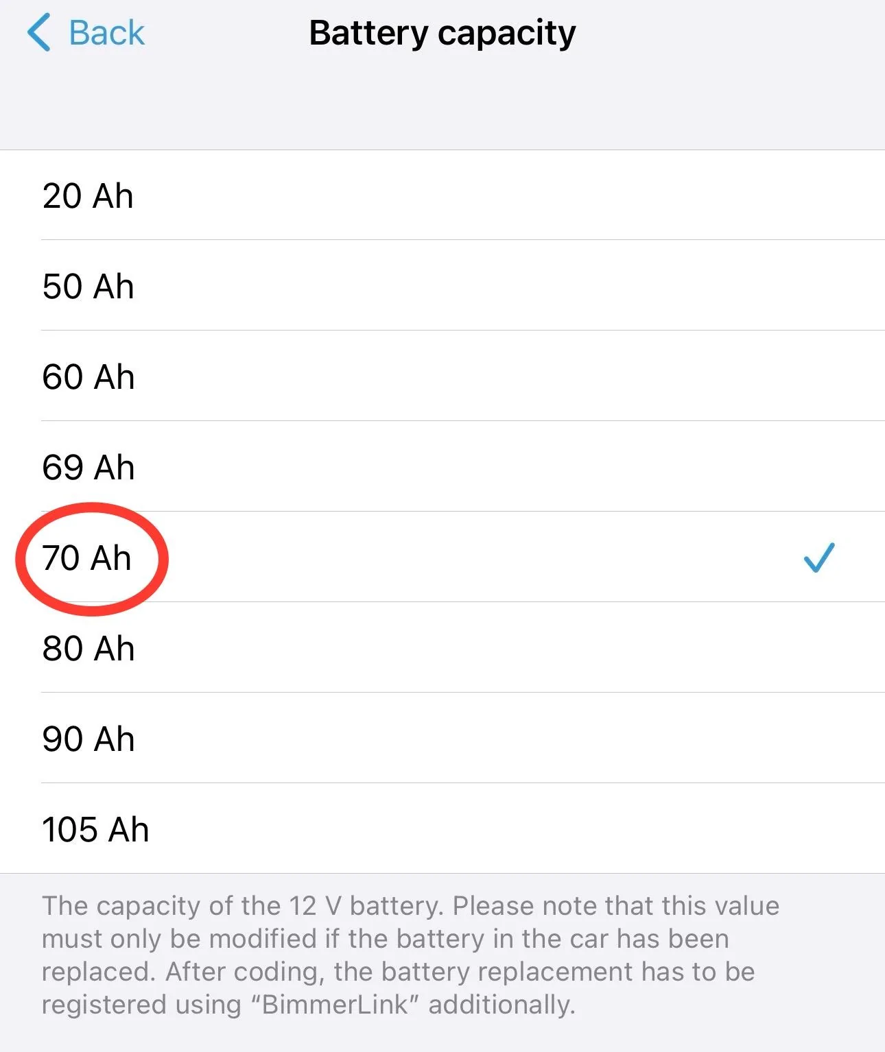

I fired up Bimmercode first. Clicked on ECU (Engine Control Unit), changed the Battery Capacity from 105Ah (OEM) to 70Ah (closest setting since mine is 68Ah), changed the Battery Type from AGM (OEM) to Lithium-ion then hit CODE.

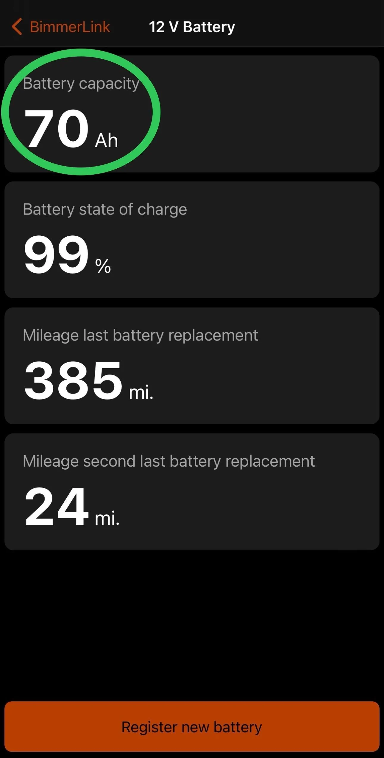

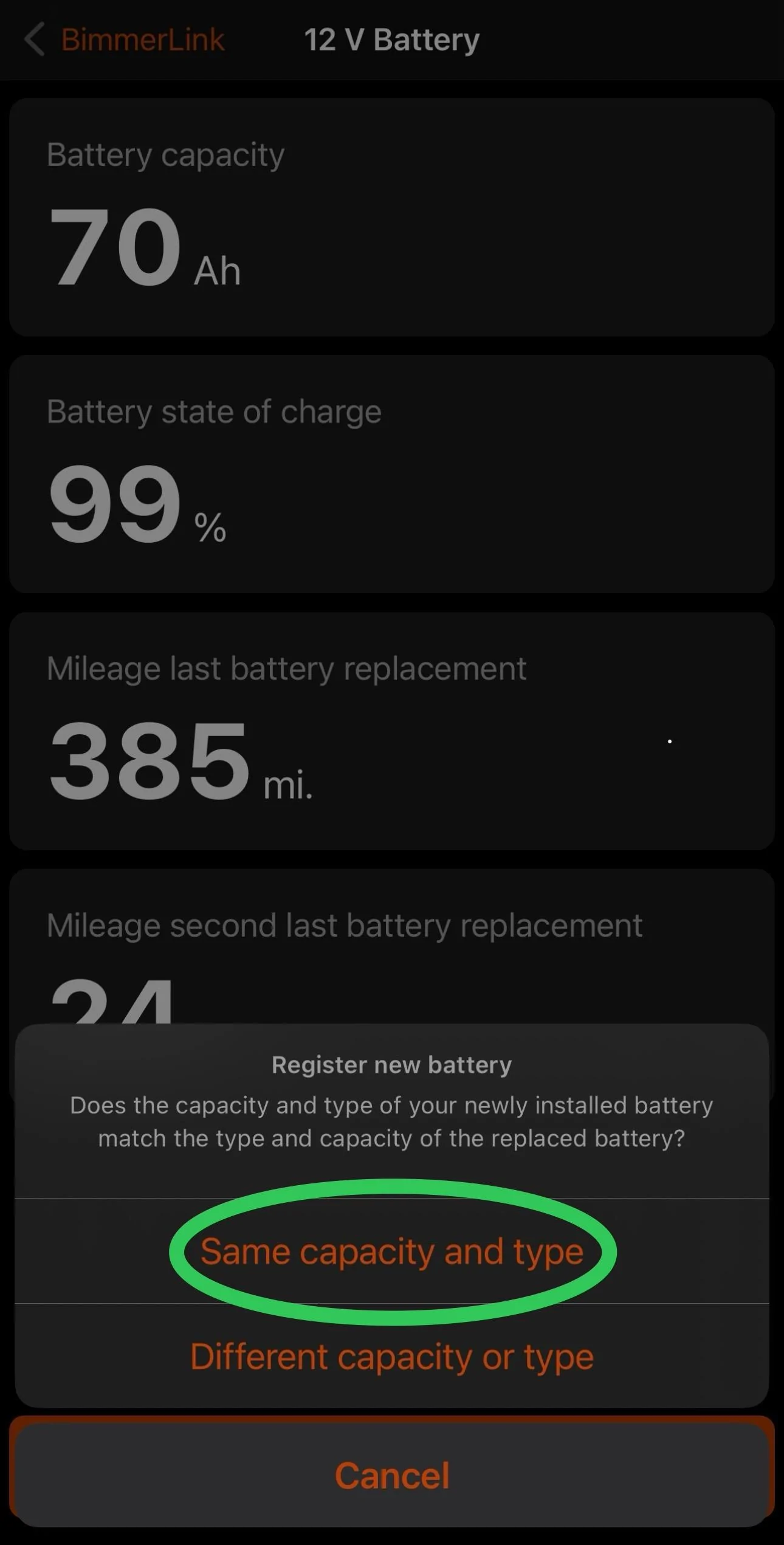

Then for Bimmerlink, I just clicked on the Battery icon and since the 70Ah capacity was already preloaded, I just selected the "Same capacity and type" option and completed the registration.
Car started right up with no hiccups! Even all my settings and presets were still all saved and recognized. The only thing that took about 5 minutes to catch up was the clock and the parking sensor system.
