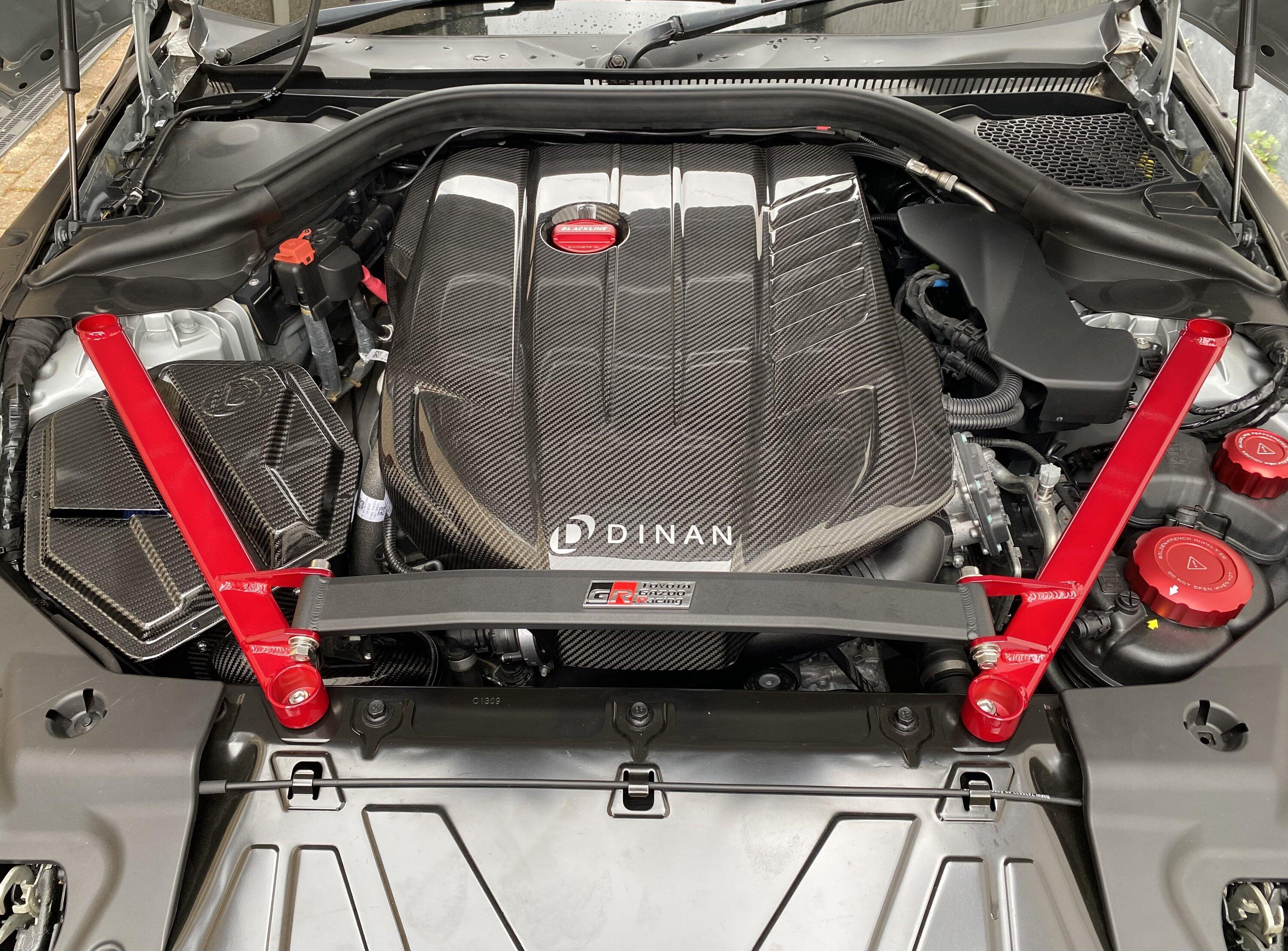

Just installed my Dinan intake and turbo inlet and I'm noticing much higher IAT temps (+60° F above ambient temps. after a couple of 0-60s).. bummer..

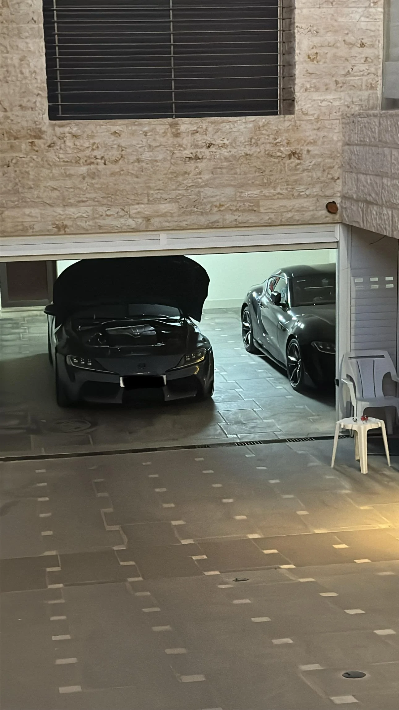

Curious, have you tried it with the lid off?
I thought about doing this but the lid is just so beautiful i don’t wanna run without it. I love everything about this intake. The quality, fitment, functionality, and design are all top notch. I just miss how loud the armaspeed was in comparison tho take and give IG

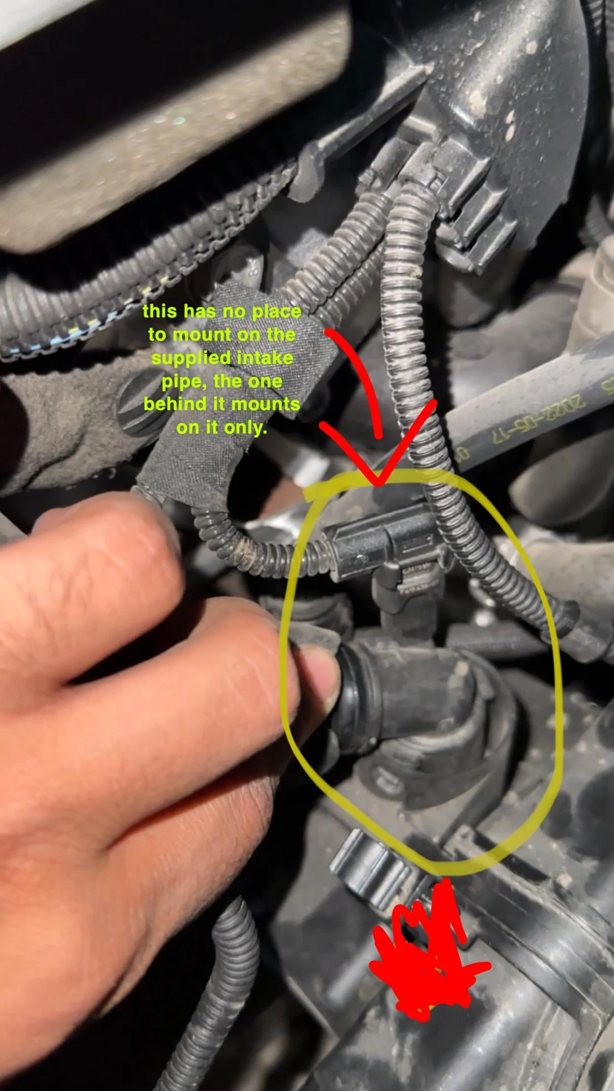

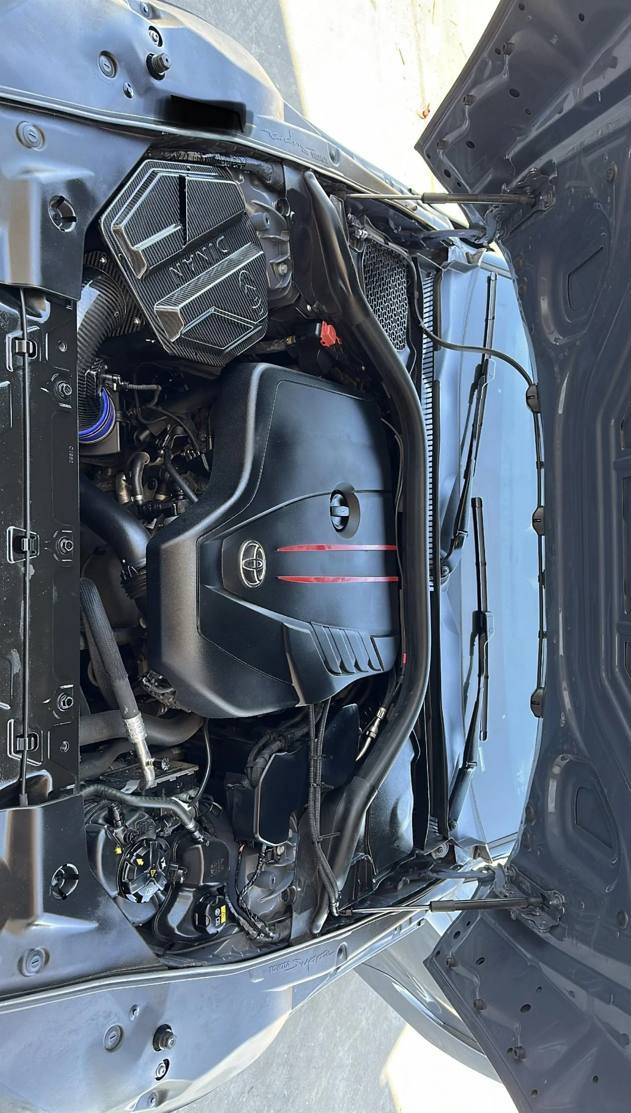

I received my intake for my 2.0 (bought from ebay) unfortunately i couldn’t install it because the middle east spec cars have different mounting locations for the intake pipe, the PCV line has no place to mount on the intake pipe that’s been supplied.
dinan stated this mounts on all 2.0 supra’s, fortunately the solution to this is to
1- mount it with the short intake pipe for the Supra B58 or the 330i B48 Intake (whichever will work with the intake i purchased)
2- Use solution #1 but i could also use the BMW 330i turbo inlet so it mounts all the way, i can run either of these setups above.
I have reached out to dinan technical support to reach a solution, will update.
Out of the office on vacation this week but got this notification so wanted to chime in...
Good to know that ROW intakes on the Supra are different (at least on the 2.0). That said, our vehicle fitment guide is based on US spec cars as those are the vehicles we have access too. Fitment for EU spec or other regions has never been verified/tested. All we would be able to say is that the factory inlet pipes/resonator from 2020 to 2023 have went unchanged here in the US (17881-WAA01 or 17881-WAA02 depending on engine).
I will defer to the technical support guys as any real answer will require 3D scanning data but based off the parts we offer and their differences I can say with near certainty that any B58 part would not help your situation as the tube angles/bends are very different and would not line up properly. BMW 330i upper tube would be your best bet most likely but again I am unsure of how close those angles (and size) may be between the Supra and it without consulting scan data. Same for the BMW 330i lower tube/inlet -- assuming that problematic secondary connection is also the same. Regardless, all data we are working with is still based on US specs so there will always be some uncertainty with any potential solution in this particular case. Trial and error is what it would likely come down to which will be both expensive and timely so my personal reccommendation quite honestly is to arrange a return with the eBay seller you purchased from.

That’s because the design with the open slots and the intake tube not sealing is just sucking in hot engine bay air. Basically not any better than an open element intake. You’re all paying for the pretty CF, not that there is anything wrong with that.

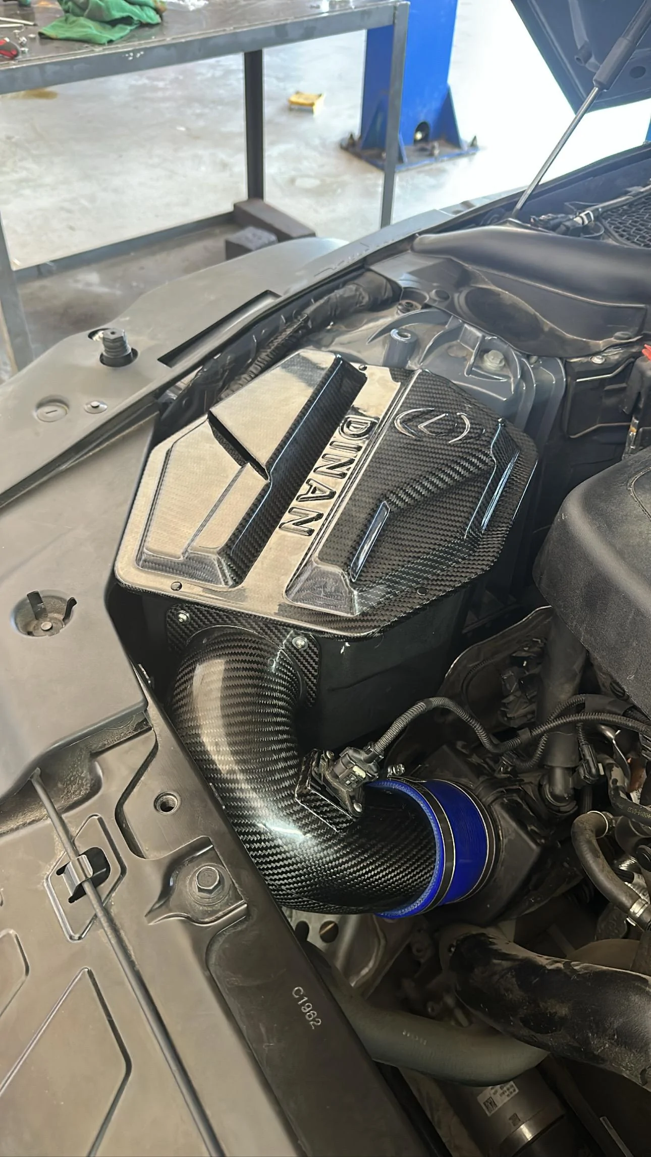

All went good, i went to a local shop and had them cut the intake pipe to become shorter like the one for the G20 330i and mounted the intake just fine with an intake coupler, the noises sound so good and the car has slightly better throttle response. you guys should update your website to note that cars outside the US need a different intake pipe.
