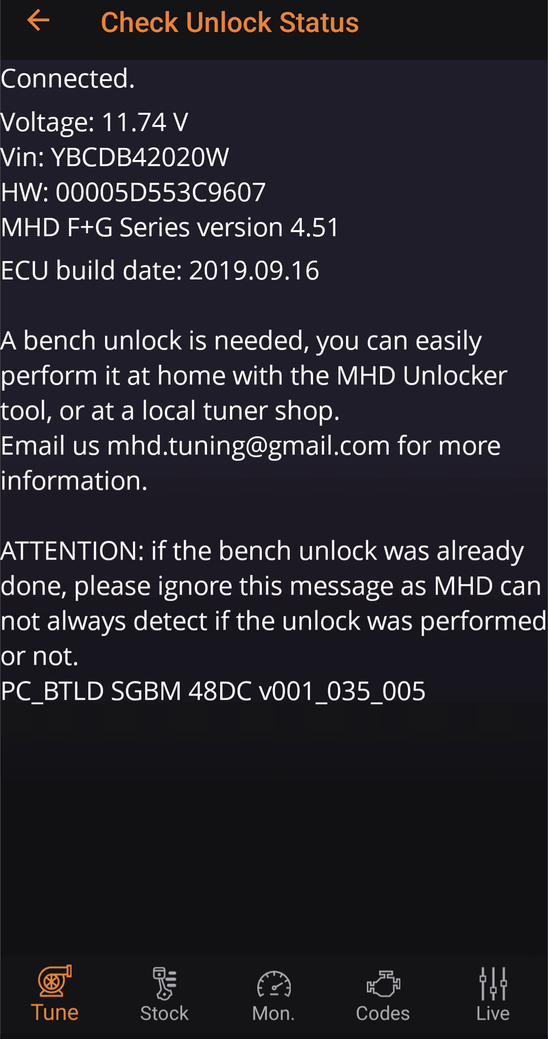

Bugger, had hoped my car being one or the early models (Sept 2019) a DME unlock wouldn't be required :(
Has anyone tried the new MHD DIY unlock feature? Any feedback as a home DIY?

By that ROM ID you had the dealer update does. So that requires a bench unlock before you can flash.
The at home unlocker works. You just need to buy the hardware from www.bimecu.com
And then the mhd license.
Or you can use our mail in service for unlock. For $175+shipping

Thanks for the advice.
So $299 for the cable. Need to see how much UK unlock is, car is in the UK. Good to know the unlock feature is part of the flash license now.
So $299 for the cable, is there an additional license, of just the MHD flasher which I'll be buying anyway? Off to their website now.
Should just be the flasher license iirc.
