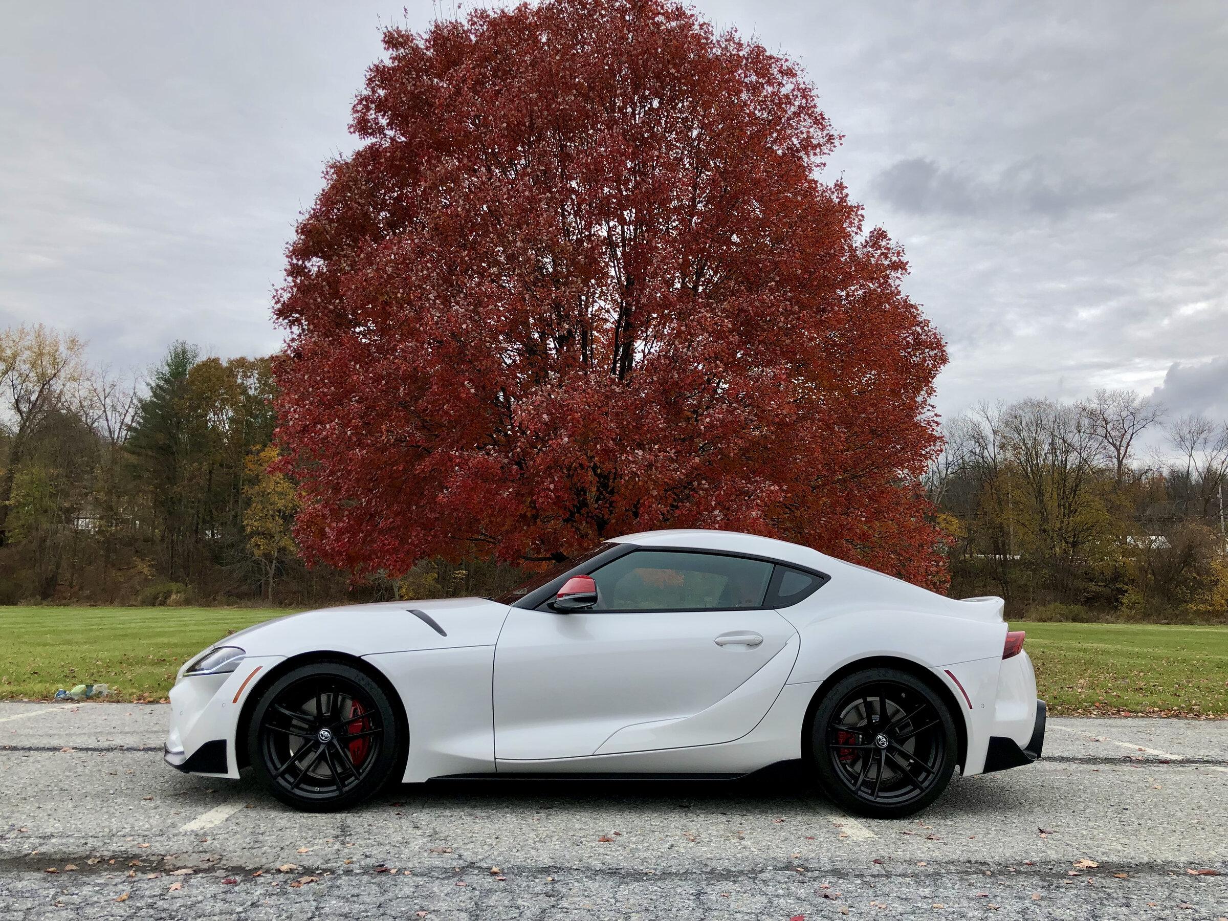

I bought a very gently/barely used 2020 white Launch Edition in November 2021 after trying but failing miserably to find a white 21/22 Supra that didn't have a crazy markup. I found this a couple of states over in Ohio with only 1,200 miles on it and it still had factory plastic protection film all over the interior. I had the car shipped to me in New York and went over every inch of the car and it was immaculate. The car must have just sat in storage the last couple of years. The tires didn't even look like the car had driven anything other than in a straight line.
Five minutes after it came off the transport truck:

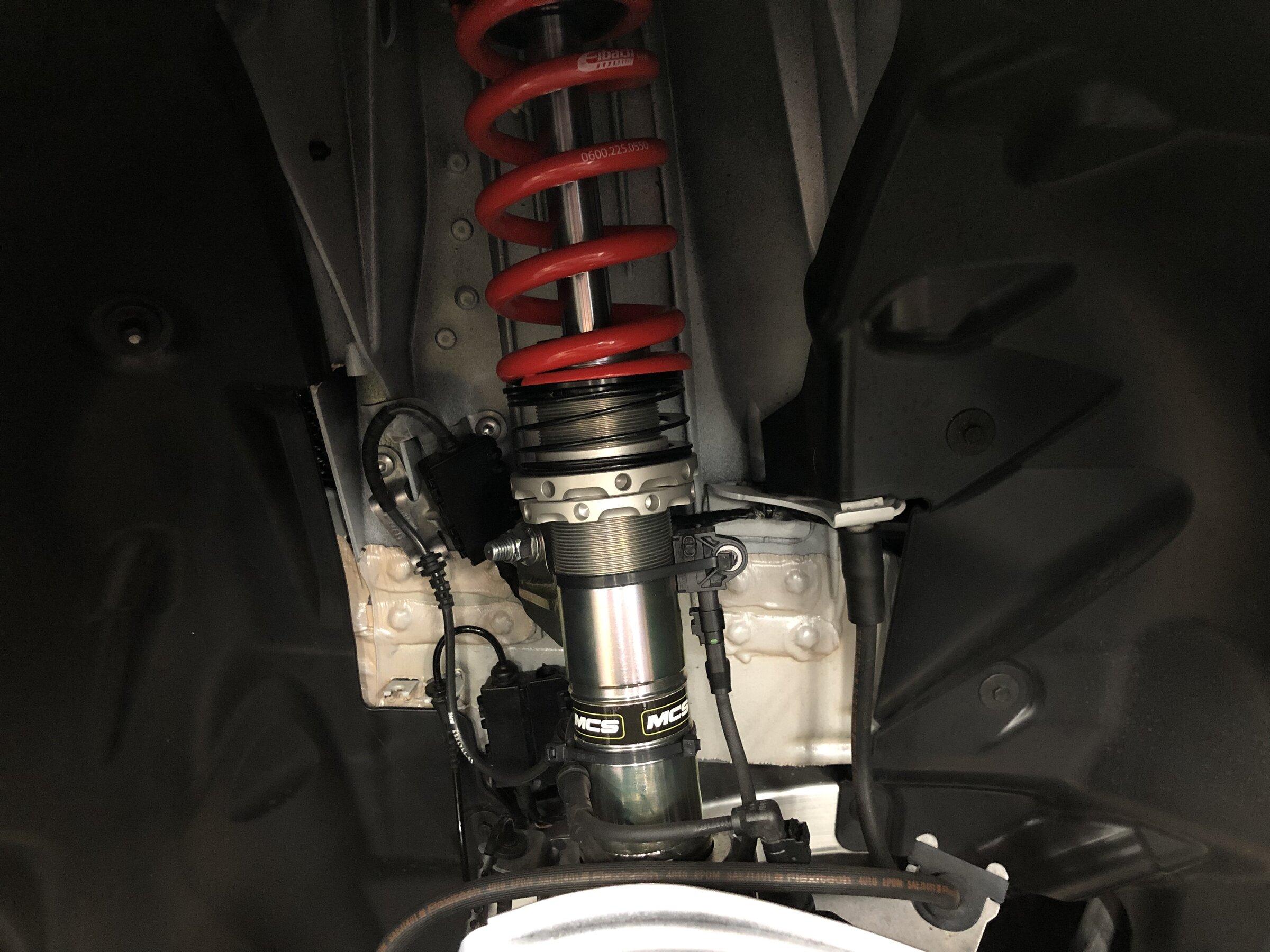

Current list of modifications ready to go on the car:
MCS 2WNR coilovers

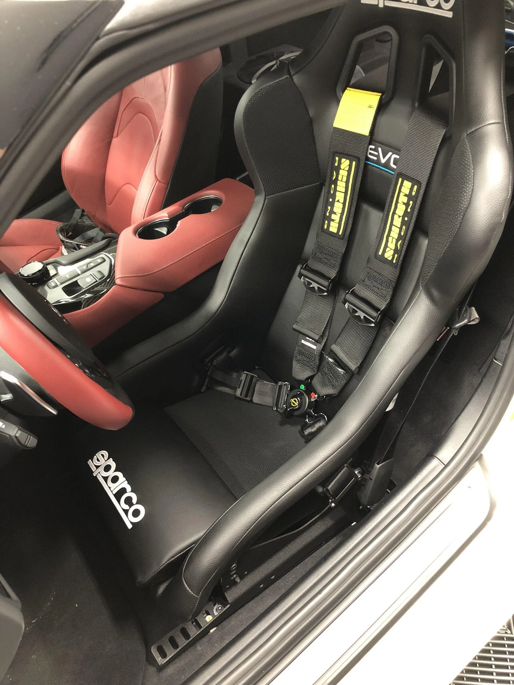

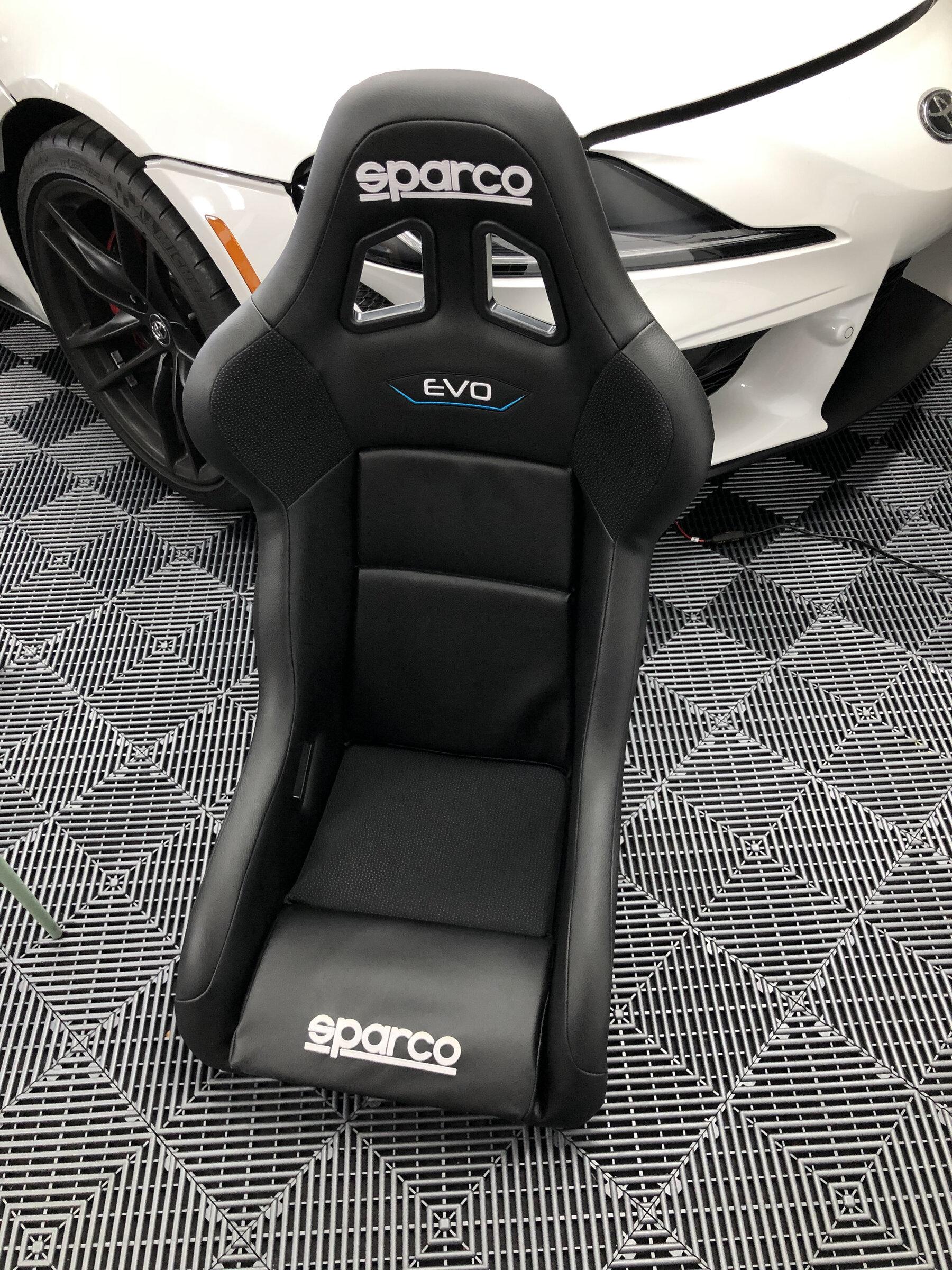

Sparco Evo QRT seat
Bride seat base
Schroth harness
Cusco harness bar
EVS Tow hook

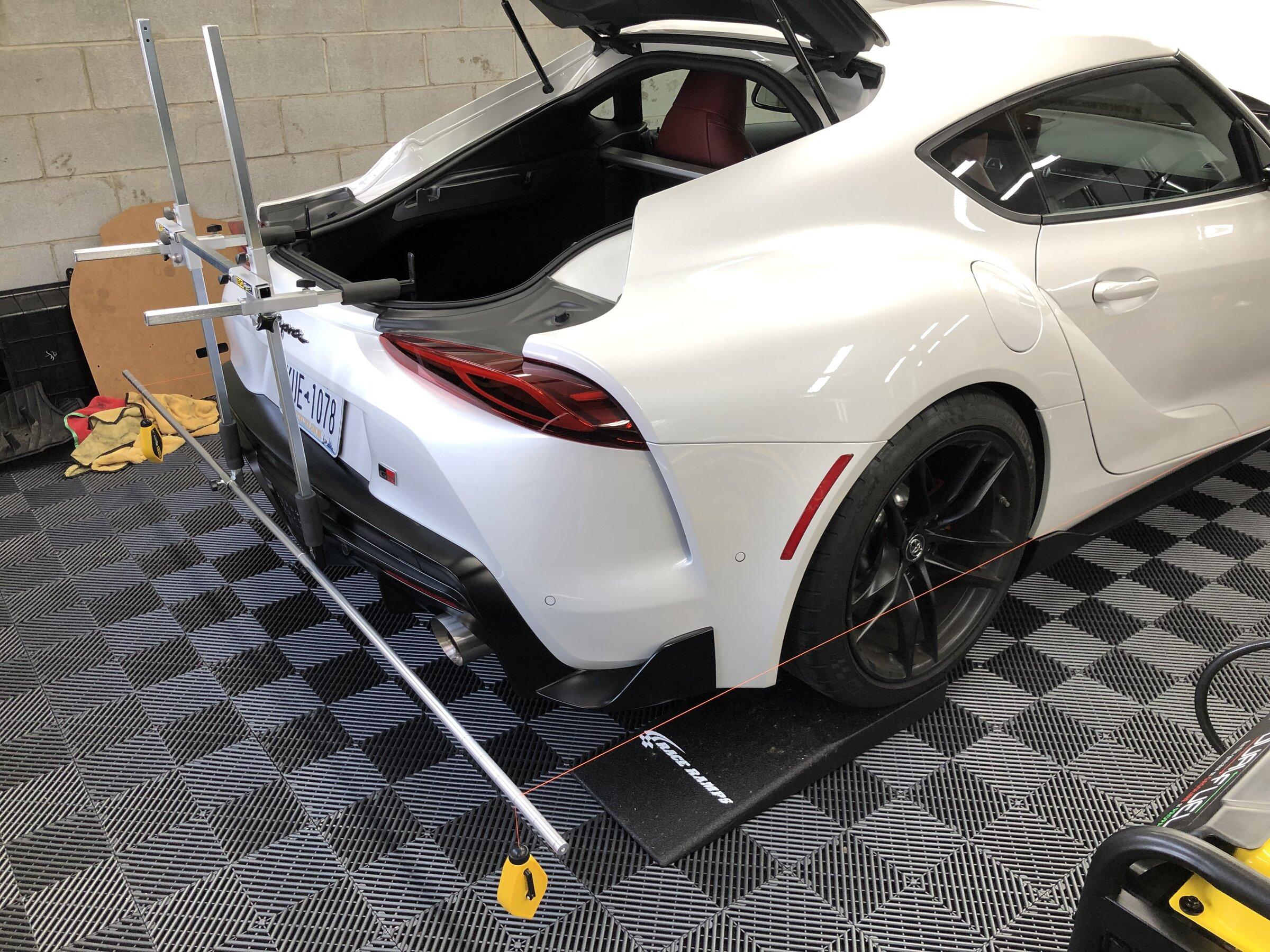

Slowing getting the Supra ready for track season.

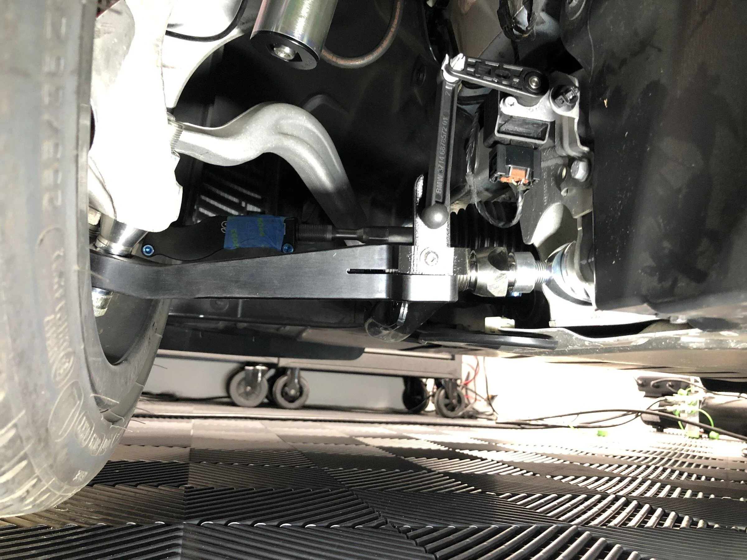

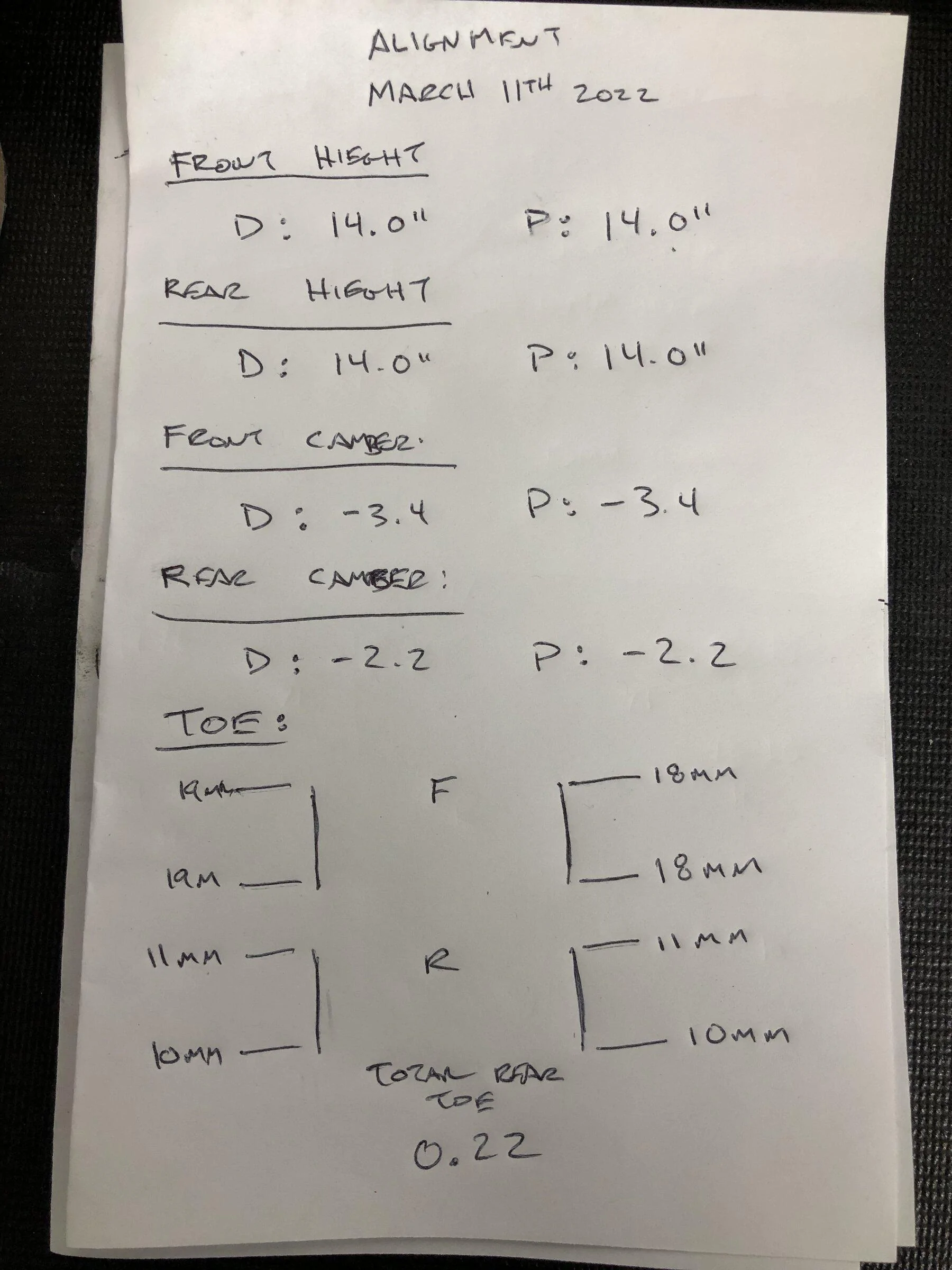

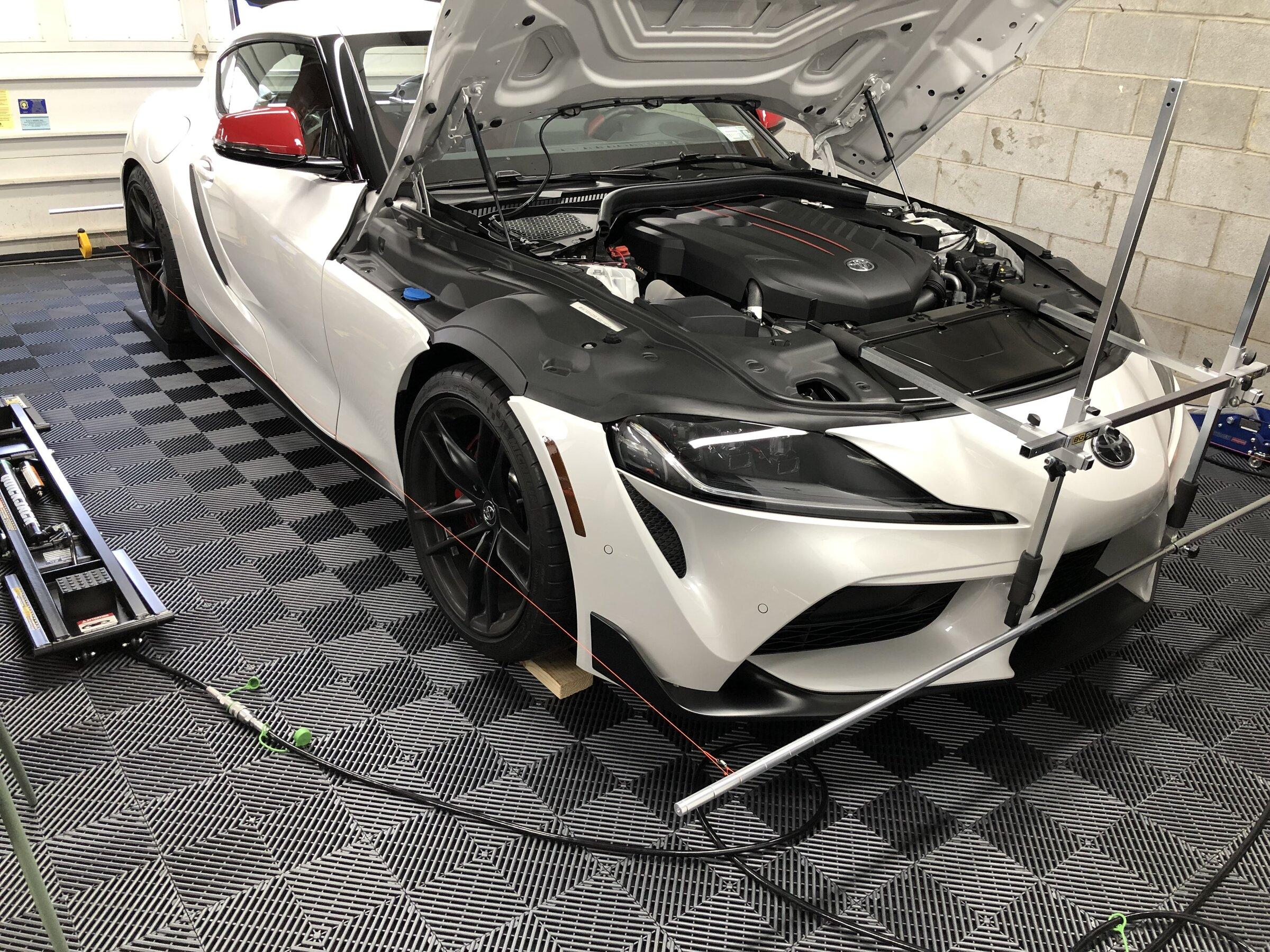

While doing some research on good alignment shops, I found out there are none very close to my new place of residence. I then decided to finally invest in a good string alignment setup.
This was surprisingly pretty easy to setup and use. The most tedious part is lowering the car down, driving it back and then forward to settle the suspension and then take measurements again. Luckily this setup is mounted on the car so you don’t have to reset it every time.

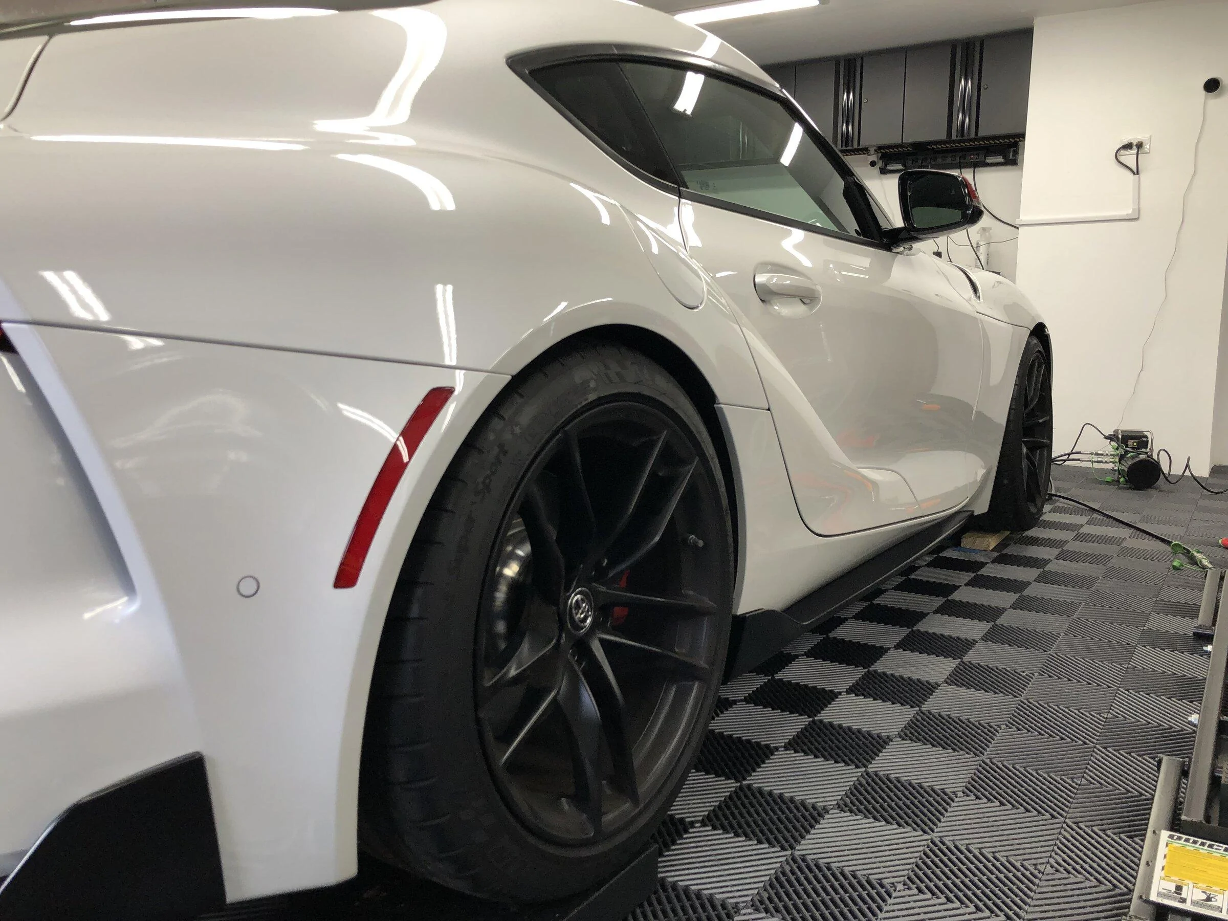

This is also the first car I have owned that had jack points so low. Even with my very modest .5” lower set height, I can’t get my quickjacks under the car without driving the car up some ramps and wooden blocks.

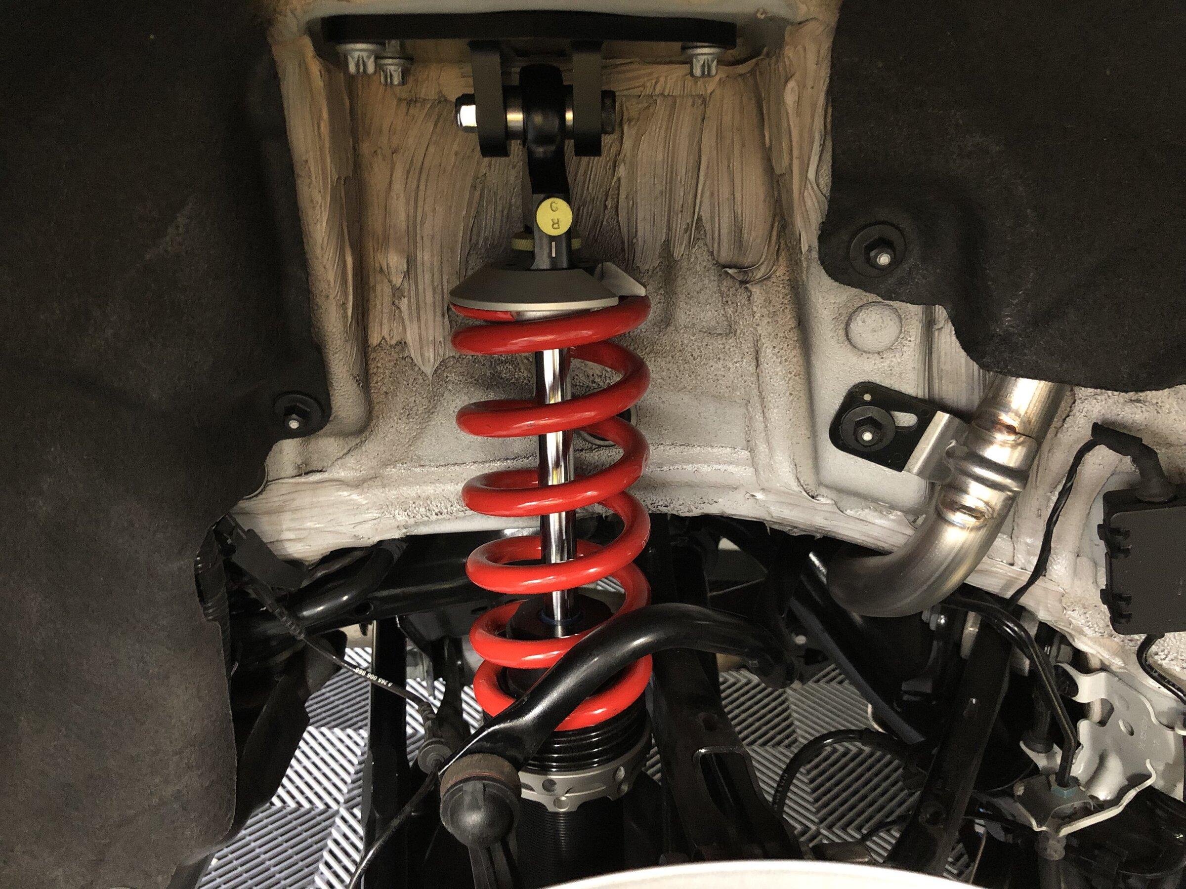

So, now I have the coilovers fully installed with SPL rear toe bars, rear traction bars, front lower camber arms and bumpsteer bits, and the ride height and alignment all done. I have a track event next Friday. Looks like the weather should be mid to high fifties. Currently showing rain so crossing my fingers that changes. It’s currently snowing with about 3” on the ground. ?

Great work on the alignment set up.
So MCS are a true rear coilover?

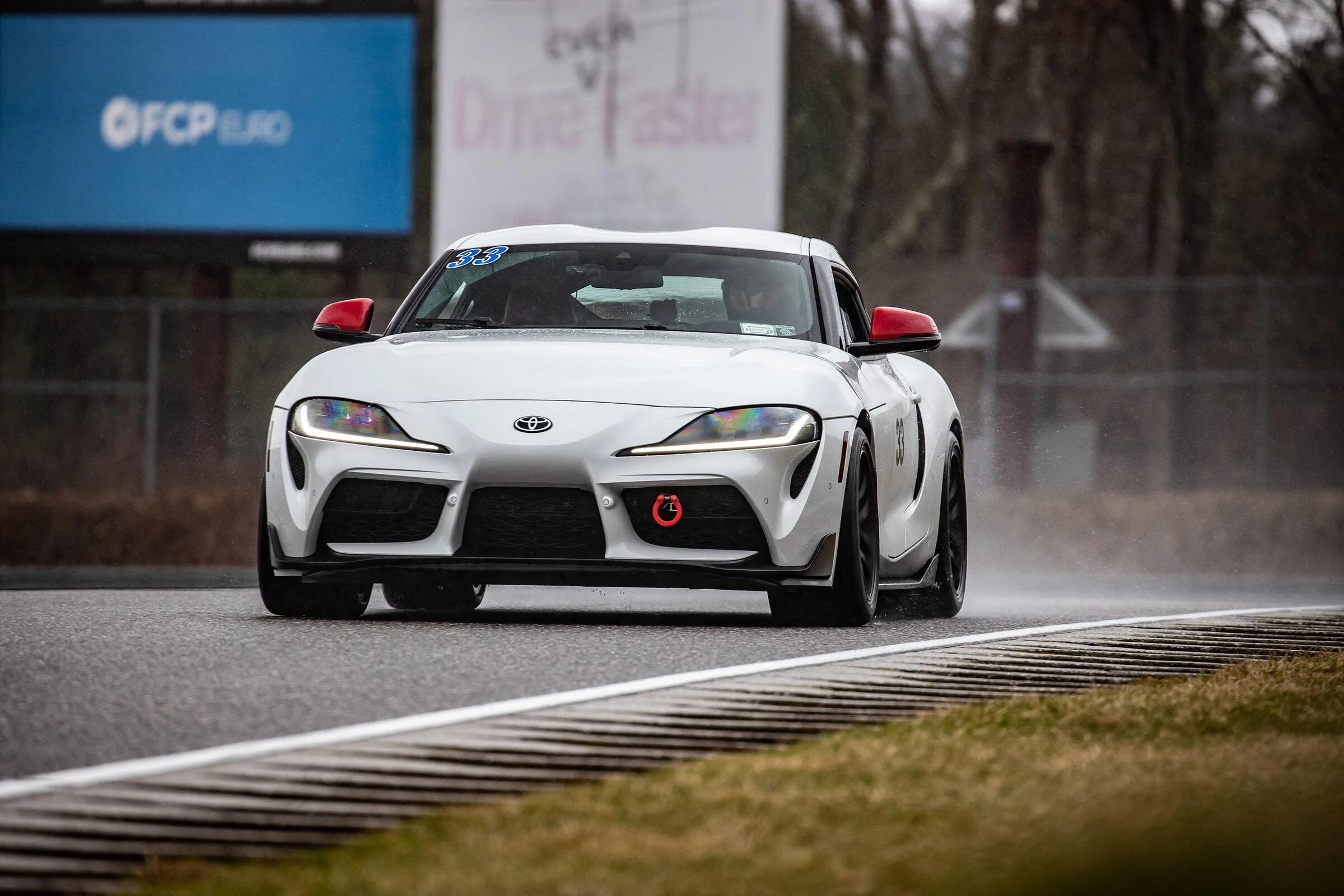

First track day with the Supra was this weekend at Lime Rock. First time to this track for me. Wet, rainy and cold all day. Couldn't get any heat in the tires so the car was all over the place. Lots of cars going off track, some hitting armcos and tire walls so I just stayed safe and worked on learning the track and feeling the car out.
Looking forward to a dryer and warmer track day to really see how the car feels. Soon!

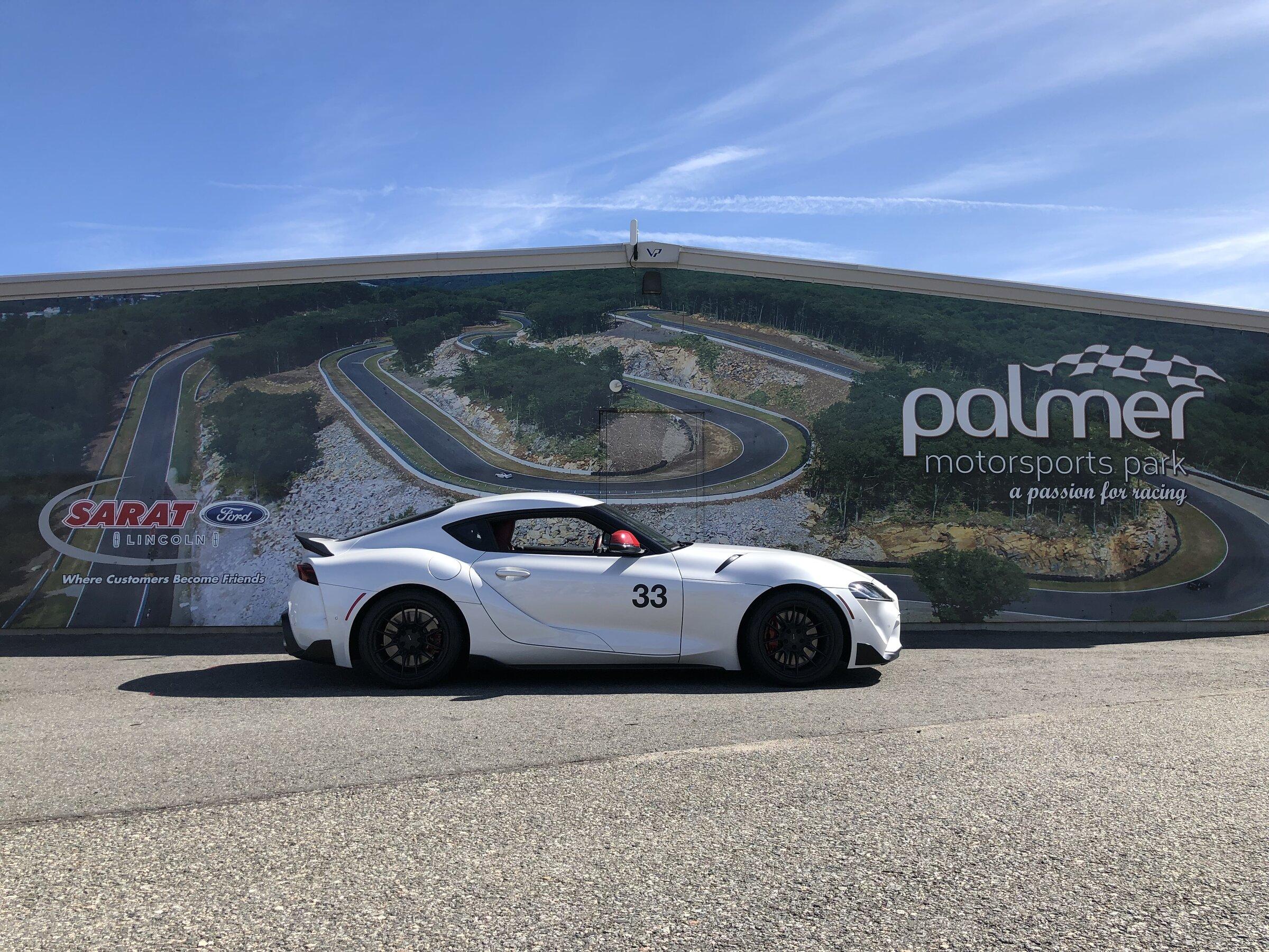

Been slacking on updating this thread.
I've done a couple more track days. Another one at Lime Rock Park, which was just as wet as the first. Rain all day.
Then finally a dry track day, although cold at 32-45F, at Palmer Motorsports Park, which is probably the most amazing and scary track I have been on.
Car feels pretty good. Waiting for a warmer track day to really get a better understanding on how the car is setup.
